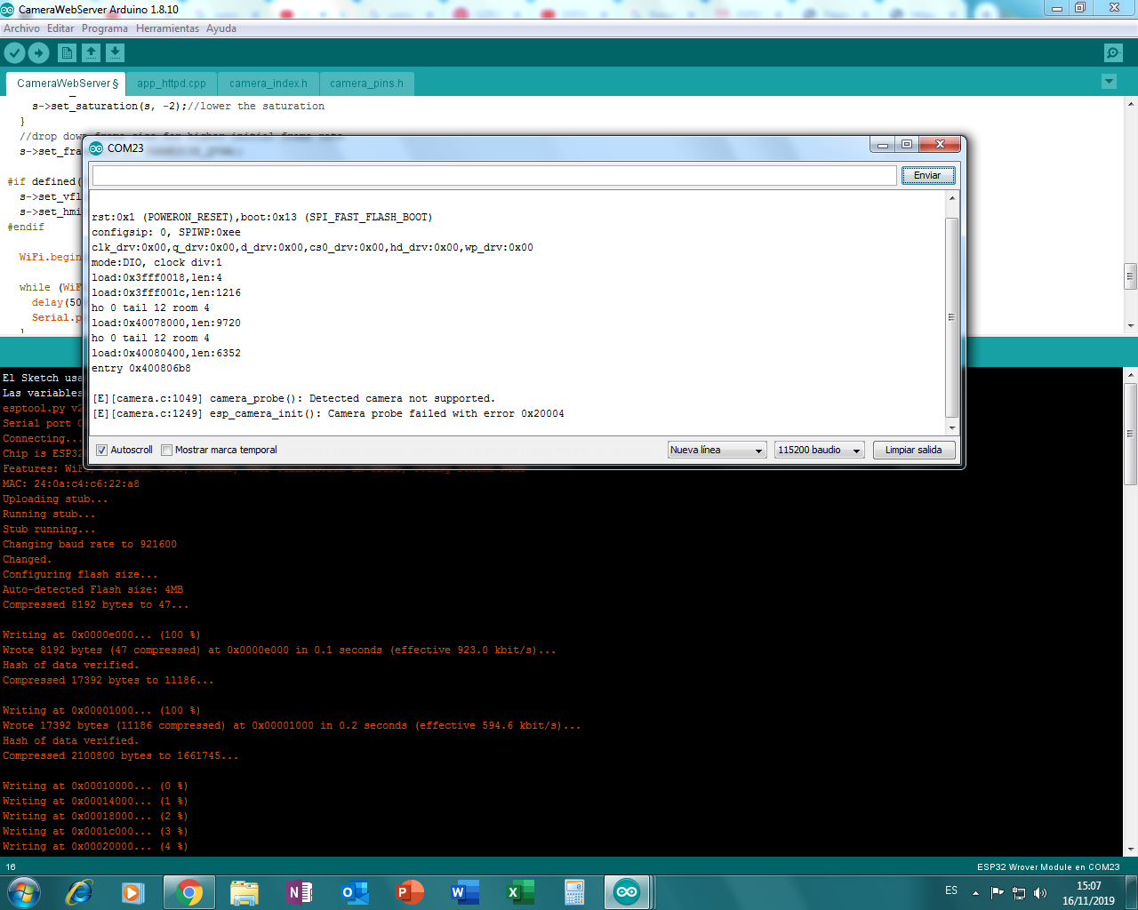

    Unfortunately , I still have to ask for help.
    This is what is now popping up for me when monitoring the port
    How to program the ESP32-CAM directly via the CP2102? .

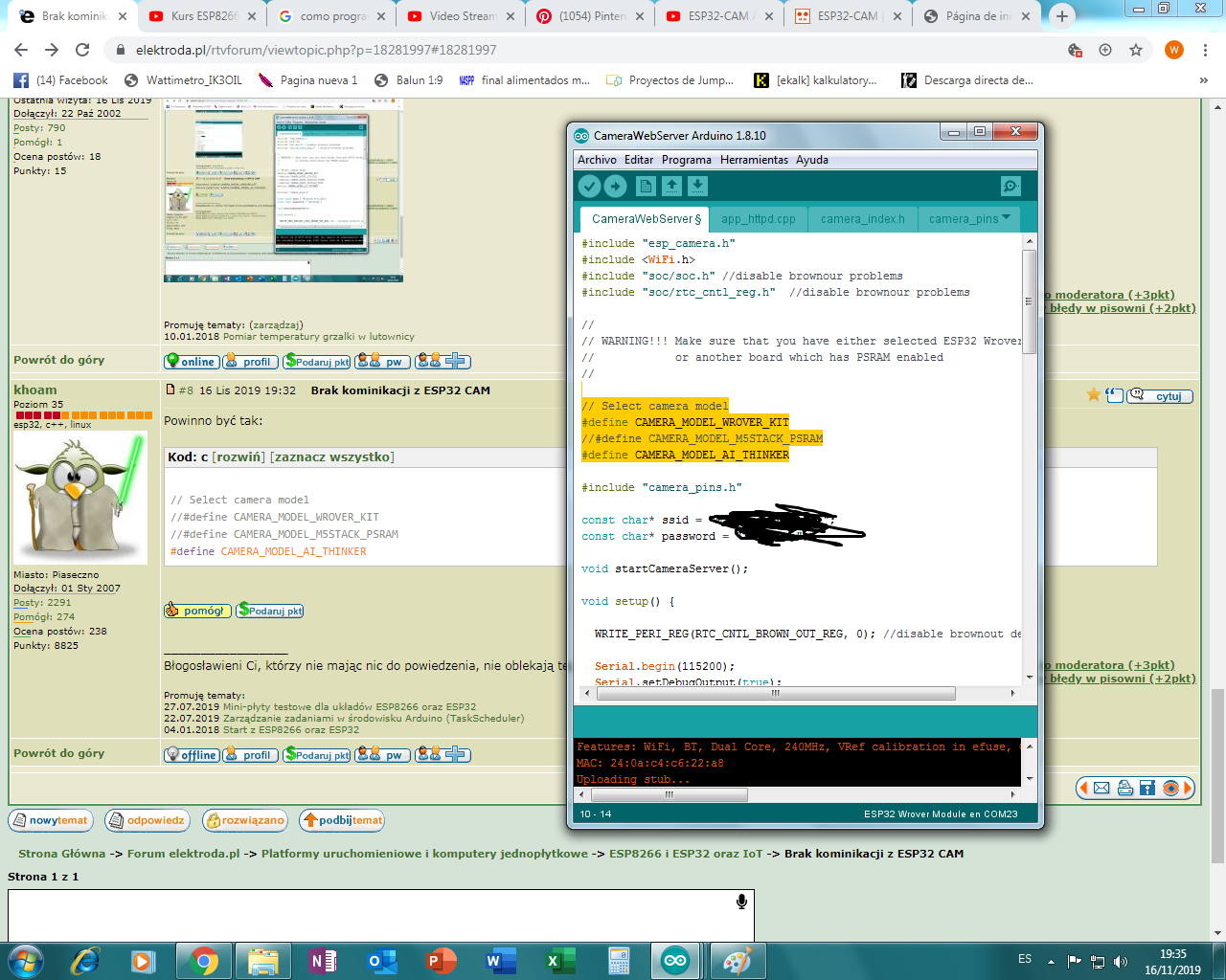

    wosiekpl
    Level 21  
    Posts: 1264
    Rate: 35

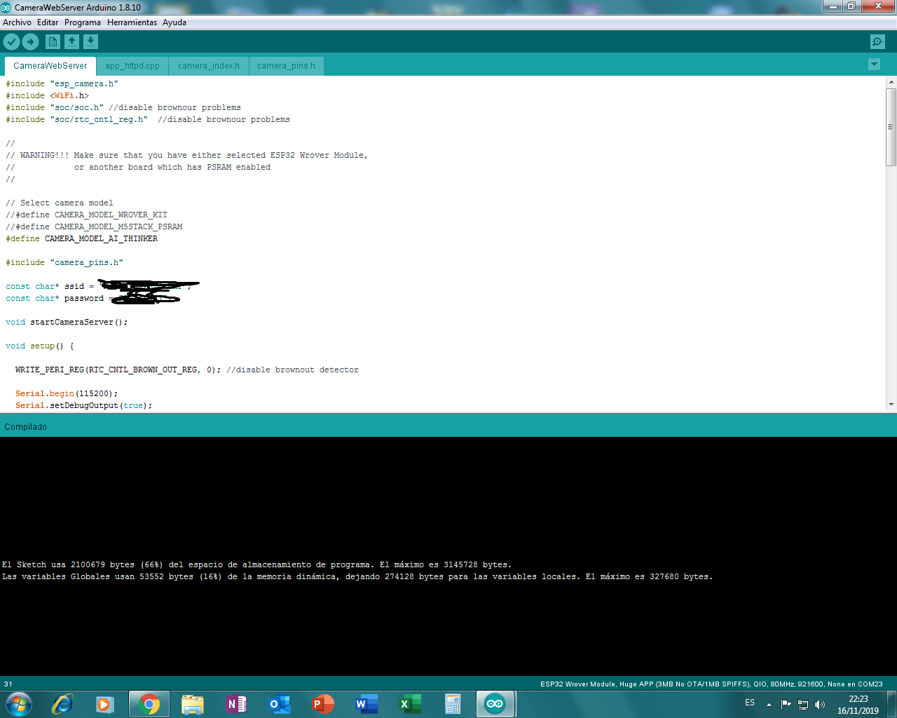

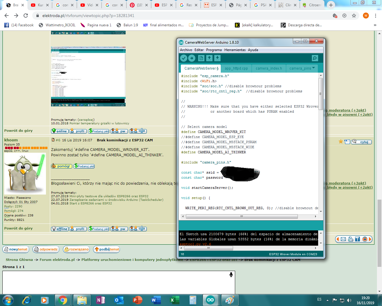

    I have it written down like this in the program, because I don't know much about programming I don't really understand what you mean, i.e. what to change
  • #8 18282034
  • #9 18282062

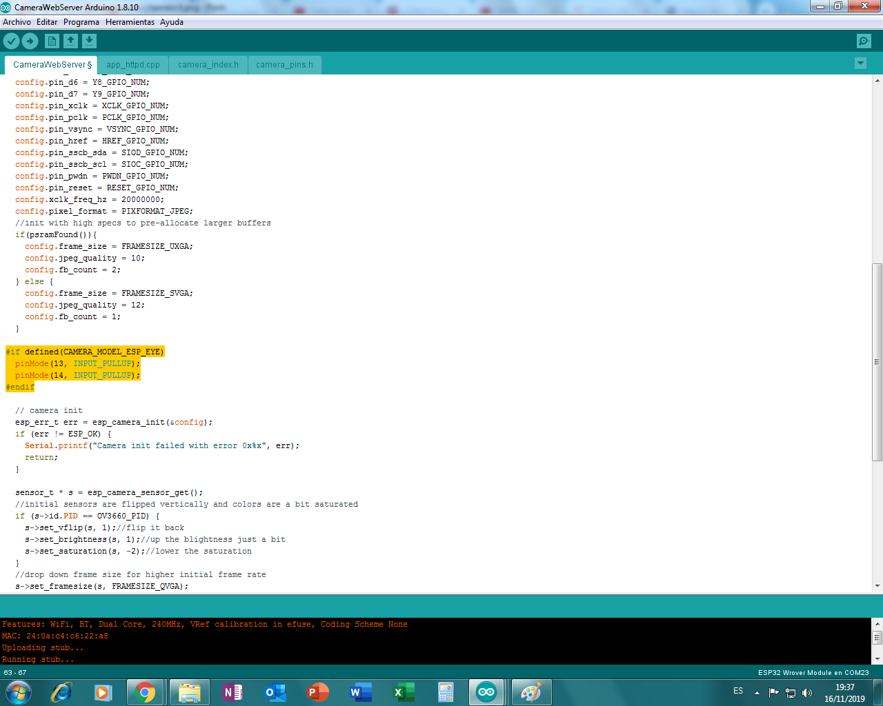

    wosiekpl
    Level 21  
    Posts: 1264
    Rate: 35
    or so ?
    I should add that in the further part of the programme it is written as follows
    Still nothing
    still can't see it

    wosiekpl
    Level 21  
    Posts: 1264
    Rate: 35
    I now have it written like this and while programming it pops up an error like this. Surely I have done something wrong

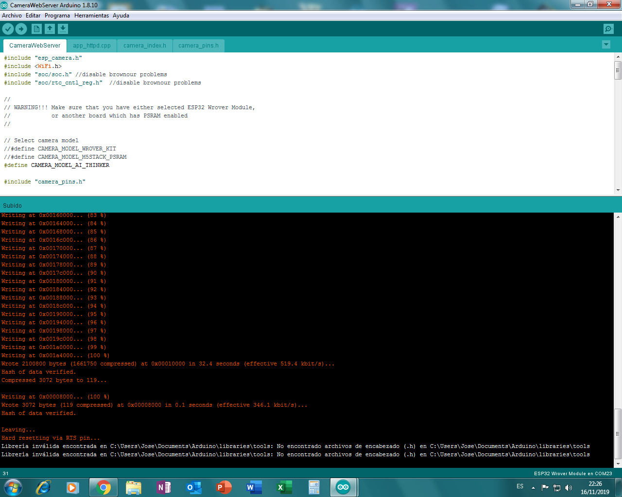

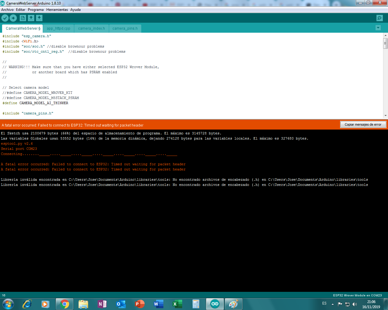

    I have re-entered
    This is what it looks like after the complication
    And this is how it looks after uploading , something is wrong

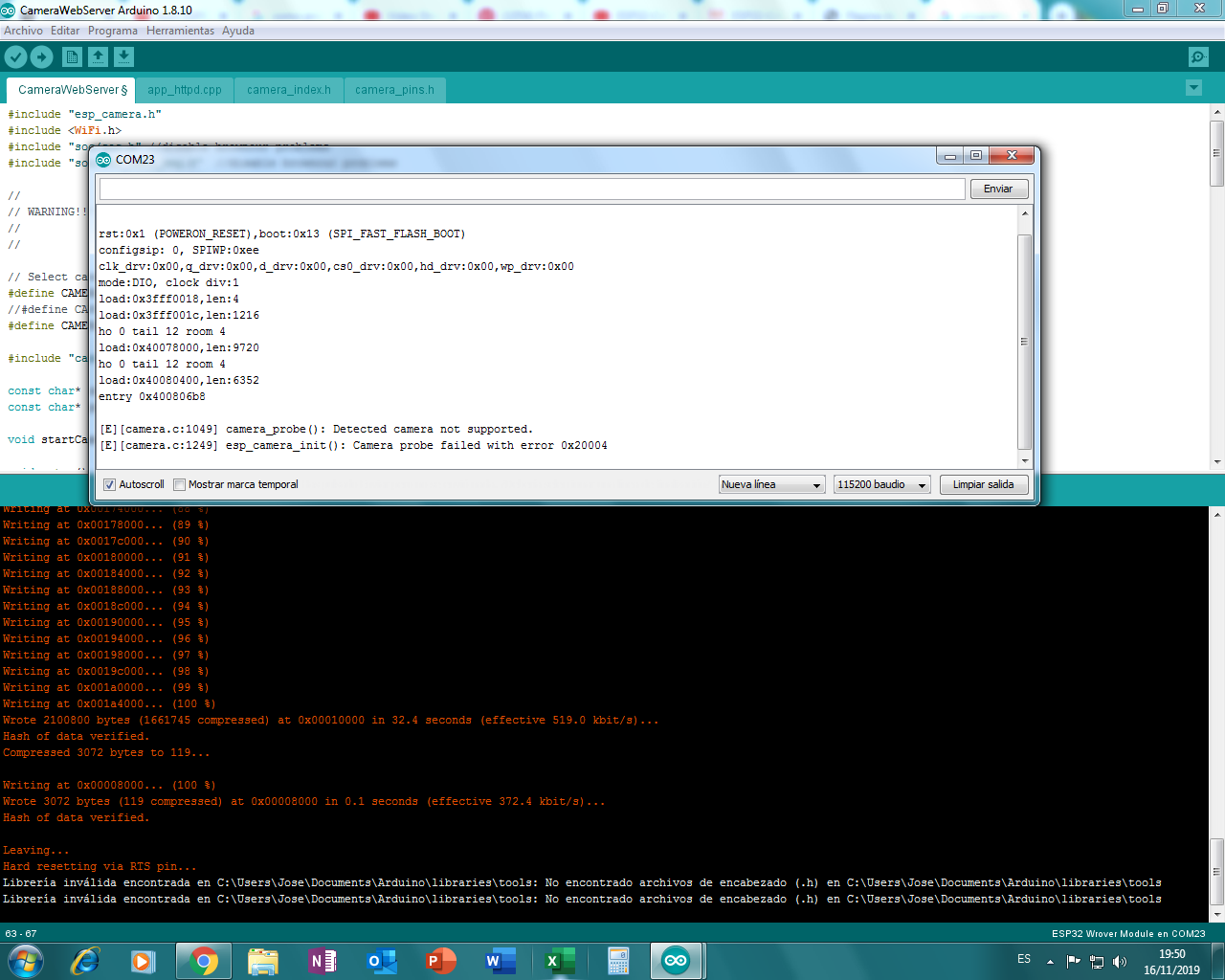

    I use the programme in Spanish jeje
    And it says so
    Library not appropriate found in C user /Jose / Documents / Arduino / Libraries / Tools : folder ( or maybe file ) with header (.h) not found in C - user - documents - Arduino - libraries - tools
    If I understand correctly I am missing the library

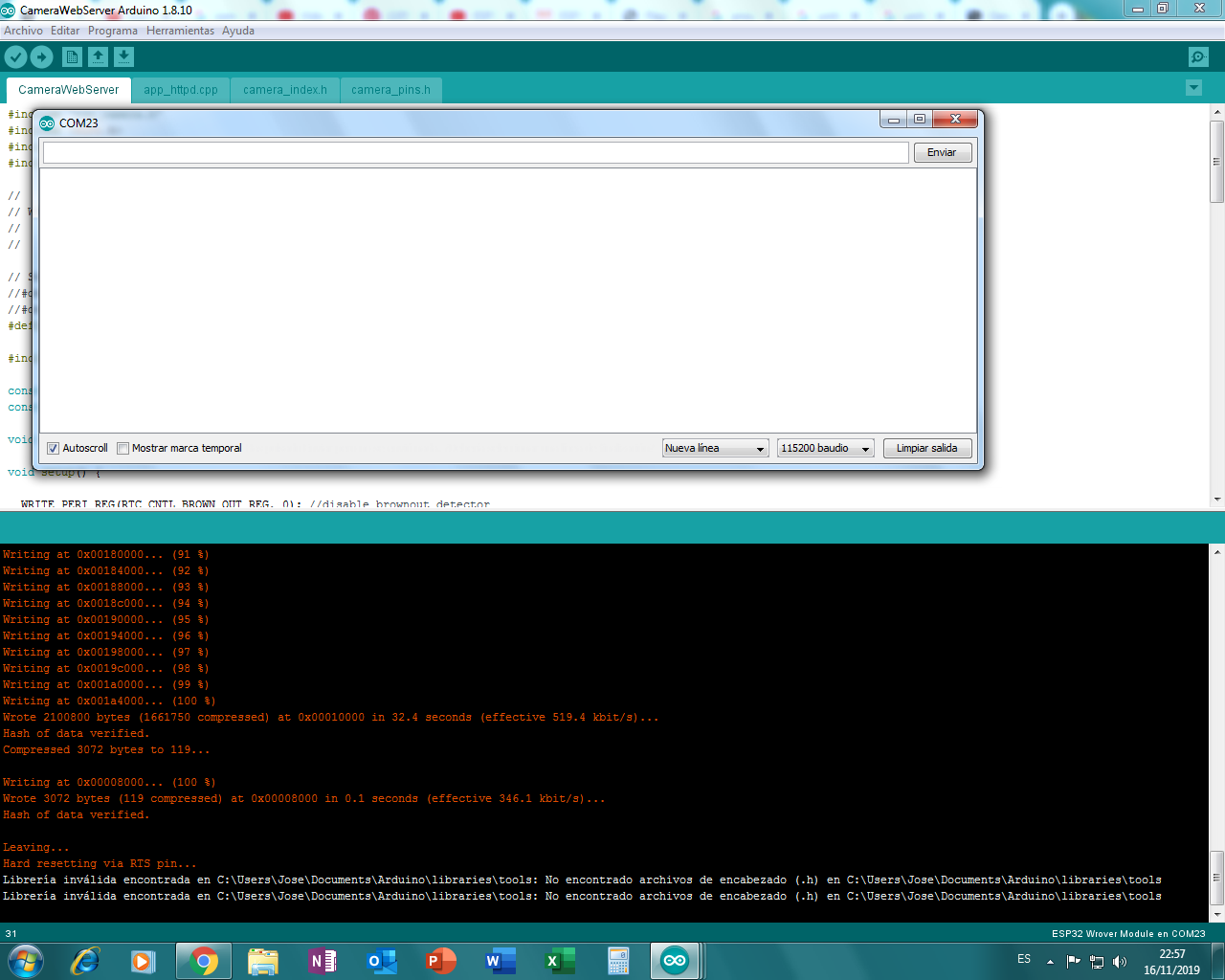

    wosiekpl
    Level 21  
    Posts: 1264
    Rate: 35
    This is what it looks like. At the moment I have a jumper on the ESP module for programming.
    Should I remove it ?
    In order for something to show up in the window I have to press reset on the module board.

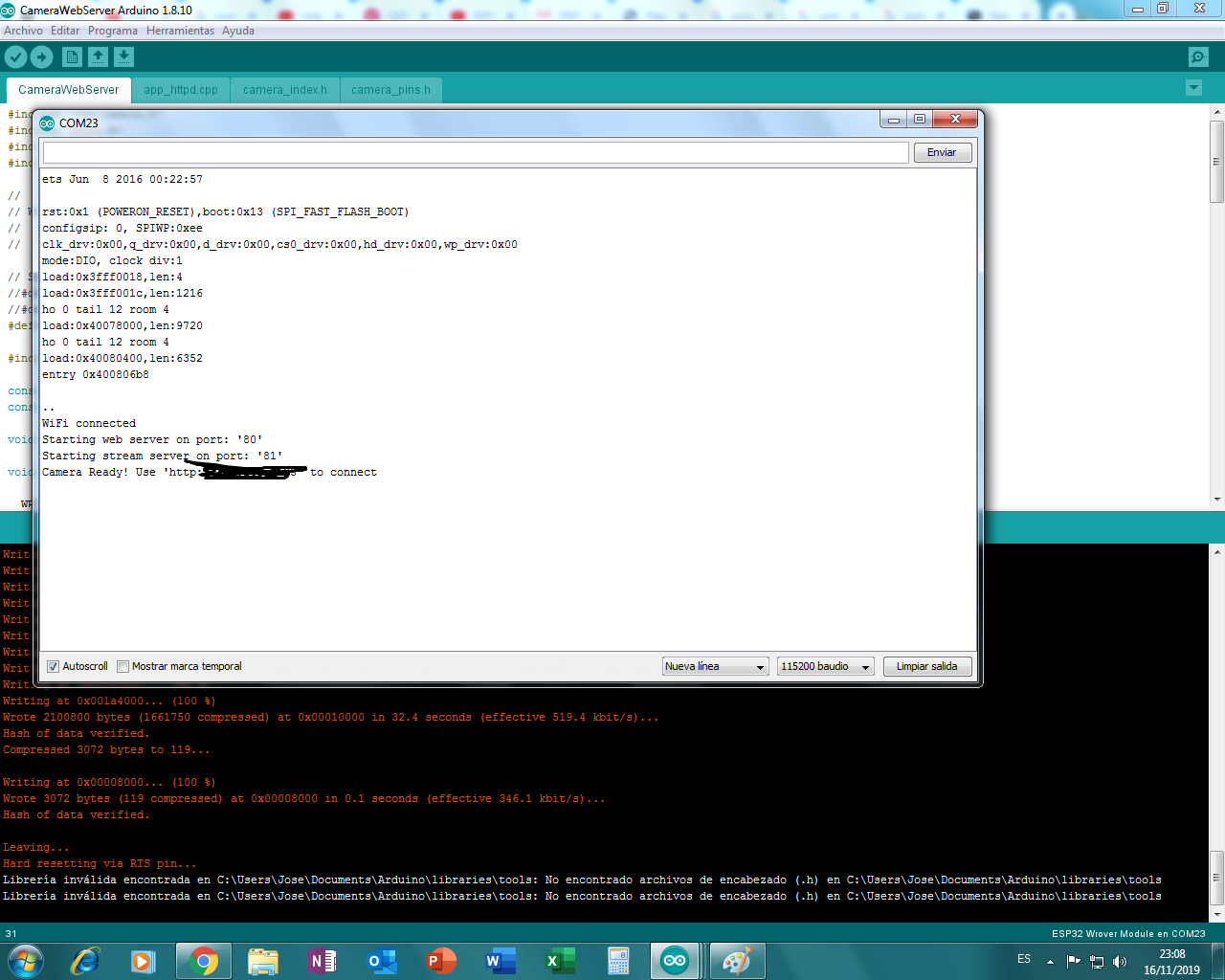

    No , I did the live. Now I have disconnected and reconnected
    It seems to be better
    And to see what the camera sees I need to connect to the address indicated. I understand that I need to use a program with which I can preview?
    It works, I entered the address and it worked.
    Thank you, many thanks for your help

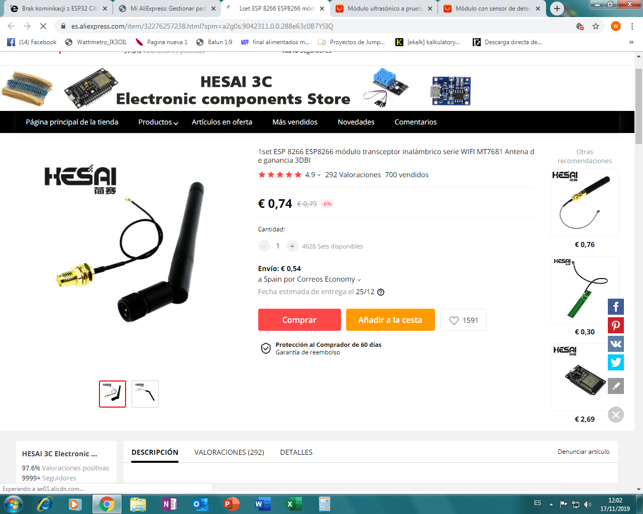

    I am revisiting the topic , the camera works fine but only at home. It is connected to the router via Wifi and in the mobile phone I can watch what it sees but also only when the mobile is connected to the Wifi. I thought that outside the house I would be able to watch but it turns out not to be the case. It follows that I will have to do something else to be able to view the camera image outside the house. I want, for now in the form of tests (because neither the quality of the image nor the voice, does not allow much. It is known that for such money one cannot demand much) to control what is happening on the roof, i.e. control my shortwave antenna.
    Greetings

    I have already ordered ( yesterday ) , This is it
    And now I will take to reading what you have given me
    Thanks
    Ps
    As I wrote, the antenna is already ordered. I just had a quick look at the website you wrote about . I will do further tests at the end of the week. But it seems to me that the problem is not related to the antenna because the signal relay from the router is located 1,5 mtr from the camera.
    The router is in the living room and the camera in the room, in a straight line it will be about 6 mtr but between the camera and the router I have mounted a signal relay which amplifies the signal from the router
