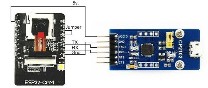

The onboard LED on the ESP32-CAM is not a power indicator; it is connected to GPIO33, so it only flashes if the firmware drives it [#19495781] To upload code from an external CP2102 adapter, disconnect the board’s included converter and wire the ESP32-CAM exactly as in the programming diagram, then press BOOT/FLASH before starting the upload [#19495690][#19495501] If you want to use the included adapter, install the CH340 driver because that converter uses a CH340 chip [#19495781] In this case the board was not initially seen because of a wrong USB cable, so also verify the cable is actually a data cable [#19495959]

    I purchased an esp32 cam on Aliexpress .I wanted to upload the software via arduino but there is a problem communicating with the esp32.I have a question how can I check if my esp is working. Shouldn't the diode blink when connecting power to the esp because it just doesn't blink at my place?

    sediv
    Posts: 106
    This is how it is powered from the converter.
  • Use the external CP2102 wiring for ESP32-CAM programming
    #10 19495690
  • #11 19495755
    sediv
    Posts: 106
    I connected as above in the picture and there is the same error. I did not use the included converter because I used the instructions from youtube. Secondly my computer does not see this converter I think drivers are needed. I repeat the question, shouldn't the LED in the ESP32 at least blink when plugged in ?
