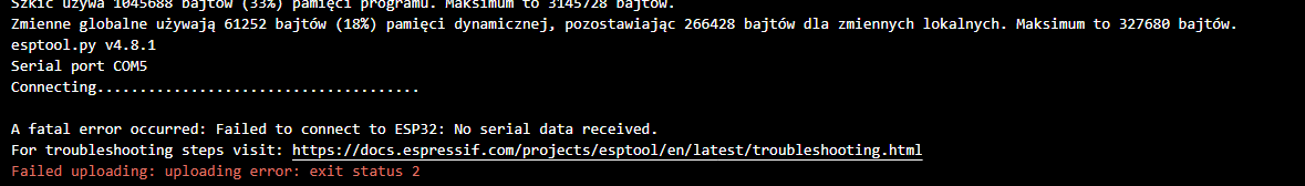

    I recently bought an ESP32 CAM module on Aliexpress, I have an ESP32 CAM MB dedicated programmer, with no problem the boards from Botland program, while with this one there is a problem. On the serial port it sends the phrase app task running, but the board does not connect, it cannot be programmed. A seller from Aliexpress sent me this link https://drive.google.com/drive/u/0/folders/1A...o?spm=a2g0s.imconversation.0.0.1a703e5fvfVZod
    Screenshot of an error during program upload to ESP32.
    Screen fragment with app task running... message.

    To program the ESP32-Cam, the IO0 pin must additionally be bridged to GND.
    Link .
    IO0 must be grounded before boot for flashing
    #3 21447130
    Posts: 14744
    Rate: 12840
    More specifically, IO0 must be connected to ground during boot. If you turn on the ESP and it's already walking, then bridging IO0 to ground won't do anything. I usually:
    - I either bridge IO0 to ground before connecting it to the power supply
    - or I bridge IO0 to GND and then perform a reset by short-circuiting RESET to GND for a while

    during programming, connect a jumper to IO0 GND
