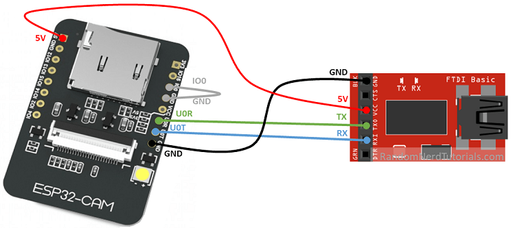

    Hi. As usual, I am asking for help.
    I am uploading a typical program CameraWebServer.ino via Arduino IDE and programmer USB TO TTL FT232RL , Jumper on 3.3V, PIN0 connected to GND, ESP32 powered from programmer with 3.3V everything else as in hundreds of instructions on the net. I press reset on the board, get info on the monitor:
    14:02:22.730 -> rst:0x1 (POWERON_RESET),boot:0x3 (DOWNLOAD_BOOT(UART0/UART1/SDIO_REI_REO_V2))
    14:02:22.730 -> waiting for download
    I upload the program, it loads elegantly. I get info Done uploading .
    I disconnect I0 from GND, press RESET and I get blocks like this displayed over and over again:

    Connect an external power supply when programming, as it will not pull from the programmer.

    vieleicht wrote:
    Connect external power when programming, as it won't pull from the programmer.
    Nothing has changed. I connected the external 5V is the same.
    Added after 2 [minutes]: .
    khoam wrote:
    yarogniew wrote:
    Of course Board: esp32 Wroover , Huge APP etc. As it should be.
    And why not AI-Thinker ESP32-CAM , since you have an ESP32-CAM module?
    Changing to the AI-Thinker ESP32-CAM didn't do anything either. It's poor because loading any program, even Blink, I get the same thing. It flies what I pasted over and over again.

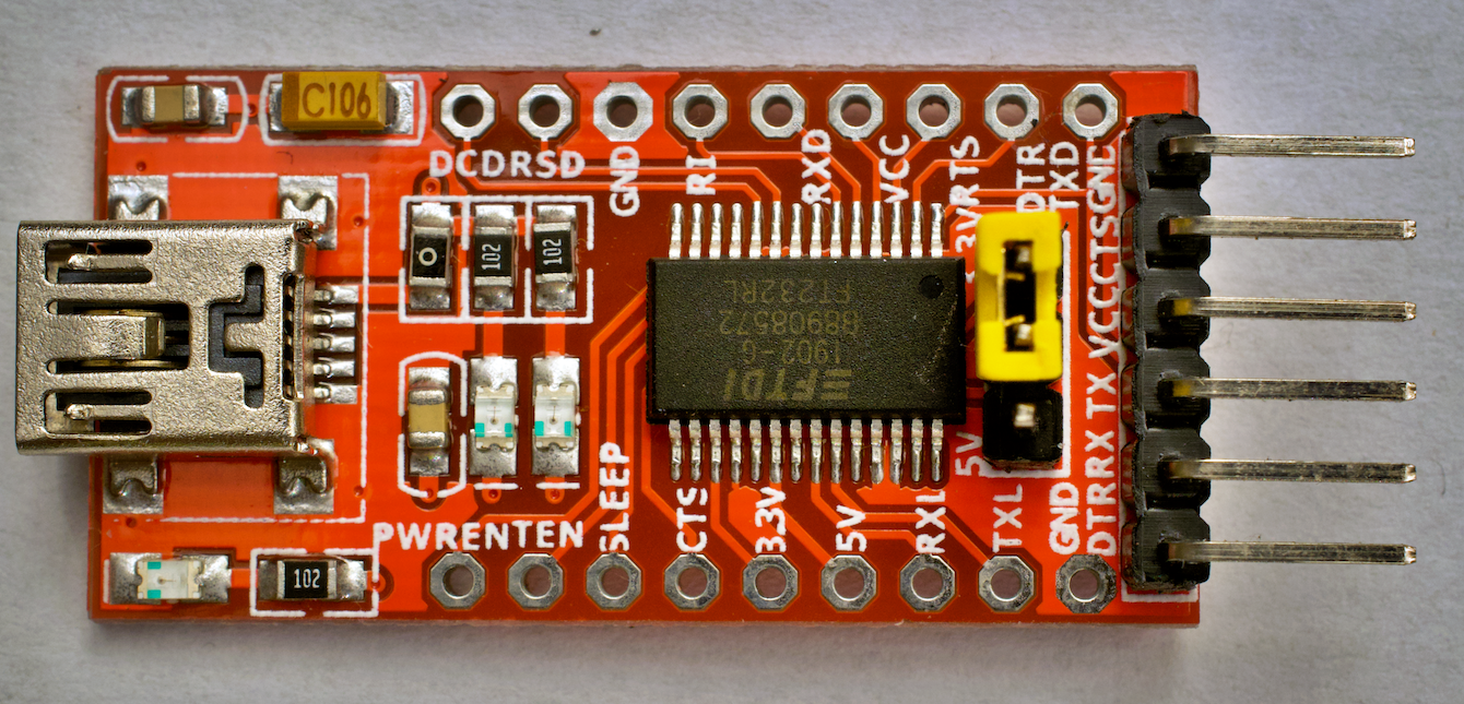

    Now as I connect pin0 to gnd, with a 3.3V supply from the programmer, it heats up my chip on TTL. When I connected external 5V, the regulator on the ESP32 almost burned up. Not even waiting for download after a reset anymore. The pudding.

    khoam wrote:
    ESP32-CAM should be powered from 5V.
    ESP32-CAM FT232RL - no response after uploading CameraWebServer.ino .
    Is this /dev/cu.usbserial-A50285BI port the same one displayed in the Arduino IDE when you loaded the program?
    yarogniew wrote:
    When I connected the external 5V the regulator on the ESP32 almost burned up.
    The stabiliser may have burnt out, but that's because you were connecting external 3V3 to pin 3V3 (that's the power output) on the ESP32-CAM, which you shouldn't do.
    Yes, port the same ft232rl programmer. It releases these packages all the time
    The programmer has a jumper that I set to 3.3V so that there is 3.3V on TX RX, and it should be at 5V?

    khoam wrote:
    yarogniew wrote:
    Programmer has a jumper which I set to 3.3V so that there is 3.3V on TX RX
    This is how it is supposed to work. The UART communication between the ESP32-CAM and the programmer should be in 3V3 logic.
    The ESP32-CAM module itself should be powered from 5V (the "5V" pin on this module). You can power it from the programmer, but from the pad on its board marked, "5V".
    That's what I did, but the comp disconnected my USB power due to excessive power consumption. I'll let it go for today. Something is wrong with this board. Thanks for your help. If I come up with something I'll let you know.

    I had exactly the same problem with the same board and with the same programmer, and the USB port was also not current-carrying when connecting. In my case, what I wrote helped - I powered the ESP32-CAM directly with 5V from the power supply. And of course a jumper at 3.3V in the USB-UART converter.
