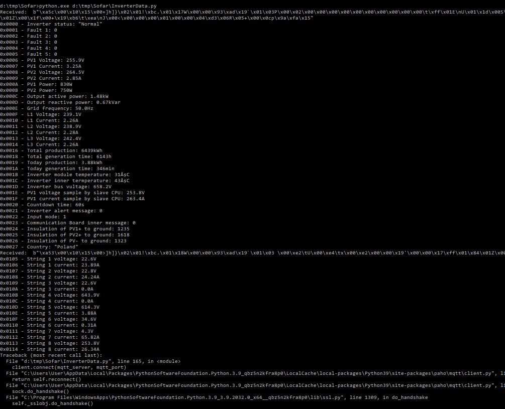

    Emi_B
    Posts: 24
    starob wrote:
    Emi_B wrote:
    Can you fix the following error?
    Your answer is too short.
    It should look something like this:
    Received: b'xa5cx00x10x15x00{]h]}x02x01xfdxce.x01tjx00x00xd2xadx19`x01x03Px00 x02x00x00x00x00x00x00x00x00x00x00nIx00x8cnx10x00}x00%x00 x00?x00?x13x85 tex00}tQx00~tbx00~x00x00x19(x00x00x18x01x01xd2x01xacx00x1bx00)x19x84n
  • Check inverter state transition for spurious power peaks

  • Python hex parsing error in inverter data script
    #125 19657797
    Emi_B
    Posts: 24
    starob wrote:
    Emi_B wrote:
    Does it matter that it's not LSW (wifi) but LSE (ethernet)?
    Doesn't matter.
    Maybe it's a network problem if it doesn't read the whole frame?
    In solarman do you get good readings?

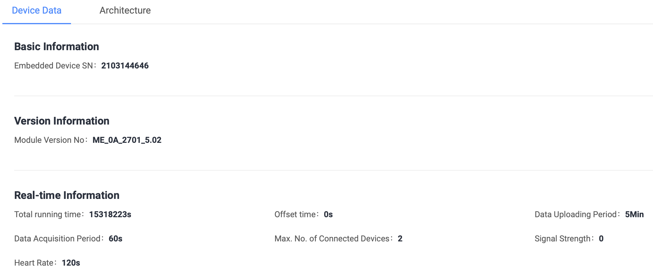

    The problem with the network (range) would be on LSW, because the installation is far from the building. Hence the change to a twisted-pair version of the logger.
    So no, there are no network problems:
    11 packets transmitted, 11 packets received, 0.0% packet loss
    round-trip min/avg/max/stddev = 2.362/3.044/4.197/0.499ms
    In solarman all readings are OK:
    Sofar Solar KTL-X Inverter: RS485 MODBUS Integration with Domoticz - Setup & Tips [90]
    And yet it shows an error:
    Code: Bash

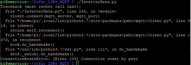

  • MQTT connection problem with Sofar inverter script
    #126 19670339
    mariopoz
    Posts: 18
    Good morning
    For a few days I am also a happy owner of Sofara (and panels on the roof) and I wanted to integrate it with my "smart" house built on a raspberry tree with Domoticz. I have an MQTT server installed there, but this script (from my friend Michalux) has some problems connecting to the MQTT server.
    starob wrote:
    Apart from the problem with MQTT, this worked (not a problem at the moment):
    Have you managed to solve this problem?
    I have a similar message. Sofar Solar KTL-X Inverter: RS485 MODBUS Integration with Domoticz - Setup & Tips [90]

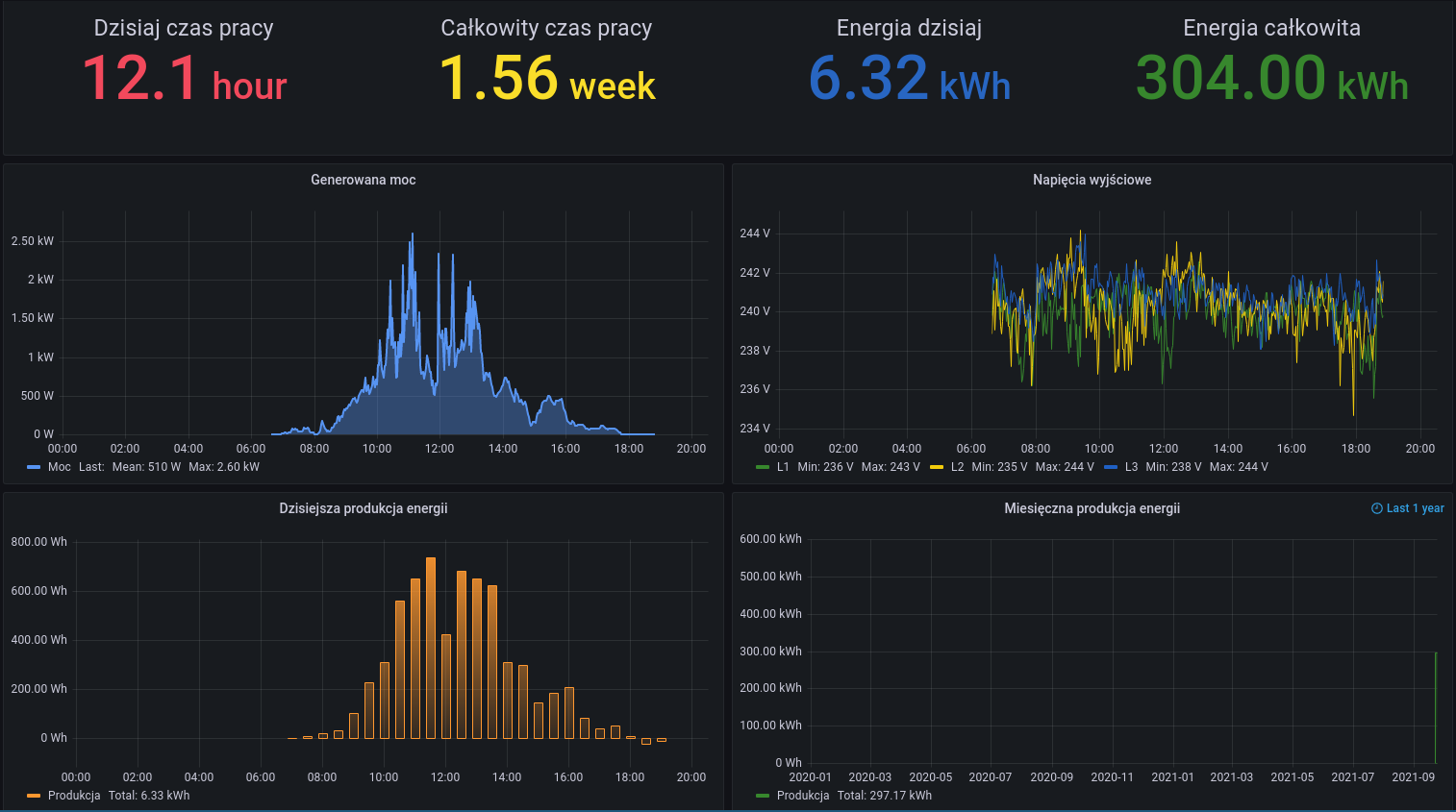

  • Prometheus Grafana support and 4-byte bug fix
    #127 19673845
    mariopoz
    Posts: 18
    Michalux wrote:
    New version 1.1 has been released on github.
    Added support for Prometheus Grafana, verbose mode and fixed bug with 4-byte total (power/time) calculation.
    This is what it looks like in the end:
    Enjoy :)
    Hey! I’ve got a question.
    How did you solve the "problem" of calling the InverterData.py script?
    So far I managed to run it via crontab, but there I can usually set it every 1 minute.
    I still have a problem with a plugin in Grafana, I can't find one like you used timeseries anywhere.
    Workaround for inverter startup spikes and polling interval

    mariopoz wrote:
    Hey! I've got a question.
    I'm on crontab. I don't really need to read more than once a minute.
    But I don't see a problem to write a simple shell script that runs InverterData.py in an interval of min 1s (I don't recommend it, because the logger inverter may not work), e.g.
    while true; do
    python3 InverterData.py
    sleep 1
    done
    You run the script in the background (./skrypt.sh &) and you're done. It can also be thrown into the crontab, so that it runs, for example, once every 10 minutes (then the loop must be limited so that it does not last > 10 minutes). This is in case the script dies/was killed (e.g. due to OS restart).
    As for Grafana, it's a plugin available with Grafana (standard installation - I didn't add anything).
    Maybe you have too old version of Grafana? I'm on 8.2.1 at the moment.
    I don't use MQTT, so I didn't mess with the original code and didn't check it.
    However, look in the forks of my project on GitHub - in one of them someone corrected this piece of code.

  • Incorrect register numbers likely causing frame errors
    #129 19678185
    Michalux
    Posts: 26
    Rate: 15
    Emi_B wrote:
    starob wrote:
    Doesn't matter.
    Code: Bash
    This is generally the most common effect of incorrect register numbers that we are trying to read.
    Try to change them based on, for example, the documentation I attached today (if you don't know how, write to priv).
    To do this, you need to change the numbers in SOFARMap.xml and modify the pini and pfin variables in the script (to the range of registers - after conversion from hex to dec) (initially, just change pini/pfin to see if the response from the logger/inverter is extended or not).

    By the way (while I'm already producing :) ), then I found yet another version of the Sofar/MODBUS documentation. The ranges of registers for reading production data are not suitable for my inverter, but it is greatly extended in relation to the documentation I found on the forum (but registers containing SN, versions, etc. are OK). It shows that it is also possible to manage the inverter in a similar way, including switching on/off, changing the configuration, etc. (generally writing support, not only reading).
    I am attaching the document for those interested.
    As the installation on the Sofar 8.8LTL-X has just started for me, I started "digging" in it to get as much useful information as possible directly from the inverter, and basically from the logger via WiFi.
    At first glance, it seems that the registers described in this version of the documentation do not match the version of the inverter/logger that I have.
    While some of the basic data is the same, the registers marked as "Inverter inner message" are completely different.
    The previous version from this thread (Word) mostly fits, but for example, the 0x001F register does not show the current on the PV1 string measured by the "slave CPU" only the voltage of the PV2 string measured by this processor. The PDF version at this address has the temperature of the inverter.
    It looks as if the version from Word was for inverters with 1 string (DC input) and the one from PDF with 2 strings but 3 DC inputs (because there are registers described there that refer to PV3)
    The question remains, has anyone seen any other versions of the documentation anywhere?
    In addition, it seems to me that the logger itself has at least two bugs in the software.
    I am unable to turn off the built-in AP - despite selecting it in the "wizard" from the configuration, it still advertises its WiFi network.
    The second error is the way of presenting the daily production. With small production values of 0.01 to 0.09, the logger on the website shows 0.1 to 0.9. Then, when it actually jumps above 0.1 kWh per day, it already shows well.

    #146 19797689
    GP007
    Posts: 16
    Rate: 7
    The script works fine for me, it reads the parameters, but I have a problem with the integration with Domoticz. It seems that mosquitto only accepts the first parameter sent by the script (no matter what it is) and then nothing from the following lines.
    According to the record from mosquitto.log, it looks like this:
    1641201602: New connection from 192.168.1.16 on port 1883.
    1641201602: New client connected from 192.168.1.16 as inverter (p2, c1, k60, u'mosquitto2').
    1641201602: No will message specified.
    1641201602: Sending CONNACK to inverter (0, 0)
    1641201602: Received PUBLISH from inverter (d0, q0, r0, m0, 'domoticz/in', ... (32 bytes))
    1641201602: Sending PUBLISH to Domoticz608855fa-954b-41f7-a6ac-7b0852822cf1 (d0, q0, r0, m0, 'domoticz/in', ... (32 bytes))
    1641201602: Socket error on client inverter, disconnecting.
    Other things on this mosquitto/domoticz type sonoff on tasmota work fine...
  • #147 19801042
    GP007
    Posts: 16
    Rate: 7
    Answering myself, it helped to put time.wait(1) in the script at the client connection and after each client.publish in the loop. Probably temporarily my mosquitto did not knead. Now domoticz gets all the data.
  • #148 19807527
    sq7krj
    GP007 could you please share your solution? Unfortunately I have the same problem with my Mosquitto. And from programming I have a total leg.
  • #149 19807662
    GP007
    Posts: 16
    Rate: 7
    Please. Three lines of code added to the original: import time at the beginning and time.wait() twice.
    • InverterData.zip (3.53 KB) You must be logged in to download this attachment.
  • #150 19807692
    sq7krj
    Revelation :) . Finally all data in Domoticz. Thank you very much.
