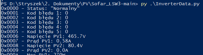

    Michalux wrote:
    No trick with DNS :)
    The solution polls the inverter directly via the LSW-3.
    Tested on LSW-3 version: LSW3_15_FFFF_1.0.57
    Sofcik is written in python3 for linux (tested on raspberry), download here: https://github.com/MichaluxPL/Sofar_LSW3
    It also works under windows :lol:
    There is only a tiny problem with Polish characters:
    0x0000 - Status: "Normal"
    0x0001 - Error code 1: 0
    0x0002 - Error code 2: 0
    0x0003 - Error code 3: 0
    0x0004 - Error code 4: 0
    0x0005 - Error code 5: 0
    0x0006 - PV1 voltage: 472.8V
    0x0007 - PV1 current: 1.74A
    0x0008 - PV2 voltage: 80.8V
    0x0009 - PV2 current: 0.0A

    It is probably enough to edit the .xml file and change the Polish names under the elevator so that the fonts are correct.
    If that doesn't help, I'd suggest playing around with the last line of code:
    print(json.dumps(jsonoutput, indent=4, sort_keys=False, ensure_ascii=False))
    specifically with the ensure_ascii=False option

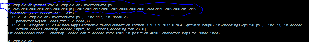

    Doesn't work :)
    I added under parse response - print(data) and it answered me.
    I don't know what, but not enough? Sofar Solar KTL-X Inverter: RS485 MODBUS Integration with Domoticz - Setup & Tips [90]

    Add .\ before the name of the script file
    The second error is related to Polish characters, find the text ERROR in the XML file and remove the Polish characters.
    Binary response suggests wrong register addresses

    Typing print(data) rather did not make sense at all, because the data variable contains a binary response from the inverter ;)
    I haven't tested it on windows, but as I can see from the posts above, it probably works (with the accuracy of Polish letters) - you can always set lang=EN in the config and after the problem :)
    However, judging by the amount of data in the data variable, you're probably not getting the required data.
    So either the script doesn't get along with your module or your inverter has different register addresses.
    Windows-1250 encoding fixes Polish text display

    It's ok. In Notepad it was enough to set the encoding to windows-1250 and edit:

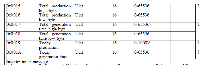

    @Michalux Looks like you have a miscalculation
    if hexpos=='0x0015': totalpower+=response*ratio;
    if hexpos=='0x0016': totalpower+=response*ratio
    Should:
    if hexpos=='0x0015': totalpower+=response*ratio*65535;
    0x0015 is Hi totalpower - until =0 the results are correct
    0x0016 is Lo totalpower
    Similarly, addresses 0017,0018 for time
    Dress it up in python and fix it

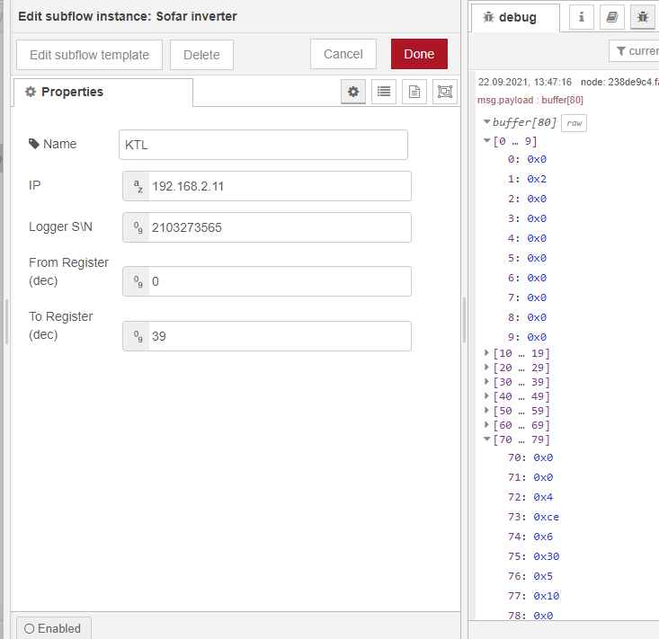

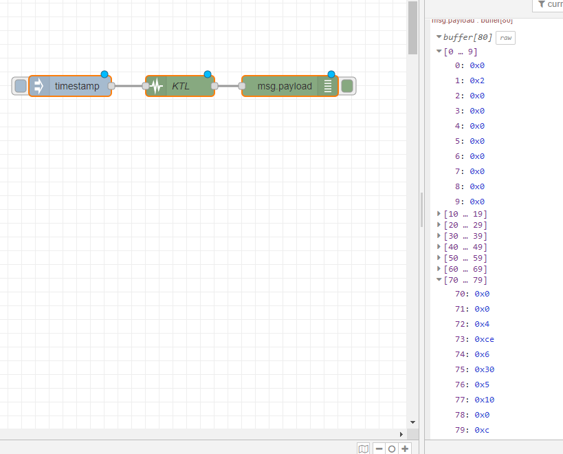

    Rate: 137
    The first version for testing data reading from the Sofar inverter - directly via the network.
    Import sofar.json to Node-Red.
    A subflow will be created - "Sofar inverter", which contains functions that return copies of the inverter registers, in the order and format compliant with the modbus specification.
    In the properties, complete the inverter's IP, logger serial number and the range of the block of modbus registers for reading.
    The output buffer should alternately match node-red-contrib-modbus - if someone has used it before.

    I advised you wrong - not *65535, but 65536.
    Best check it out :)
  • #106 19623674
    Michalux
    Posts: 26
    Rate: 15
    Well, definitely 65536 ;)
    I don't know why I typed it 65535 :?:
    Fixed.

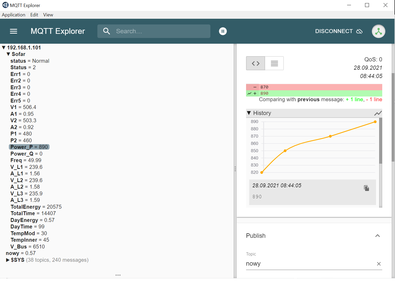

    Extended Node-Red version from the previous post
    Data reading from the Sofar inverter - directly via the network.
    I added parsing to MQTT.
    • SofarLanMqtt.zip (4.01 KB) You must be logged in to download this attachment.

  • #110 19630012
    iborkim
    Posts: 38
    Rate: 33
    Works with S/N 05xxxxxxxx
    Sofar Solar KTL-X Inverter: RS485 MODBUS Integration with Domoticz - Setup & Tips [90] .

    #111 19637909
    pirzol
    Posts: 28
    I have Inverter Deye SUN-3.2K-G03, with LSW3 logger
    Device serial number 175xxxxxxx
    Firmware version LSW3_15_FFFF_1.0.65
    The same logger is used by Sofar, unfortunately the registers are probably different.
    I ran the script under python 3.9.7 on windows, it gets responses as below:
    ======================= RESTART: C:DeyeInverterData.py ================= ======
    Chunk no: 0
    Sent data: bytearray(b'xa5x17x00x10Ex00x00xa6x8exdewx02x00x00x00x00x00x00x00x00x00x00x00 x00x00x00x01x03x00x00x00(Exd4x00x15')
    Received data: b'xa5x10x00x10x15x00IxdcrZhx02x01sxddnx00x8bx1fx00x00x14xa2Nax06x00x9b x15'
    Traceback (most recent call last):
    File "C:DeyeInverterData.py", line 156, in
    parameters=json.loads(txtfile.read())
    File "C:UsersxntyAppDataLocalProgramsPythonPython39libencodingscp1250.py", line 23, in decode
    return codecs.charmap_decode(input,self.errors,decoding_table)[0]
    UnicodeDecodeError: 'charmap' codec can't decode byte 0x81 in position 7950: character maps to
    Regards
    P

    #112 19637976
    starob
    Posts: 1088
    Help: 128
    Rate: 137
    zygzak wrote:
    Michalux wrote:
    starob wrote:
    Doesn't work :)
    It's ok. In notepad++ it was enough to set the encoding to windows-1250 and edit:
    You received the data, because of the different inverter you would have some stupid results ... but you did.
    Remove Polish characters
