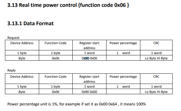

    I set the SOFAR 60000TL inverter power via RS485 port, Modbus RTU protocol. I hope this will be important for other SofarSolar inverters. For example, you need to set the power to 57%. Therefore, you send to port 01 06 90 00 39 D9 77 (hex meaning).
    Here 01 - ID (Modbus address) of the inverter 06 - function number 90 00 - starting register 00 39 - power meaning (57 dec = 39 hex) Power unit here 1%. 100% corresponds to 64 hex D9 77 - CRC (check sum)
    You can submit a different package for yourself, CRC can be counted online https://www.lammertbies.nl/comm/info/crc-calculation Sofar Solar KTL-X Inverter: RS485 MODBUS Integration with Domoticz - Setup & Tips [90]
    CRC in Sofar go Lo byte, Hi byte - not standard. Therefore, the bytes in the counted CRC must be changed by place.

    spin722 wrote:
    Modbus TCP, as usual, will use port 502. Therefore, packets will not go through port 8899 to the inverter. But better check it out.
    Here

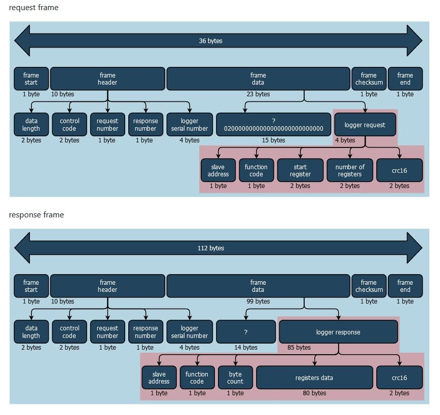

    Because you read via RS485. LSW3 has its own "protocol" which is not fully figured out.
    A regular MODBUS request (logger request) is wrapped in a wider frame, and so are the responses.
    How did he read it?
    TCP request sent to the logger IP address, port 8899

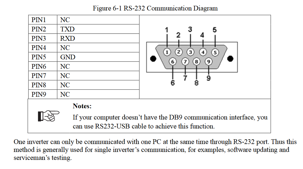

    pabelo76 wrote:
    I am looking for a pinout of the connector in Lsw-3, does anyone have it?
    I think it's just a COM-port, standard RS232.
    You can check it. Needed to measure the voltage between pins 2-5, 3-5. Must be something around -5...12 and 5...12 volts.

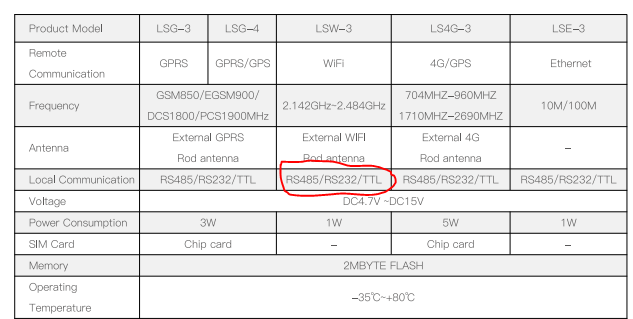

    You're wrong. It's definitely RS485, note that it also supplies power to the module.

    There is no RS485 in the LSW-3.
    See LSW-3 technical specifications in the datasheet https://www.sofarsolar.com/product-detail/499/Stick-Logger
    "Data interface - RS232"
  • #229 20168910
    starob
    Posts: 1088
    Help: 128
    Rate: 137
    Do not look at what LSW has, only the inverter.
    The data shows that LSW has it all ;)

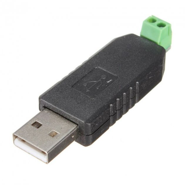

    What a problem to check. Connect the USB-RS232 cable, configure the baud rate and try to read a modbus register using e.g. Radzio modbus master simulator.

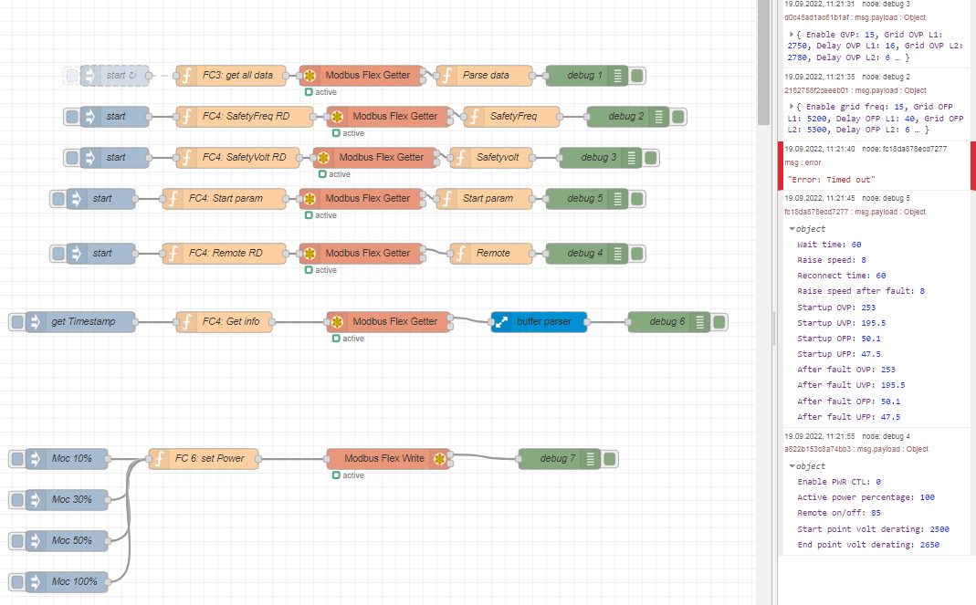

  • Question about saving custom FC 0x13 parameters
    #231 20196592
    xury
    Automation specialist
    Posts: 7090
    Help: 878
    Rate: 1501

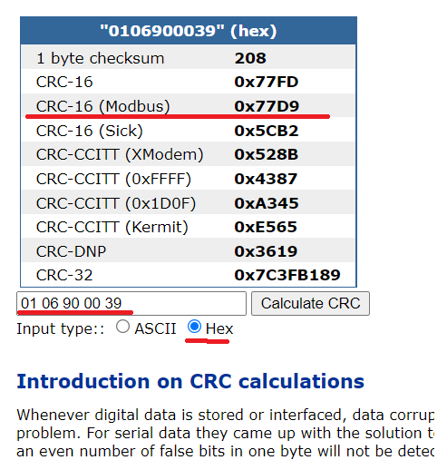

    Is this CRC correct for this. I do not want to leave D9 77
    It always comes out as pictured. Nodered counts the same.
    Added after 5 [minutes]:
    And I already know. you counted
    01 06 90 00 39
    and according to the protocol it should be:
    01 06 90 00 00 39
    The question is anyone know how to save custom FC 0x13 parameters?

    spin722
    Posts: 27
    Rate: 9
    01 06 90 00 39
    01 06 90 00 00 39
    I'm sorry for my mistake.
    A few weeks ago I saw that one inverter did not start automatically after the error was removed. I found that registers 1009-100B are zero. Other inverters have different information. It must have changed the meanings of the registry, He wrote that by FC 13.
    B7 9F

    xury
    Posts: 7090
    Help: 878
    Rate: 1501
    I made an RS485-TCP bridge on ESP8266 and read the registers using NodeRed-contrib-modbus:
    So what the inverter gives me is directed to the TCP port, and what goes to this port goes through the UART and the RS485 converter to the inverter. I used the scheme:
    https://github.com/pawelka/sofarsolar_esp_rs485_logger except that I didn't use any of the solutions proposed by him, but I used Tasmota as serialbridge https://tasmota.github.io/docs/Serial-to-TCP-Bridge/
    As Tx and Rx pins I used D6 and D7 on hardware pins it didn't want to work well.
    One small note, this won't work on a compiled Tasmot, you need to compile your own with the Serialbridge option enabled. I can provide the binary if anyone needs it.
    Sometimes I have timeouts but generally reading is ok. Especially standard FC 3 registers.
    Attached is a picture of reading other registers that I managed to discover in my 4.4 KTL-X G2
    And a complete flow to NodeRed.
    When reading via cable, you need to set modbus-rtu in settings
    I use a combined RTU to TCP transition Sofar Solar KTL-X Inverter: RS485 MODBUS Integration with Domoticz - Setup & Tips [90]
    Disabled first Inject gives us exactly the same values as the wifi loger.
    The only thing I can't do is write and read registers under non-standard function codes like 0x13 0x40 0x60 etc.
    Attention, an error has crept into the power control flow and instead of 100% it is 30%.
    You need to change the value from 30 to 100 in inject node.
    • Sofarmodbus.zip (3.15 KB) You must be logged in to download this attachment.
  • ESP8266 RS485-TCP bridge for Modbus reading
    I use a USB-RS485 converter
    I normally read on the computer. I write the same through this converter.

    I made a mistake in Node which sets the power to 100%. It should be 100 instead of 30.
