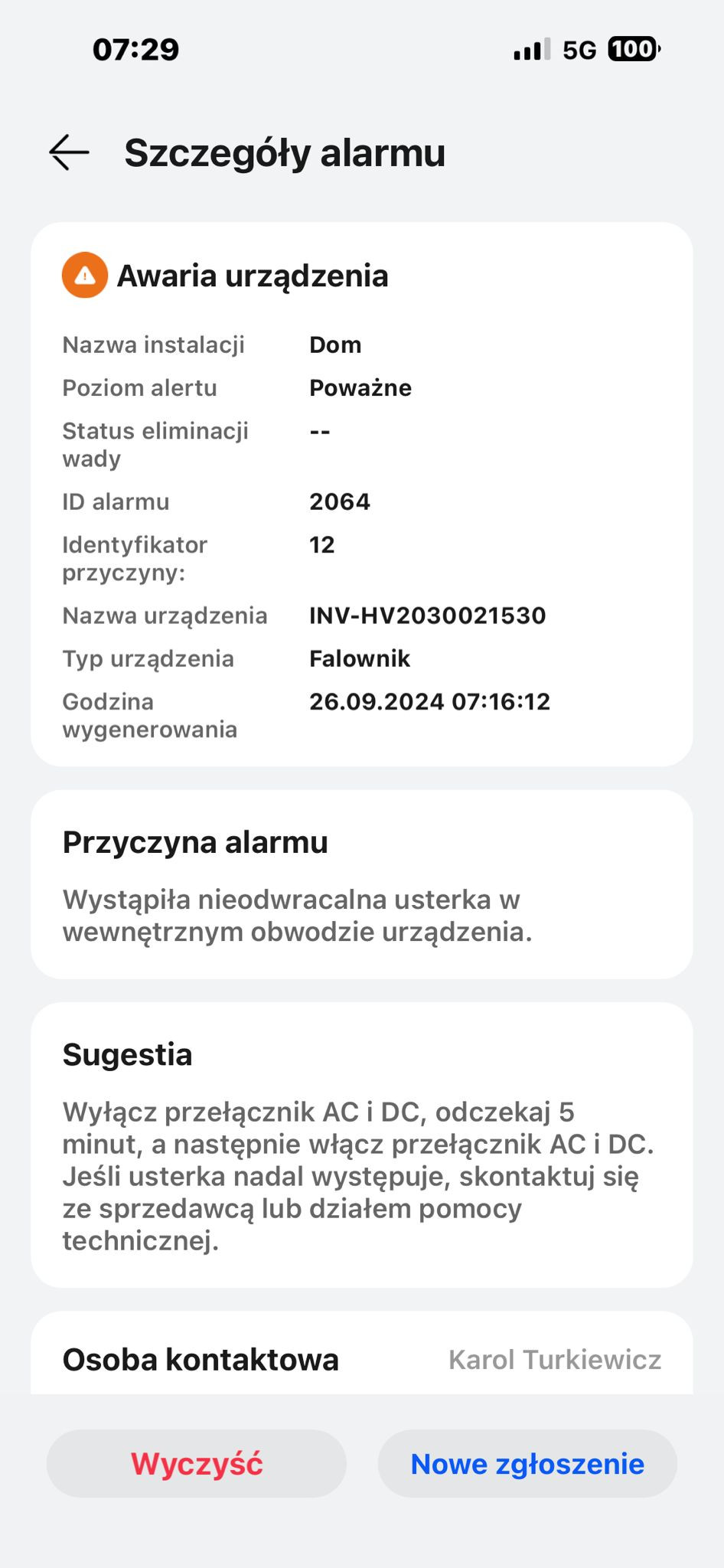

  • #1321 21239828
    karolturkiewicz86
    Good morning, this is what appears to me on the Huawei inverter, plus 3 red LEDs.
    • Huawei SUN2000 Inverter: WIFI Dongle Connection, Firmware Update & FusionSolar WhatsApp Image 2024-09-26 at 08.12.18.jpeg (157.07 KB) You must be logged in to download this attachment.
  • #1322 21239833
    mateos2
    Posts: 153
    Rate: 8
    >>21239828 reboot exactly as recommended - if it persists then replace with new ones

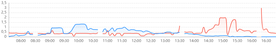

    #1328 21414655
    salo5
    Posts: 164
    Good morning,
    I recently set up a photovoltaic for myself and so am testing how it works.
    Huawei SUN2000-3KTL-L1 inverter with LUNA 5kWh storage.
    DDSU-666-H 1 phase meter.
    I observe on a daily basis that I do not have full consumption and consumption information from the PV.
    There are hours that the consumption information to the server is not transmitted, as can be seen in the graph below:
    Energy consumption chart from the photovoltaic system throughout the day.
    Is this normal and this type has it like this, or pay attention to something else?

    #1330 21416121
    cedrom
    Level 20  
    Posts: 229
    Help: 35
    Rate: 81
    salo5 wrote:
    Good afternoon,
    I have recently set up a photovoltaic for myself and so am testing how it works.
    Interruptions in internet connection. Wifi at the limit of range.
  • #1331 21416174
    mateos2
    Posts: 153
    Rate: 8
    >>21416121 .
    Huawei sends the missing data as soon as coverage returns
    Unless the coverage is mega-poor and bigger data doesn't get through
  • #1332 21416477
    k_pec
    Posts: 1772
    Help: 271
    Rate: 562
    Have you checked what wifi connection you have --> Link - TEST1.
    If it's weak and that's the cause of the outages, you can always poke around to improve it.
  • #1333 21417382
    cedrom
    Level 20  
    Posts: 229
    Help: 35
    Rate: 81
    mateos2 wrote:
    >>21416121 .
    Huawei sends back the missing data as soon as coverage returns
    For longer interruptions, you can restore up to a month back.
  • #1334 21417602
    salo5
    Posts: 164
    cedrom wrote:
    Interruptions to internet connection. Wifi at the limit of range.
    k_pec wrote:
    Have you checked what kind of wifi connection you have --> Link - TEST1.
    If it's weak and that's the cause of the dropouts, you can always poke around to improve it.
    Hi,
    Unfortunately not this - inverter connected via ethernet cable.
  • #1335 21417871
    kotbury
    Gantry automation specialist
    Posts: 9584
    Help: 2098
    Rate: 3625
    And doesn't the home router catch crashes or have timed resets? My Growatt has as an intermediary such an ancient router monument with Gargoyle firmware preloaded, and it regularly crashes, and out of laziness (I'm not keen on re-pairing a possibly new Acces Point with the inverter's Dongle) I put up with having to regularly reset the router.
  • Shielded ethernet and local switch test recommended
    #1336 21417908
    k_pec
    Posts: 1772
    Help: 271
    Rate: 562
    salo5 wrote:
    Hi,
    unfortunately not that - inverter connected via ethernet cable.
    LAN can also cause problems when working with inverters, which can generate a lot of interference, so much so that the manufacturers themselves can recommend shielded twisted pair cables. Obviously grounded on both sides, otherwise all sorts of things can happen on an unshielded twisted pair cable.
    It might be worth putting a switch under the inverter and testing TEST4 from the link provided earlier. It won't be entirely reliable, but it's always something.
    Or maybe there is something on the way from the internet to the inverter, not to mention lag on the internet link itself to the cloud.

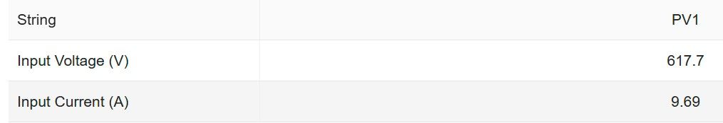

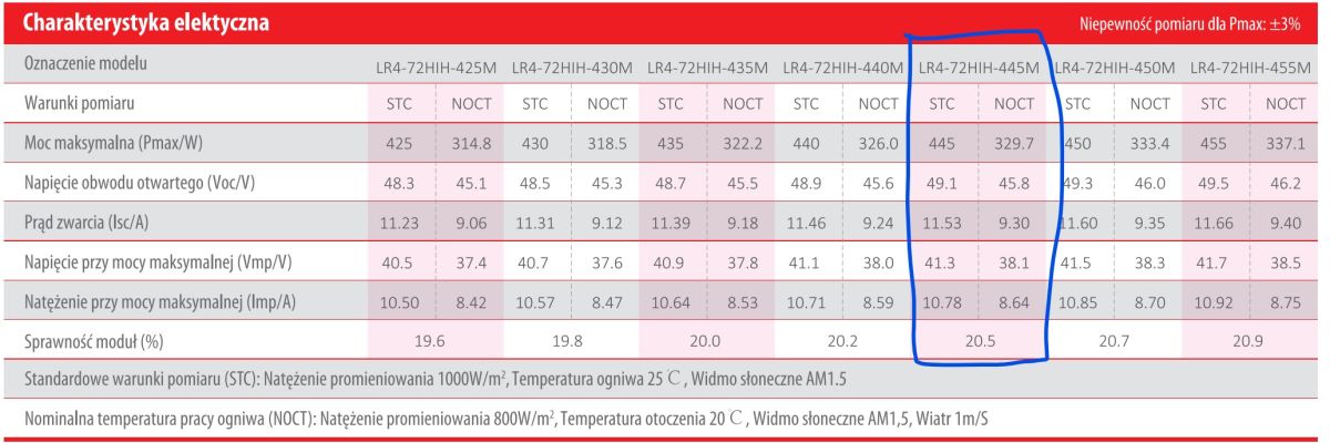

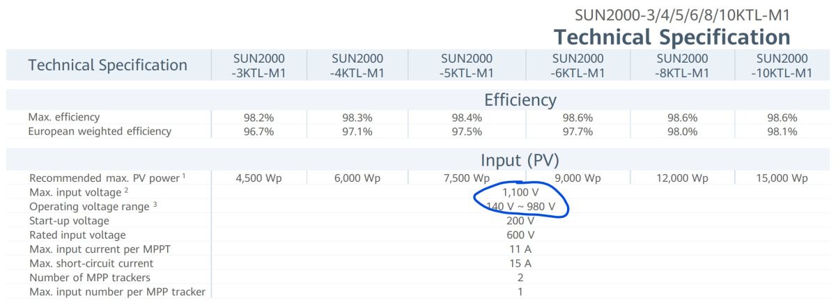

    #1340 21533297
    szczukot
    Posts: 826
    Help: 6
    Rate: 83
    A year ago I planned to expand the system but something "didn't work out"
    So I am back on topic
    Thanks to @velkhor I have learnt a bit and now a summary
    I have a Huawei SUN2000-8KTL-M1 + 16 Longi L4R-72HIH 445 W panels (or 7.1 KWh)
    Well I plan to add 6 of the same (or strongly similar) panels.
    22 * 445W = 9.8 KWh
    So the question is: can I add them in the same string ? It would always be easier for me because I don't have to pull cables.
    But I am not sure about these maximum voltage values.
    Table of technical specifications for Longi LR4-72HIH photovoltaic panels, 445W model column highlighted. .
    A technical specification table for Huawei SUN2000 inverters with the input voltage range highlighted. .
    At the moment I see these values on the inverter
    Screenshot showing inverter input voltage at 617.7 V and input current at 9.69 A.
    I understand that at max from the panel will go 41-42 volts ? So 42 * 22 = 924 and it is quiet ?
    ps. I know - at peak I will get max 8,8 KWh from this inverter anyway
  • String voltage likely exceeds inverter limit
    #1341 21563885
    qrko
    Posts: 153
    Rate: 34
    Hi. Anyone have experience of buying/selling a used SUN2000? I may be replacing with a larger model and am wondering how to approach the subject so that the eventual new user doesn't have any problems. I was thinking of setting up some sort of left email account, changing the address in FusionSolar to this new one and then passing this on to the buyer. The question is whether this is the correct process, whether it is better to somehow deregister the unit so the new owner can add it to their account and whether to somehow do a reset to factory settings. I have an installer entry if that helps with anything (and a local one with a password and a remote one via the cloud with the possibility of e.g. software updates).
    >>21533297 .
    I have very little experience, but nevertheless some, so based on that I will conclude that it won't work. That 42V you write about is the voltage under load. I have 2 strings of 12 panels each and in theory I should see 480-500V there all the time, however it is not uncommon for me to have as much as 550V there, if only when I have cut production in the inverter due to the grid voltage being too high. 550V/12=~46V, which in turn in your case x22 panels = 1008V. My parents had 21 450W panels on 1 string and it was giving so many errors that the next day the crew were breaking it into two strings.
