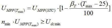

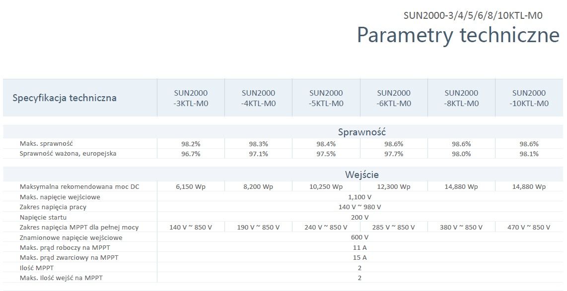

    Let me ask you in this thread, because I can see that only here you get specific answers from competent people.
    I have a question about Huawei inverters.
    I will assemble the Huawei Sun2000-5KTL-M0 inverter.
    The technical parameters for this inverter do not clearly describe the minimum MPPT value of the inverter, i.e. U dc min.
    Two values are given:
    1) Operating voltage range: 140V - 980V
    2) MPP voltage range for full power: 240V - 850V
    Huawei SUN2000 Inverter: WIFI Dongle Connection, Firmware Update & FusionSolar
    I mean the inverter voltage parameter for which it is calculated: "Minimum number of modules in the string due to MPPT of the inverter".
    From this formula:
    If we take the value: 240V for calculations, it turns out that the minimum number of modules in the string is 6.59.
    The company, on the other hand, offered me an installation consisting of 12 panels, 6 in each string. So 6 + 6. Is it not enough?
    If we take the value: 140V for calculations, it turns out that the minimum number of modules in the string is 3.84. Then the proposed number of modules in a string, i.e. 6 pcs, would be OK.

    The starting voltage of your inverter according to the data sheet is 200 V, now calculate how many planned panels should be connected in series to achieve the required value.
    Don't spread the same question over "all" renewable energy :) .

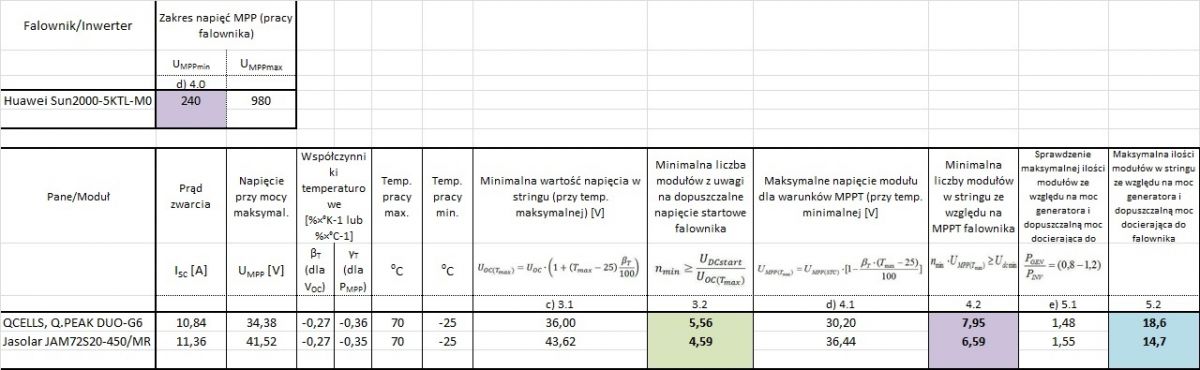

    Sorry for repeating the question. But I have editing tomorrow, time is running out for me and I don't know what to do.
    Of course, I calculated the minimum number of panels to get the condition of Start-up voltage 200V. It came out: 4.59, so 6 pcs will be OK.
    But according to the formula I have given, you should also check the minimum number of panels due to the inverter operating voltage range, and more precisely to the Minimum voltage value.
    According to the formula I gave earlier.
    And here the opinions differ, some say that I should use 140V, others say 240V.
    For 140V, 3.84 panels are enough.
    For 240V, as much as 6.59 panels are needed. And here 6 pcs will not be enough.
    People who believe that the assumed value of 140V is incorrect support it with, for example, the following statement:
    "But what will 140V give you when the inverter does not turn on because it will not see 240V?"
    Here are my calculations:
  • #36 18928925
    3301
    Posts: 2100
    Help: 224
    Rate: 869
    The quote is almost correct, because in fact at 140 it will not start, it needs more. 200
    Added after 13 [minutes]:
    So, when reading between the lines, I need more than 200, which is exactly at least 240V.
    3301 wrote:
    And you do not take into account the opinion of the contractor, after all, he should be sure that the installation will work and have comparable yields to those in the area, and not only work
    I take into account the contractor's opinion.
    Except that he did not mount these panels on Huawei but on Sofar, which inverter has a lower MPPT voltage. So 6+ 6 will work on it.
    He said that Huawei "should" take off. He wasn't making calculations. :-(
    However, now I know that Huawei will not start the 6 + 6 panel system.
    The starting voltage is supposed to be 200V, but the MPPT voltage is from 240V.
    The weaker Huawei 4kW inverter would work without any problems in the 6 + 6 system.
    It needs 200 volts to take off, not 240 volts, in the range 240 volts - 850 volts it reaches its best performance.
    You have not written what panels Voc have.

    rokbok wrote:
    The panels are: Jasolar JAM72S20-450 / MR
    Parameters under STC conditions
    - Open circuit voltage Voc: 49.70
    - Voltage at maximum power point Vmp: 41.52
    Parameters under NOCT conditions
    - Open circuit voltage Voc: 46.90
    - Voltage at maximum power point Vmp: 39.19
    Using this formula, I calculated that: The maximum module voltage for MPPT conditions is 36.44V, and 6.59 panels are needed to achieve the required 240V. :-(
    So it follows that in a 6 + 6 system, they will rarely / or almost never work in the range of 240V - 850V and will not achieve their best performance.
    I was even suggested to install 2 additional panels in a 6 + 8 (east-west, because the west part is more south-facing). But this is still 6 panels on one string (East) which will not go into the 240V - 850V range and not achieve its best performance.
    So, would a 7 + 7 panel layout be the correct and only correct solution?

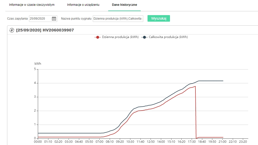

    rokbok wrote:
    Go to the inverter and try like this:
    1. Log out of FusionSolar
    2. Turn off data transmission on your smartphone
    3. Find the inverter WiFi network on your smartphone and connect to it (you have the SSID on the side of the inverter)
    4. Click in the top right corner of the FusionSolar login screen (three dots)
    5. Select "Putting the device into operation"
    6. Scan the QR code on the side of the inverter
    7 Enter the password: 00000a and you are in the settings.
    Managed to! However, they left the password the default.
    But I haven't found too many interesting things here ... I still don't know how I could change the data I see, for example, at https://eu5.fusionsolar.huawei.com
    This means, for example, I have a shift by an hour on the chart - now it is 4:00 p.m. and on the chart it gives me production from 5:00 p.m.
    Can this page also be accessed with installer permissions?
    How is my account linked to the inverter? In the inverter settings, I did not see any ID number or anything similar, so that the data sent from my installation will be linked to the correct account on FusionSolar ...

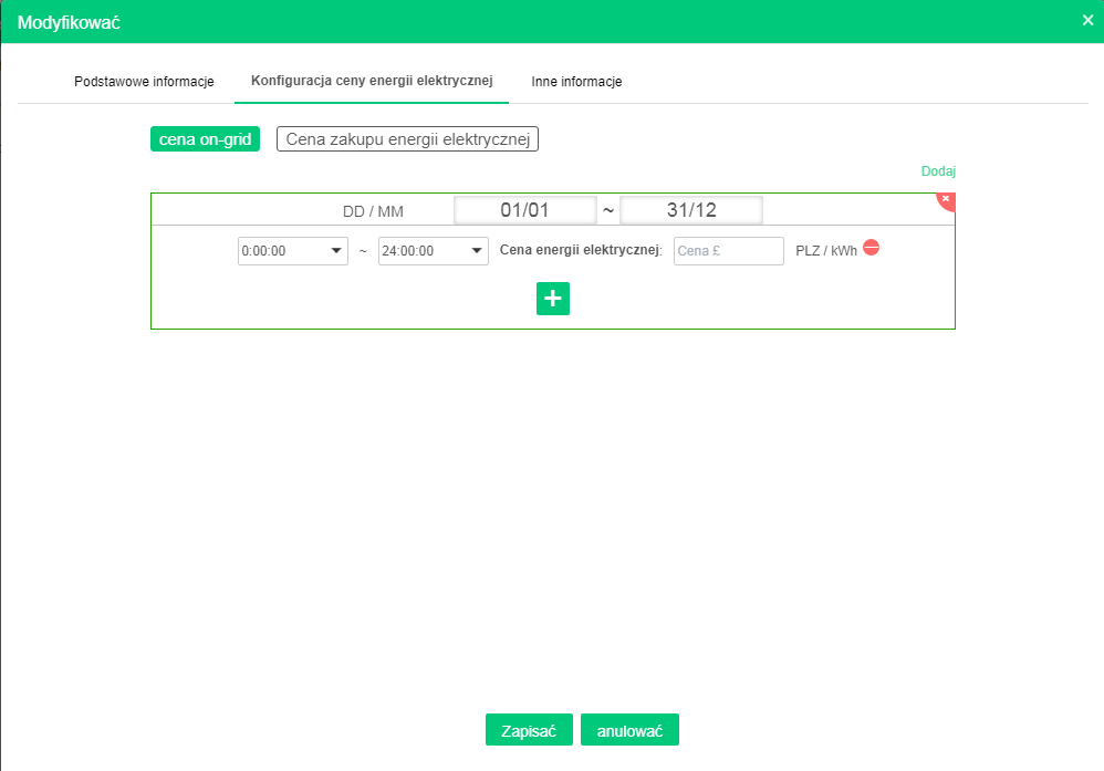

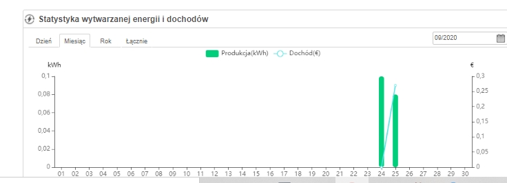

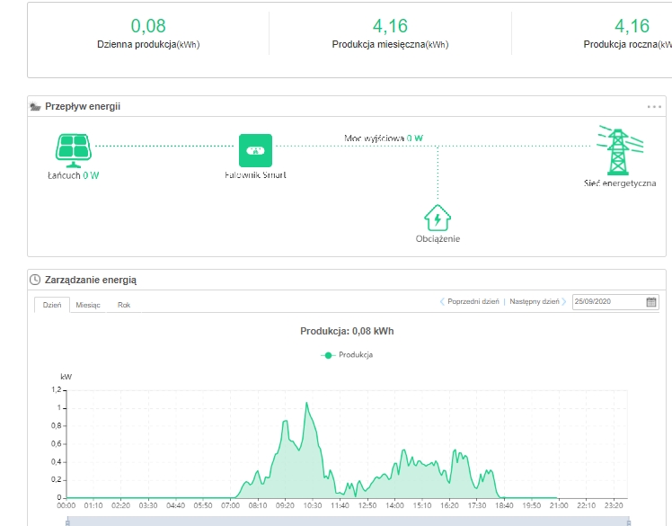

  • #42 18929981
    rokbok
    Level 40  
    Posts: 4384
    Help: 646
    Rate: 1027
    dprzyb wrote:
    I have an hour shift there on the chart - now it is 4:00 PM and the chart shows me production at 5:00 PM.
    I do not know what permissions the installer gave you and what you have access to on the web version on the website you provided, for me it is like this:
    1. I log in to the website https://eu5.fusionsolar.huawei.com
    2. At the top, in the tabs, I have Settings
    3.Click on the Settings tab - the System settings / Account settings window should be displayed with your data, user name (partially asterisks), avatar (if you have added one), password (stars), telephone number if you have entered, e-mail address (partially stars)
    4. Click in the menu on the left in Manage the installation, give a tick next to the name of your installation and click on modify at the top right, a new window called Modify will appear,
    this box will / should contain information, the name of the company that installed the installation, the name of the installation, installation capacity, date of connection and some information such as Installation without social purposes
    5. At the top, in the Configuration of the electricity price tab, you can define the price, transmission separately, energy separately
    6. In the Other information tab you can set the time zone so that it shows you correctly on the charts.
    If you do not have these options after logging in, press the installer to give you the appropriate permissions.

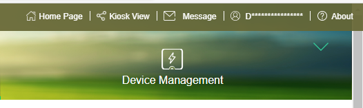

  • #43 18938637
    dprzyb
    Level 22  
    Posts: 504
    Help: 36
    Rate: 119
    So I should be seeing these settings somewhere here?

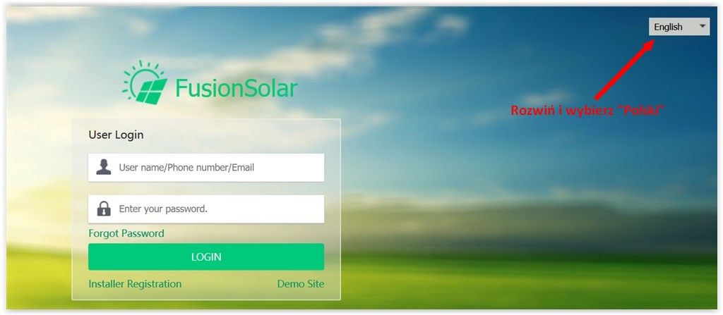

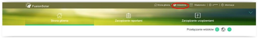

  • #44 18938758
    rokbok
    Level 40  
    Posts: 4384
    Help: 646
    Rate: 1027
    On the login screen, select Polish language support, unless you prefer EN.
    Then, as indicated in the picture below, select "Settings", then, as I described earlier, if you do not have the "Settings" button, ask the installer for an interview and explain what you mean.
    Everything is clear :lol:
    After logging in, I am immediately on the page with the preview of my installation and in the tabs I do not have the settings, only "Kiosk view"
    And today I clicked in the tabs on "Home" and the settings appeared (which I had not noticed before because I rarely opened the home page)
    So thank you for your help and guidance to solve the problem :D

    For an acting user (because he is asking), what and how to enter in the "Configuration of electricity prices" tab?
    in your earlier post you wrote:
    I do not see: "transmission" and "energy" only: "on-grid price" and "purchase price ..."
  • #53 18942184
    rokbok
    Level 40  
    Posts: 4384
    Help: 646
    Rate: 1027
    I have a slightly different screen / window
    In the Electricity price tab I entered distribution, in the Electricity purchase price tab I entered the energy price, did I do it right, I don't know, there is no explanation anywhere.
    I also learned about the possibility of changing the currency name from EUR to PLN and so far it is not possible, but it's just a name.
  • #54 18942582
    Math13
    Posts: 112
    Rate: 34
    I am trying to analyze it and harmonize it somehow.
    If the applications work on the same principle, they only have a different description of "appropriate-same" windows, then maybe it should be interpreted as follows:
    1) Price of supplied energy (with you) = Price on-grid (with me). It means the price of energy / electricity that we give to the grid. That is the price for the surplus we sell. If, of course, such a price is specified e.g. in the contract and appears on the invoice.
    2) The purchase price of energy (with you and me). It stands for the total price of electricity / electricity that we take from the grid and it consists of the price of electricity and the payment for distribution services.
    How do you think?
    It's just that if we do not have a meter (DTSU666-H) installed, does entering these prices show something to us in the application? And does it serve anything?
    In the FusionSolar application, I can only see one power output from the inverter (split into load / house and grid / power consumer). The current is either produced by the inverter and flows from it to both loads mentioned, or it is not produced by the inverter and is zero. I have never seen the application show that we are taking electricity from an external network.
    So, how is the application supposed to know how much we give and how much we download? and somehow illustrate it to us in relation to the prices that we entered in the "Electricity price configuration" tab.
    How do you think?

  • #56 18942859
    e_tomi
    Posts: 30
    Hello. For 2 days I have been the owner of a PV installation with the Huawei SUN2000-5KTL inverter. The installer set up an owner account for me on FusionSolar. Today I noticed that on the daily production chart there is a reset at 5:55 pm. As if the daily production was counted from 5:55 pm to 5:55 pm, not from midnight to midnight. Yesterday it was also at 5:55 pm
    Huawei SUN2000 Inverter: WIFI Dongle Connection, Firmware Update & FusionSolardzienna pr...dukcja.jpg (87.96 kB)You must be logged in to download this attachment.
    The chart below shows the daily production despite the fact that the result is 0.08kWh, and by about 6 p.m. it grew to the value of about 3.77 kWh.
    Huawei SUN2000 Inverter: WIFI Dongle Connection, Firmware Update & FusionSolarwykres ...jpg (101.28 kB)You must be logged in to download this attachment.
    Even though my total production is 4.16kWh, it shows me from Sep 24 on the monthly chart for these two days. 0.1 kWh and Sep 25 0.08 kWh, which is as if only counting these performance after 5:55 pm.
    Huawei SUN2000 Inverter: WIFI Dongle Connection, Firmware Update & FusionSolarwykres.jpg (35.95 kB)You must be logged in to download this attachment.
    I suspect that the device is functional and the problem is somewhere in the settings, but from the owner level, I do not have such permissions.
    Which of the settings is responsible for this?
    If I create an installer account, will I be able to add this inverter to this account, even though it is already added to the account of the person who installed the system.
  • #57 18942913
    You won't create, read post # 49
  • #58 18942933
    e_tomi
    Posts: 30
    Oki, I think I've already solved the problem. I read and followed the procedure from post # 32. After logging into the inverter, there was immediately a message about the time difference between the phone and the inverter. The time on the inverter was 4:14 on Sep 26. I set the time to the current one. There was an option to set up time synchronization with the NTP server. Set it up?
  • #59 18942937
    rokbok
    Level 40  
    Posts: 4384
    Help: 646
    Rate: 1027
    Set it, you can always undo it.
