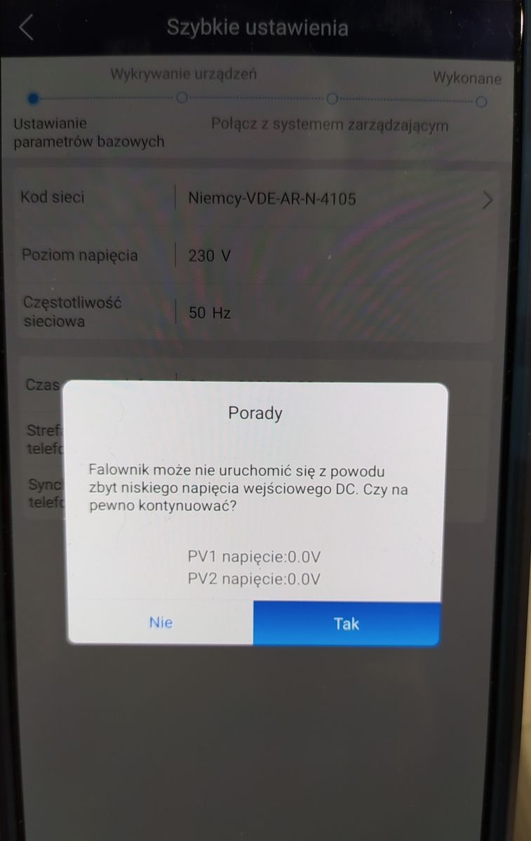

    The problems with the application have been mastered, but I still have a problem with the first start-up, the inverter shows no voltage on the DC side, where the measurements show that everything is OK Huawei SUN2000 Inverter: WIFI Dongle Connection, Firmware Update & FusionSolar

    Did you turn on Hebel DC in it?
  • #79 19098511
    Zanoborek
    Yes of course
  • #80 19098529
    rokbok
    Level 40  
    Posts: 4384
    Help: 646
    Rate: 1027
    Do you have the option of measuring the DC voltage at the input to the inverter? E.g. on the surge voltage, the base of the DC fuses, if there are any, or the DC switch if you have installed one, if there is the appropriate voltage there, and the inverter continues to report an error, you should look for the cause in it.
    Otherwise, look for a problem in the panel connections and cables going from them to the inverter, MC4 connectors, or whatever else you have.
  • #81 19098539
    Zanoborek
    Welcome
    Measurement with the inverter turned off shows 279 V, and when the inverter is turned on, the measurement is 1.3V
  • #82 19098554
    rokbok
    Level 40  
    Posts: 4384
    Help: 646
    Rate: 1027
    Disconnect the DC cables from the inverter and then measure the voltage, as it will be appropriate for the inverter to start, and it does not, look for the reason in the inverter, report to the installer how you did the installation yourself, then advertise where you bought it, if you can get advice from the official distribution Huawei.
