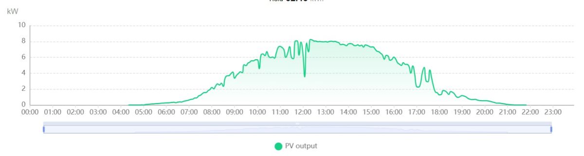

  • 8 kW inverter appears to clip at rated output
    #1353 21586684
    szczukot
    Posts: 827
    Help: 6
    Rate: 83
    Well. I have connected the additional panels. It's almost 10 kW.
    Well, and the first day shows me a graph like this.
    Huawei SUN2000 Inverter: WIFI Dongle Connection, Firmware Update & FusionSolar .
    The inverter is 8kW. But supposedly there is this 10% in the documentation. Here you can clearly see the cut-off at 8kW. How is it with this spare 800W ?
    ps. And by the way, when reporting to ENEA, should I specify 8 kW or 8.8 kW ?

    >>21586684 Somehow on this graph the cut off doesn't show. Here you have the cut off, mine has 3 and cuts off at 3.3. As for Enea, you report as much as you have in the panels.

    At these air temperatures (around 30 degrees), the efficiency of the panels drops sharply. The cut-off is easiest to observe on a frosty, sunny day such as March, unless you have significantly oversized panels.

    It is possible that someone changed from max 8.8 kW to 8 kW in the settings. Some good fellow installer. :D

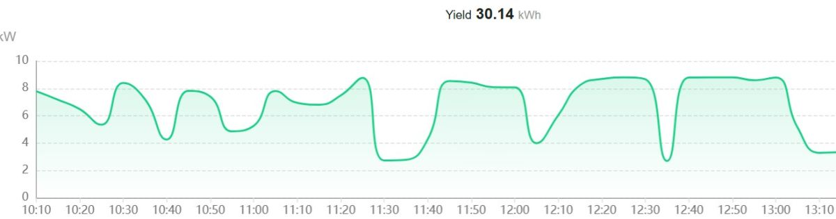

    Well.
    Today you can see the cut-off at 8.8 kW
