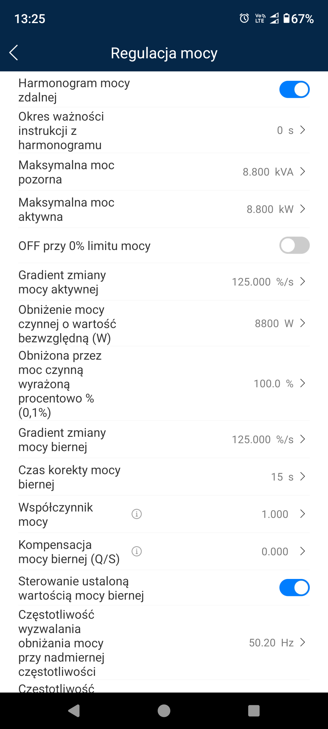

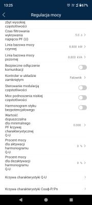

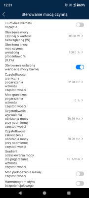

    >>21212484 .

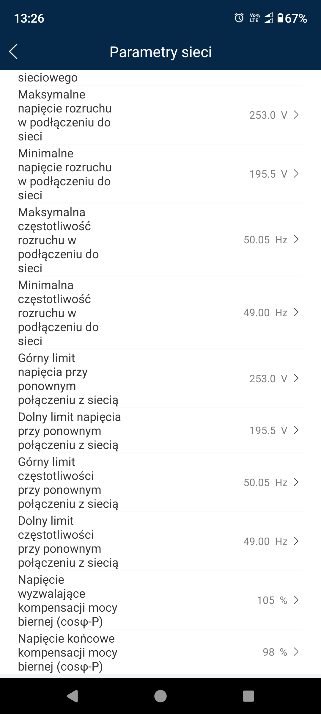

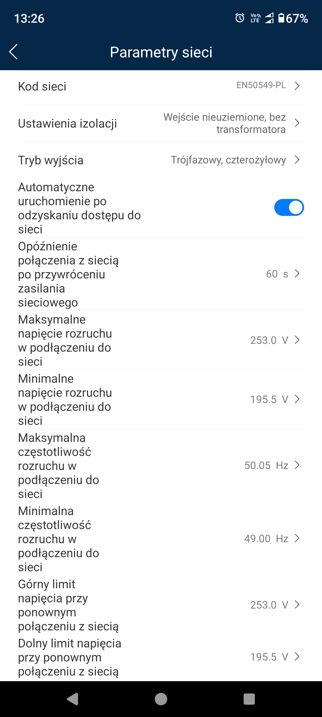

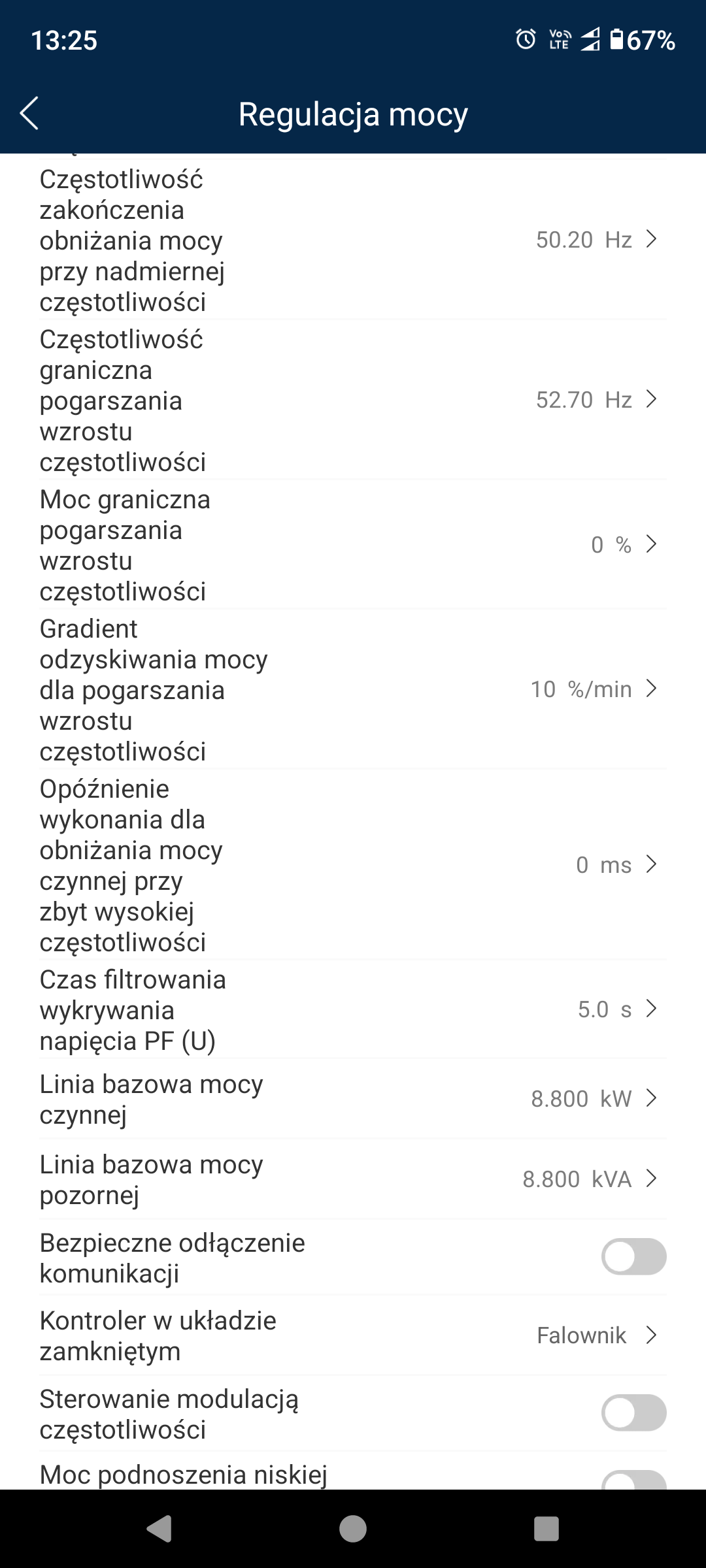

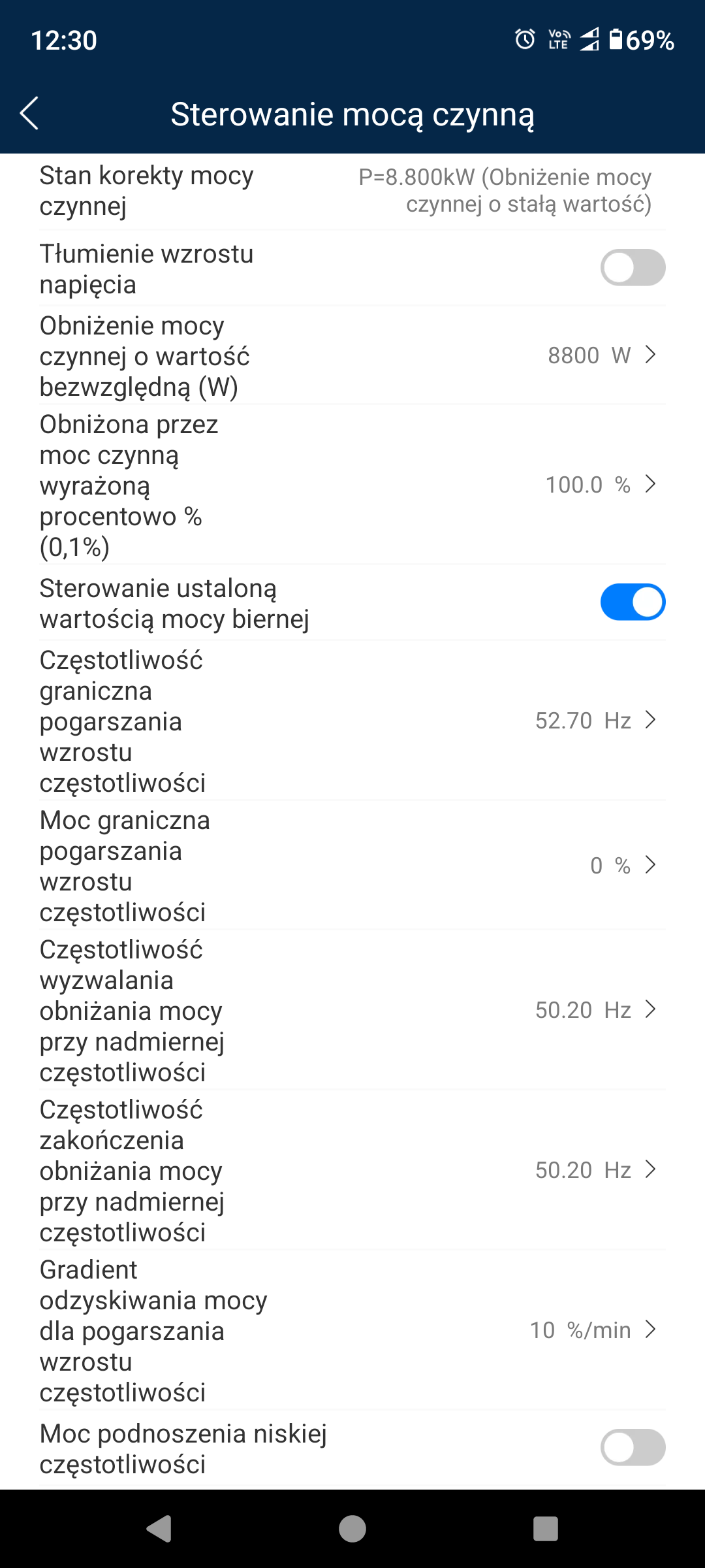

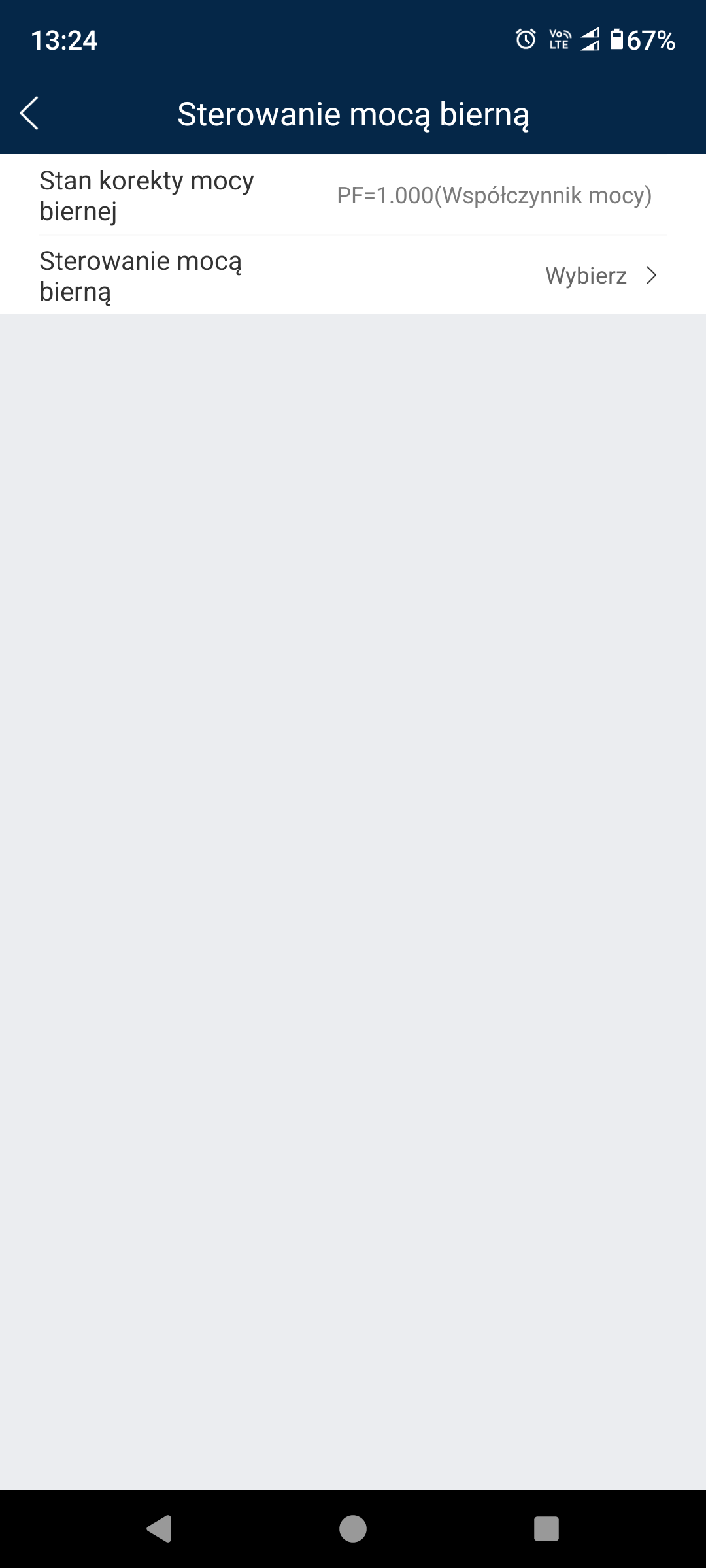

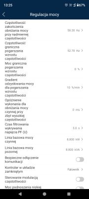

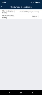

    I looked in the app - no, there is no compensation, in the sense that 1 seems to have been entered. But I can still check that.
    Or I can enter manually in the web panel, only I don't know what value, because the range I have is [-5,280~5,280] kVar ? When I click "default setting" it says: "enter correct correction value".
    As for the graph, I know that on www - but where exactly?
  • #1292 21212498
    mateos2
    Posts: 153
    Rate: 8
    >>21212486 .
    monitoring -> select inverter on the left and historical data on the right
    for the reactive power settings - simply upload the screenshot from the same place, but select on the right - configuration
  • Asking which phase voltage and current graphs to select
    #1293 21212521
    webonek
    Posts: 66

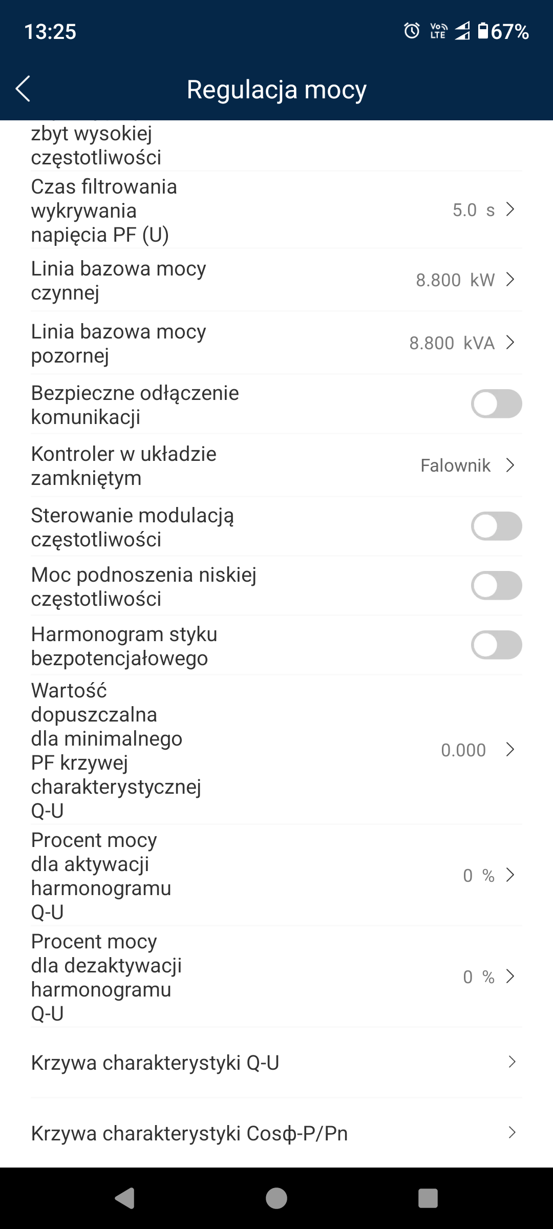

    And that's where I was, only that it only displayed active and input power. Any specific parameters to select, as I see the list is - for the graph? I have a choice of phase voltages A,B,C and amperages A,B,C. I can select either just the voltage or the amperage.
    Screenshot of the active power control settings menu on a mobile device. Screenshot of active power control settings in a mobile app. App screen for reactive power control showing correction status and selection option. Power regulation settings screen in an app showing various parameters. Power regulation settings screen in an app showing various parameters. Power regulation settings screen on a phone with various parameters and options. Screenshot of power regulation settings in a mobile app. Screenshot showing electrical network parameters settings on a mobile device. List of electrical network parameters on a phone screen. List of electrical network parameters on a phone screen.
  • Signal point selection reveals the missing display option

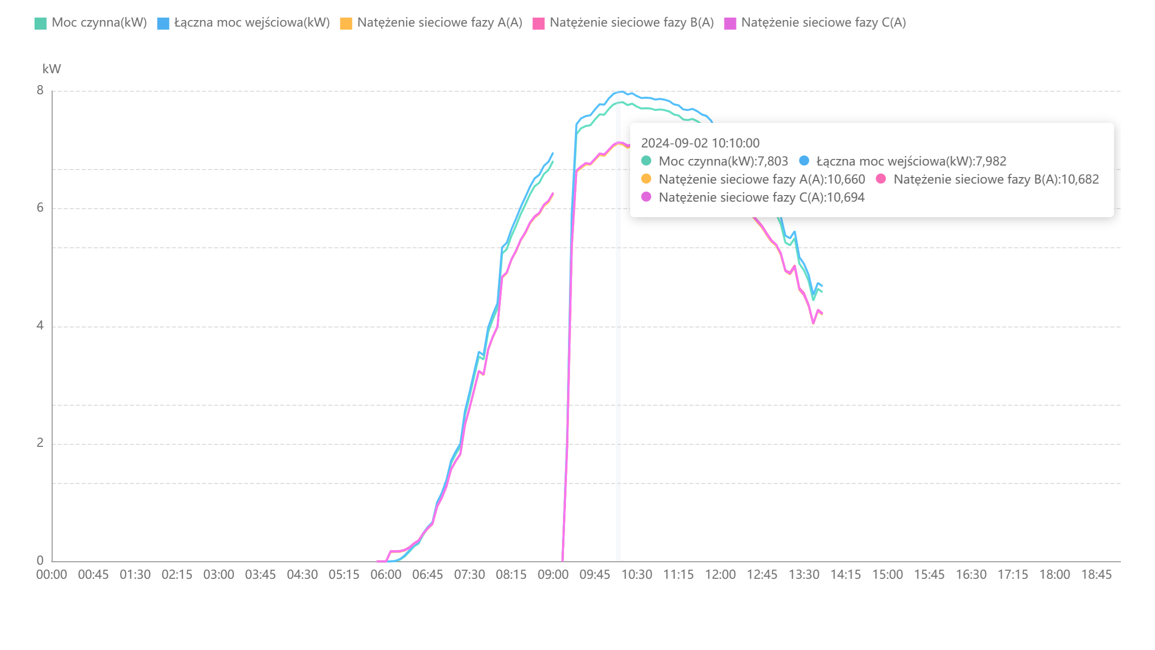

    Where I have "signal point" on the right it says "selected2". But as I wrote - the active and input power graph appears. I asked - what should I look for or what should I mark? And you don't write anything about what to do with what I see - should I include the active and input power graph or was it also about the currents though...? As I develop the list, I have - as I wrote above: phase ABC and current ABC. And what...?
    Such a graph...? This is from today - this break is my handwritten one.
    Graph of active power and network currents for phases A, B, and C. .

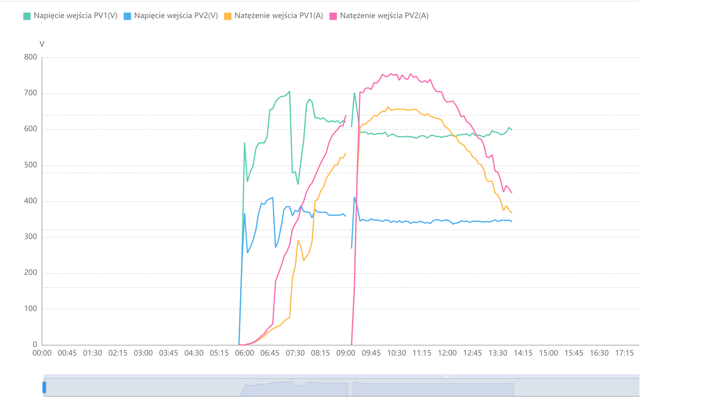

  • #1297 21212563
    webonek
    Posts: 66

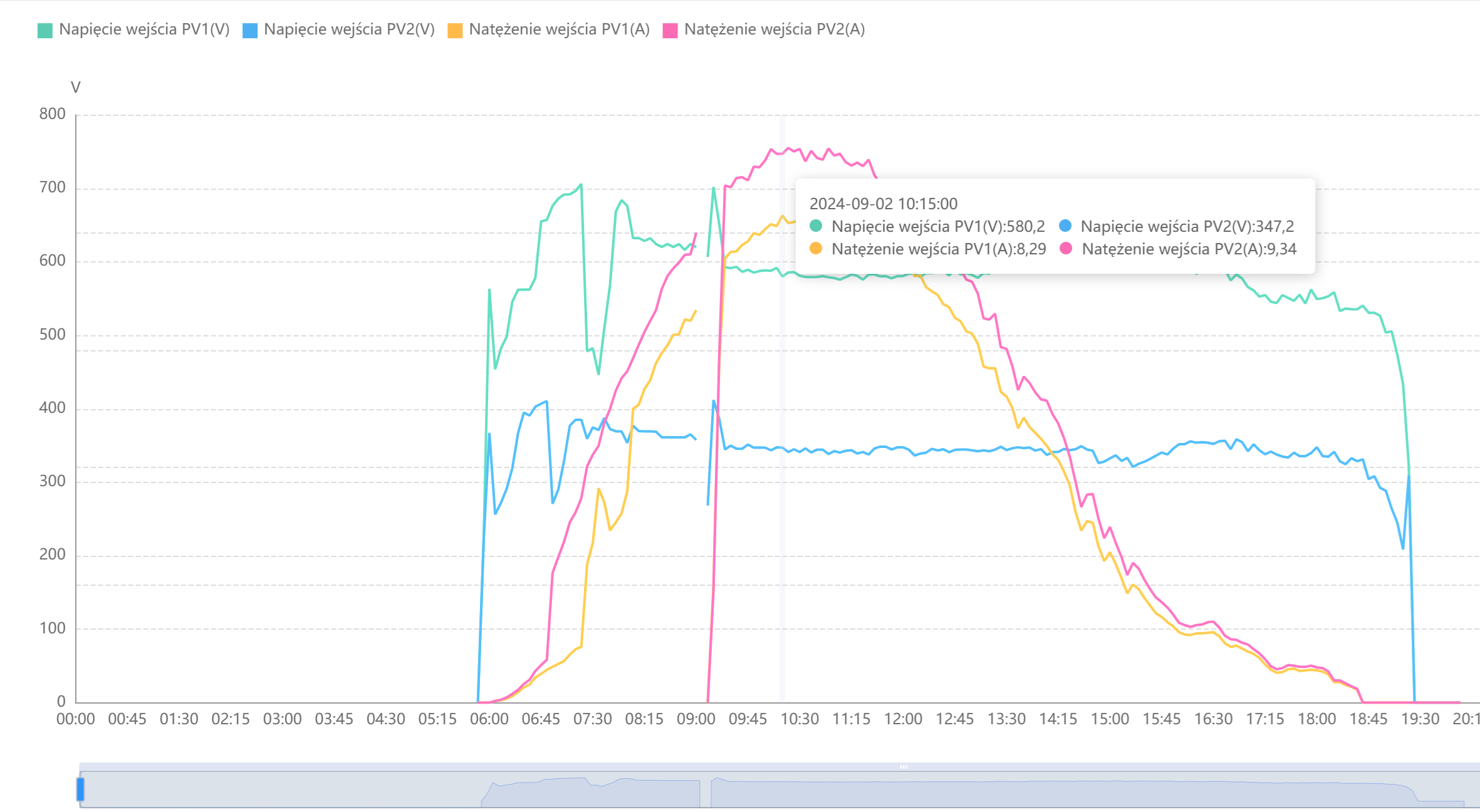

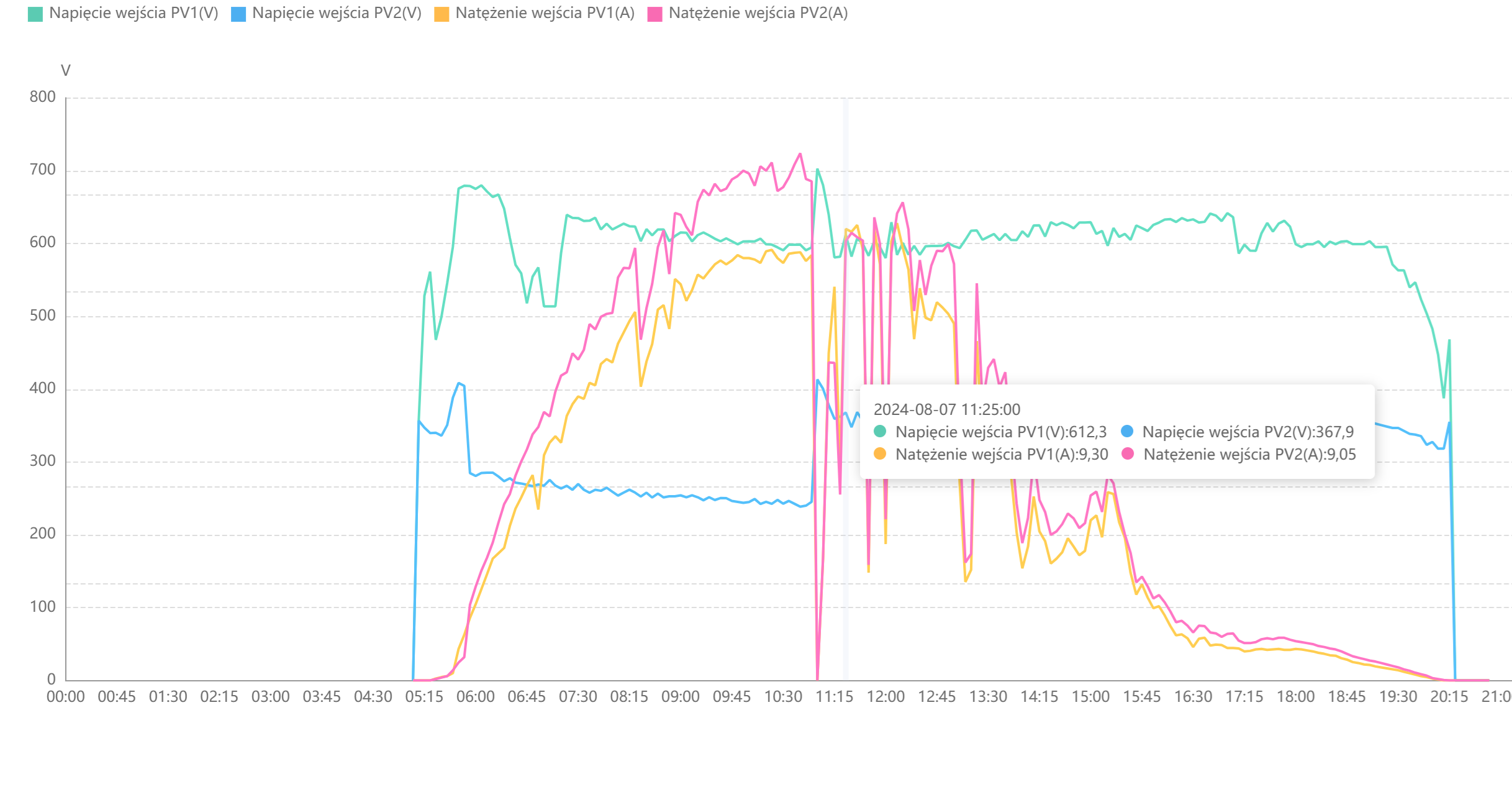

    And you see...! I didn't have a swipe bar, so I didn't know this list could be swiped - my bad, even though it's so out of touch with Huawei's site, for first time visitors. It wasn't until you wrote that it helped :) .
    The graph shows changes in voltage and current for PV1 and PV2 inputs over time.

    in my opinion you have shadows on the panels
    and tell me - don't you have an 8KTL-M0 inverter?
  • Cloudy-day graph suggests no shadow effect
    #1299 21212575
    webonek
    Posts: 66
    Well, but there is no shadow just :( Additionally - it was pouring yesterday, so even if some dirt, it would have washed off a bit. And is the shadow indicated by this wrinkling of the graph or something else?
    I have a SUN2000-8KTL-M1 - and why do you ask?
    Here's another graph from a month ago - marked where there was a peak of 8.79 kW for a while at 11:25 a.m. But it was cloudy then, as you can see from the graph. Maybe this will help something:
    Graph showing voltage and current input for PV1 and PV2 with reference to time. .

    Show a graph from a day when there were no clouds at all but sunshine all day
    8ktl-m0 on 300V could not give full power on mppt
  • Miswired panels lowered PV2 voltage below optimum

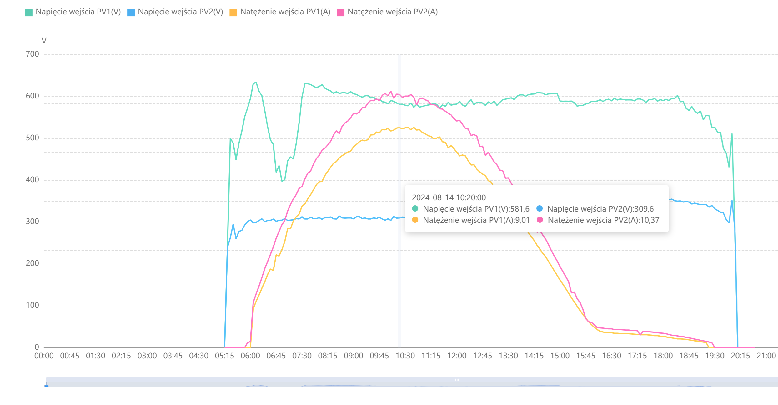

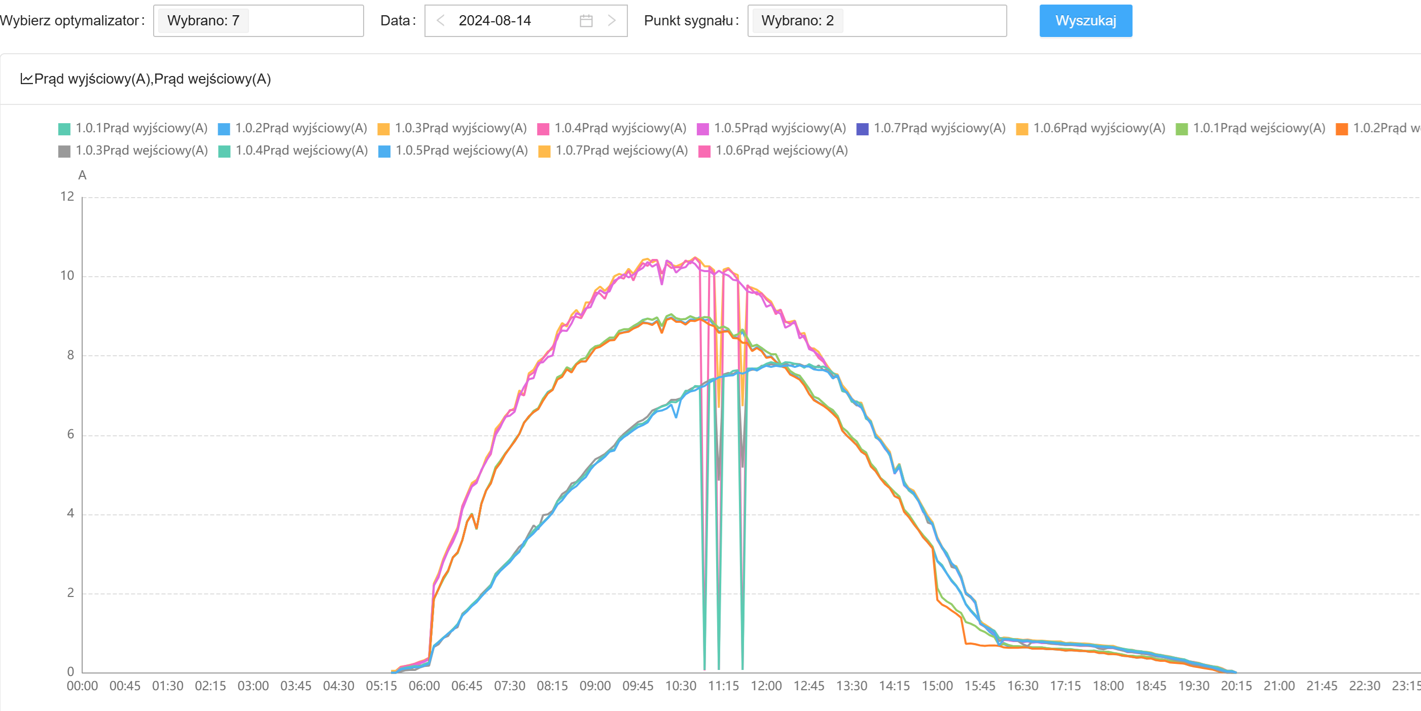

    Please. Maximum peak 8.1-8.2. But here there were 2 panels less on PV2 (375W), because the 2 pcs. 375W the team mistakenly connected to PV1 (325W). Therefore a voltage of 309V below the minimum optimum of 315V for PV2. Panels seemingly connected incorrectly, voltage too low, but.... the current became quite high, however.
    Graph showing the input voltage and current of two PV panels throughout the day.

    #1302 21212612
    mateos2
    Posts: 153
    Rate: 8
    >>21212603 .
    it all works correctly - curious about the gap

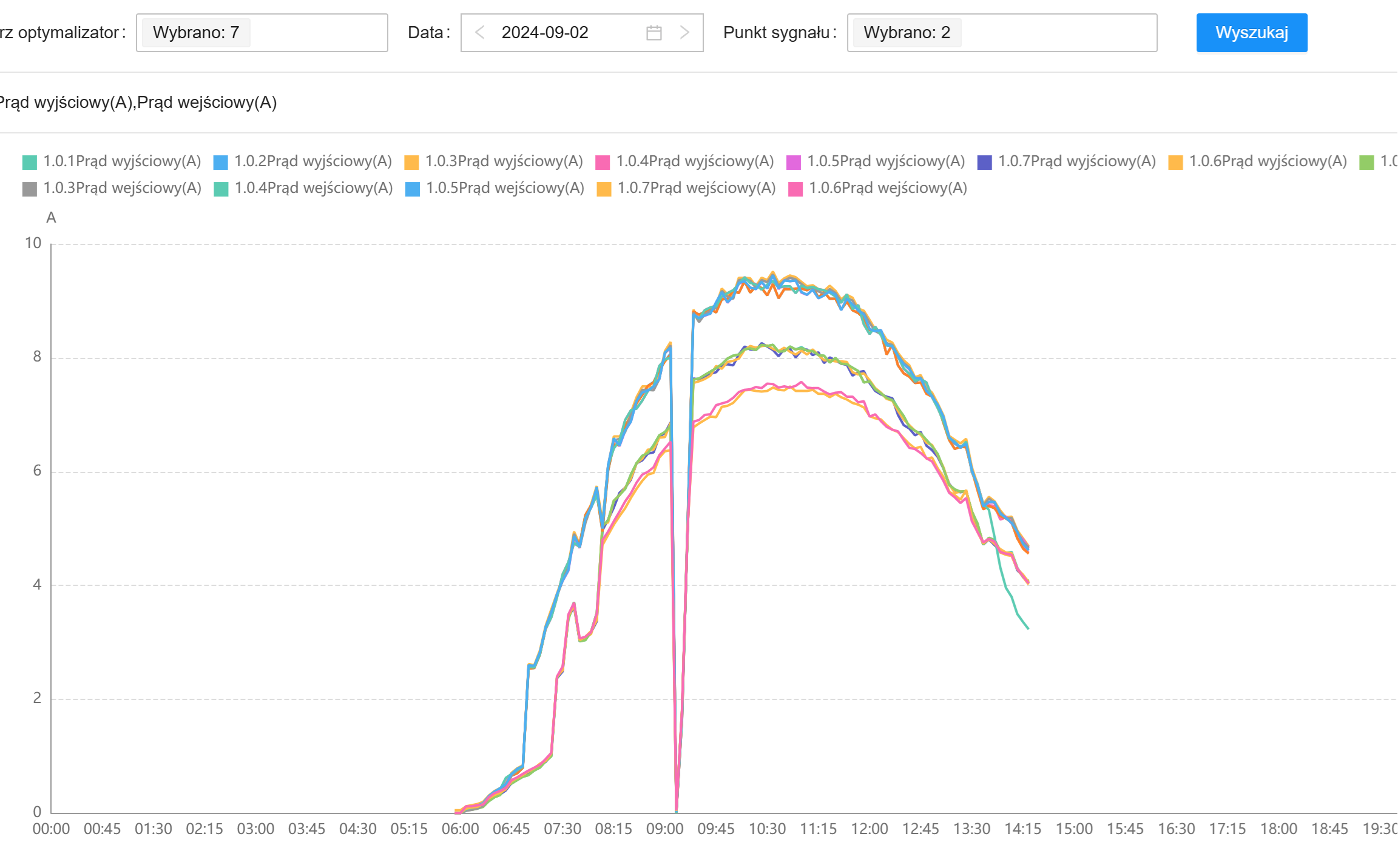

    on the left under the inverter you have the option "optimisers"
    select it and similarly make the historical data (current) for all the options
    you also did not write how exactly the distribution looks like
    eg string 1: 16*panel X + 5 opts; string 2: 11*panel Y + 3 opts
    The optimiser works as follows
    changes the input voltage and intensity so that the output intensity is the same as the other panels, and the voltage is arbitrary
    if you have partial optimisation it may not work perfectly

    Graph of input and output current of a photovoltaic system on August 14. .
    Graph of output and input current from various optimizers in a photovoltaic system.
    One from a month ago, and the one "snapped" from today with the inverter's manual shutdown.
    PV1 is 19x325W - 3 optimisers: no 1, 6 and 7.
    PV2 is 11x375W - 4 optimisers: nos 2-5.
    Optimisers older P and newer P2.

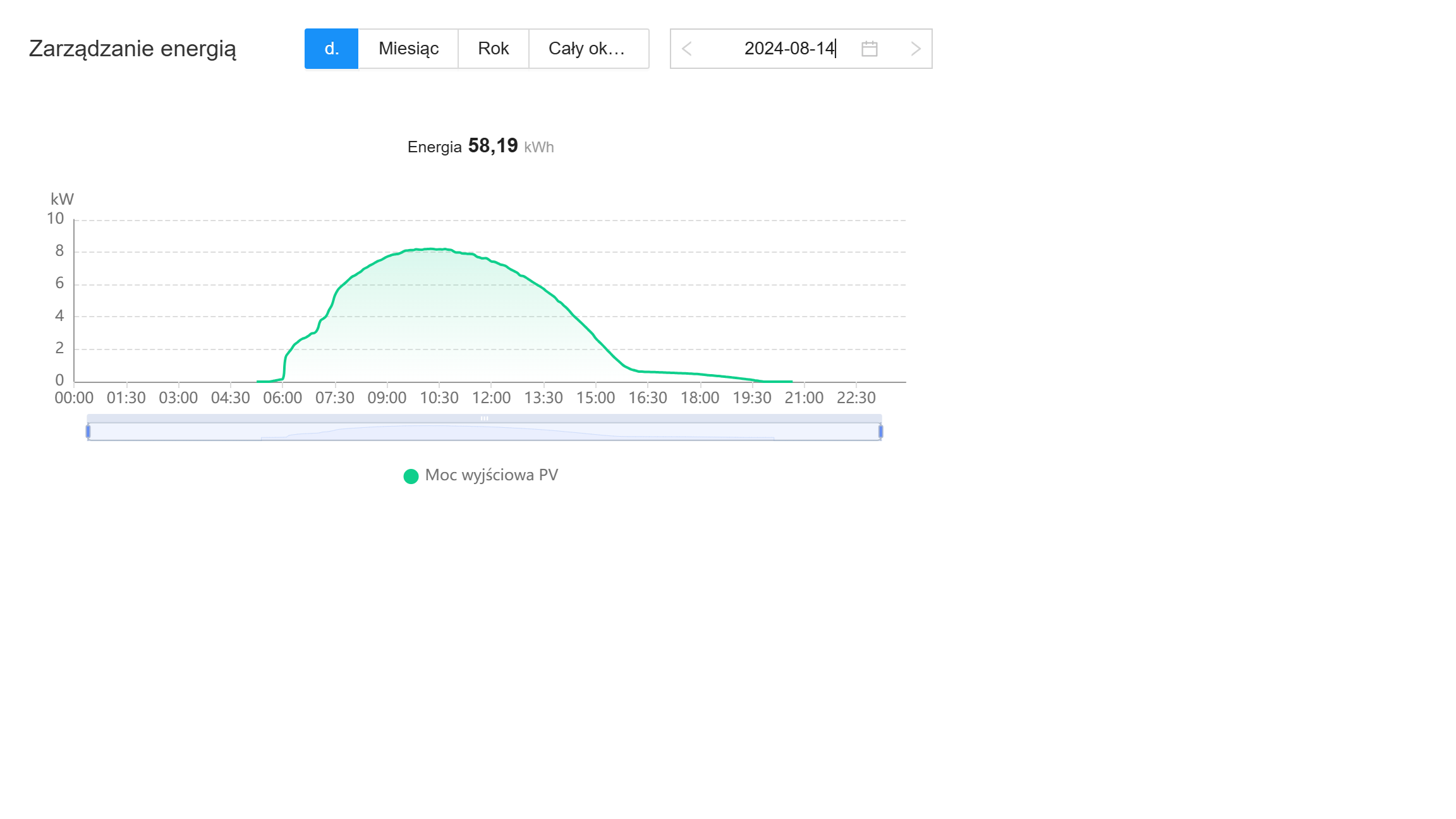

    Strange this drop from 14.08 if the power graph is like this:
    PV output power chart from 14.08.2024. .
    There was a lot of this (changes), but I think at the time there were temporarily 3 PV2 panels lying flat (14.08) on the roof to the north temporarily with 3 optimisers, also it was cutting off even 17V on the panel at the worst moment. Well, but the current was getting made nonetheless.
    Now they are all facing the same way - but only recently. I gave the 14.08 chart because the sun was out all day then.

    You can't plug in less than 6 Huawei optimisers on a single string - it stands like a bull in the data sheet.

    but can you show us the measurement report made by the installation team at the end of the work? the commissioning report? and where did you get the 375W panels from? because they are PV2 and as far as I can see they have a lower current than the old panels - it should be the other way round

    on PV1 you have panels with Impp 9.57A
    on PV2 you have panels with Impp 10.87A
    the current graph on PV2 should be 13% higher than on PV1
    (or even more, as the panels on PV1 are 3 years old)
    this is not the case - so either miraculously on PV1 you have panels 15% more powerful - almost impossible
    or on PV2 you have panel(s) that do not have the parameters
    in 95% you have either defective panel(s) or counterfeits
    do you have their serial numbers to check the originality?

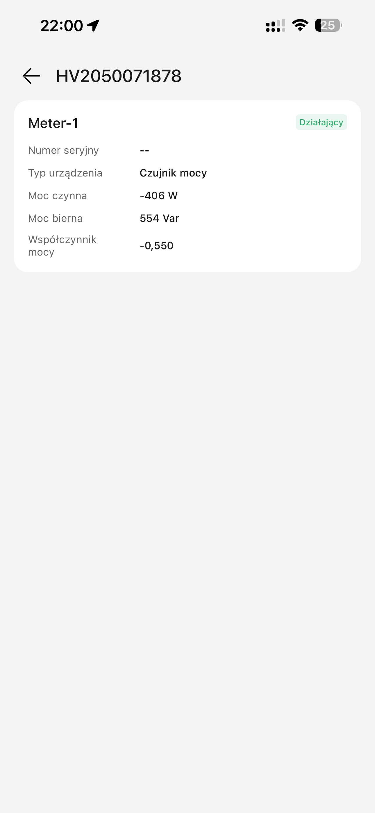

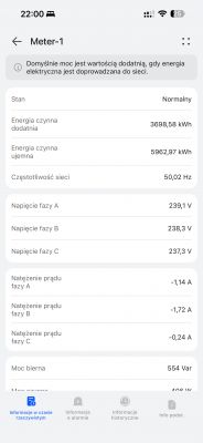

  • Home screen consumption display stopped after update
    #1313 21213205
    symeks
    Posts: 79
    Help: 12
    Rate: 18

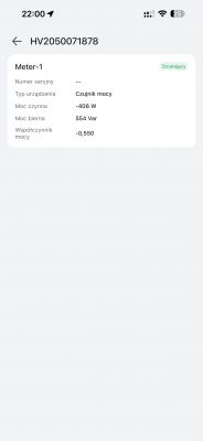

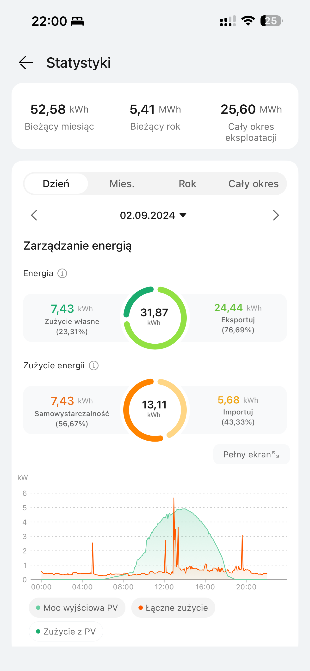

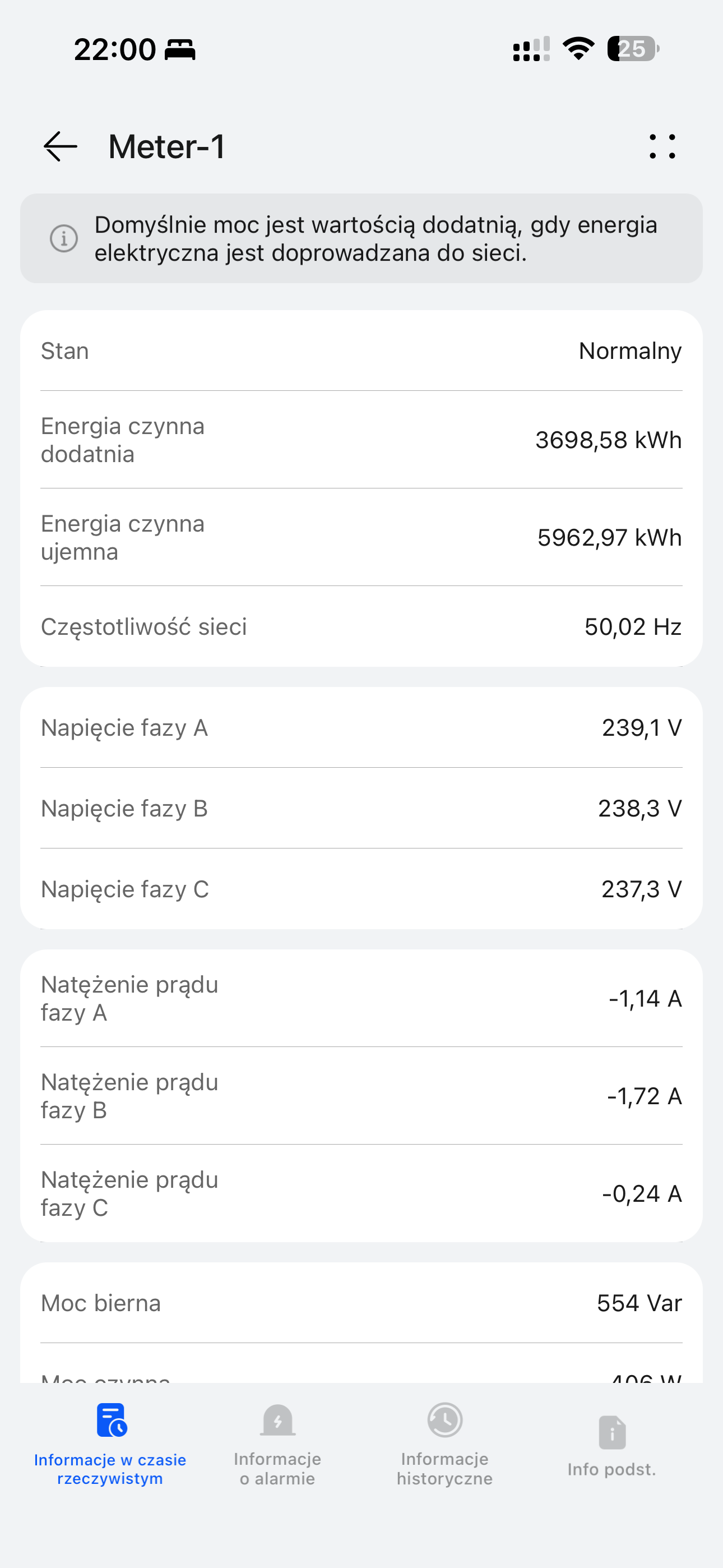

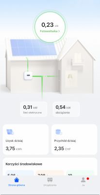

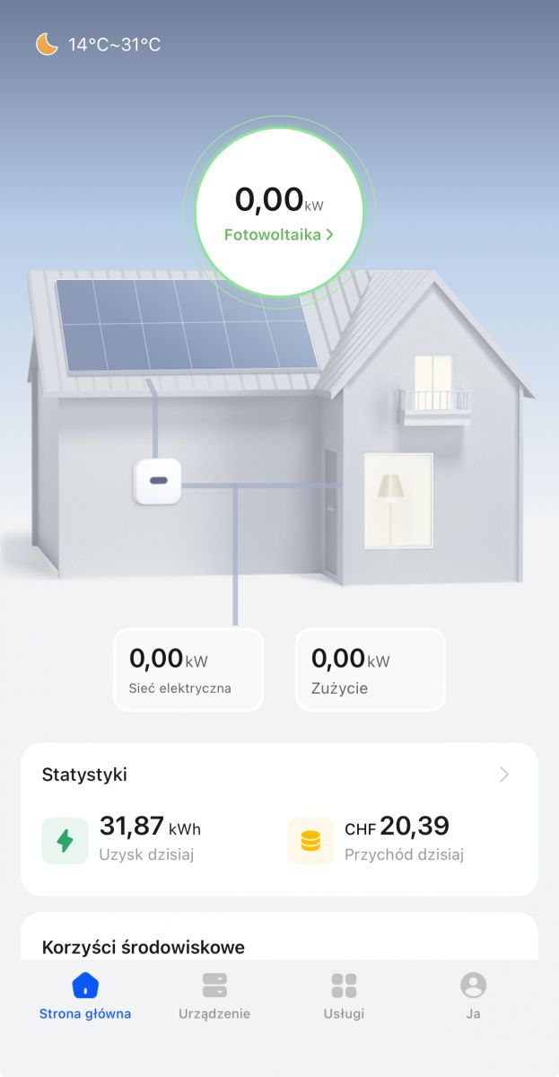

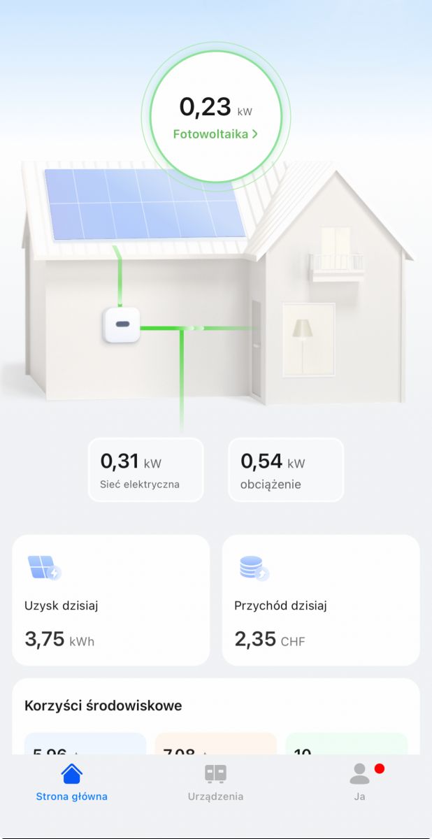

    Hi all. Some time ago I added a meter to my inverter and in the app, the home screen was showing the current consumption. I don't know when it stopped working, but when I go into the statistics it shows how much energy I have used. Does anyone know if there may have been an update along the way that may have broken this?
    Greetings
    Edit
    I've added a pic of how it was showing just after starting the meter.
    Screenshot of an app measuring solar panel energy, showing 0.00 kW consumption and production. Screenshot of an energy management app showing consumption and export statistics. Screenshot of an inverter monitoring app showing energy consumption data. App screen showing power sensor operation data. App screen showing power sensor operation data.
    Screenshot of an app for monitoring photovoltaic energy usage. .
  • #1314 21213232
    mateos2
    Posts: 153
    Rate: 8
    >>21213205 .
    update the app or wait
    Zeroes also show when the dongle loses connection to the server
  • #1315 21213240

    mateos2 wrote:
    >>21213205
    It also shows zeros when the dongle loses connection to the server
    That's what I thought, but why does it show consumption after entering the graph?
  • #1316 21213272
    mateos2
    Posts: 153
    Rate: 8
    >>21213240 .
    Because the graph generates from historical data and missing 5 minutes of data is not even noticed
    And the main page shows the last 5 minutes of data

    I've done all possible updates, the inverter doesn't show that a newer version is available. And every time I check it is just zeros on the main screen. Is there a newer version? Screenshot with inverter model and software version information. .

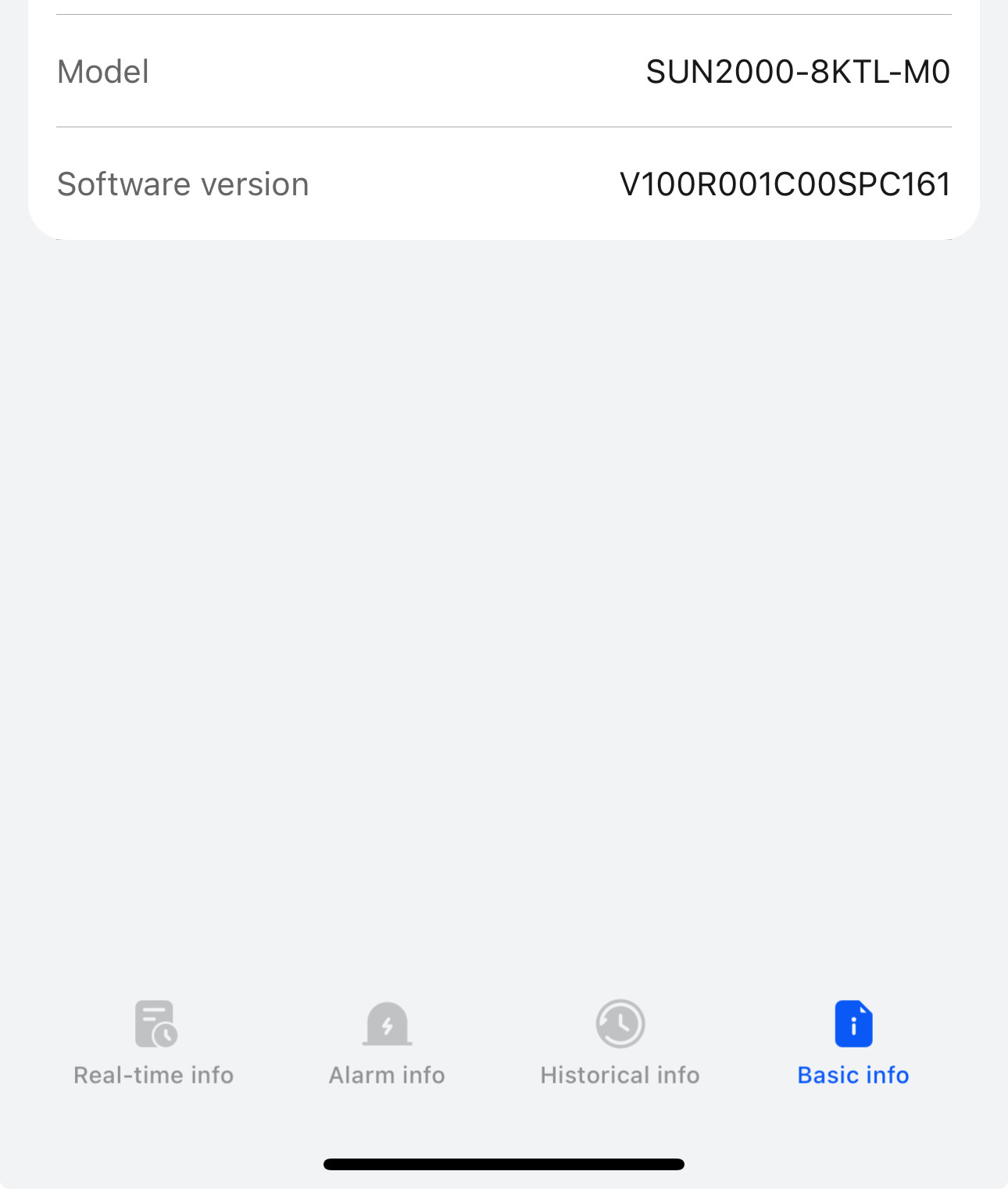

    • Huawei SUN2000 Inverter: WIFI Dongle Connection, Firmware Update & FusionSolar IMG_4971.jpeg (70.78 KB) You must be logged in to download this attachment.
  • #1320 21214285
    webonek
    Posts: 66
    >>21214277 .
    But where specifically does it show you that there is no newer version - because on me on the same but M1 is the latest version 165 and on you 161?
