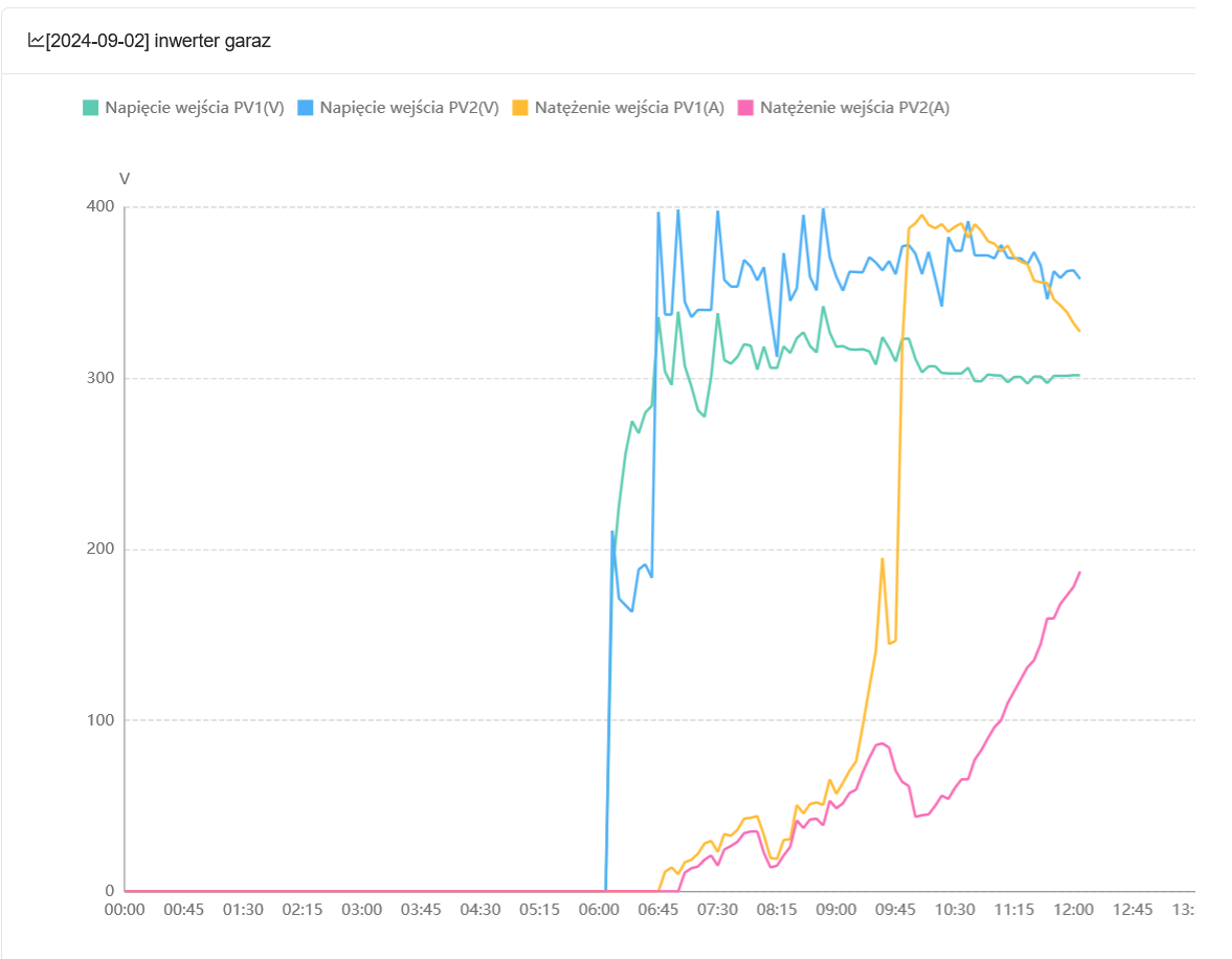

    webonek
    Posts: 66
    >>21210027 .
    Well, that's it - a bit low :( .
    I have Huawei optimisers - some P and some newer P2. Huawei says it doesn't matter - they just recommended uploading the same soft, which was done (and MBUS).
    I have uploaded the old soft ...153 - but tentatively I can see that this has not changed anything.
    At the moment - it's full sun, basically starting the hours of peak (at my place) production, as the panels are on the south-east side (peak between about 9:30-12:00) and I can see on the optimisers (they hardly cut anything) that:
    1) String PV1 325W 31.6V*7.41A=~235W
    2) String PV2 375W 32.6V*8.51A=~279W
    ....no and just: A little low :( .
    Total production around 7.7 kW and the graph is already flattening out.
    Cloudless, temp. in the shade 22'C. Temp. inside the inverter 55'C (with vent).
    P.S. And why is the 6 kW after rewiring the PV1 string to the new inverter suspect? ...That it was too much? But it was, I remember exactly, because I was surprised.

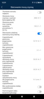

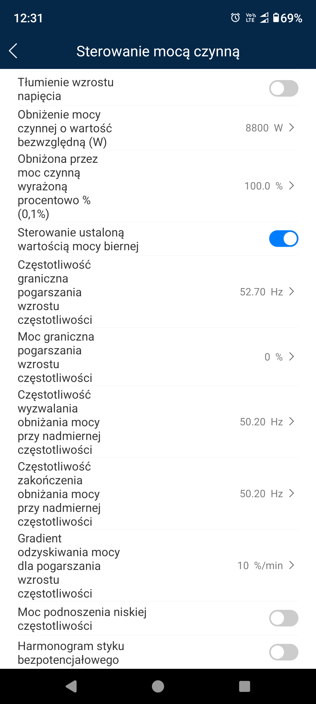

    #1270 21211038
    webonek
    Posts: 66
    Well, you see - in percentage terms I too have oversized by about 30%: analogous to 10/13 kW, only I have an 8 kW inverter 30% more panels. And that's exactly what I mean. We had winds in July, so the panels cooled down and the peak was 5.5 kW. It stopped - despite the same weather - after putting on the 8 kW inverter.
    By the way: in the FusionSolar web panel there is an item "configure strings": you can enter the exact parameters of the panels in each string - voltages, short-circuit currents, degradation etc. Huawei claims that you can enter or not, but this has no bearing on the operation of the inverter. So what is this for...?

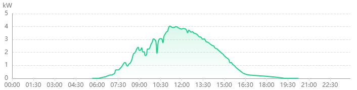

    #1275 21212300
    speedy9
    Helpful for users
    Posts: 12035
    Help: 1233
    Rate: 2423

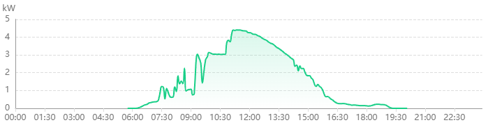

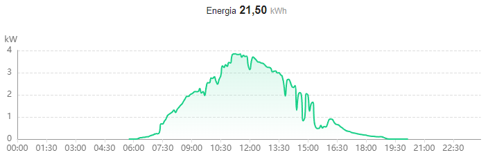

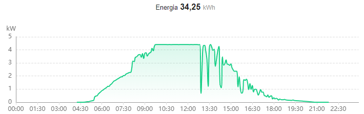

    >>21211038 .
    I have about 5.6kWp of panels and a 4kW Huawei inverter. And check this out:
    1 September, air temp 22 degrees:
    Graph showing daily energy production from photovoltaic panels. .
    29 August, air temp 32 deg:
    Graph of daily energy production from solar panels. .
    30 August, air temp 33.5 deg:
    A graph showing solar panel energy production with power from midnight to 10:30 PM, peaking at about 3.8 kW. .
    And a comparison with this year's record daily production of 23 June:
    Chart showing daily solar energy production of 34.25 kWh. .
    I don't have the highest daily air temperature from that day, but the daily average was 21, compared to 26.5 on 30 August. So it must have been quite a lot cooler in June after all.
    You can clearly see the difference in maximum power, also the heat affects the power of the panels a lot. It still depends on the setting, I have an east facing one. To the south they will heat up more.

    #1276 21212306
    webonek
    Posts: 66
    >>21212300 .
    Well that's right - on the graph from 1 September the inverter is doing 110% of rated power. It was like that on a 5 kW inverter at my place too.
    And at my place it doesn't hit rated power or it hits it for a while, not to mention peak - even when the weather is exactly like this: 21'C, cool wind and full sun.
    I also have an east-facing - more precisely: south-east-facing.
    I'm not arguing that I don't have an 8.8 peak in hot weather or every day in summer - just that I don't have one at all, except for really short, very short spikes after the sun comes out from behind the clouds. And the kind of longer peak above rated power on a cool, sunny day (above 4 kW with you and above 5 kW with me on the old inverter) - I haven't had at all since nearly 2 months after I changed to an 8 kW inverter.

    I've added another graph, from June, there's a lovely peak there.
    That's what I'm thinking, maybe it's a panel issue. You have the black ones, I have the classic 'blue' Longi LR4-72HPH 435M. Maybe yours get hotter and drop in power more?

    >>21212355 .
    if you at least showed the graphs of the MPPT on sunny days, it would help something
    or do a full optimisation then you can see what is happening per panel
    maybe you have a shadow, maybe you bought defective panels, maybe your inverter is set to power factor 0.6 or to reactive power factor correction.
    in general, your installer should be able to sort it out.

  • #1285 21212422
    mateos2
    Posts: 153
    Rate: 8
    >>21212405 .
    Current and voltage graph for each MPPT
    something like this :
    Graph showing voltage and current for each MPPT of the garage inverter. .

  • #1288 21212459
    webonek
    Posts: 66
    >>21212443 .
    I've been keeping an eye on the standard for what they set and it's the right one - but I checked to be sure anyway.
    This graph is where can I find it? Because I have various but rather power only ones?
    App screen showing active and reactive power control settings. .
  • #1289 21212483
    xszuflax
    Posts: 53
    Rate: 7
    >>21212459 .
    Hey,
    In a similar section Reactive power control. See if you don't have compensation there. Looking at your posts I haven't seen any problems with the line voltage but it's still worth checking.
