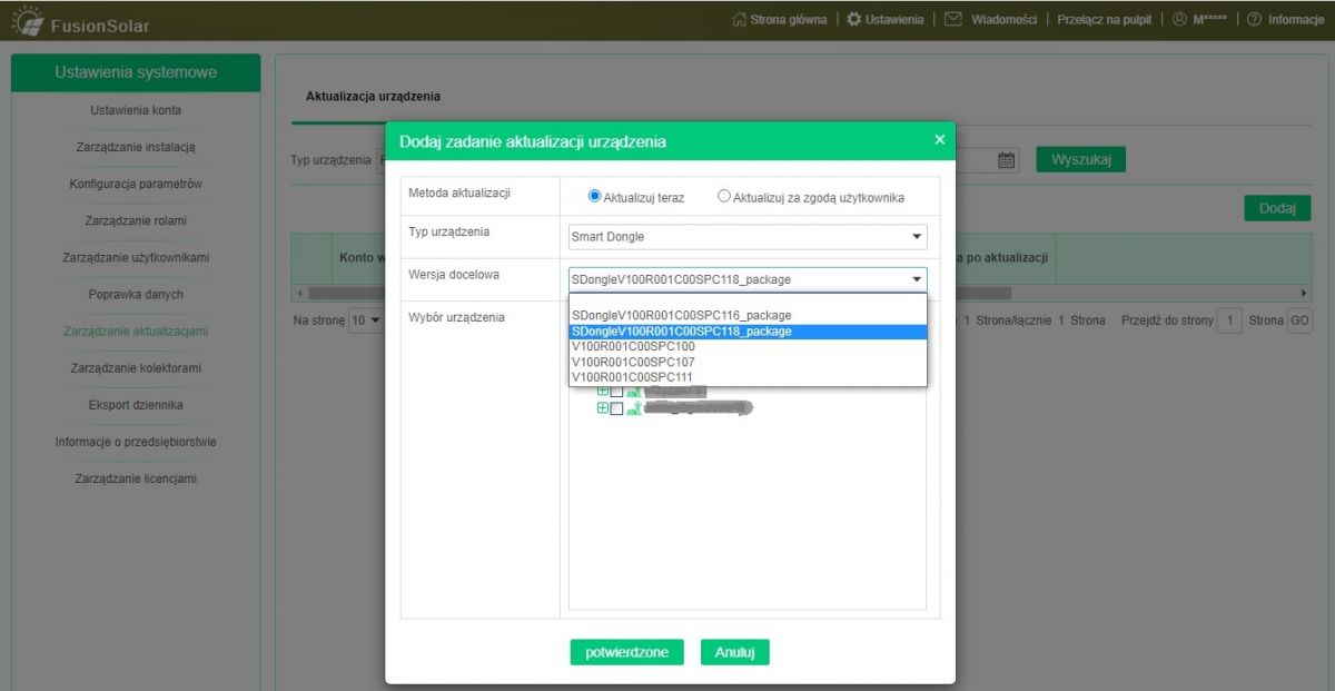

    Huawei SUN2000 Inverter: WIFI Dongle Connection, Firmware Update & FusionSolar
    What inverter do you have? Until my latest version is the one marked by me, im going fast 130 came out in February as far as I can remember.
    Huawei SUN2000 Inverter: WIFI Dongle Connection, Firmware Update & FusionSolar Other files are for other inverters, probably parts to those that do not exist in Europe, theoretically, the system should not give a bad one, but seeing how the Huawei is thrashing with the application, I would not risk it.
  • #122 19294028
    Math13
    Posts: 112
    Rate: 34
    andrzej20001 wrote:
    For me, the machine sucks up updates.
    I don't and I don't understand why. :-(
    Added after 7 [minutes]:
    I have both installations on identical inverters.
    SUN2000-5KTL-M0
    In the list (as I indicated earlier, in the search window) I also found updates for SDongleA-05.
    How do you guys. Worth updating?

    domelek
    Posts: 275
    Help: 10
    Rate: 44
    Math13 wrote:
    domelek wrote:
    You enter the Fusion Solar website. You log in and enter the settings at the very top. I think you can still do it ...
    It's not very intuitive, but I managed it somehow.
    You have to find the device yourself and the matching software.
    I just still don't understand:
    1) Why I didn't get the update from the machine like my colleague "mondo20001"
    2) I do not see any software with the ending ... SPC126 on the list.
    3) I can't see firmware newer than: V100R001C00SPC122
    The ending 133 is the newest (at the top in your screenshot)

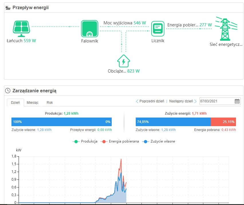

    lukkucz
    Posts: 44
    Rate: 19
    The question is a bit different
    I have a SUN2000-5KTL-M0 inverter, panels power 4.74kWp - to what maximum value I can extend the installation. I know it will be one or two panels, but I mean a specific value.
    And the second thing I would like to have a preview like in the photo
    I mean the load, how much energy do I use, give back etc. Probably something needs to be built, but what and how it is already beyond me
  • #131 19302424
    dprzyb
    Level 22  
    Posts: 504
    Help: 36
    Rate: 119
    You must have an energy meter in addition. The original one is Huawei DTSU666-H.

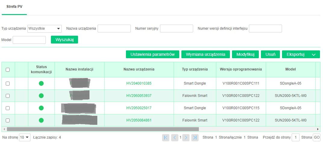

    dprzyb wrote:
    dprzyb wrote:
    You can force some update if I do not have the "Software update" tab available in Fusion Solar, and after logging in to the inverter directly with the app, it shows me "no update"?
    At the moment I have SPC122 in inverter and SPC111 in donglu (SUN2000-4KTL-M0)
    Someone something?
    See post 121, how do you have no update option, maybe you do not have permission?
  • #139 19319387
    dprzyb
    Level 22  
    Posts: 504
    Help: 36
    Rate: 119
    Exactly. I do not have the option to update on the FusionSolar website, probably due to lack of permissions. Therefore, I am asking how to get around it.
    I have an update option in the app but I write that there is no newer version.
    Can you manually download this version of SPC133 from somewhere?

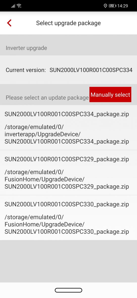

    rokbok
    Posts: 4251
    Help: 622
    Rate: 992
    Yes, from the huawei website, registration required, link below.
    https://support.huawei.com/enterprise/en/digital-power/sun2000ma-pid-22755755/software
    dprzyb wrote:
    after logging in directly to the inverter, the app shows me "no update"?
    Someone something?
    For me, there is an option to select the file manually, but you need to physically have it, e.g. on a smartphone, see below.

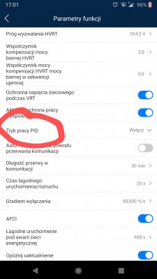

    Yahoou77
    Posts: 73
    Rate: 55
    Math13 wrote:
    Anyone using the SUN2000 app with a Huawei inverter? Does it work for you?
    I use the SUN2000 app to support my SUN2000-5ktl-m1 and I really appreciate its performance. The only flaw is that it does not remember the login password and you have to stick your finger in it every time.
    And a question for installers who have the configuration of Huawei inverters at their fingertips:
    How should the parameter "PID operation mode" be optimally set (marked in the photo below)? There are two options: "disable" and "repair". I have a Sun2000-5ktl-m1 to which 2 chains (12 + 7) of JaSolar jam60s10-340 / mr panels are connected, without optimizers, because there is no risk of shading.
    By default, the installer has disabled this feature. Is this a good approach? If not, what are the benefits / inconveniences of changing this option to "repair"?
    I will be grateful for your response...
