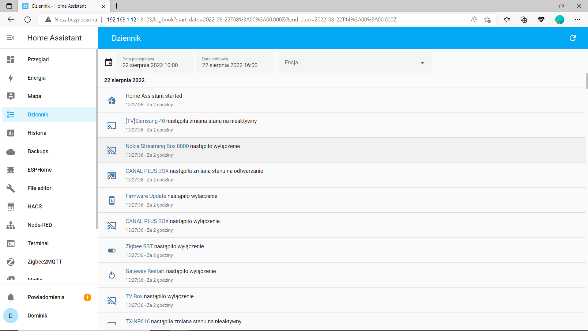

  • #35 20155272
    bambek2005
    Posts: 15
    Good morning, nice tutorial. So let me "give up" my problem because I see that you have quite extensive knowledge in the subject of HA, and I am looking, I am looking for and nowhere can I find a solution. When it comes to RPi there are lots of "uncles Good Advice" but about HA OS x86 ... Bida. Well: Home Assistant OS x86, installed "configured" on Dell Wyse. Everything is cool except time ... The system itself in the terminal shows the correct time (DELL in the BIOS is set to the correct time), Home Assistant Tutorial - configuration, WiFi, MQTT, Zigbee, Tasmota while all the rest (diary, esphome, zigbee etc.) Home Assistant Tutorial - configuration, WiFi, MQTT, Zigbee, Tasmota Home Assistant Tutorial - configuration, WiFi, MQTT, Zigbee, Tasmota Home Assistant Tutorial - configuration, WiFi, MQTT, Zigbee, Tasmota
    indicate + 2hours. I installed the CHRONY plugin (NTP server) which shows a good time, but it doesn't change anything ...
    The only thing I got to was editing the conf file /etc/systemd/timesyncd.conf and patting NTP servers at tempus1.gum.gov.pl tempus2.gum.gov.pl and returning to ntp.ubuntu.com (I also combined from 0.pl.pool.ntp.org - no effect).
    The problem, in my opinion, is that I cannot change the time zone from the terminal (timedatectl set-timezone Europe \ Warsaw) because I have a failed to set ntp error: file /etc/systemd/system/dbus.org.freedesktop.timesync1.service : Read-only file system. and so every time I try to change anything with timedatectl - is it to disable the NTP server where should I start or whatever. I even tried to edit the above mentioned dbus file .... manually with the VI command but it crashes that I cannot write read-only file.
    It's a trivial thing, but because of this little thing I can't start the TUYA integration - error 1013 (time synchronization) crashes, NodeRed freaks out and my hair is starting to grow in general ;-) with a nerve ...
    I will add that in the HA itself in config.yaml the time zone is set to Warsaw, but it does not change anything - I can change it to +/- 3/4/6 and it does not change anything in the logs or system operation ...
    Maybe someone / something has already encountered such a problem?

    Compare yourself with the picture below

    ok, but how to enable synchronization with the system clock? and how to change the timezone from the command line ... This is where I have a problem.

    It's hard for me to say what my friend messed up there ;-)
    1.The bios watch should be set to time UTC not on local time - this is the first to change
    2. Is the timezone set in the HA itself?
    Link

    I cannot change / set the time zone in the BIOS ;-(
    Yes, the HA is set as I wrote in my "regret post"

    We did not understand each other.
    Set the system time (in bios preferably) to universal time (-2 hours to ours).
    And show what you got at that point in HA

    I guessed the time set back in the BIOS by two hours - hereinafter LYPA. I've been through it.
    Again, I quote myself - "my hair starts to grow from this nerve" - all over again ;-)
    Added after 4 [minutes]:
    The problem is that I don't know / can't change the zone, time or anything from the console level ... :-(
  • #42 20155820

    I've never had a problem like this ...
    Try differently:
    leave the line "homeassistant:" and delete the line below completely.
    Save the configuration.
    Go to system / general and set your timezone there.
    Reboot and cross your fingers.

    unfortunately, nothing came of it. I checked after the reboot if he added a line with the zone - strange, but not.
    But thank you for your willingness, maybe someone on the forum will be able to solve "my puzzle" ...

    thanks for the link but something I have the impression that it does not apply to me, i.e. in my configuration.yaml there is absolutely nothing and as you can see
    he sets the zone with the GUI and now raises another question for MiSie - where, if not in configuration.yaml HA OS writes it?
    Maybe in this version of HA the configuration files are also named differently?
