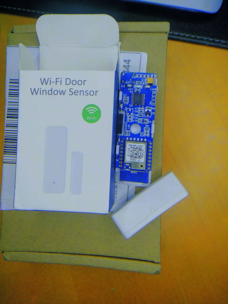

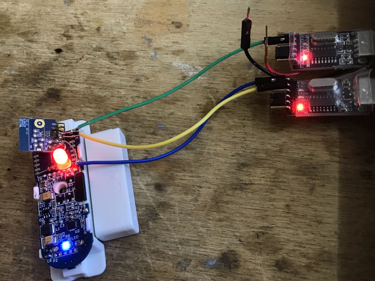

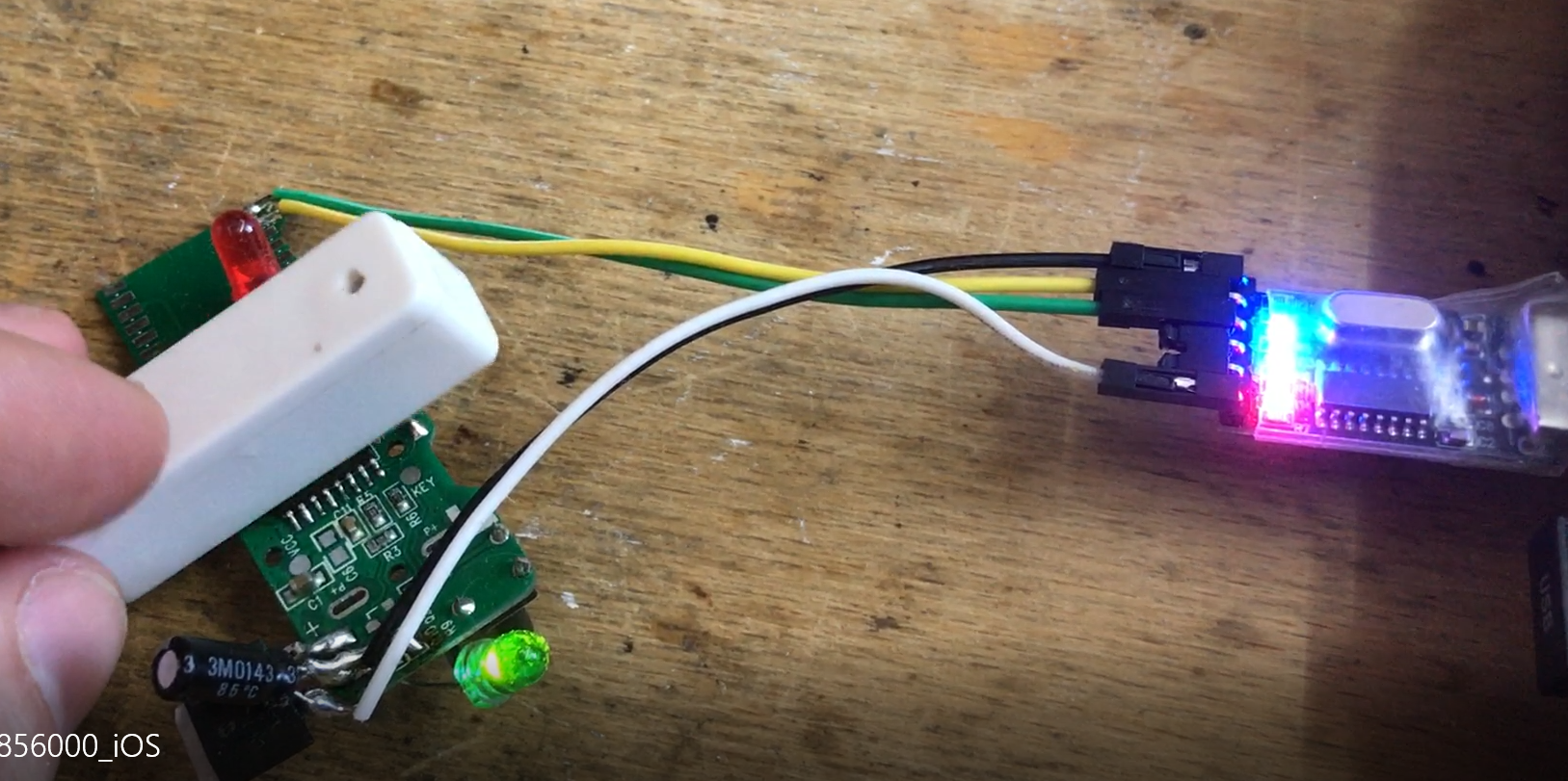

    Hello @elbuit . You are using uartprogram incorrectly. Please consult manual:
    https://github.com/OpenBekenIOT/hid_download_py
    Energy-saving (?) Battery-operated door / window sensor for WiFi DS06
    You are missing offset.
    [/url]
    :oops: I've missed that part, my apologies.
    Thanks for your help and to allow my tuya devices a new life with home assistant.
    I managed to write OpenBeken firmware and it works.
    But I think that I've broken the magnetic field sensor because although I put the magnet closer the device don't stops.
    By the way, I've seen that CB3S supports bluetooth.
    That could be interesting for a door sensor, to detect which devices are near when the door is opened.
    Thanks.

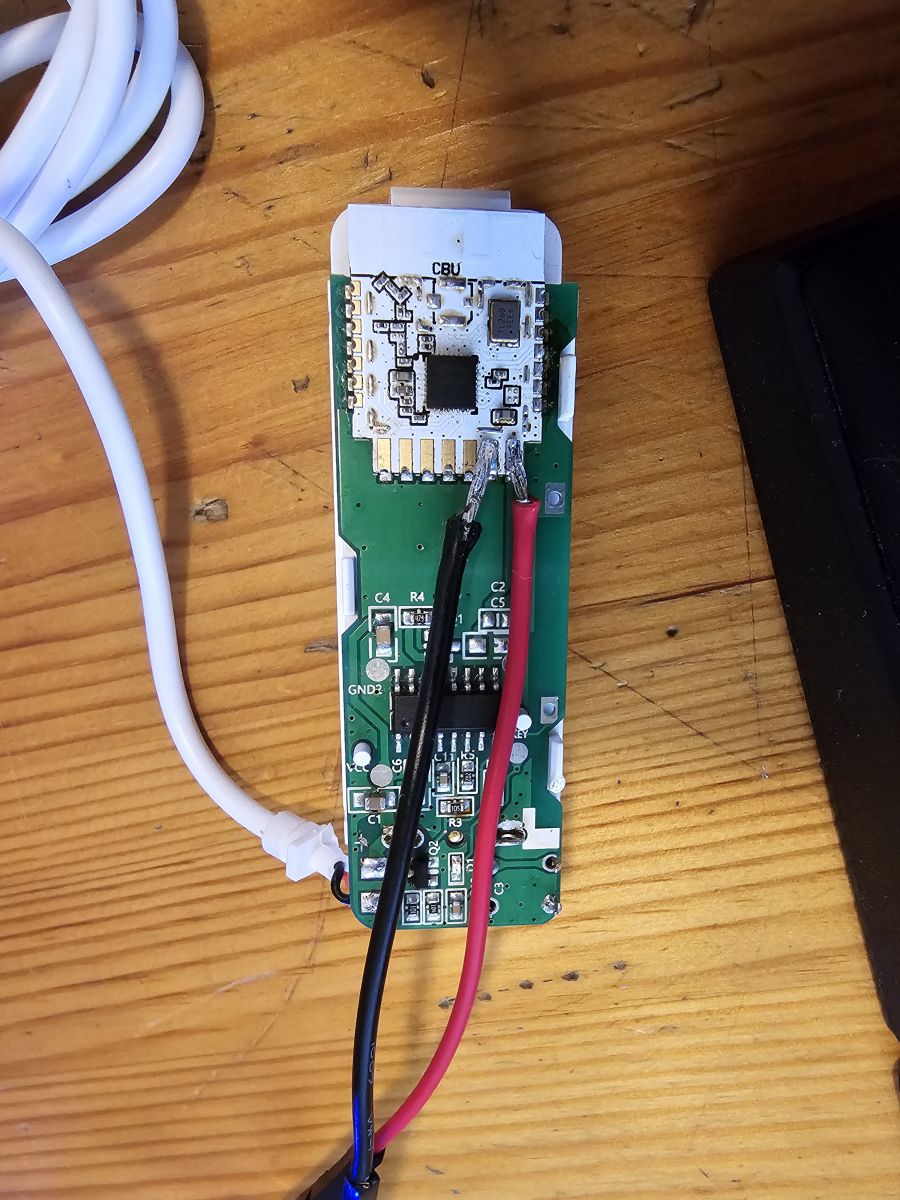

    Unfortunately I don't have much time at the moment.
    I don't know if your problem is solved, but I also had problems with flashing the device initially. When flashing I had a write error again and again.
    I fixed it by changing the USB serial device. It was the same guy. I don't know why, but the other one works fine.
    I used the flashing tool (Buffalo in version 1.4.8 as described in the discussion).
    Greetings
    K

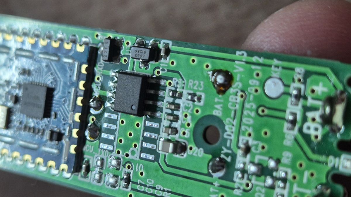

    I have this door open sensor. I uploaded OpenBK version 1.15.468 to it, so far it works without any problems.
    I analyzed the board and drew a schematic. Maybe someone will like it.
  • Deep sleep and PowerSave for WiFi-only sensors
    #34 20448565
    Posts: 14810
    Rate: 12977
    Hello, thanks for the diagram. This door sensor, i.e. the one from TuyaMCU?
    Remember that if your door/window sensor does not have TuyaMCU and is implemented on the WiFi chip only, then you should consider its configuration to work with Deep Sleep and wake up by changing the state on the pin.
    Also (in any case) it is worth considering adding the PowerSave command to the short startup command, which in turn starts the hybrid sleep mode (the device supposedly works all the time, but it saves energy). PowerSave will soon be set to 1 by default in every release (you won't need to enable it), but we're still testing it.

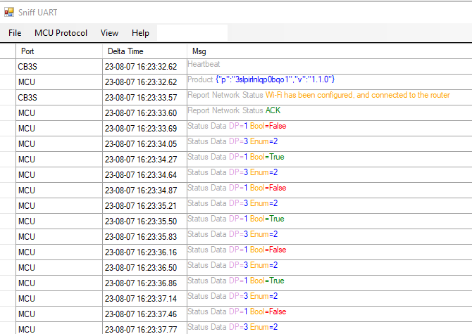

    1. Do UART capture to figure out dpId meanings:
    https://www.elektroda.com/rtvforum/topic3970199.html#20528459
    2. Flash OBK, you may need to cut traces because TuyaMCU will interfere with UART communication. You also will need to connect power to 3.3V of WiFi module because otherwise TuyaMCU can cut off its power (see first post)

    mkmunichmk
    Posts: 32
    Hi, my Tuya door contact device is moreless looking identical to the water-leakage-detector (https://obrazki.elektroda.pl/1674347900_1671892731.jpg) refer to #13 from 24th december 2022. I was able to install openBeken onto my device and I'm struggling with the correct configuration...
    Open sensor showing electronic board next to a box labeled Wi-Fi Door Window Sensor.
    In order to avoid the problem, that TuyaMcu is powering the CBS3 I just soldered wires to GND and VCC of the CBS3; so the CBS3 is permanetely powered (if wanted).
    I tried the following configuration (not knowing which DP are really used by my device):
    Screenshot of Sniff UART interface displaying protocols and status data.
    It is strange, because the output does not correlate with the door state. Even worse, the DP states are sent sporadically; means they are send rarely and not when contact state is changing. I have currently no MQTT broker running - would this make a difference? I did not try yet.
    At this moment I'm using this autoexec.bat:

    I think that powering CB3S constantly is the source of your problems.
    I may be wrong, but as far as I remember, and I did quite a research on this topic, the TuyaMCU on battery powered devices works in such a way that the MCU powers on the WiFi module and WiFi module then sends the first UART packet to the MCU. WiFi module initiates the transaction, and MCU only responds, so timings are crucial.
    If you power on the WiFi module permanently ,you break the communication standard and get undefined behaviour.
    I have tested two door sensors and in both cases it worked reliable when I was following the protocol as designed by Tuya.
    Here are my sensors during testing:
    The photo shows a door sensor being tested with connected wires and a lit red LED.
    Close-up of an electronic circuit with a white sensor, colored wires, and glowing LEDs.

    Hi, I repeated the test by NOT powering the CB3S. Please find the SniffUART recording attached (this file can be imported into SniffUART). I opend the magnet contact and got a change in DP1 from false to true. So half way is done. Still missing the magnet close event from DP1= true to false. I guess, there is something wrong in my autoexec.bat above?
    Best Regards MK_Munich

    Hi @p.kaczmarek2, I'm digging into it ;-) From the Serial Port Protocol of Wi-Fi for Low Power Devices in the flowchart below section "Report the real-time status" it is seen, that values are reported by MCU to CB3S after CB3S tells the MCU, that connected to network. In my attached SniffUART recording above this behavior is seen. For this I would guess, that in case of closing the contact, the "Report Network Status" message is missing?
    In an other sniff after I closed and opened the contact I got (after "Report Network Status") DP1=false , then =true and back to =false.

    Close-up of an open electronic device with a visible PCB and chips. WiFi water leak detector instructions with technical information. Box of Wi-Fi water leak sensor
    Hi have 3 exact devices (have opened them up and PCB and chip layout are identical). I have been trying for days now to get these to work without success and looking for some assistance. I have managed to cloud cut and load OpenBK on them (well one has kickstarter-esphome...but that another story). I have tried using the template found in the OpenBK device list data base for Tuya W06 Water Sensor which seems to load just fine but I do not see any change in the pin configuration afterwards...should I? I have tried adding the startup command as you indicated and that does seem to change anything. Can you give a walk down of the process you did to config or anything that I should check or do? Thanks for help you can give. fyi, I am a long time Tasmota user so some things in OpenBK are famaliar some things not so much.

  • Identifying ZY-D02-CB3S as a BK7238 TuyaMCU sensor
    #54 21952915
    iCarRadio
    Door Window Sensor
    ZY-D02-CB3S-v1.3
    T1-3S
    Chip: BK7238
    Device ID: bffc68b9ae09ce99c81yvs
    Product: 001D02T1-3S
      "vendor": "Tuya",
      "bDetailed": "0",
      "chip": "BK7238",
      "board": "TODO",
      "flags": "2621440",
      "keywords": [
        "TODO",
        "TODO",
        "TODO"
      "pins": {},
      "command":
       startDriver TuyaMCU
       linkTuyaMCUOutputToChannel 101 enum 1
       setChannelType 1 ReadOnly
       setChannelLabel 1 \"Door State\"
       linkTuyaMCUOutputToChannel 102 val 2
       setChannelType 2 ReadOnly
       setChannelLabel 2 \"Battery\",
