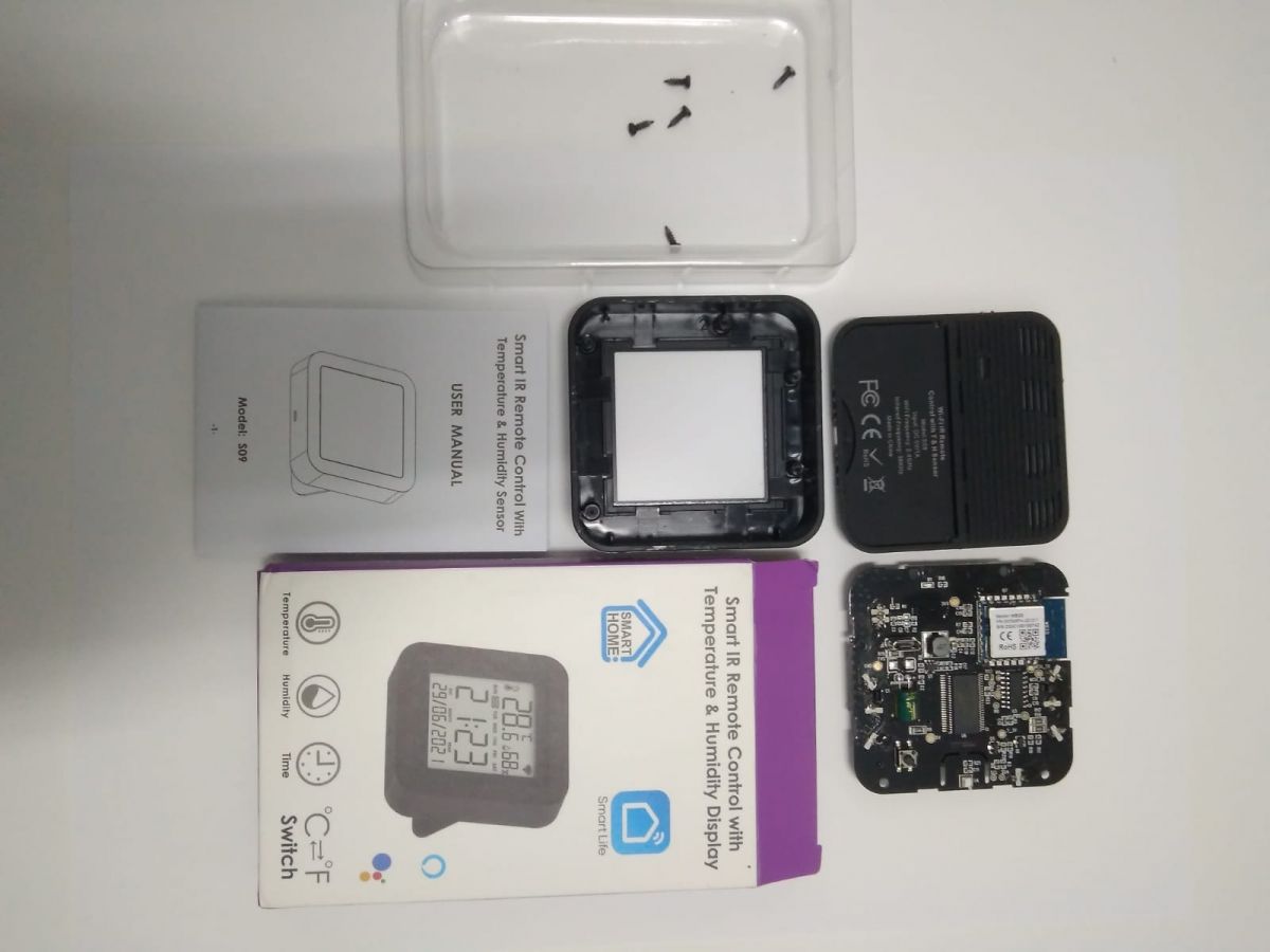

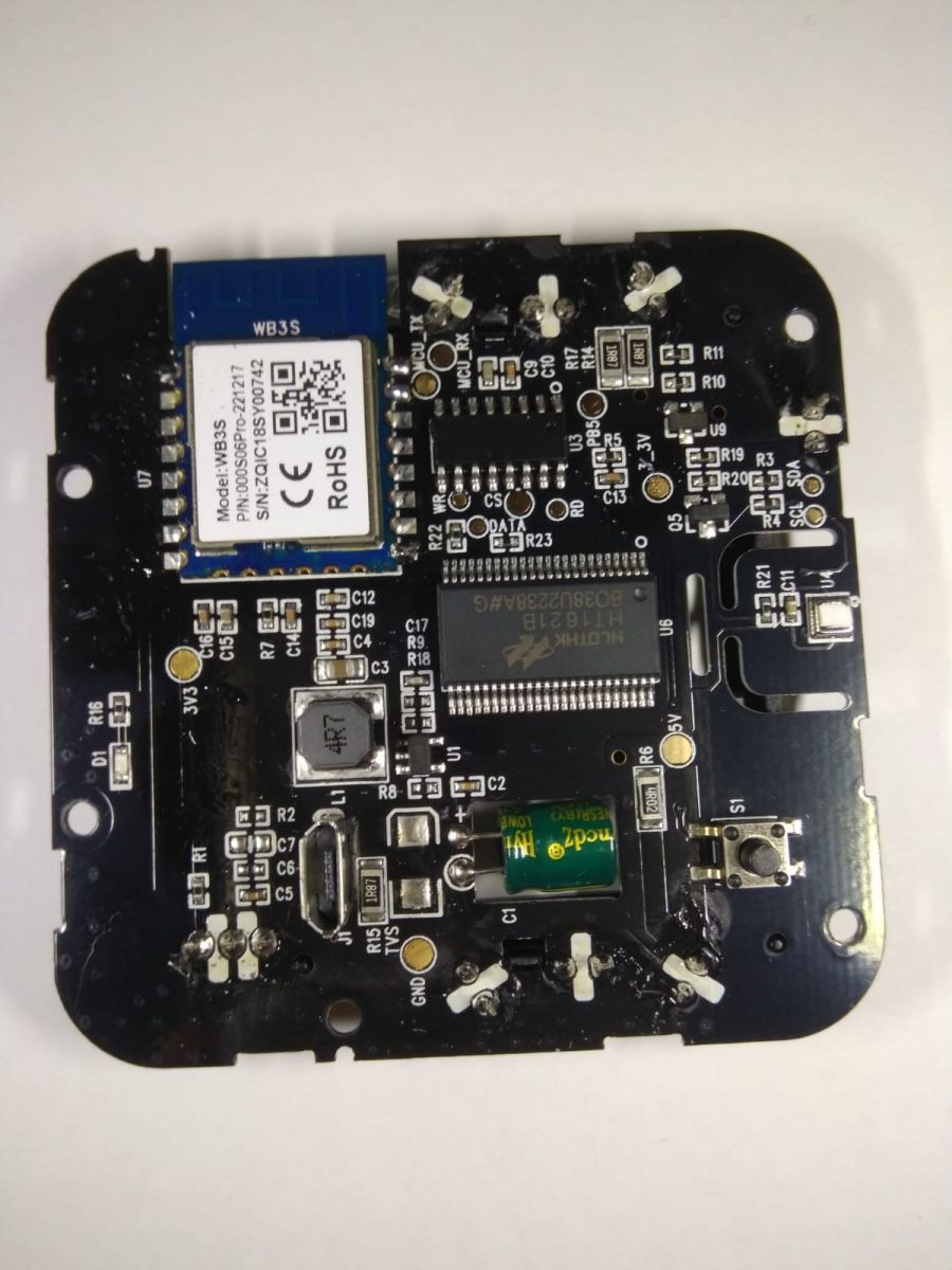

Teardown of the TH06 clock/thermometer/hygrometer and UART reverse engineering
p.kaczmarek2 23973 41
  • Teardown of the Tuya TH06 USB clock/thermometer/hygrometer, plus reverse engineering of its UART communication and SmartLife pairing.
  • Inside are a WB3S BK7231T Wi‑Fi module, an unnamed SOIC microcontroller, a TM1621B LCD driver, an AHT10 sensor, and a step-down power stage.
  • Measured current draw stays around 20–30 mA after network time sync, about 0.15 W, and the seller price was about $20 / PLN 80.
  • UART traffic runs at 9600 baud and uses binary packets that expose year, month, day, hour, minute, and likely AM/Wi‑Fi status and checksum fields.
  • The clock needs constant USB 5V, forgets time after power loss, cannot switch to 24-hour format, and cannot run Tasmota because it lacks ESP.

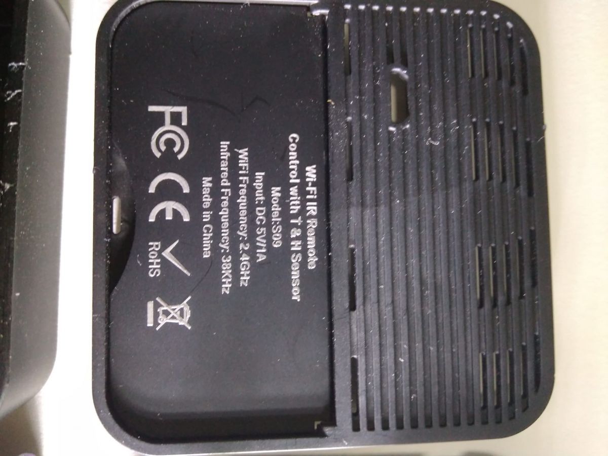

    ah. mine is slightly different to the eMylo S09s, what was yours?
    My one is like this https://www.elektroda.com/rtvforum/topic3819498.html#20672815 with IrSend now on P26 and only 1 capacitor
    I could not get any life from TX/RX using any USB-TTL until I cut the TuyaMCU RX/TX. I tried many times using different cables and USB-TTLs. I have flashed quite a few Beken devices now.
    Also, I note on these PWM0/P6 is the button. Maybe this variation could do with a new thread and a modified OBK to distinguish between newer S09s and the eMylos

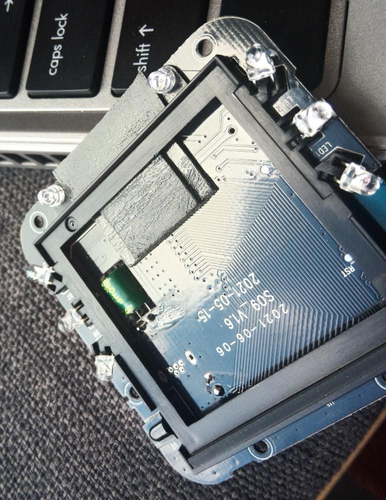

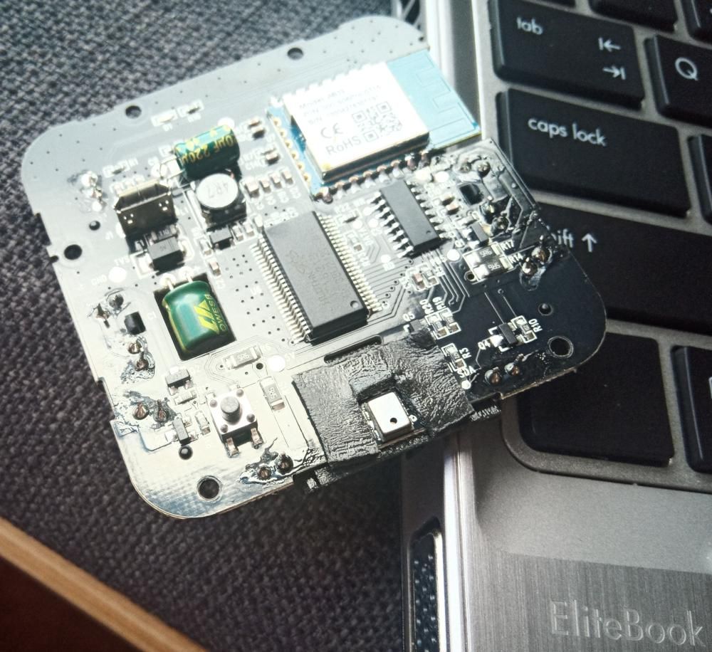

    I noticed it was over-reading temperature like others have experienced. The AHT10 is read digitally and is supposedly factory calibrated, and so poor design is all I could think was effecting the reading. So I experimented isolating the sensor and providing it better air flow.
    I noticed that there is a cut out on the PCB which is great. I added a couple of layers of double sided tape, which is essentially just 1ish mm thick foam, for insulation
    Circuit board with visible components placed on a laptop keyboard Close-up view of the circuit board of an electronic device with LEDs and ventilation holes. Image showing a plastic device casing with drilled holes.
    You can see I also drilled holes for better air flow into the sensor capsule

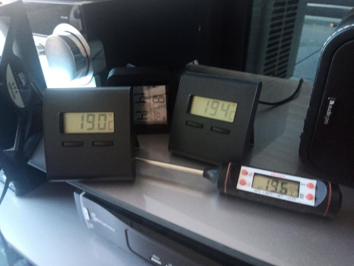

    I then sat all the temperature sensors I had available together with a fan for an hour or so and checked that the readings had all stabalised
    Several temperature displays showing readings from 19.0°C to 19.6°C.
    You will notice that during the experiment it under-reads by roughly 0.5 degC.

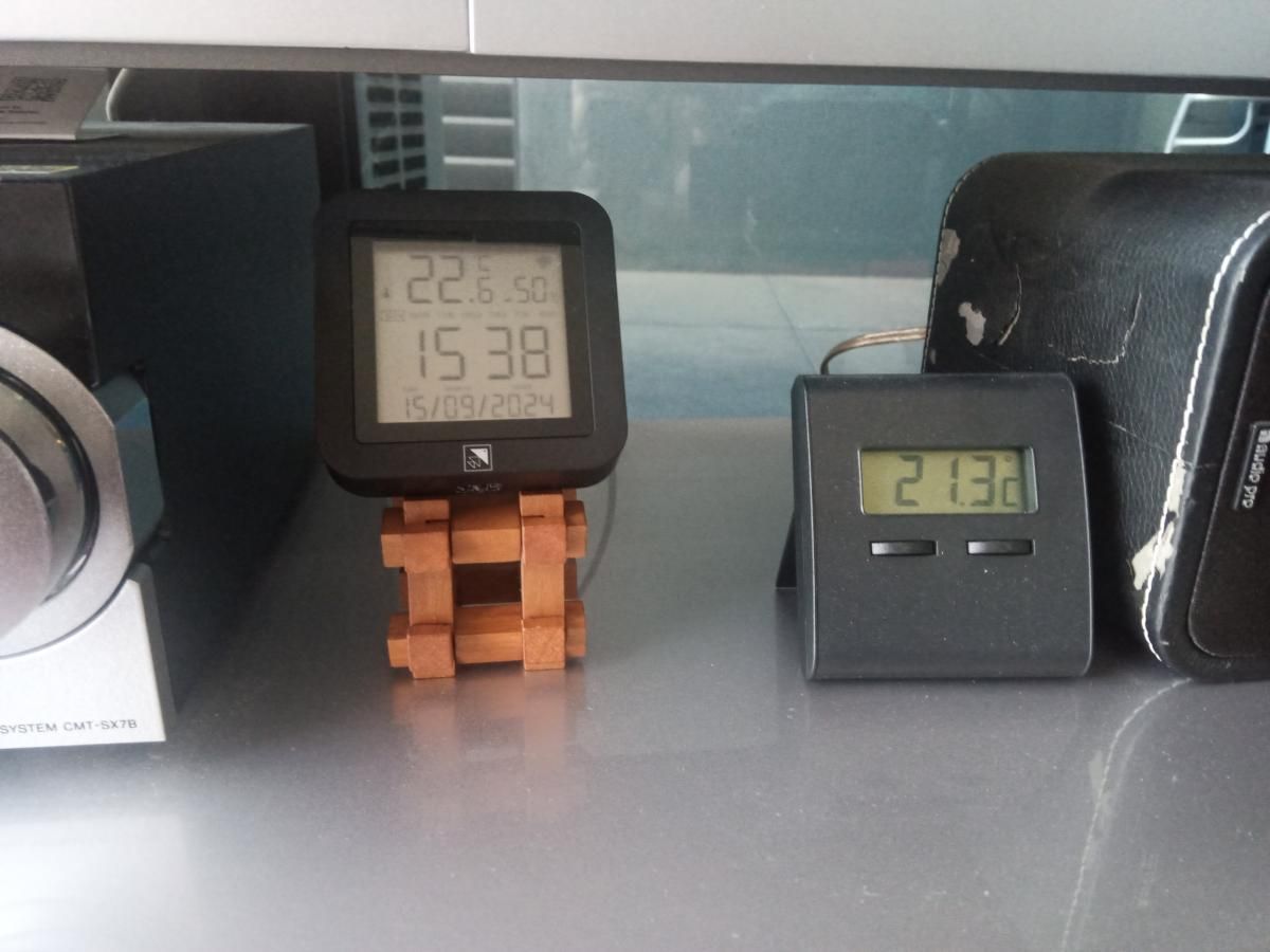

    I found a nice little trinket I can stand it on that gives clearance between the sensor capsule and the shelf below, allowing for better airflow. In this configuration it again over reads by about a degree
    Two devices with LCD displays showing different temperature readings on a desk.
    So I presume there is a small amount of localised heating occurring in the sensor. I do note the in the AHT10 data sheet the relative humidity performance is specified at 1m/s aiflow.
    So thats it. The display is accurate enough for me, I probably won't correct for it in HA either as I am more interested in long term trends. Its a good attractive little unit and I like the time sync capability and date display.

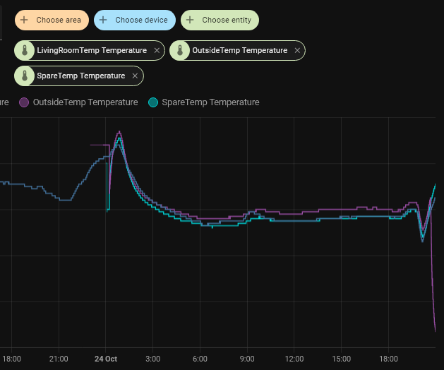

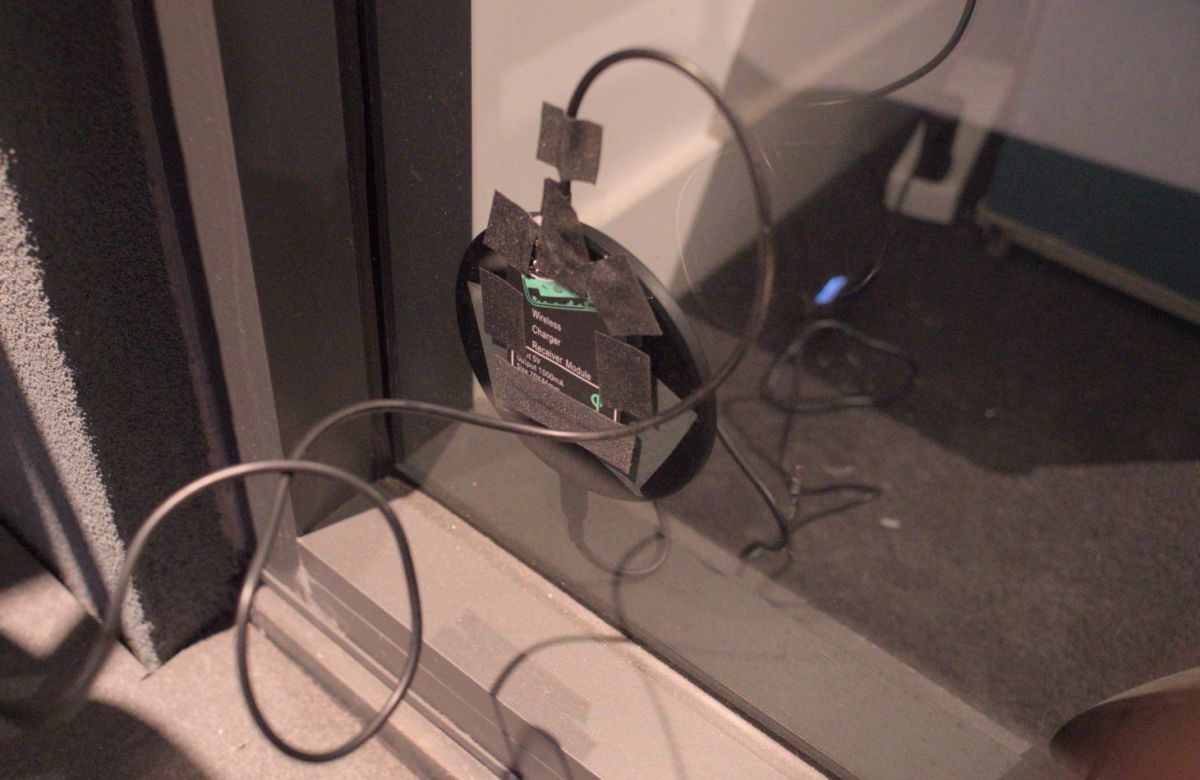

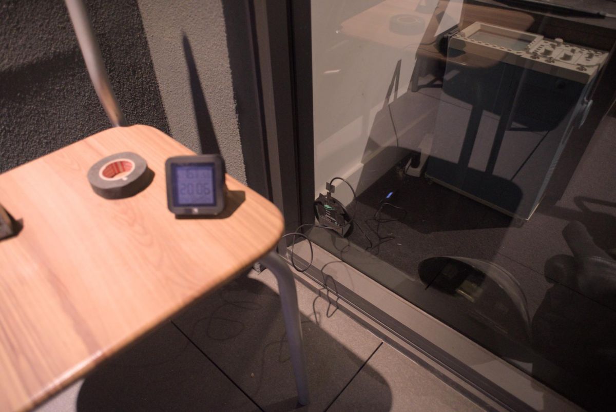

    Flashed up three more. I wired one of to run outside.
    Inductive charging through a window
    Wireless charger in packaging on a light background.
    Inductive charger mounted on a window with tape Table with an electronic device and tape, next to a window with cables inside.
    Added after 31 [minutes]:

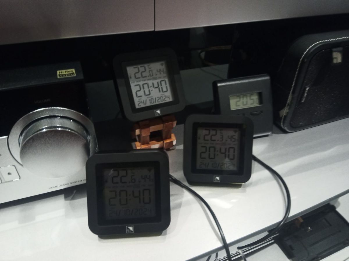

    This is how they track over 20 or so hours
    Several electronic devices on a desk, including three digital thermometers.
    Temperature graph with three lines showing indoor and outdoor measurements.
  • #37 21275594
    Posts: 14621
    Help: 655
    Rate: 12637
    Thank you for detailed writeup. I can see that one shows 22.0, second 22.3, and third 22.6. So I think it can be fairly said that precision after the decimal point is questionable.
    Or maybe they are affected by the way they are placed?
