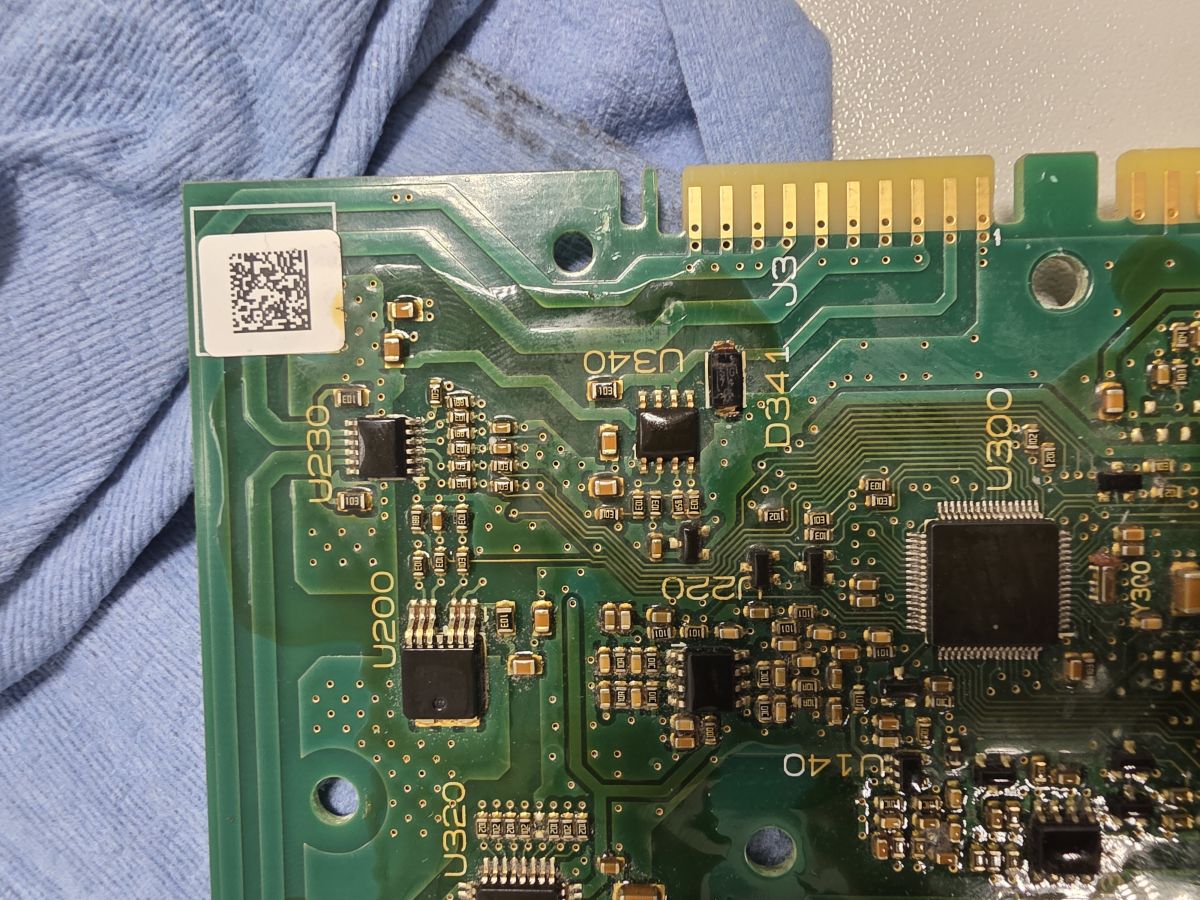

    Hello, I have a problem with the AdBlue pump on a 2018 Citroën C4 Pixasso. I completely disassembled the pump unit and resealed it. We checked the circuit board and found that D341 has a short circuit. What type of diode is this? And what effect does this have on my system? The error code is P20E8: Urea pressure too low.

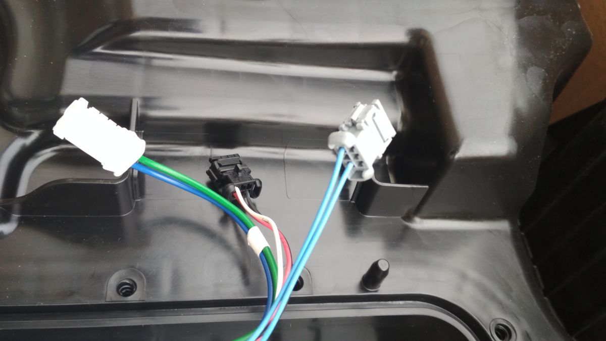

  • Questions about the 2023 AdBlue tank redesign
    #230 21723913
    goss85
    Hi Guys!
    I have got the 10k thermistor problem too. I have "repaired" it last year with a 12V pulse successfully, but the problem appeared again this year. Now I was not able to repair with this method reliably, so I was looking for a new tank without the pump module.
    I was lucky to see a brand new one and I got a surprise: there are no yellow wires going to the gray connector.
    Close-up of a wiring harness with three connectors in an AdBlue tank
    What do you know about this upgrade? The tank was manufactured around 2023.
    If I want to buy a new pump module for this tank, the dealer asks for the old one.
    Is it possible that the current tank+pump with disconnected yellow cables would work with a firmware upgrade? Are there other modifications too?
    Will the adblue system reliable enough to use the car for longer trips? In the last 5 years it had problems with the tank (replaced in warranty), NOX sensor, now the tank again. It shows a "1100km" warning, typically before planned longer trips, which is annoying.
    I know there are ways to get rid of adblue errors forever, but I would also prefer to use this system if it was reliable.
    I'm not brave enough to replace the 10k resistor with an other one, as maybe the urea heater board has a PID regulator, which uses this resistor as a reference input.
    If I use new firmware with the old module: is the new version of the tank uses some safety heat switch on board instead of the resistor?
    I have heard about the extended warranty of Stellantis, also read the TBS about that. Is it covering my problem for a Peugeot 5008 2.0blueHdi, 2015 155000km which tank was replaced at about 70000kms in 2020?
    Thank you for your help!

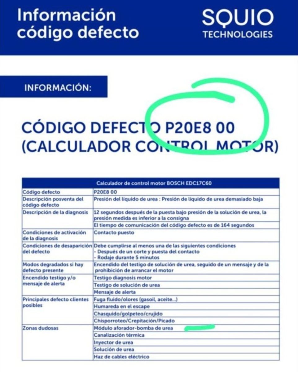

    #231 21741158
    aberto74
    Hi @mako122,
    I’m currently dealing with the P20E8 – Low pressure in the AdBlue system error on a PSA group vehicle. I’ve seen that several companies offer repair services for the electronic module with the pump, without replacing the entire AdBlue tank. These repairs usually cost around €400–€500, and they focus only on the electronic part.
    I’m attaching a screenshot from one of the providers offering this kind of repair.
    Table with details on fault code P20E8 00 related to emission fluid pressure
    From what I understand, if the fault is related to the SMD resistor of the 10K thermistor or the 3.3K thermistor, Do you think it might be possible to fix the issue by repairing or replacing the electronic control board???. This board seems to manage the heating elements (wires B, C, D, E, F – green, yellow, blue, white), and if the failure is in one of these heating circuits, it could be resolved by repairing just the electronic part.
    Maybe these companies install a new thermistor or resistor directly on the board to bypass or correct the error caused by a faulty sensor. That would explain how they manage to fix the issue without replacing the whole tank.
    So my question is: if the fault is in one of the heating elements or the thermistors (10K or 3.3K), how do they manage to repair it just by working on the electronic module? Is it a matter of replacing components on the PCB, or do they reprogram something?
    Thanks in advance for your help and insights!

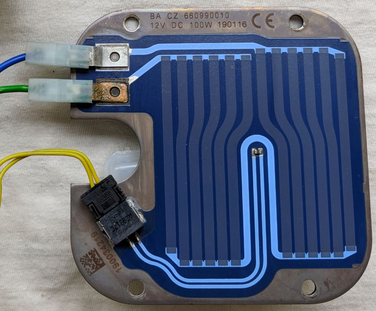

  • #235 21814607
    Reflekt
    Posts: 417
    Rate: 58
    Measure the value of the thermistor and only then you will know which resistor to solder in series, because the thermistor is permanently installed in the tank
  • #236 21814645
    enviesdean0v
    Posts: 27
    Thank you for your reply. I've seen a few people write about buying and soldering a thermistor rather than a resistor, so I wanted to make sure which is the better option.
    Where should the measurement be taken? Again, I'd really appreciate it if you could paste a photo, as there are so many in this thread (thanks again to everyone who took all these photos) that I'm not getting my bearings.
  • #237 21815181
    Reflekt
    Posts: 417
    Rate: 58
    in the first post you will find a description of which plug goes with what, as well as the colours of the wires
  • #238 21831394
    enviesdean0v
    Posts: 27
    @Reflekt, if I knew for sure which photo was in question and which plug-in, you can be sure I wouldn't have wasted my time asking :)

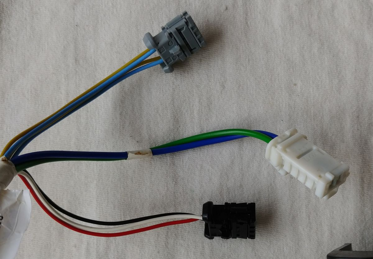

  • #239 21847611
    Reflekt
    Posts: 417
    Rate: 58
    here you have a thermistor with yellow wires
    Metal plate with blue heating trace and connectors; yellow, green, and blue wires visible
    Three electrical connectors with multicolored wires on a light fabric surface
    Grey cube - two temperature sensors ( yellow wires - temperature sensor on heating plate, blue wires - temperature sensor for AdBlue fluid)
