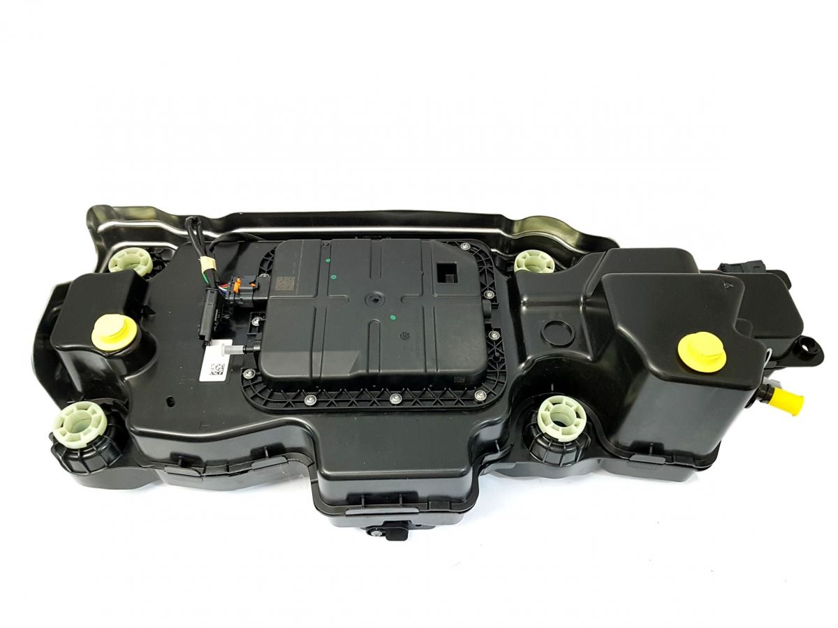

    In this topic I will post all the information and pictures related to the repair of the AdBlue tank in the PEUGEOT BOXER III car.
    I hope that someone of my colleagues will find this material helpful for a similar repair.

    Removing the tank from the car
    In order to repair the tank it is necessary to remove the tank from the car. Firstly disconnect the battery and disconnect the tank supply block marked A.
    See photos below:

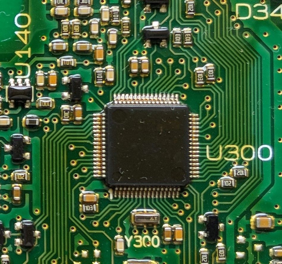

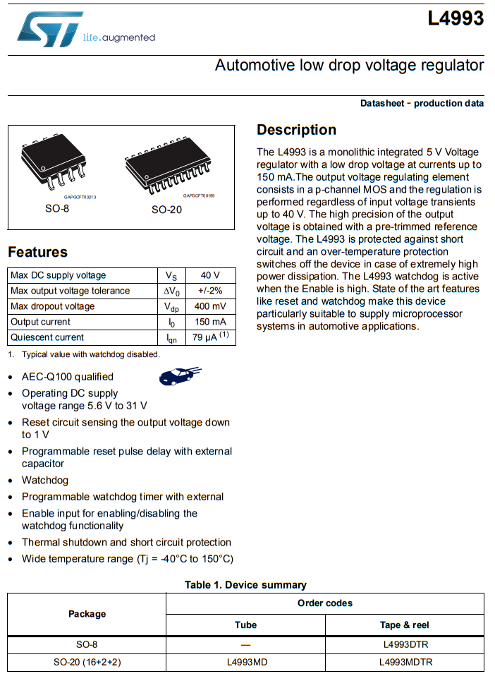

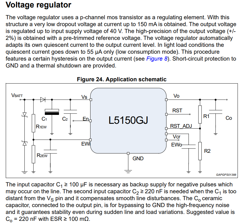

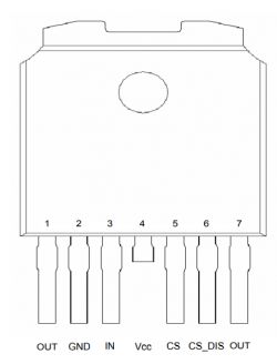

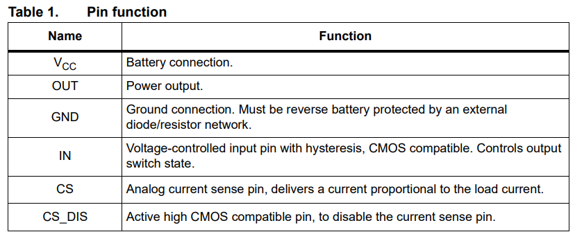

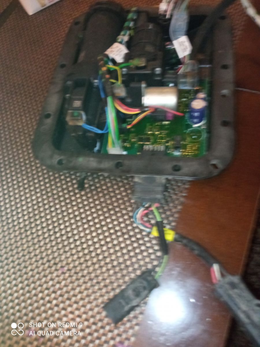

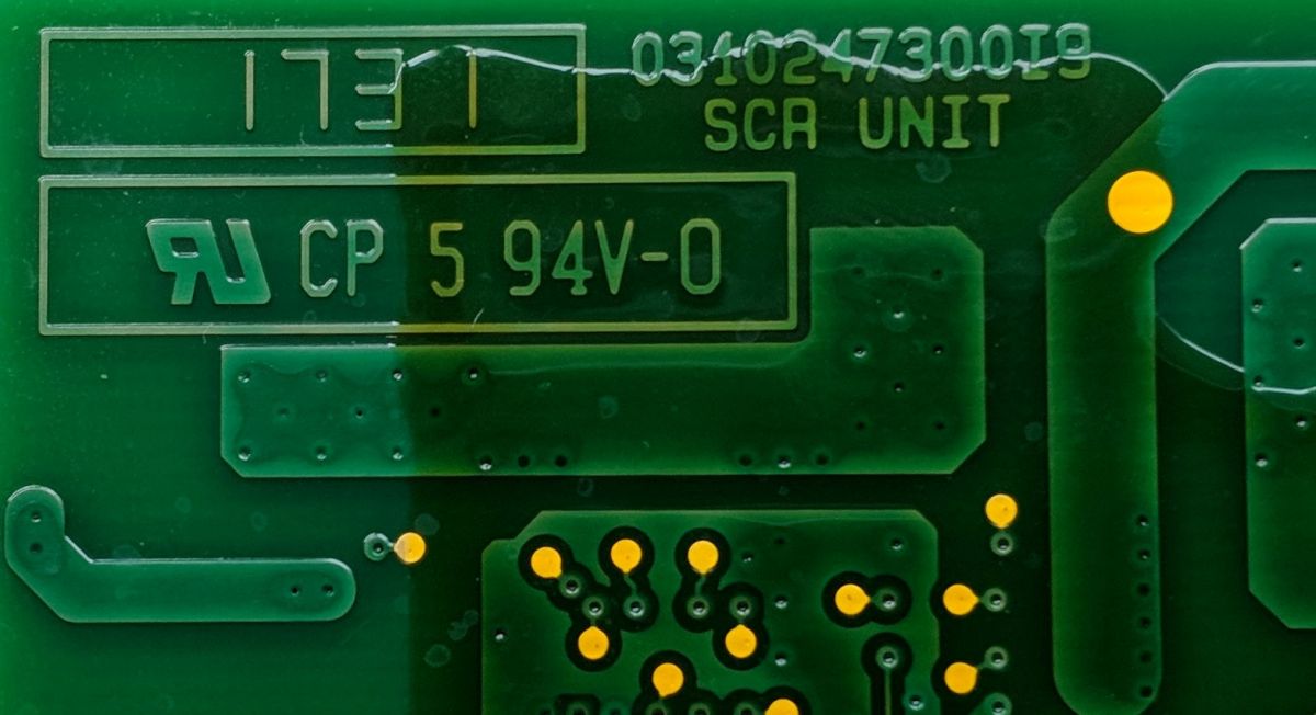

    Electronic board description:
    The electronics on the board manages the operation of the tank and sends information on the status of the tank to the car's central computer via the CAN bus (bus). It reads data from two temperature sensors, one pressure sensor and one tank level sensor. It controls one pump, one solenoid valve, seven urea heating circuits.
    The board has 4 connectors for communication with the above components. See photo of the board (connectors J1 and J2 and two edge connectors J3 and J4)
    PEUGEOT BOXER III - Repair of the AdBlue tank PEUGEOT BOXER III, CITROEN JUMPER
    Description of the J1 connector leads in the order shown in the photo from top to bottom:
    1 - thick black - tank supply - minus
    2 - thinner black - urea tube heating between tank and urea injector (injection) - minus

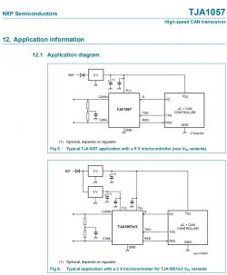

    3 - thin blue CAN bus
    4 - thin white CAN bus
    5 - green - heating of urea tube between tank and urea injector (injection) - plus
    6 - thick red - tank supply +12V
    Between the tank The AdBlue pipe (near the fuel tank) and the urea injector (near the engine) run along a urea pipe (see drawing at the bottom of the appendix - item marked 26) which is subject to freezing in winter. At temperatures below -11" C, urea freezes and therefore the entire length of the urea tube is heated by a resistance wire molded into the tube. Leads 2 and 5 of connector J1 supply this resistance wire. This is one of seven urea heating circuits and the only external circuit the other six urea heating circuits are located inside the AdBlue tank.
    IMPORTANT NOTE: Tank supply + 12 volt connector J1 (6 - red) appears when the key is turned and supplies power to the tank. The car's central computer waits for a response after CAN from the AdBlue tank. If there is no response then the car computer disconnects the +12V supply to the tank. This could be misinterpreted by the car repairman to mean that the reason for the problems is that there is no +12 supply at connector J1. In summary, if there is no communication between the tank and the car, or the tank is disconnected and removed, then voltage will only appear on J1 connector 6 (+12V) for a few seconds and then disappear.
    Description of J2 connector pinout (see photo)

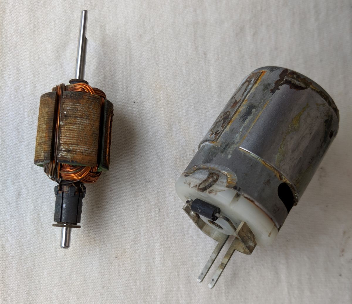

    2) The black (minus)-green-yellow (plus) pair of wires feeds the pump motor.

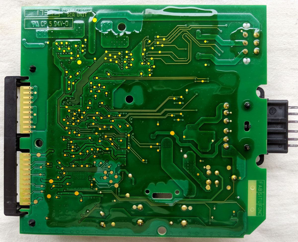

    Description of the J3 connector leads in the order shown in the photo from bottom to top. At the bottom is no. 1!!!!!! (see photo)
    contact no. 1 ( first from the bottom!!!) black ground - control of the solenoid valve.
    contact no. 2 red plus - control of solenoid valve.
    the next contacts are the power supply for the four remaining of the seven heating circuits:
    - white circuit - pair 3 and 7 (white wires)
    - blue circuit - pair 4 and 8 (blue wires)
    - green circuit - pair 5 and 9 (green wires)
    - yellow circuit - pair 6 and 10 (yellow wires)
    As you can see from the layout of the tracks, the four aforementioned heating circuits are switched together by the same signal and always work together. If one circuit is short-circuited, the other three will be short-circuited!!!!
    The four aforementioned heating circuits (white, blue, green and yellow) heat the 4 urea flow points (see photos below)
    PEUGEOT BOXER III - Repair of the AdBlue tank PEUGEOT BOXER III, CITROEN JUMPER PEUGEOT BOXER III - Repair of the AdBlue tank PEUGEOT BOXER III, CITROEN JUMPER
    - the white heating circuit heats the urea in the tube (elbow) at the tank outlet.
    - green heating circuit heats the urea pump.
    - yellow heating circuit heats the area near the solenoid valve and pressure sensor.
    - heating circuit the blue one heats the urea accumulator (a small tank with a capacity of a glass in which the urea is pressurised at around 5-6 bar)

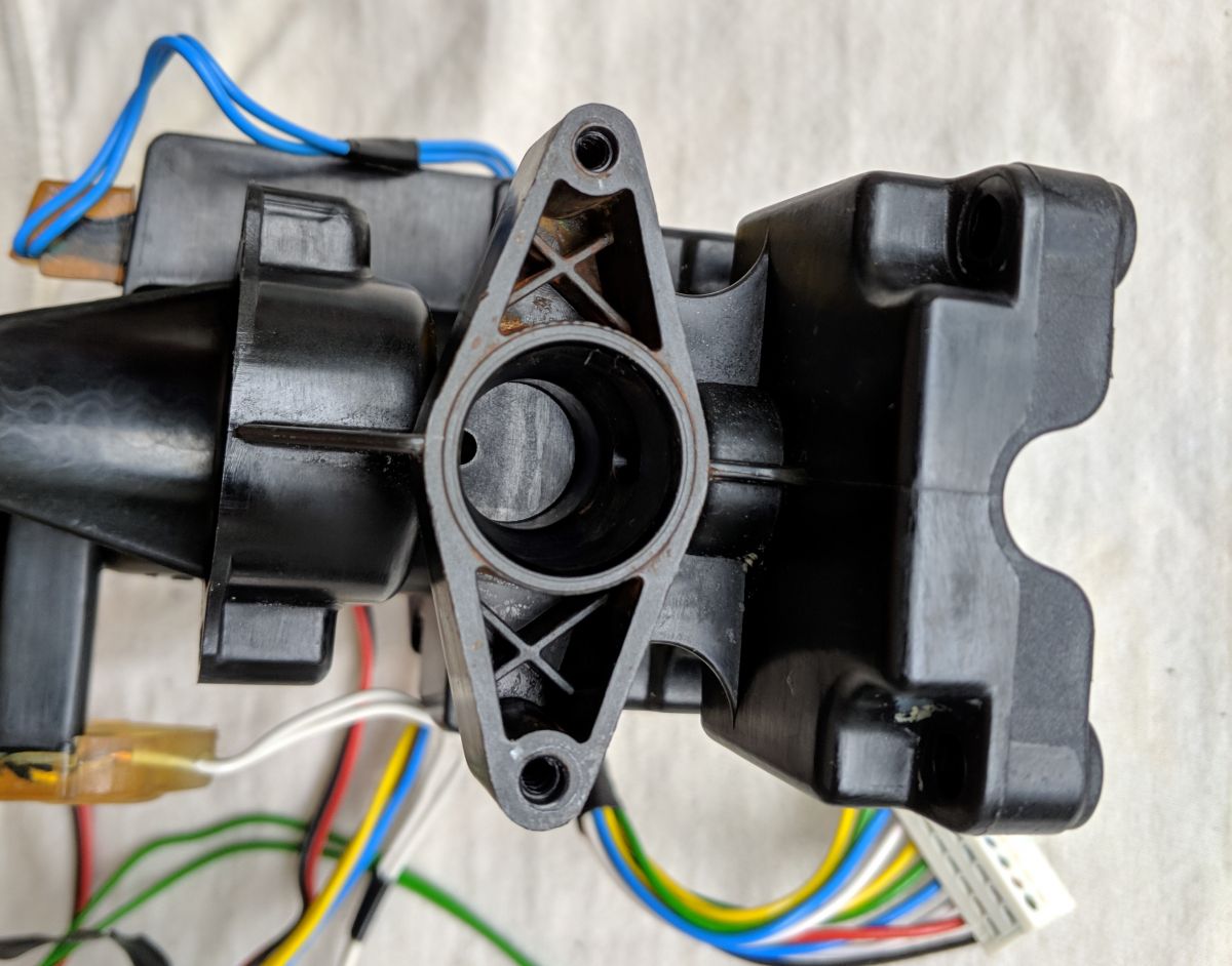

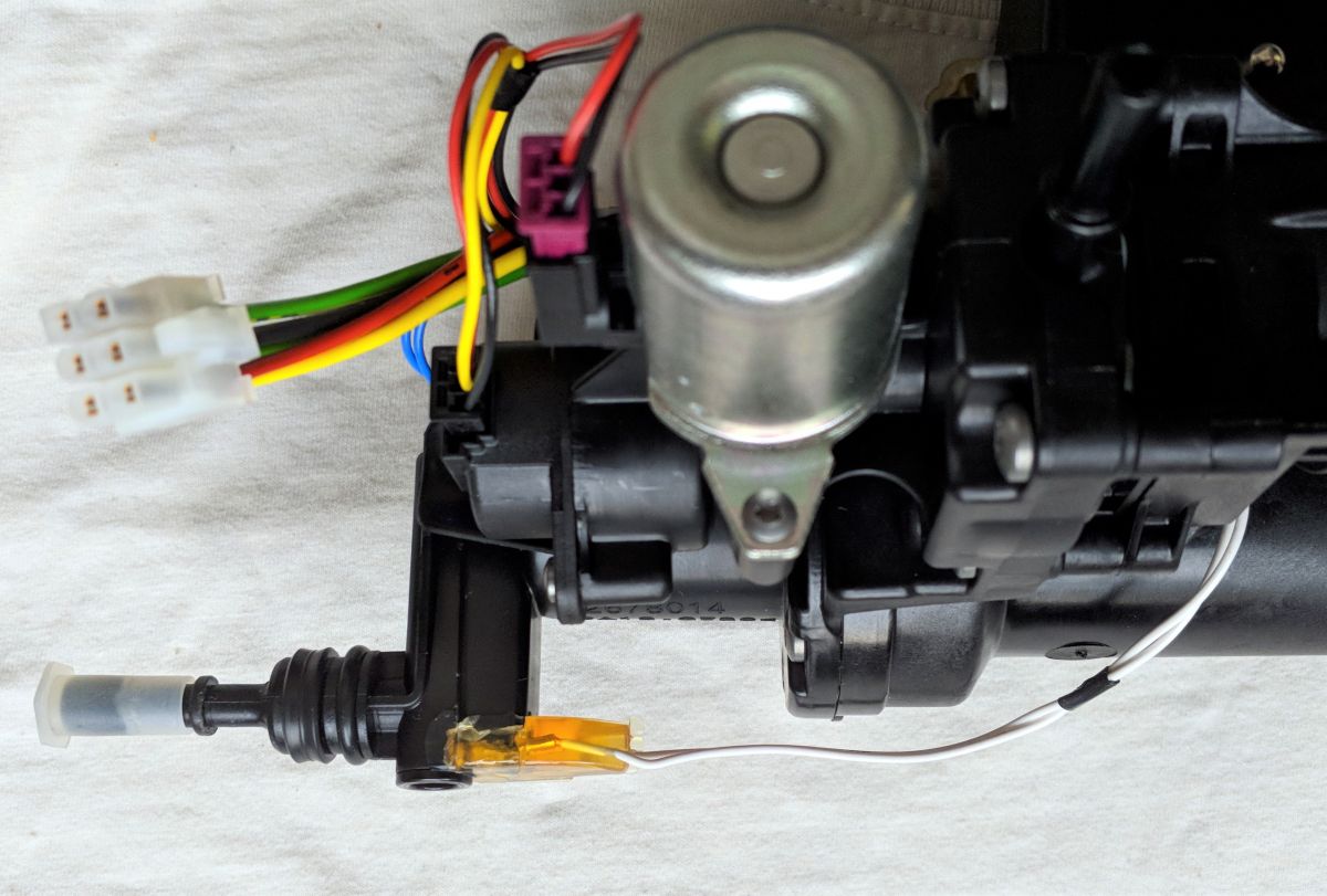

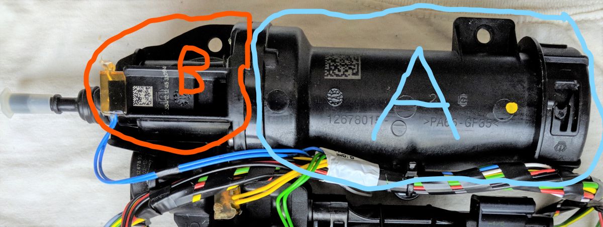

    Below are pictures of the sensors and the heating plate. There is no access to these components!!! You have to cut open the tank and remove part of the housing to make the sensors visible as they are sealed in a plastic box.
    The 100W heating plate and a photo of the temperature sensor placed directly on the heating plate:
    As an addendum to what I have written please read the additional information I posted in this thread in reply #48 of 18 Nov 2022. (#46 18 Lis 2022 13:00)
    A temperature sensor that measures the temperature of the fluid (urea) near the filter through which the pump draws urea:
    PEUGEOT BOXER III - Repair of the AdBlue tank PEUGEOT BOXER III, CITROEN JUMPER PEUGEOT BOXER III - Repair of the AdBlue tank PEUGEOT BOXER III, CITROEN JUMPER PEUGEOT BOXER III - Repair of the AdBlue tank PEUGEOT BOXER III, CITROEN JUMPER
    In red is where the urea temperature sensor is located. This is the outside of the sensor box that is in direct contact with the urea. The sensor measures the temperature of the urea through the wall of the box, which is why there is a bulge here for better contact with the fluid.
    The picture also shows the float chamber of the urea level sensor.
    The urea level sensor consists of a chamber in which a float with a permanent magnet is placed (the chamber is in direct contact with the urea and a Hall sensor board which is enclosed in a sealed housing:

    As I wrote earlier the aforementioned sensors cannot be accessed without cutting open the tank. We can only measure the 3 connection cubes at the end of the wiring harness which enters the chamber located at the top of the tank where the electronics and pump are located. The yellow piece is the spigot with which the pump draws AdBlue from the tank, to this spigot on the other side is connected the filter.
    See photo:
    Picture of the harness with 3 cubes:
    White cube - heating plate power supply
    Black cube - fluid level sensor
    Grey cube - two temperature sensors ( yellow wires - temperature sensor on the heating plate, blue wires - AdBlue fluid temperature sensor)

    Photo of the sensor compartment as seen from the top (sensors and heating plate are on the other side):
    A - chamber in which the float is located.
    B - fluid level sensor located on the other side.
    C - urea temperature sensor located on the underside.
    D - marked place where the heating plate is on the underside.
    The chamber is covered by a white plate with a spring. Inside the spring is a filter through which urea is drawn by the pump:

    The hydraulic system consists of:
    1) a urea filter located in the non-extractable part of the tank.
    2) a pump driven by a small DC electric motor.
    3) an electro-valve.
    4) a pressure sensor.
    5) an accumulator of urea (a small container the size of a glass in which the urea is pressurised at about 5-6 bar, one wall of which is a piston on which a precompressed spring exerts pressure). In its construction, the urea accumulator resembles a syringe in which a pre-compressed spring presses on the piston. When the accumulator is charging, the piston moves under the influence of the AdBlue fluid pumped by the pump, overcoming the pressure created by the spring. Thanks to the spring, the urea in the battery remains at a constant pressure of 6 bar. This means that the electric pump does not run continuously, but only briefly to top up the urea in the battery.
    The principle of the entire urea dosing system is quite simple. Urea is drawn from the tank by a pump and pumped into the battery. The pump runs until a pressure of around 6 bar is built up in the accumulator. The pressure in the accumulator is controlled by a pressure sensor. To prevent the urea (which is pressurised) from flowing back from the accumulator back into the tank, there is an electro-valve between the accumulator and the pump.
    Click on the image.
    The gear pump is not a leak-proof pump, by which I mean that when the pump is not pumping, the liquid already pumped to the accumulator can easily squeeze between the gear wheels and return to the tank.
    For this reason an electro-valve is necessary, which in this case prevents the urea already pumped into the accumulator from flowing back.
    The following operating cycle is performed:
    A pressure sensor continuously monitors the pressure in the battery. While the car is being driven, pressurised urea is fed to the urea injector, which injects further portions as necessary, causing the urea pressure in the battery to drop. If the pressure drops to the lower limit, the solenoid valve opens and the pump recharges the battery. Once the battery is charged, the pump stops and the solenoid valve closes. This state continues until the urea pressure in the battery drops again and the cycle repeats.
    Photo description:
    A+B - battery
    part A - round can contains a spring ending in a piston.
    part B - contains a chamber inside with the volume of a glass filled with urea. One wall of the chamber is the piston.
    Between parts A and B there is a metal ring connecting the two parts and a rubber cap is placed on the piston which acts as a seal. It prevents urea from entering the spring can. See photos below:

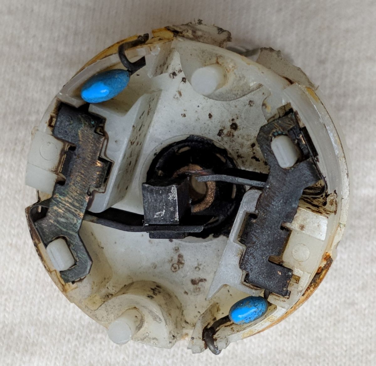

    Pictured below is the damaged engine (it was flooded with urea for a long time and corroded):
    PEUGEOT BOXER III - Repair of the AdBlue tank PEUGEOT BOXER III, CITROEN JUMPER PEUGEOT BOXER III - Repair of the AdBlue tank PEUGEOT BOXER III, CITROEN JUMPER PEUGEOT BOXER III - Repair of the AdBlue tank PEUGEOT BOXER III, CITROEN JUMPER PEUGEOT BOXER III - Repair of the AdBlue tank PEUGEOT BOXER III, CITROEN JUMPER PEUGEOT BOXER III - Repair of the AdBlue tank PEUGEOT BOXER III, CITROEN JUMPER
    The protection diode shown in the picture is TRANSIL DUAL P6KE
    Wikipedia:
    Transil (Transient Voltage Suppressor, TVS) is a specialised protection diode that protects sensitive electronic components from the effects of overvoltage, often used to suppress surges and high voltage pulses. It works similarly to a varistor, but is much faster than it. When a threshold voltage is exceeded, it begins to conduct rapidly. The main advantage of the transil is its very short response time - on the order of 1 picosecond. The popular 1.5KE series allows 1500 W of peak power to be knocked out over a short period of time. The transil can be either unidirectional or bidirectional.
    Pump:
    This is a simple gear pump. One pinion is driven by the motor (shown above) and the second pinion is driven directly by the first pinion. See https://pl.wikipedia.org/wiki/Pompa_z%C4%99bata

    Socket in which the pressure sensor is placed:
    The sensor has a sealing o-ring, is press-fitted into the socket and is secured by two screws.

    Here I will put all the information I was able to get about the SCR UNIT board, components used in its construction, etc.
    Block diagram:
    Selective Catalytic Reduction (SCR)
    How the SCR block works
    The SCR block controls a pump that takes AdBlue from its tank and injects it with a metering valve, into the diesel exhaust gas. To optimize fuel consumption, the gas sensor is downstream of the catalytic reduction process and its information is sent to the diesel engine ECU, which links this information with the engine status and provides the SCR unit with precise information on the correct amount of AdBlue to be administered.
    1) control unit (on the block diagram) on the board marked as U300 to 16-bit Microcontrollers with R8C CPU Core marked as R5F21368WKFP

    4) heaters driver - the heating controller - consists of two systems. One is the 100W 12V heater plate driver marked as U200 it is the arrangement VN5E010FH

    U210 - VN5E010FN - the circuit already described above and
    U211 and U212 - VND14NV04
    This circuit also includes a current shunt R220 with the value of R010, which is used to measure the current consumed by the heating cable, and more precisely to control this circuit. The voltage drop that occurs on R220 is read by the microcontroller and on this basis the processor checks back the correct operation of this heating circuit, detects a break or damage.

    6) CAN bus - layout on the board with the designation U350 this TJA1057 (High-speed CAN transceiver)
    The area surrounded by red dots are elements of the CAN input track terminated with the U350 chip.
    CAN is located on J1 connector pins 3 and 4.

    On the PCB above the chip U120 there is a second + 5V stabilizer U130 it is an arrangement L5150 GJ

  • Suspected ECU and urea controller incompatibility
    #11 19625594
    romano713
    I disassembled the tank three times, no leaks were visible, I checked the valve, pump, pipeline patency and the injector. I emptied and filled the tank physically about 10l and the diagbox. I was pounding on Tunapa. Like you, I suggest that the urea controller cannot get along with the car's ECU. In the denox parameters 1: Estimated aging of the heat catalyst -100%. Maybe the ECU is programmed that you need to replace the tank programmatically in the service? Also, I am not sure if the battery condition matters, because it is about 60% and it quickly enters the energy saving state. In my free time, I will take the tank off again and check all parameters with the meter.
  • Reset and bleed AdBlue tank after ECU error clear
    #12 19626116
    mako122
    Posts: 136
    Rate: 58
    In my opinion no! Even the replacement of the electronic board does not require any special actions. And have you tried to reset or perform the bleeding procedure?
    In the service, after replacing the tank, they perform the bleeding procedure. I did not, and initially there were errors, but over time, as the air through the injector was removed, all the errors disappeared by themselves. In my opinion, you do not need to do any adaptation, but it is worth removing all the errors that are stored in the ECU. Not every specialist can remove all errors stored in the ECU. I have contact with a specialist who knows it very well, but it's a long way from you. For now, I would not disassemble the tank again, but rather delete the errors properly. I bought a damaged allegro tank which had the electronics board undamaged and I replaced it and it's OK. All electronics, I think is the same in all PSA cars, but I think that you cannot replace the PCB from another car model because I am almost 100% sure that it looks the same physically but it is programmed differently, e.g. tanks have different capacity, etc. and in the software probably there are therefore other values stored.
    Have you tried to delete errors? If so, are everything back to normal, are the AdBlue lights off? Everything should return to normal after deleting it, and if there is still something damaged, the errors return, but only after driving, say, 10 km and not immediately. The AdBlue starts to work as the engine warms up.
    One more important note, do not disconnect the tank without first disconnecting the battery !!! This can generate errors and even cause a lack of communication over CAN !!! To be sure, disconnect the battery, wait a few minutes and reconnect the battery.

  • NOx sensor suspected in AdBlue CAN fault
    #17 19825068
    Jean_Phi
    My car has exactly the same problems as yours.
    When she's cold, the adblue system starts up and then shuts down after 30 seconds, which causes U029D 87 problem (Denox communication lost) and thus low pressure problem.
    On the other hand, when the car is warm, if I switch off the engine and switch off the ignition for more than 30 seconds, after restart everything works. The adblue pump is working properly and all the lights are off.
    My engine ECU is EDC17C60.
    Of course, the problem is a problem with the CAN bus.
    There is a NOX sensor and ADblue on this CAN bus.
    If either of them has a problem (such as water or ice on the PCB), there may be a communication problem.
    I think the adblue board cuts off the mini relay because it did not receive the correct information from the CAN bus in 30 seconds.
    I would like to spend more time on this problem, but at the moment it is too cold for me.
    My next test will be to disconnect the NOX sensor and check if the adblue ECU disconnects, which would mean that I have a problem with the NOX sensor ECU.

    Thank you very much for your answer and for all the information you put in this topic. Good job !!!
    I fully agree with you and it is as you write. The computer drops power from the Adblue module.
    I checked it and confirmed it. I just don't understand:
    If there is a problem with communication via CAN, why the first 30 seconds all information reaches the diagnostic interface via the OBD connector? I don't understand that. I am doing the relay test manually, the power goes also and the pressure and urea temperature values show up correctly. During this time, I can also trigger a performance test and the pump is physically working.
    So it looks that all the elements of the adblue module work properly only from the control side of the car, the power supply is dropped after time.
    I will add that after deleting the errors, the first thing that pops up is the pressure error, but only after the car warms up > 55c.
    Maybe there is no problem with communication, only the tank tests itself after starting the car and does not pass the test !! Then it sends a message such as "It does not work properly, e.g. I do not detect the urea heating circuit such and such and please switch me off for safety !!!!! Unfortunately, without knowing the microprocessor software in the tank and its operating logic, it is difficult to say something meaningful. the tank checks its circuits and sends a message to the car's central computer.
    What solution do I see?
    If someone has access to a functional tank, it is worth doing such exclusion tests.
    Unplug all sensor and heaters from the board, etc. Connect the same bare board to the car, but 100% efficient, and see if it drops the voltage after 30 seconds, if so, connect other peripherals and check what causes the voltage drop by deduction. There is a bypass in each urea preheating circuit to inform the tank computer if the circuit is open or shorted. So the tank computer monitors even such things. It knows whether a given circuit is working properly or not. It is enough that one heating circuit consumes too much current or it is open and this may already be the reason that the tank sends a command to the central computer "turn me off" because I have a faulty heater and I cannot continue to work !!!
