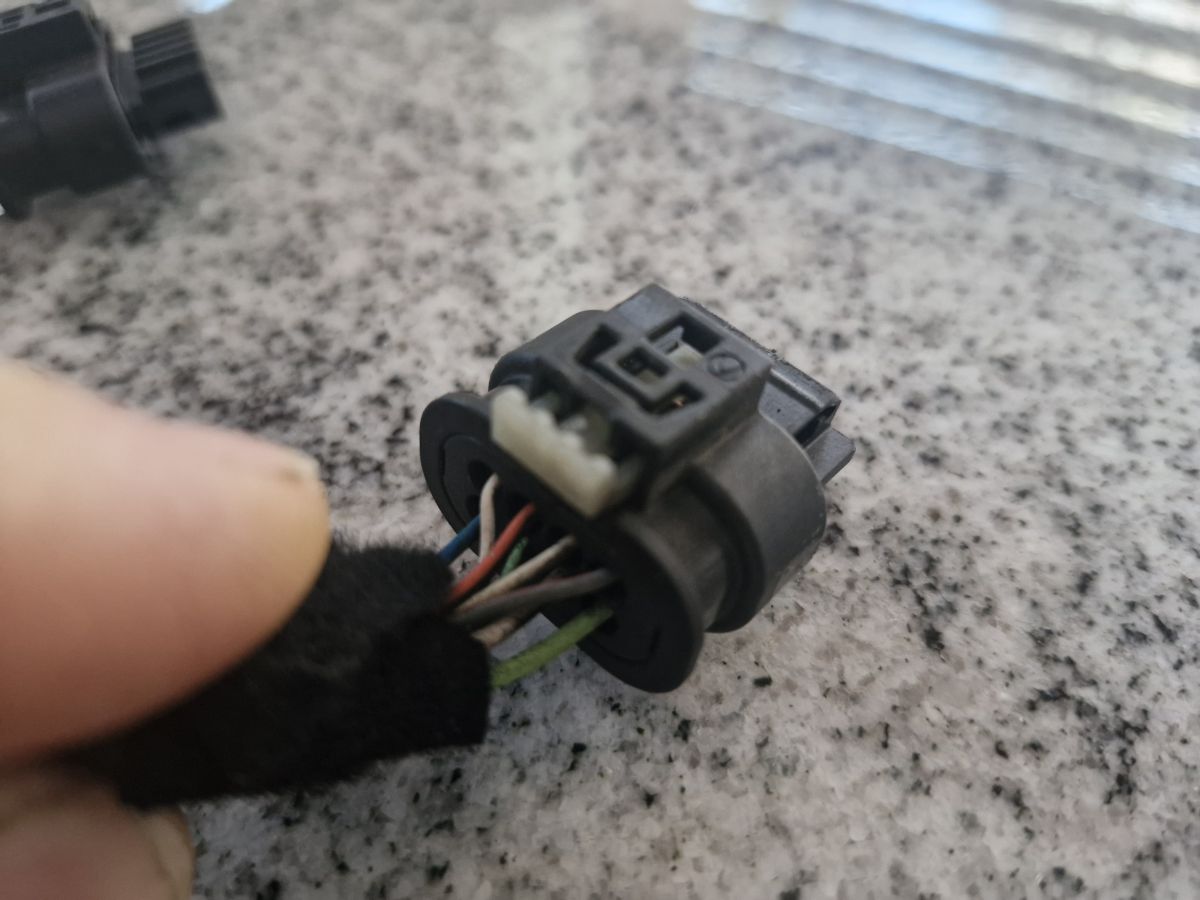

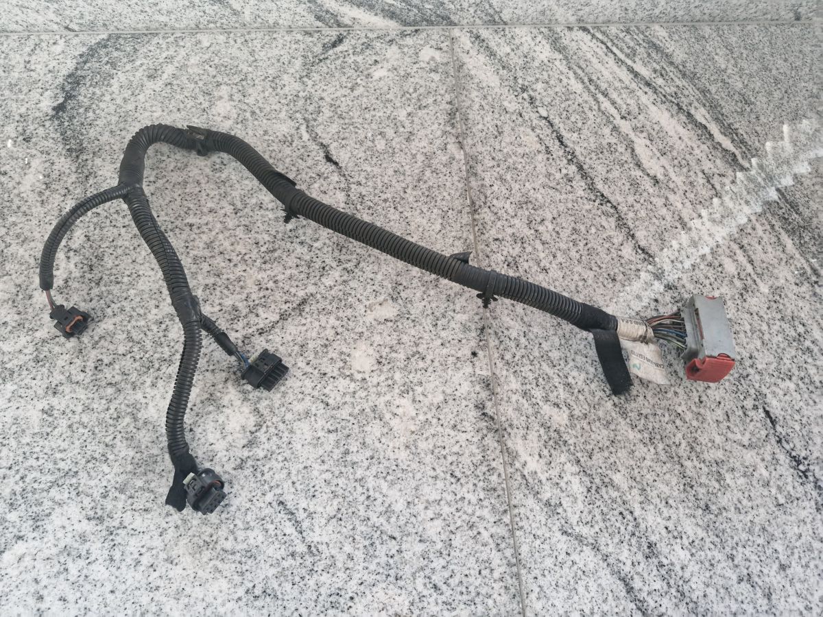

  • Identifying the urea level sensor connector
    #198 21376145

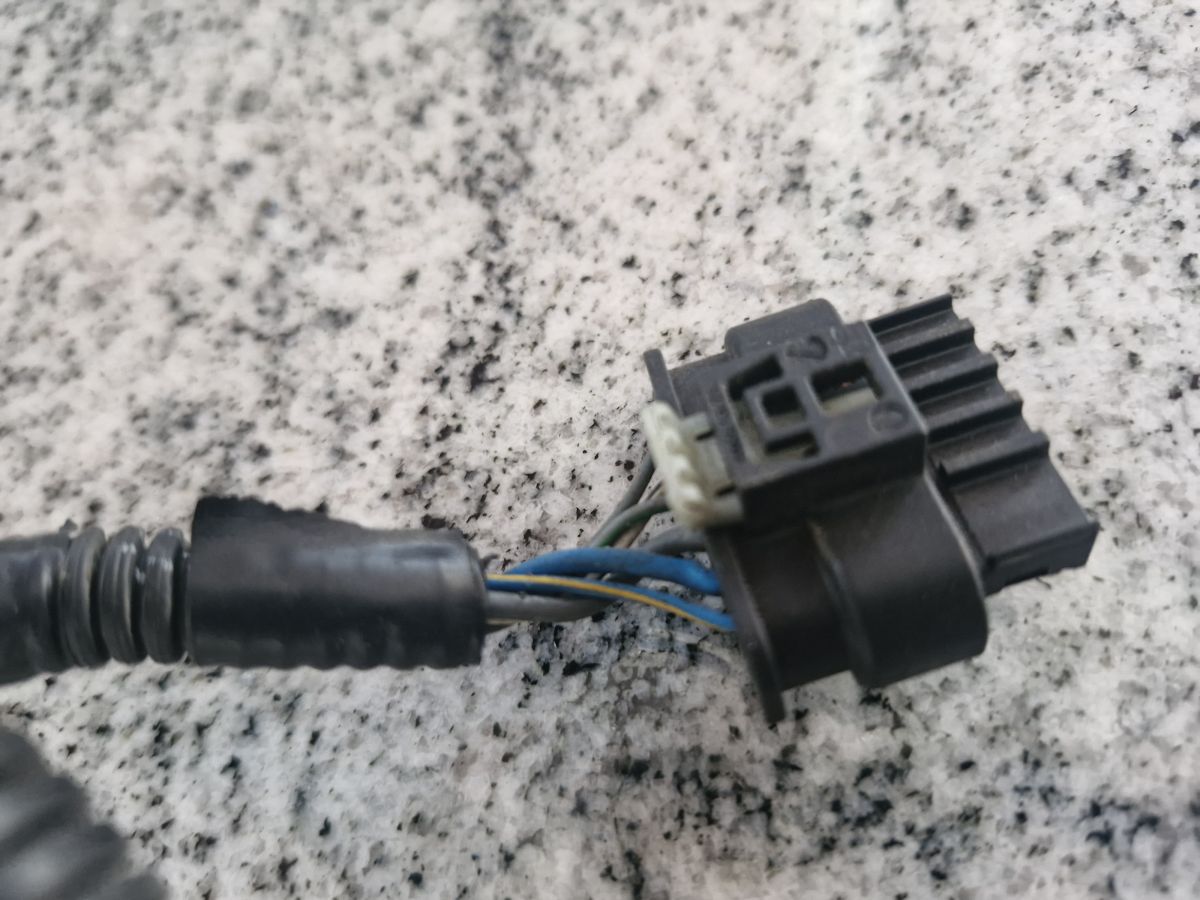

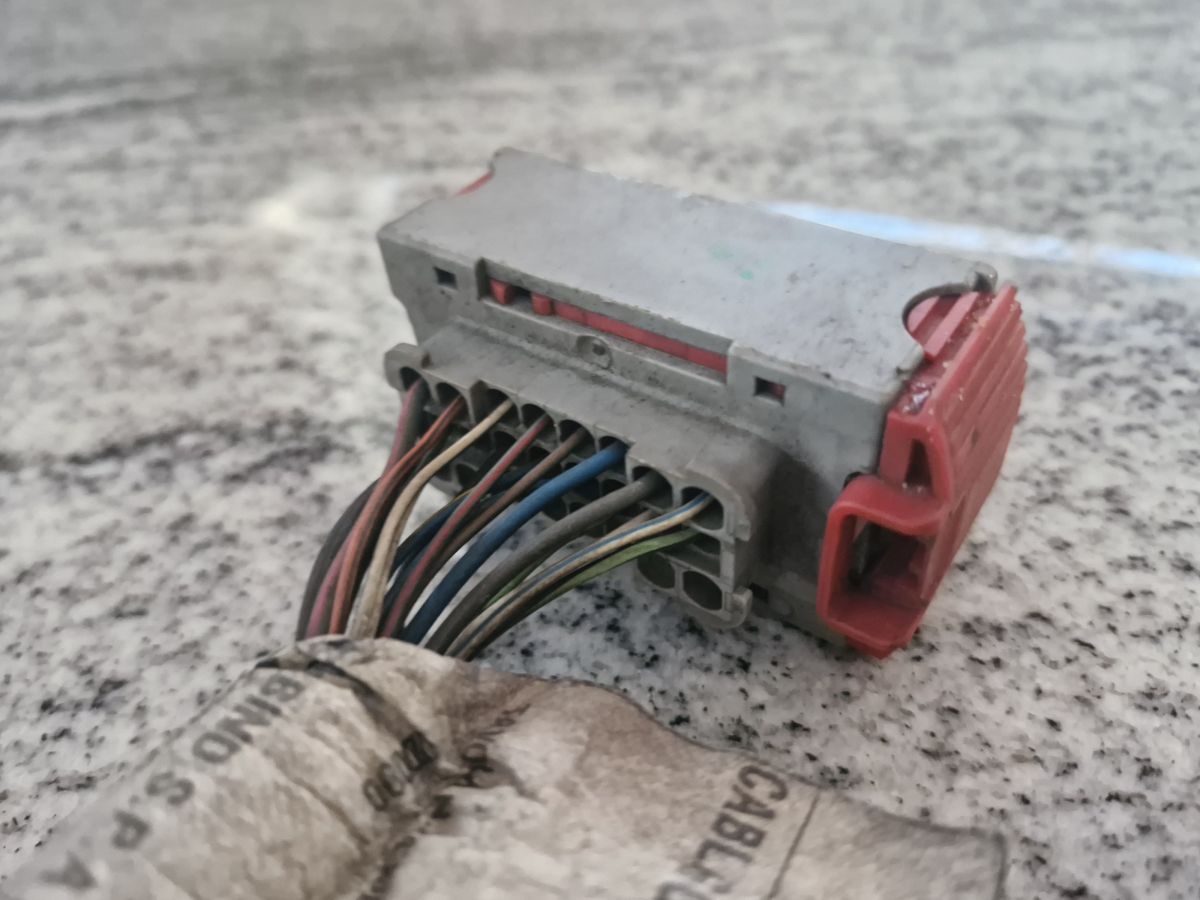

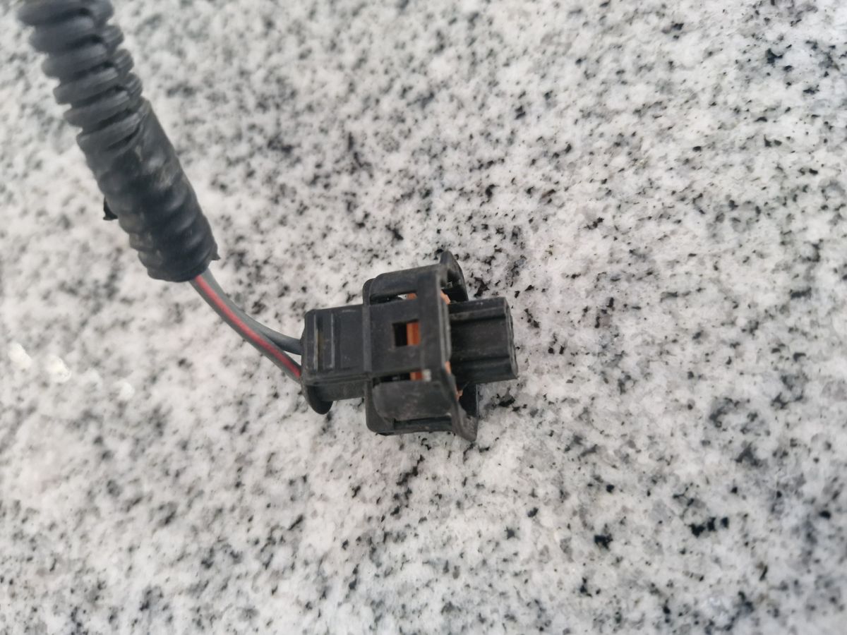

    PIMP_MY_RIDE-P1
    Posts: 149
    Rate: 38
    Close-up of a car electrical plug with multiple colored wires. .
    Photo of an electrical connector with a wiring harness. .
    Close-up of an electrical harness with a black connector, visible wires in blue and gray insulation. .
    Close-up of a car electrical connector with wires on a countertop surface. .
    Wiring harness for the AdBlue system from a Fiat Ducato 2.3JTD 160HP 2019 on a granite surface. .
    Hi! In the photo above is my adblue harness from a 2019 ducato 2.3jtd 160hp
    I need information on which plug it is from the urea level sensor - as the post describes a cube with three wires and I have different ones
  • #199 21376825
    Reflekt
    Posts: 417
    Rate: 58
    The urea level sensor cube comes out of the tank under the controller housing.

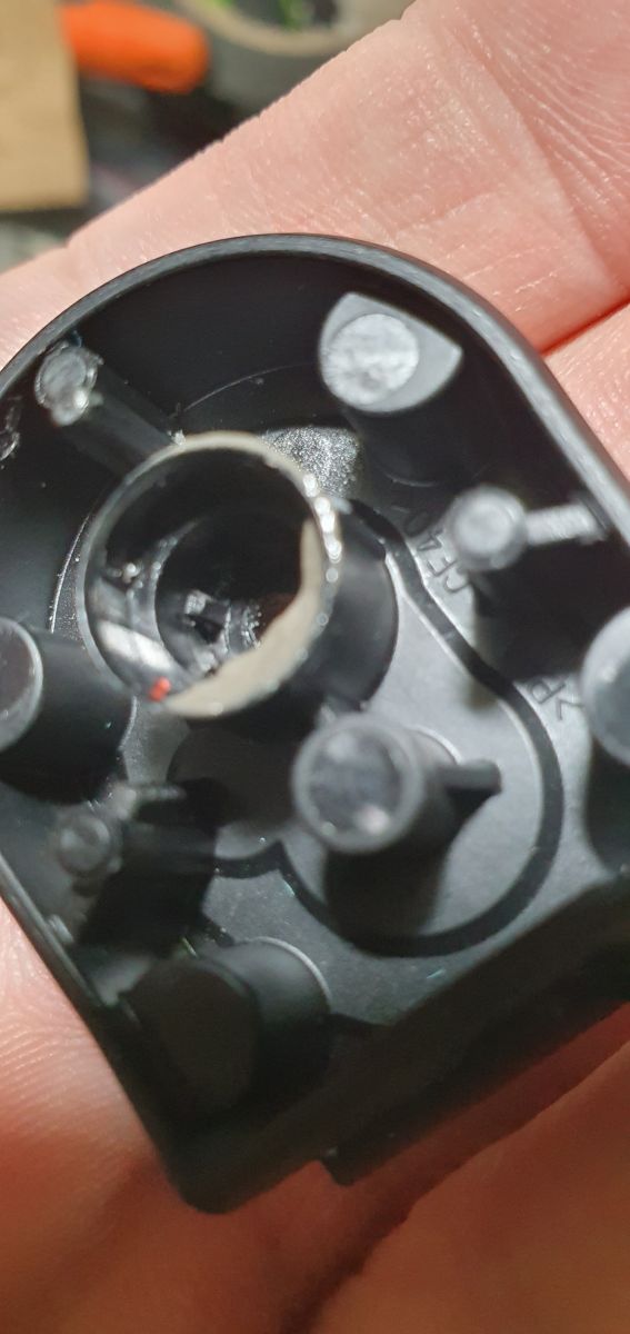

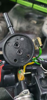

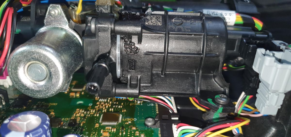

    #200 21400608
    Pablo_Pablo
    Level 4  
    Hey,
    Firstly, thanks to the author of the topic for the huge amount of work put in to work out the whole thing like this.
    I have a problem with ADBLUE in a 2017 C4B7. It started with the message "system fault, starting impossible in 1100 km". I refilled the fluid, the UREA and SERVICE lights disappeared for a while, but after a few kilometres the problem returned. On top of that, the check light came on. Pressure error on the comp, of course. Added fluid top-up, errors cleared and of course it all came back after a few kilometres. So I started by charging the battery and inspecting the whole system. No mechanical faults - everything looks like new. After pulling out the tank and unscrewing the housing, you can clearly see a leak at the pump - I'm uploading photos.
    View of the interior of a car's AdBlue system with a pump. .
    Image of the vehicle's container interior with leaking fluid near the pump. .
    Close-up of AdBlue pump with visible leakage and car electronics. .

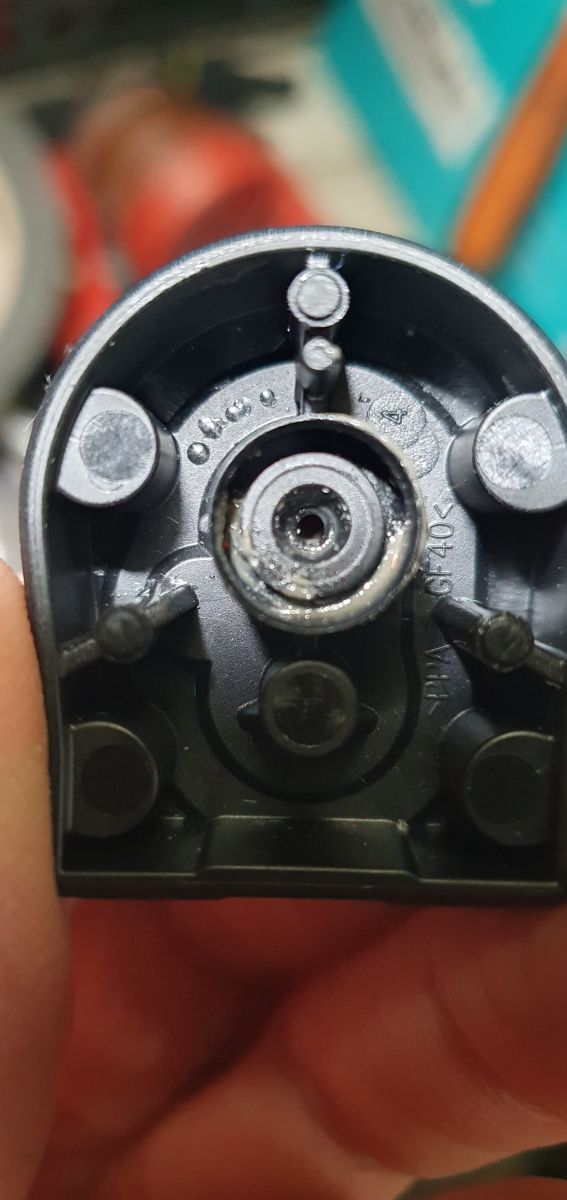

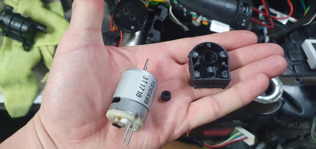

    After disassembling the pump I presume the culprit is the simmering on the motor shaft - fortunately I took everything apart quickly and the motor is like new.
    Has anyone managed to get hold of such a simmering? The smallest I've been able to find is 3 or 4mm and here the shaft is 2.3mm.
    Motor and housing of AdBlue pump on a hand. .
    Unfortunately buying a used pump is a high probability of the same problem.

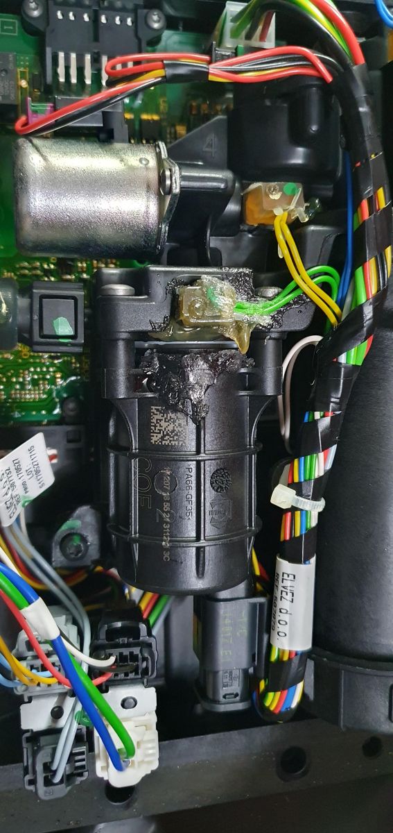

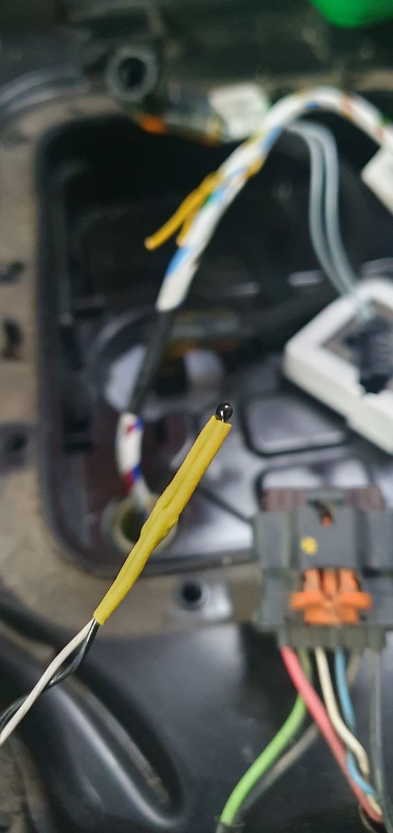

    In addition, after measurements I found a defective SMD thermistor - the yellow circuit in the grey cube - measuring only 0.37 kΩ at 14 °C. The rest of the circuits after checking seem to give correct values. The only thing left to do is to check the fluid level circuit, but should it turn out to be broken, I will use a divider.
    And here is my question - what power resistors did you use for the divider?
    Thanks in advance for your help.
  • #201 21400694
    mako122
    Posts: 136
    Rate: 58
    Any, there is very little current flowing there. They can be for example 0,25W as for this simmering someone had a way to do it. I'll try to look for it soon and provide info. I sent a private message.

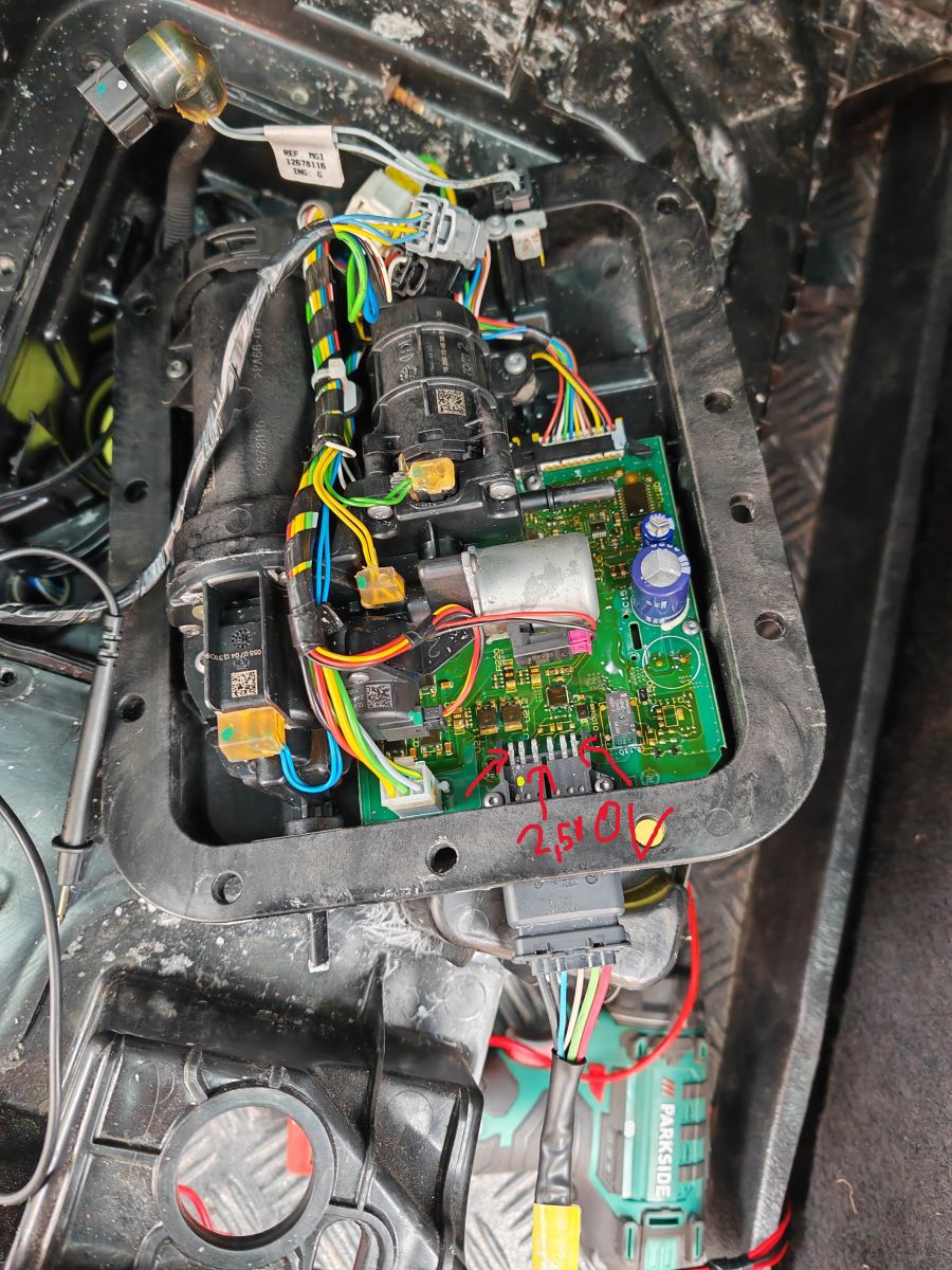

    krisf6
    C4 GP 2.0 BlueHDI. Adblue error no communication with can bus U029D 87 and P2BAD00. Tank removed, electronics and rest as new, pump working, other components checked. I still have a board to swap but does that make sense?

    #203 21418720
    mako122
    Posts: 136
    Rate: 58
    >>21418636 .
    Please check the plug that goes to the tank. The two thicker wires are the power supply and the two thin ones so twisted are the CAN. Maybe there is no contact in the plug or it is corroded. If there is, check the part of the board that is responsible for CAN communication. There is a description in this thread which part of the board it is. It makes sense to replace it because the other board may have this part in working order. Please look for damage under a magnifying glass. It is necessary to check whether the tank is supplied with 12V because if not, communication will not work because the board must be powered for CAN to work.
  • Missing circuit on replacement AdBlue board appears normal
    #204 21418750
    krisf6
    Plug checked, power supply is there. The harness between the plugs also has passages, generally everything looks like new, no signs of corrosion, oxidation, etc. I have the same board only from another vehicle, dismantled as working.

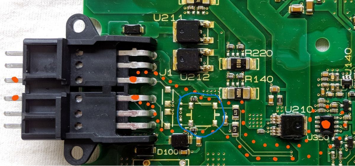

    Added after 20 [minutes]: .
    Close-up of a green printed circuit board with various electronic components, including a connector and a marked area. .
    There is some circuit soldered in the marked area on my board, on the board I want to substitute there is not.
    On both boards the resistance of the can circuit is the same 126 ohms. Conclusion, there is no fault?
  • Oscilloscope check of CAN data and harness fault
    #205 21418875
    mako122
    Posts: 136
    Rate: 58
    >>21418750 .
    If the Lord had the opportunity to check with an oscilloscope if any data is flying over this CAN. Maybe there is a problem with the harness somewhere further down. A board from another car is unlikely to fit because it won't get along with the engine computer. I mean a different type of vehicle e.g. one is a C4 and the other a C3 because they have different software often different AdBlue tank capacity etc.
  • #206 21418887
    krisf6
    Where under the bonnet does this harness go? I could check for a break.
  • AdBlue tank power cut after 30-second self-test
    #207 21419452
    mako122
    Posts: 136
    Rate: 58
    >>21418887 .
    I don't know how it is in your car because I don't know this model. Often the signal goes directly to the ECU (Electronic Control Unit), which is the central control computer.
    You may find information here: https://dailydriven.ro/pl/jak-dowiedziec-sie-gdzie-znajduje-sie-ecu-w-citroen-c4
    But I would not stick strictly to this message, but check the tank, heaters, etc. Look at the electronics under a magnifying glass etc. Often these errors do not indicate what is really faulty. Please read this thread carefully. The car, after starting, tests the tank for about 30 s and if it does not get a positive answer that it is OK then after this time it stops supplying power to the tank (cuts off power completely with a relay) then after this time there is no more communication with the tank because there is no power and it is no wonder that you can get a com that there is no data over CAN from the tank. As the car has not been in an accident etc it is unlikely that there is a faulty harness. I definitely think that it is not a problem with the communication over CAN rather somewhere else you have to look for the cause.

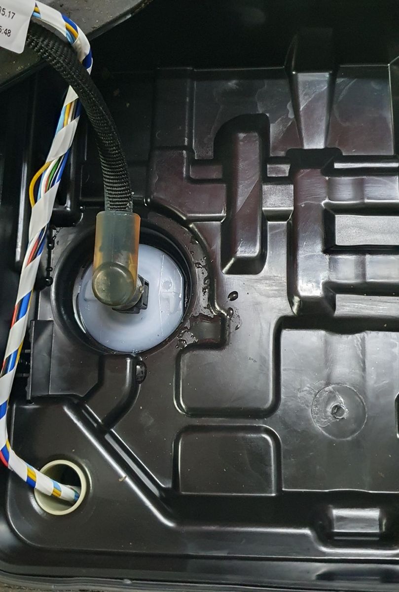

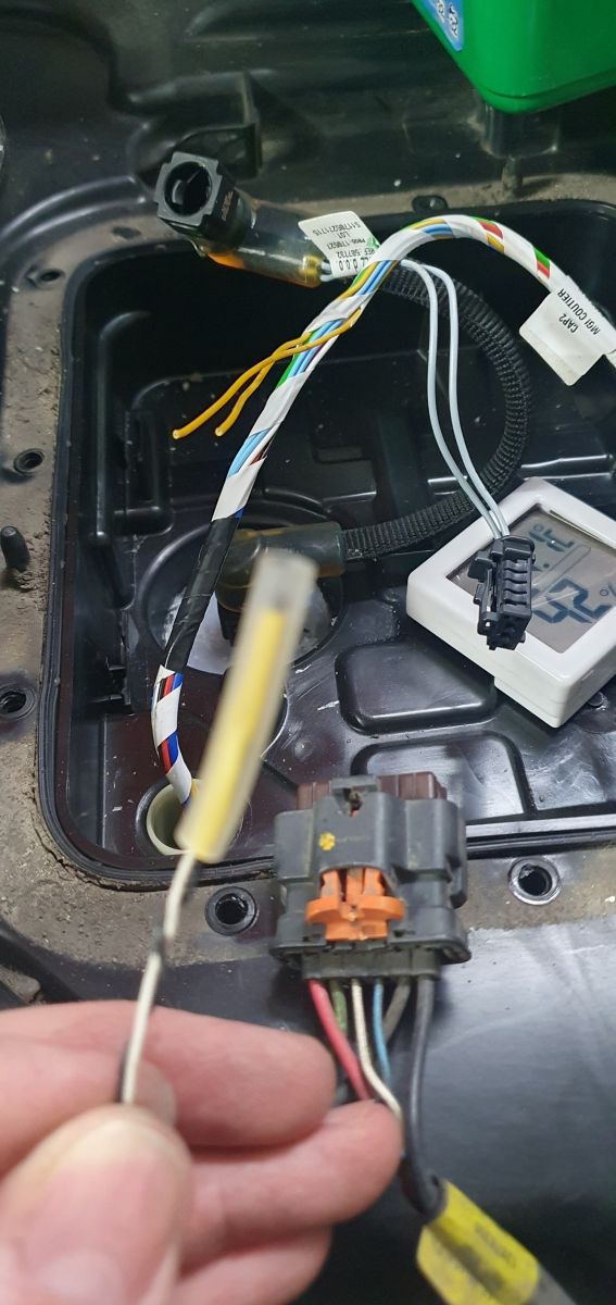

  • 10 kΩ thermistor and O-ring pump seal repair
    #208 21426633
    Pablo_Pablo
    Level 4  
    Hey,
    I'm posting an update because I promised the topic founder, and he deserves credit for his immense work.
    After about 2 weeks of using the car, I consider the repair successful :) . In my case, the repair consisted of replacing the thermistor and sealing the pump. All other components proved to be in working order. I bought a regular 10kohm thermistor. After cutting the circuit from the tank, I soldered a new one, put a piece of silicone tubing over it and inserted it through the hole where the wiring harness goes - as far as possible.
    Close-up of electrical wires with attached thermistor. .
    Car wiring repair with visible thermistor and electrical connectors. .

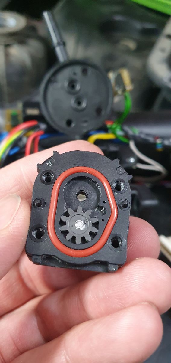

    I sealed the pump by replacing all the o-rings with new ones. I replaced the two smaller ones with a different size from the originals, according to the information from the author of the post - and here again a big thank you for your help and interest!
    Close-up of car pump components with visible wires and O-rings. .
    The new o-rings are 5.5 x 1.5 - 70NBR - they are thicker and it is noticeable - they sit tight and when assembling you have to gently tighten each screw diagonally so that the plastic part doesn't break from the stress - the difference is really quite substantial.
    I fitted a larger o-ring with 22x2 silicone - 70 VMQ.
    View of repaired mechanical part with a gasket. .

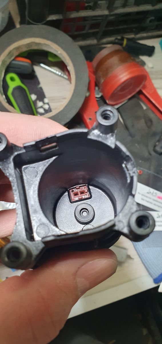

    And now the most interesting thing about this leaking pump - the main culprit for the fluid leak into the motor housing is the simmering on the shaft, which is unusual and cannot be bought anywhere.
    7bbc2a748 .
    It is embedded in such a "socket"
    View of the inner part of a plastic casing with a spot for an O-ring .
    It just rests on the circumference on the spline visible in the centre. So I figured it out like this:
    I purchased 2 tiny 2x2 o-rings that fit perfectly in the centre of the spline, but fit snugly over the motor shaft - it has a diameter of 2.3mm. The height of the spline is 2.5mm and the 2 o-rings on top of each other give us 4mm, so that the simmering ring protrudes slightly when inserted into the socket.
    Interior view of a pump with an installed seal. .
    As the housing at the rear has a rubber drag that presses the motor inside us, putting everything together "crimps" the tapered inner part of the simmering in the protruding o-ring, giving us a tight seal on the shaft.
    Interior of a car pump part with a visible seal mounting spot. .
    Once assembled, by turning the pinion on the motor shaft you can feel a marginally higher resistance but completely non-threatening to the engine.
    After putting everything together, I cleared the errors using the app from my phone and so far they have not reappeared.
    Best regards and thanks again to the author of the topic!!!
  • 10 kΩ series resistor fixes AdBlue tank fault
    #209 21461118
    baldy77
    Hi all,
    I had to register to say thank you! With the help of this forum I repaired my Adblue tank. Problem was with the urea heating plate, NTC had a resistance of about 400 ohms. So I added a 10Kohm resistor in series with the "yellow-yellow" wire and now the check engine light and urea light are turned off. Diagbox says there are no faults anymore, yippee!!
    I encourage everyone with Adblue problems to try repairing, it is not difficult.
    Thank you so much mako122 for starting this Adblue repair-thread!
  • Faulty AdBlue thermistor bypassed with external sensor
    #210 21484538
    mlody300
    Posts: 84
    Rate: 39
    >>21461118 I also had the same thing, these thermistors are faulty and there is no access to them, I used a second thermistor inserted into the tank along the cables .I know that this will not measure the exact temperature of the heater but there will be reactions to temperature changes. I would not risk including a resistor in series, this defective thermistor may completely lose conduction, any change in resistance and the tank will be removed again. It is better to disconnect it completely and put a resistor in its place.
