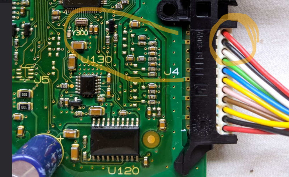

    Hey,
    thanks for this great work and detailed description of the adblue (disaster-)tank of Citroen.
    What kind of electric motor is it? With the number, which is printed on, I can't find anything. Does anyone know where I can get a replacement?

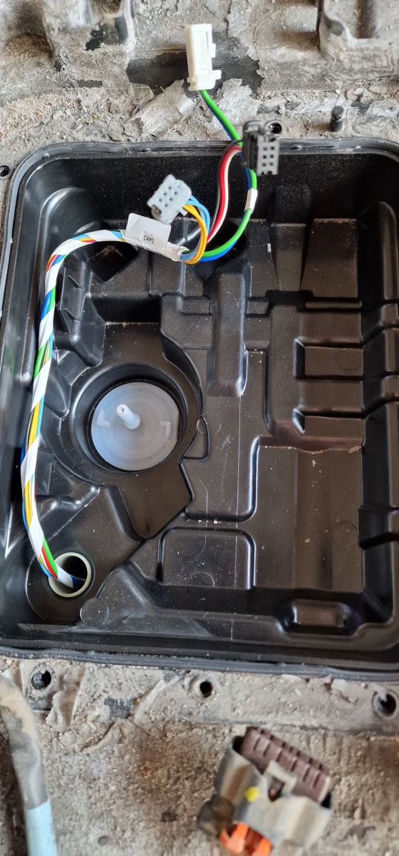

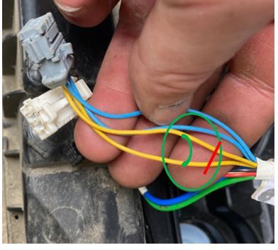

  • Asking resistor wattage and yellow-wire placement
    #152 21058570
    roule35
    >>20135435
    Bonjour,
    Je penses que j'ai le même problème de capteur. J'avais 2 questions sur cette résistance de 10 K Ohms :
    Quelle est sa valeur en watts ?
    Sur quelle partie des fils jaunes tu l'as installée ?
    Merci beaucoup pour ta contribution.
    Hi,
    I think I have the same sensor problem. I had 2 questions about this 10 K Ohm resistor:
    What is its value in watts?
    On which part of the yellow wires did you install it?
  • #153 21066123
    Reflekt
    Posts: 417
    Rate: 58
    Power of resistor 0.25W, you connect in series with the yellow wire at the plug so that it is easy to solder
  • #154 21066785
    roule35
    You mean like that ?
    A hand holding a bundle of wires with yellow, blue, green, and red wires.
    I have 200 ohms resistance between these 2 yellow wires ...may be the reason of my pressure issue ...
    Another problem to resolve : I only have 0,5 bars on the diagbox computer , seems to be a data connexion issue with the ECU ??

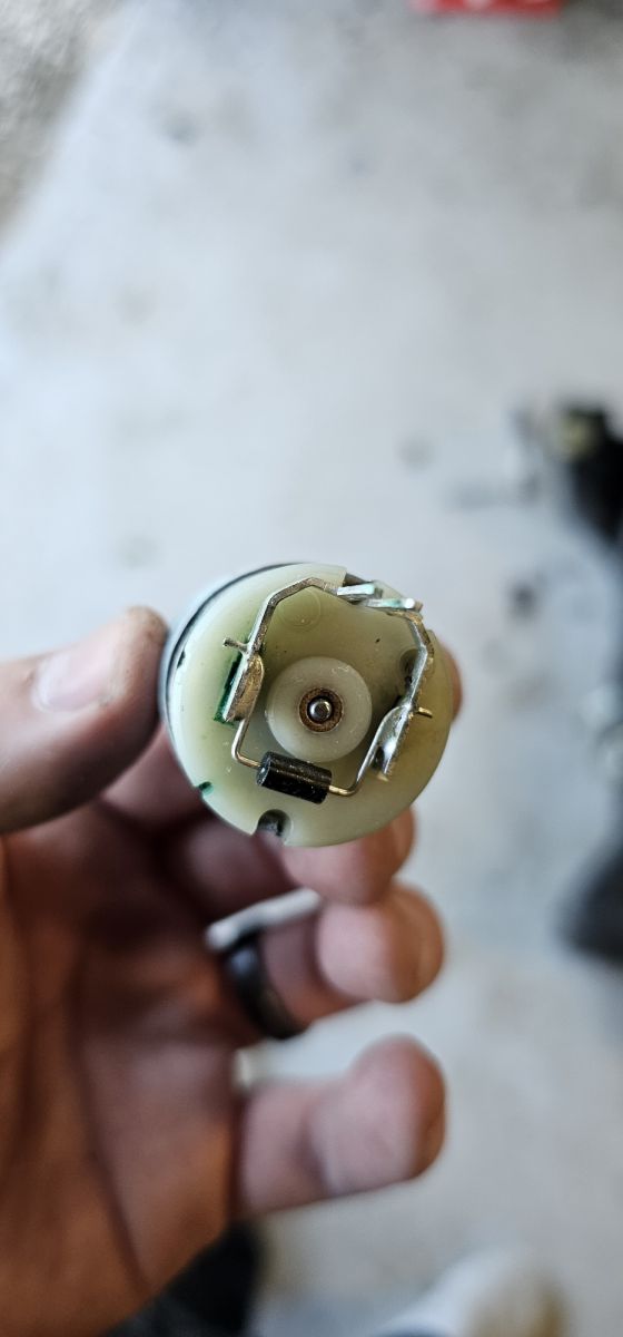

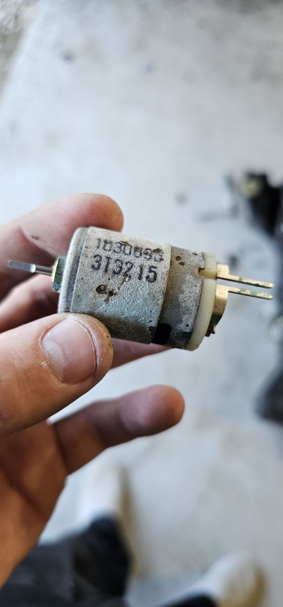

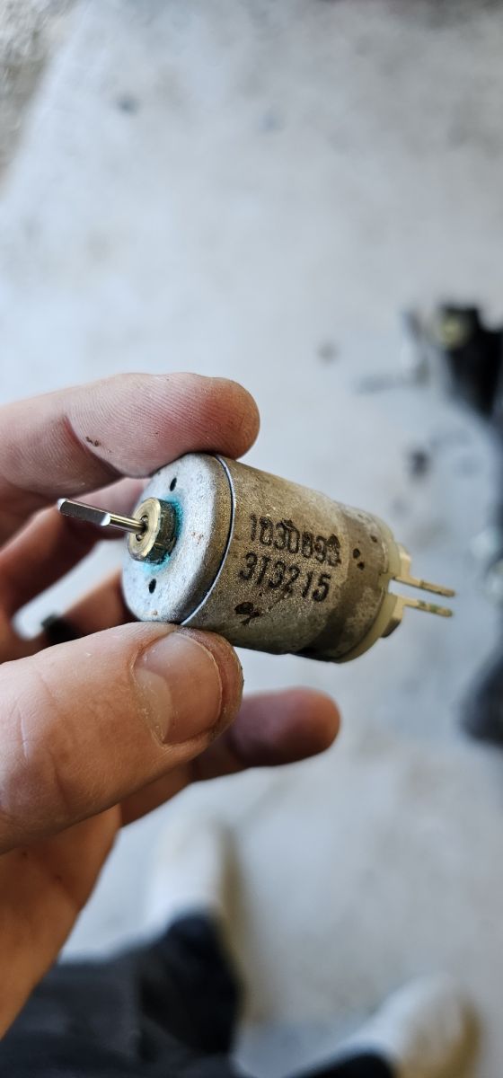

  • Seeking replacement pump motor for seized AdBlue tank pump
    #163 21115569
    mitchcisco7
    Hi, has anyone been able to source a new pump motor? The bushes have broken off of my current motor and the motor has seized. I was wondering if there is a replacement motor available out there that would work in its place? The code on the Motor does not refer to anything on Google (That I can find).
    Any help on this would be greatly appreciated.
    Thanks.
    Close-up of a damaged pump motor held in a hand. Person holding a small electric motor with markings 103088 and 913215. Small electric motor held in hand with visible number 313215 on the casing.
  • Worn shaft seal lets AdBlue flood pump motor
    #164 21116222
    gemiel
    Level 26  
    Posts: 579
    Help: 79
    Rate: 305
    mitchcisco7 wrote:
    Hi, has anyone been able to find a new pump motor? The bushings in my current engine have broken and the motor has seized.
    First of all, you need to get a new simulator, which seals the engine shaft. It is through its wear that the adBlue enters the pump. This is why the motor is primed first and then the entire electronics.
    Unfortunately, I have not been able to find such small simulators or motors anywhere. The motor can be used recycled, the sealer unfortunately not.

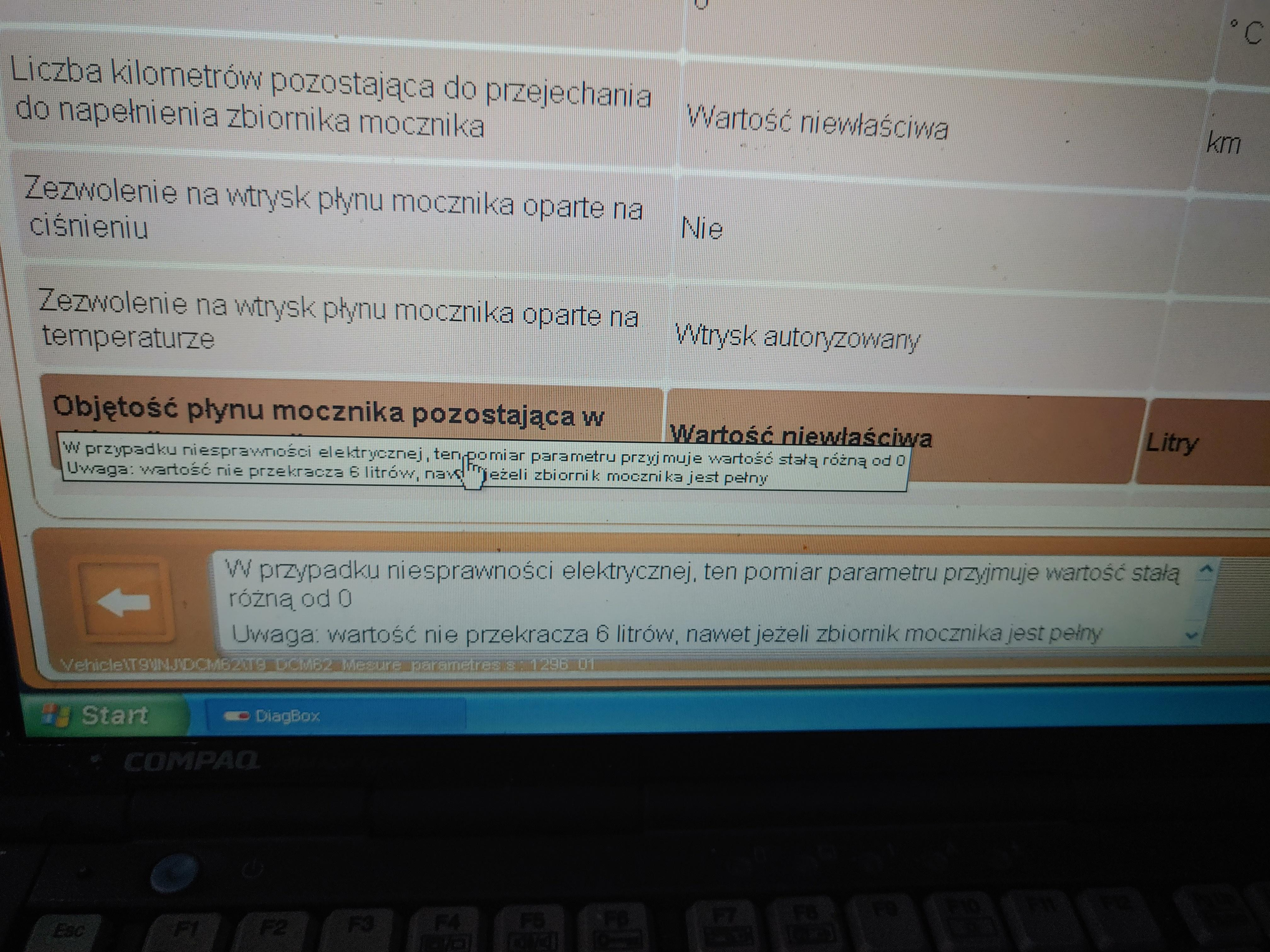

  • Urea tank level and heating faults persist
    #167 21128609
    sperma
    Welcome,
    First of all, respect for your analysis on this topic !!!!
    I have a 2016 peugeot 308 2.0 hdi automatic. The car has a mileage of 83 thousand km. Some time ago an error appeared to me, known to all in this topic of this forum P20E8- urea pressure.
    On the display of course the Christmas tree check engine and service and urea light.
    Plug from adblue new type.
    Db shows 4 bar.
    So far I have checked the injector and the pipe from the tank to the injector is unobstructed.
    I quickly dismantled the adblue tank, unscrewed the pump. I didn't see any leakage or traces of urea on the plate.
    I added urea under the cap, did a urea drain and still the error pops up.
    One thing puzzles me.
    Db shows with full tank in position
    "Volume of urea liquid remaining in the urea tank - incorrect value.
    As I drained all the fluid from the tank wanting to flush it with warm water it showed a value of 0,000.
    I filled the tank again and still the value was wrong.
    As I was cleaning the tank I could hear the float moving. But the puzzling thing is this result with a full tank.
    I have another conundrum.
    The "urea line heating" test - result of heating failure.
    Test "heating of urea tank"-result also failure of heating.
    Db, however, despite these negative tests in the option:
    "Authorisation of urea fluid injection based on temperature"-result- authorised injection.
    "Temperature of urea fluid in the urea tank - always shows 0*C. Recently it seemed to me that it showed 22*C for a while, but after refreshing it was constantly 0*C.
    Apparently these two heating tests are negative, but it allows injection.
    I am also puzzled by another point in the test:
    "NOX system relay control test" a noise should be heard. The result is successful, no defect, but I do not hear the noise.
    If, for example, there is a "test of the urea injector control", noise should be audible - the result is noise.
    I think that as the db will see the adblue level may improve something, because systemically it has an unknown value so far.
    It also makes me wonder:
    "NOX system pressure build-up control"-result- stuck clutch pedal, and it is an automatic after all.... Wondering what I can do to make this test give some result.
    Another conundrum:
    "NOX system vent check" - no result, the program comes right out to select individual tests.
    "Operating status of the NOX system"-result of the indicator-pump urea module switched off at blank.
    This is so far what comes up for me.
    For now, I wanted to check all the components before I got down to checking the electronics.
    But under this heading. "Volume of urea fluid remaining in the urea tank" is commented on from the photo in the appendix, so it's as if there's something wrong here, but it puzzles me that with the tank empty the value is given as zero but the value shows something.
    Thank you in advance for any guidance

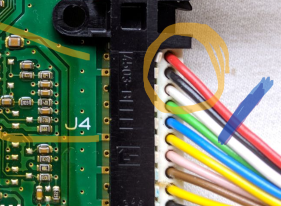

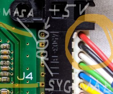

  • Testing the AdBlue level sensor with a 4.5V battery
    #168 21128836
    mako122
    Posts: 136
    Rate: 58

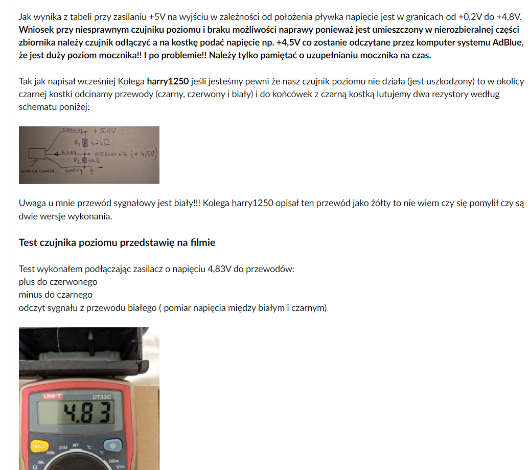

    >>21128609 .
    I don't know which AdBlue level sensor you have. There are supposedly several versions. If you have one like the one described in this thread then check that it works properly. To start with, check two states.
    You check on an empty tank.
    Disconnect the 3 wires from the sensor from the electronics board and do as described in this thread above. Just power the sensor from a 4.5V flat battery and read with a voltmeter what the voltage is on the third signal wire. You do this in two positions of the tank.
    The tank in the "normal" position and the second position the tank turned upside down" and you read in these positions what the voltage is on the signal wire. If the tank passes this test, you can do a thorough test of this sensor by filling the tanks slowly with water and observing how the voltage on the signal wire changes. How to do this you have a description above in this thread. I hope I have described it clearly. If not then write boldly I can also help you with a phone call on how to do this.
    Read the description in this thread from what you have in the picture below. There is also a video on the sensor test there.
    Screenshot from a forum with a description of an AdBlue level sensor test and an image of a meter displaying voltage. .

  • #171 21129399
    sperma
    >>21128991 .
    Doing as you wrote with an ac voltage of 5.99 V.
    Between white and black:
    - on an empty tank: 0,54 V,
    - on a flooded tank (poured about 10 l) where the value no longer
    increased: 5,30 V.
    What else can be checked, and could be the cause of the incorrect display of the urea quantity?

    #173 21129469
    mako122
    Posts: 136
    Rate: 58
    >>21129399 .
    This means that the level sensor is working correctly. You can still check with an ohmmeter whether there is a correct transition of these three wires to the contact point on the electronics board. whether there is any damage there. You can also replace the level sensor with two resistors according to the diagram in the photo above as a test. You will be sure where to look for the problem. If you insert the two resistors as shown in the diagram right near the edge connector, you will not only bypass the sensor itself, but also the whole path from the sensor to the edge connector, because there is also another connector on the way.
    Check under a magnifying glass whether there are any printing defects in the area of the edge connector (no copper path) or whether the edge connector itself is damaged. You can also apply 12 V to the board (supply power to the whole board and check that there is +5 V on the wires to the sensor (if the sensor is powered).
    Of course, if you want to replace the level sensor with resistors then you have to cut these three wires near the edge connector (cut the sensor off) and solder these two resistors to the ends going to the edge connector. (Maybe I shouldn't write about this, but a colleague has already soldered these resistors without cutting off the sensor, so I prefer to point this out because not everyone is an electronics technician)
    Check the area of the board circled in yellow and the wires marked in the yellow circle.
    You can cut these three wires here where I have marked in the circle and solder the two resistors here.
    Image of a circuit board with a marked section and a bundle of wires. .
    I have marked the cut lines of the three wires in blue and at this point to be sure there is a transition to the sensor do the sensor test you have already done. This black edge connector should be unplugged from the board and checked for dirt. It is a good idea to wash it with extraction benzine or, even better, CONTACT-CLEANER for the contacts.
    Close-up of a circuit board with marked wire section. .
    Close-up of a circuit board with an edge connector and marked wires.
  • Dashboard AdBlue range capped above 5000 km
    #174 21132140
    sperma
    >>21129451 .
    Yes I know, I have already read this and on my tank I have verified it, the voltage values changed up to about 10l pour.
    Added after 8 [minutes]:
    >>21129469 .
    I'm waiting for the resistor and will act.
    The board looks very bare to the naked eye but with a magnifying glass I will check.
    Checking on the dashboard with the 000 button how many km left to run on adblue I came up with (with full tank) over 5000 km. Is this the maximum amount the computer can show? Is it only showing that much due to the unknown level of urea?
  • AdBlue gauge tops out above 5000 km
    #175 21132702
    mako122
    Posts: 136
    Rate: 58
    >>21132140 .
    The computer when the float is in the maximum upper position shows (depending on the car model, because it is usually different in each, it depends on the engine power and the capacity of the AdBule tank) that you can still drive more than 5000 km. It is only when the float begins to fall that the precise measurement takes place until the float reaches the lower position, and when this happens, the warning message "Fill up with AdBlue, because you can only drive e.g. 400 km" appears. In this situation, you get a message on the dashboard every, say, 50 km saying "top up with AdBlue".
    In summary, the computer will not show more than 5,000 km because it is not possible to do so, this is due to the design of the tank and the level sensor.

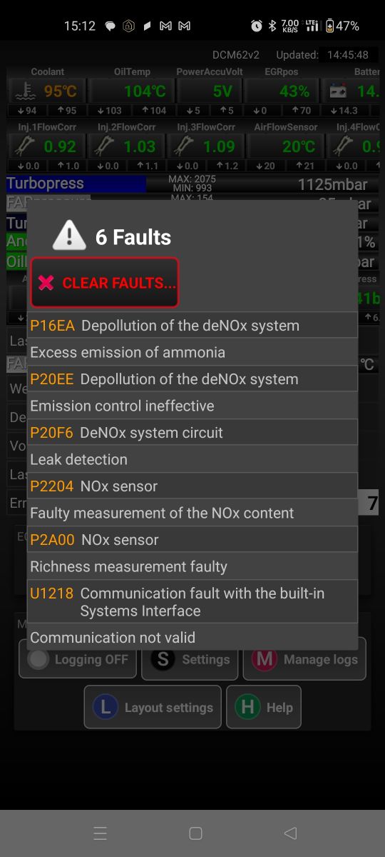

  • #178 21136876
    mako122
    Posts: 136
    Rate: 58
    >>21135311 .
    This is a very difficult matter because of the lack of access to documentation, software etc.
    And what is the error? Because maybe it is not about the AdBlue level maybe the cause lies elsewhere.
    I have had different errors P20f6 in a moment P2a00 or P20e8 and the cause was the same.
    What errors do you have?
  • Measured AdBlue tank heaters, pump, and valve readings
    #179 21137055
    szustakowski
    Good morning,
    It got me too, the car is a Peugeot 308 SW, 2.0 HDI, 2016.
    Error 20E8. Alpine combinations of DB like colleagues from 308 brought exactly the same test results and the same behaviour and readings. Here is my observation, DB does not quite handle the 308. Hence perhaps the misleading missing test results of e.g. the line heater to the injection and the injection itself.
    I passed the tank, passed the cap, clean dry and no leaks or efflorescence.
    I am not an electronics technician so I will say what I was able to check.
    1. the heaters (4) at the pump itself give readings of 17 or 50 ohms
    2. the heater of the cable connecting the tank to the pump something around 28 ohms
    3. the tank heater about 1.8 ohms
    4. blue thin at grey plug, 2.61 kohm but at 28°C
    5. yellow at grey plug 275 ohms, also at 28°C
    6. black plug, between white/black wires about 800, between black/red 800, between red/white.... one way 2.8 Mohm, the other almost 9Mohm.... Or am I measuring something wrong.
    7. the non-return valve when voltage is applied works ok
    8. pump works both ways after applying voltage
    I don't think I know how to measure the rest 🙂 .

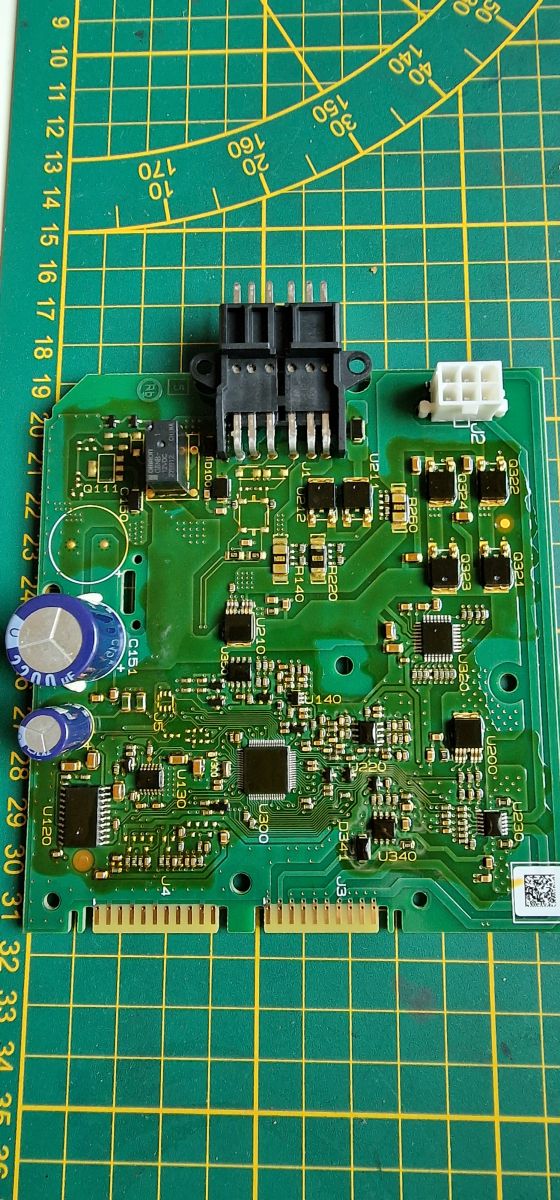

    Photo of the board.... looks OK.
    And the pump chamber, does that white thing (I think it's a filter) open and clean somehow?
    Have you noticed that when the weather gets hot there's a rash on the respective brand forums that AdBlue has gone to shit?
    Electronic circuit board on a measuring mat View of the interior of the pump casing with electrical wires in a Peugeot 308 SW car.
