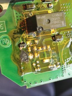

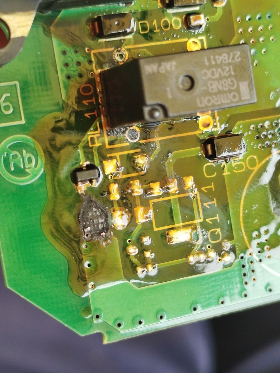

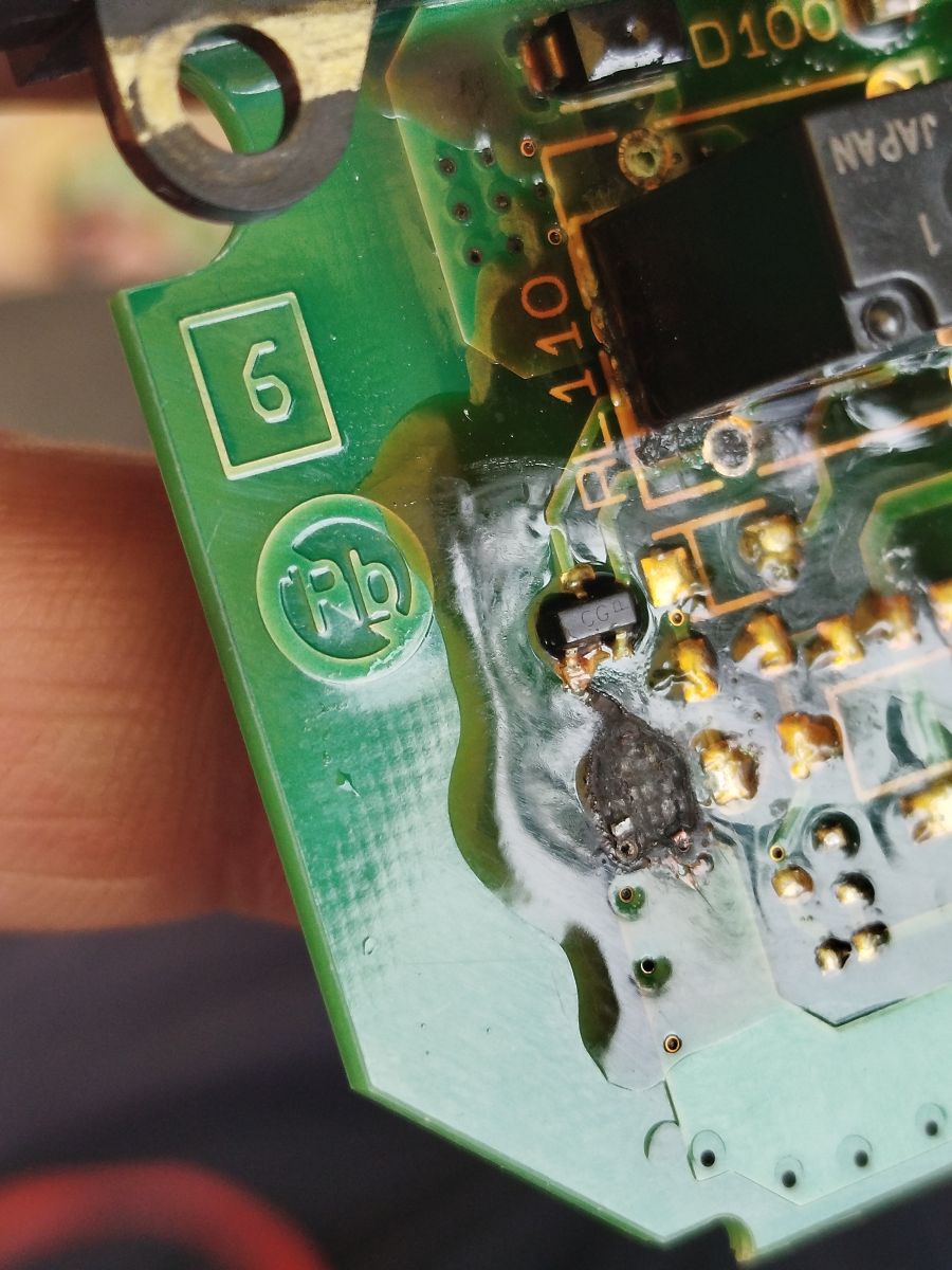

    can someone help me about transistor that is burn?
    Close-up of a PCB with an Omron relay, solder joints, and visible flux residue
    First is CG p?😕
    Close-up of a green PCB with SMD parts and a scorched, melted-looking area
    Please help me!

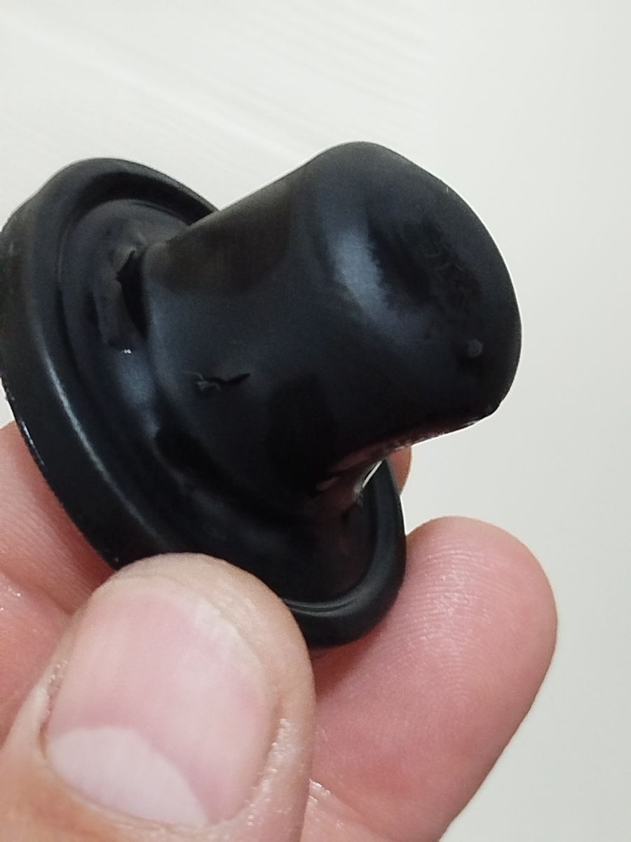

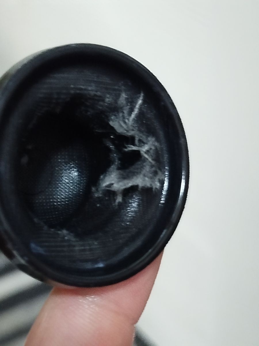

    cdmen11
    >>21904267
    Problem is thorn membrane, replacement?

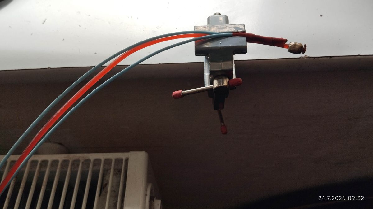

  • Thermistor replacement pushed about 15 cm into tank tube
    #256 21943602
    vkolo11
    staszek75 wrote:
    Check the resistance of the current thermistor with an ohmmeter; it’ll probably be around 300 ohms.
    That’s what I did: I cut it off, soldered on a new one and pushed it into the tank as far as it would go. I’ve checked the temperature many times since then and it seems to be correct. I’ve been driving like this for two years now and the problem hasn’t occurred. Recently, I’ve had two AdBlue-related faults – P21C5 and P2A00 – but they don’t cause the check engine light to come on in the car and the AdBlue seems to be working properly. After clearing them, they don’t reappear for a while, so I’m not too worried about it.
    Hi Staszek and everyone,
    I see, that the ribbed hose / tube inside the tank is probably 40 to 60 cm long.
    Could you, please, provide details, how far you were able to push the termistor inside the tube?
    I have made several tries with the mower string and my best result was at about 15 cm.
    Could you, please, recommend a better way, how to reach a bigger distance?
    Regards
    Vilem
  • #257 21944039
    staszek75
    Posts: 94
    Rate: 30
    I reckon that’s about it – about 15 cm.
  • #258 21944160
    vkolo11
    thank you for your replay.
    I have inbetween prepared a special tool made from the lawnmower string with a metal ball on the end.
    With this tool it was possible to insert the termistor at about 40 cm into the hose.
    Regards
    Vilém
