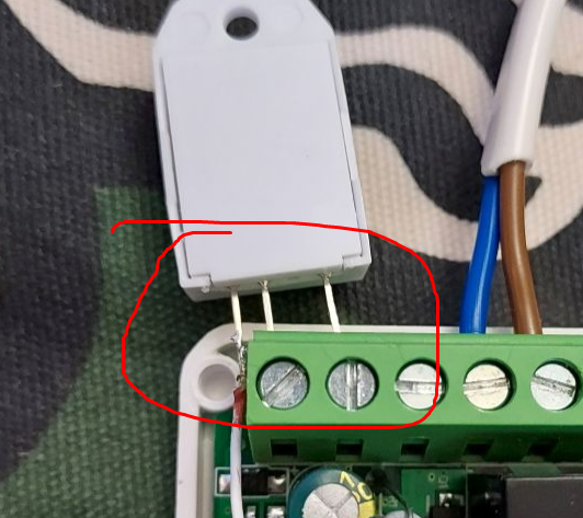

  • Modified a T34/BK7231N heater controller by adding a DHT22 temperature sensor for room-temperature sensing and relay-based heating on/off control.
  • Wired the sensor to the S1/S2 external switch connector: S1 to ground, S2 to GPIO P14/pin 11, removed the sensor’s NC pin, and used jumper power for VCC.
  • Removed the pullup resistor and capacitor on P14 near the relay under marking BC8, and flashed without desoldering the CPU by soldering UART to BR4.
  • The DHT22 reported correct values immediately; a DHT11 also worked only with divider adjustments.

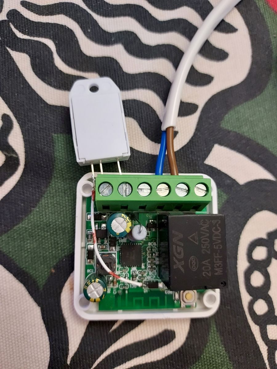

  • Modified Tuya relay controller with attached DHT22 sensor.

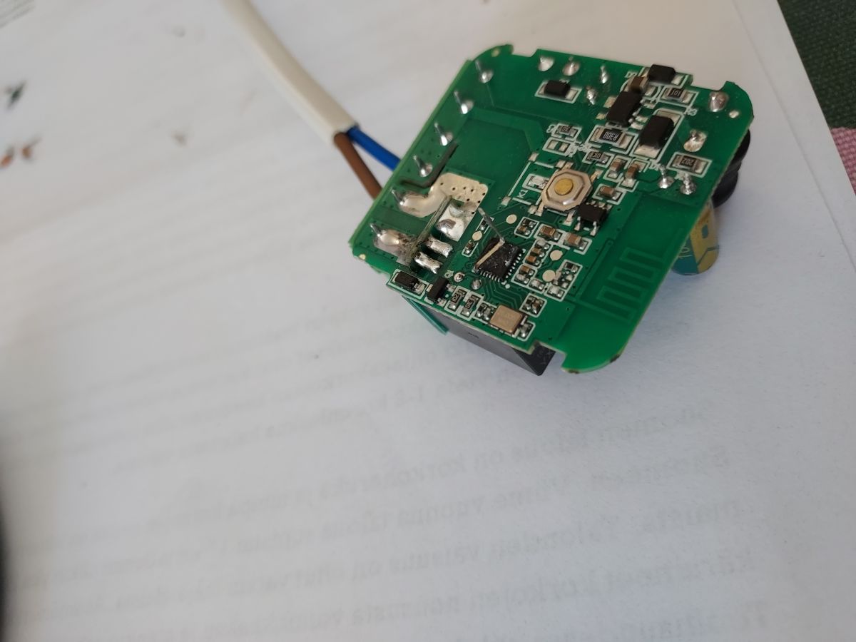

    There seems to be multiple different layouts available of this device.
    My need was to add a temperature sensor in it to make possible to measure room temperature and use the relay to connect heating on and off.

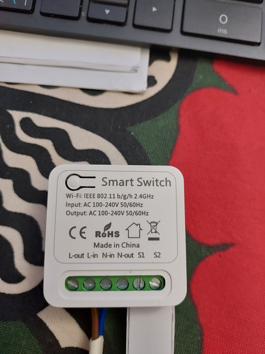

    Smart switch Tuya with DIY modification, label view.
    There is S1 and S2 connectors for external switch. I used those to connect DHT22 sensor. S1 is ground and S2 ic connected to GPIO P14, which is pin11 on the CPU. I just took the NC pin off the sensor. All three other pins are at suitable distance from each other to fit the connector.
    There is a pullup resistor and capacitor between this P14 and VCC. I took them both off. They are located near the relay under marking BC8.
    Only VCC to the sensor needs to be addeb by jumper.
    I did not desolder the CPU to flash it. One UART wire can be soldered to the BR4 resistor at the end near number 4. For the second one I used a big and sharp normal knitting needle from my wifes reserves. I holded it at the plase simply by hand. It's easier to keep it on the right spot if it is sharp enoug.
    DHT22 sensor gives right values right away. I did try a DHT11 too and it seems to need some dividers to give correct value.

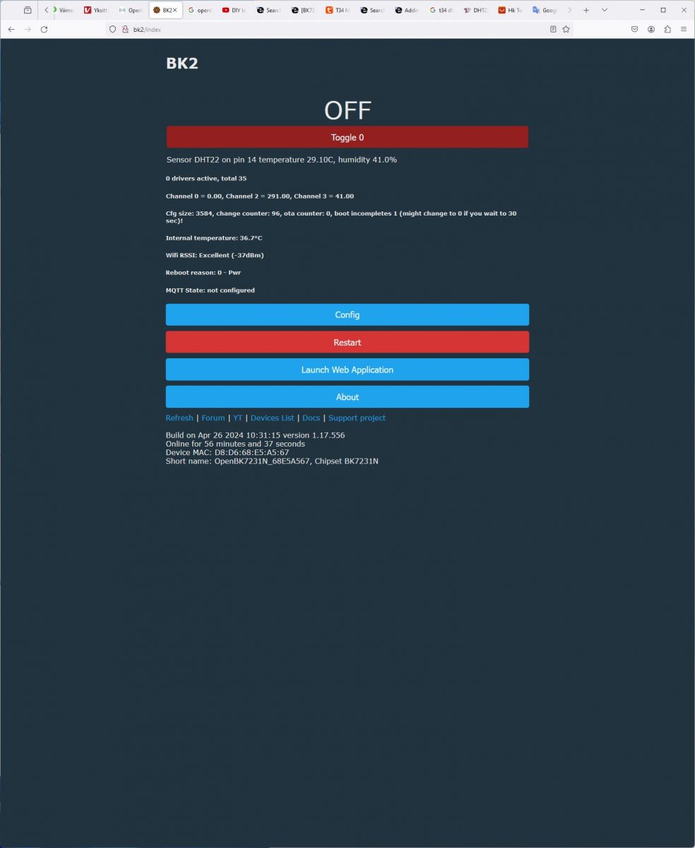

    Here is what it looks like:
    Web interface of the BK7231 controller with DHT22 sensor information

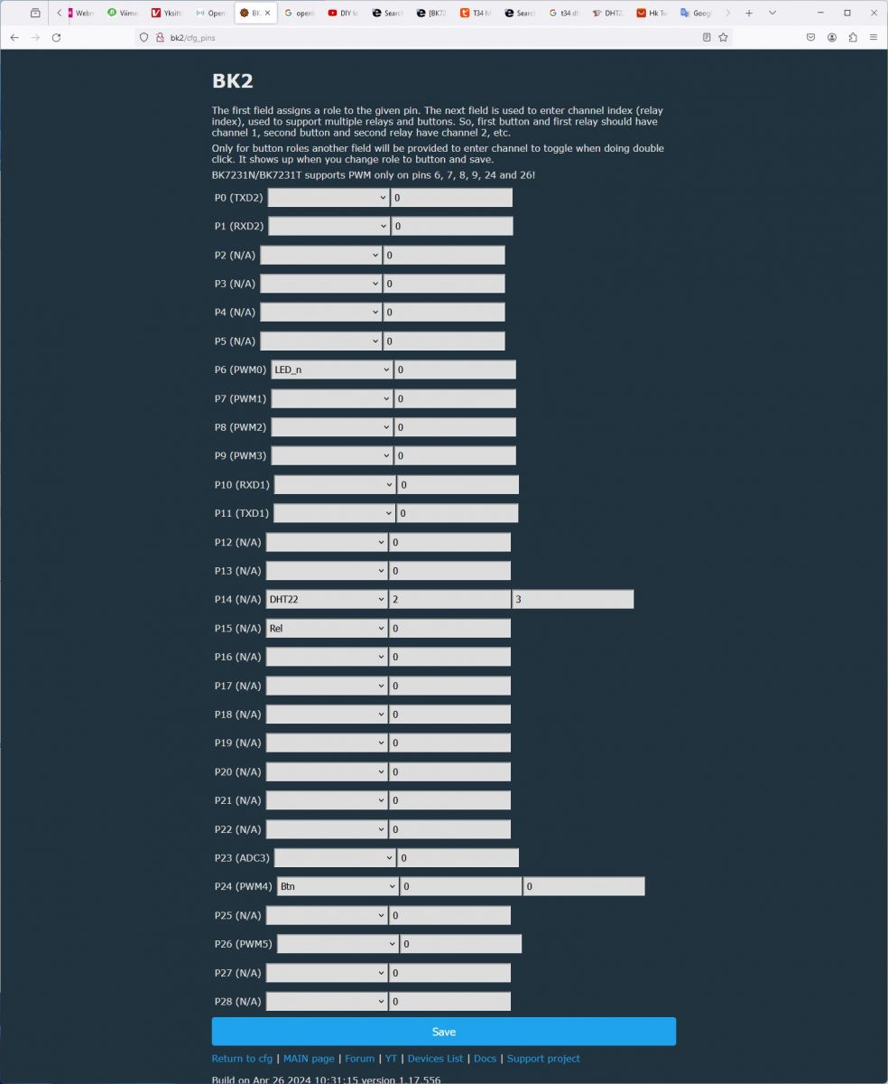

    Here is configuration:
    Screenshot of pin configuration settings for BK7231N/BK7231T controller.
    DHT22 is where originally should be BTN_TGL_ALL to act as external on/off switch.

    Yes, this is a good idea. With OBK, such modifications are very easy. We've did similiar thing with DHT11 on our YT channel:
    https://www.youtube.com/watch?v=KEjOPuYd3CE
    The second modification that is worth considering is adding a IR receiver, one could be taken from any scrap board from devices like a sat tuner, etc:
    However, when it comes to IR receivers, I would first check what kind of device we're extending. That's because IR code may not work well with PowerSave, while on the other hand, some devices may straight up require PowerSave because of their low quality power supplies. That's why IR mod may be a little bit more problematic.
    By the way, now you have a temperature values read. This means you could now write some kind of simple script in autoexec.bat to control relay depending on the temperature. For example, turn on heating when it's too cold...
    There is, however, one more important thing that needs to be mentioned. This particular device you have does not provide isolation from the mains, and it means that you can get live mains on like DHT11 ground pin. This means you must exercise EXTREME CAUTION while doing and using such mods. So, of course, modify only devices disconnected from mains and futhermore make sure that your DHT (or any attached sensor) is well secured and won't make contact with user... or anything else. In your case this part needs to be isolated/secured (if that's a final connection):
    Close-up of an electrical circuit with a DHT11 sensor.
    Anyway, that's a good mod, and if you need any help with extending it, let me know.

    Can you tell me is it possible to read the temperature value by some http command like "http://My_Device/cm?cmnd=?????".
  • #4 21095708
    Posts: 14701
    Help: 656
    Rate: 12747
    I think our OBK channels command should work:
    http://192.168.0.163/cm?cmnd=channels
    Please try it out and let me know if it works for you.

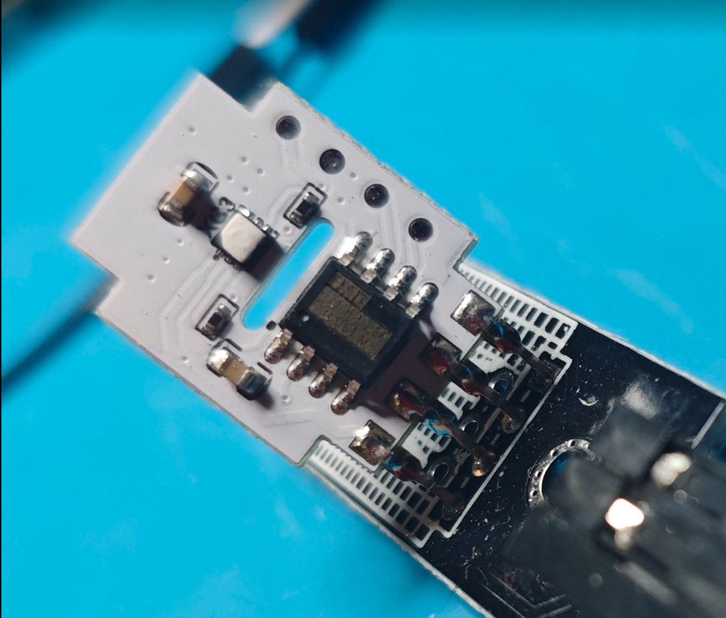

    @Tilator does your DHT22 give readings still with the latest builds? I don't suppose you ever took a pic of the PCB inside the casing? I'm just curious about my one which doesn't seem to work with OBK but does with Tasmota. Maybe mine is fake and the Tasmota driver has different tolerances or something
    Close-up of a PCB with visible electronic components.
  • OBK DHT22 works on version 1.17.661
    #9 21223462
    Tilator
    Posts: 139
    Rate: 13
    At least version version 1.17.661 works fine.
    Pictures are available if they anyhow help you.

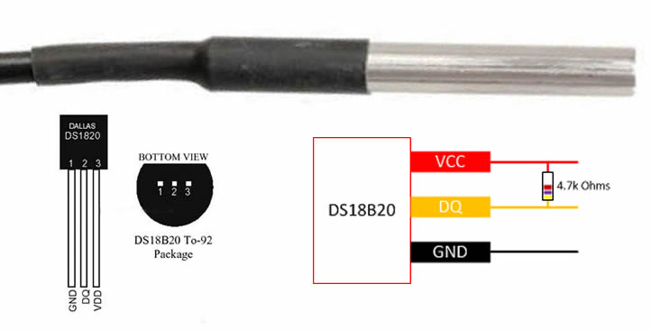

  • Clarifying DS18B20 two-wire wiring and power pin
    #10 21237109
    Tilator
    Posts: 139
    Rate: 13
    I'm eager to hear some feedback! Please try and let know.
    Now I had time to try it, but DS18B20 sensor does not come available.
    There are at least two different physical configurations to install this sensor. Which one should I use?
    I installed it by connecting GND + VDD to ground and mid pin to GPIO. Does it need to have power from VDD pin or should GPIO power it as it's supposed to do in this "two wire" connection?

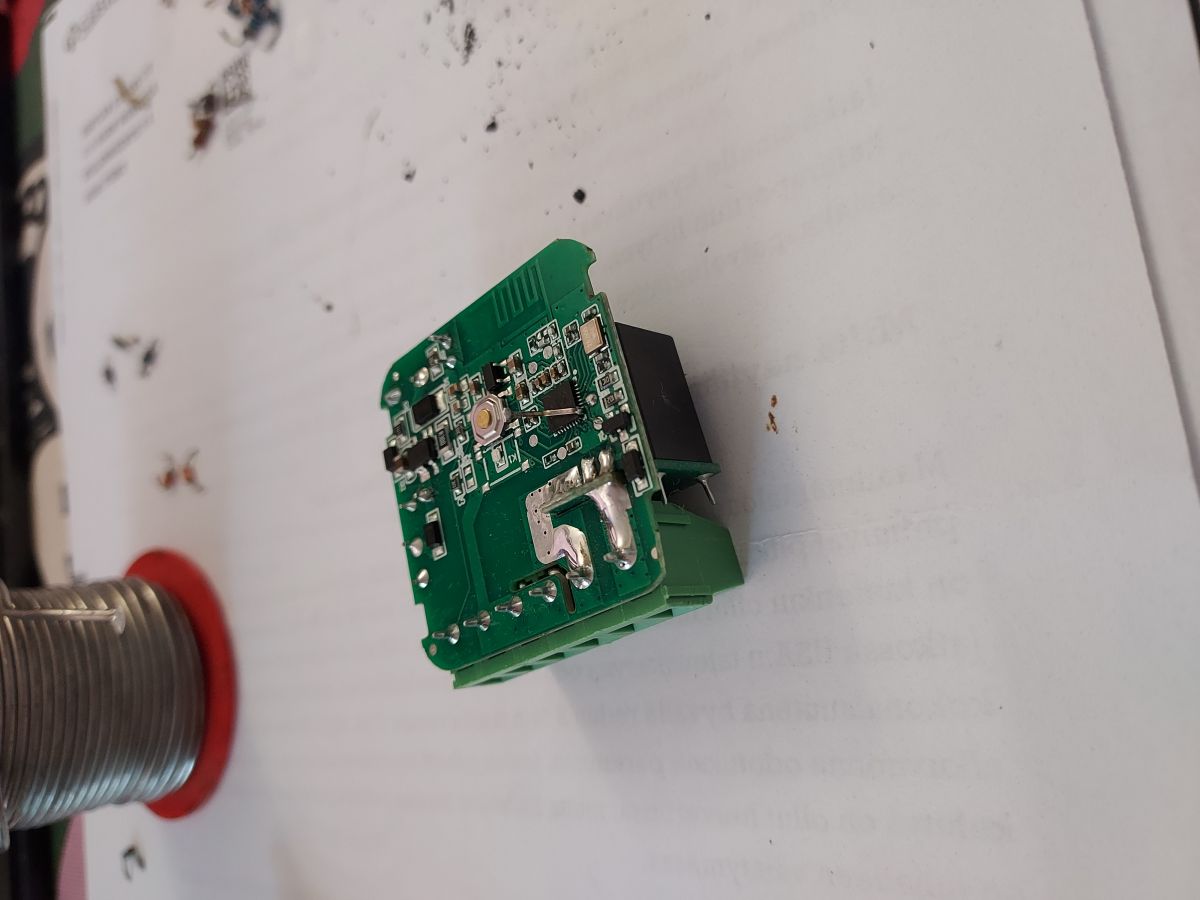

    I took one of those mini relays having BK7231N and connected DS18B20 to it using GBIO 9. Still no temperature reading.
    If I add sensor usin WEB UI there happens nothing. No loaded driver listed on front page. If I put a startup command "startdriver DS1820 9" and reboot it does load driver but temperature reading is always same -1,26 C or something like that.
    I did try one wire connection having only ground and data connected and VDD connected to ground. Then I did try "two wire" connection having power connected to VDD with or without pull up resistor.
    Always same result. T34 device has a power metering component, but this latter device doesn't even have it.

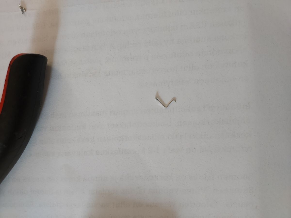

    B.T.W: I made a little modification to make it easier to try adding this sensor. Here are pictures about it in case someone is interested: Small, bent wire on a white surface next to a black handle tool. The image shows the back of a green circuit board with a soldered wire. Colorful circuit board with a thin leg soldered onto it.
    In the first picture there is a tiny "hook". It's originally a leg from one DHT22 sensor. It is narrow enough, soft to bend and easy material to solder.
    In second picture this hook has been soldered to pin 25 (GPIO 9) and third picture has a drop of super glue to attach it firmly.

    still requires external power afaik
    so, 3.3v, gpio and ground. 4.7kohm between data and vcc.

Why might a DS18B20 start working only at about 4.75V but fail at 3.3V on some BK7231N-based devices?
The thread points to a power or timing sensitivity in the actual setup. One user reported no DS18B20 response at 3.3V, then partial operation at about 4.75V, with a reading roughly 10 C too high. The same post notes it later worked at 3.3V when configured in both the Web UI and the startup command, which strongly suggests a startup timing issue. [#21238824]
