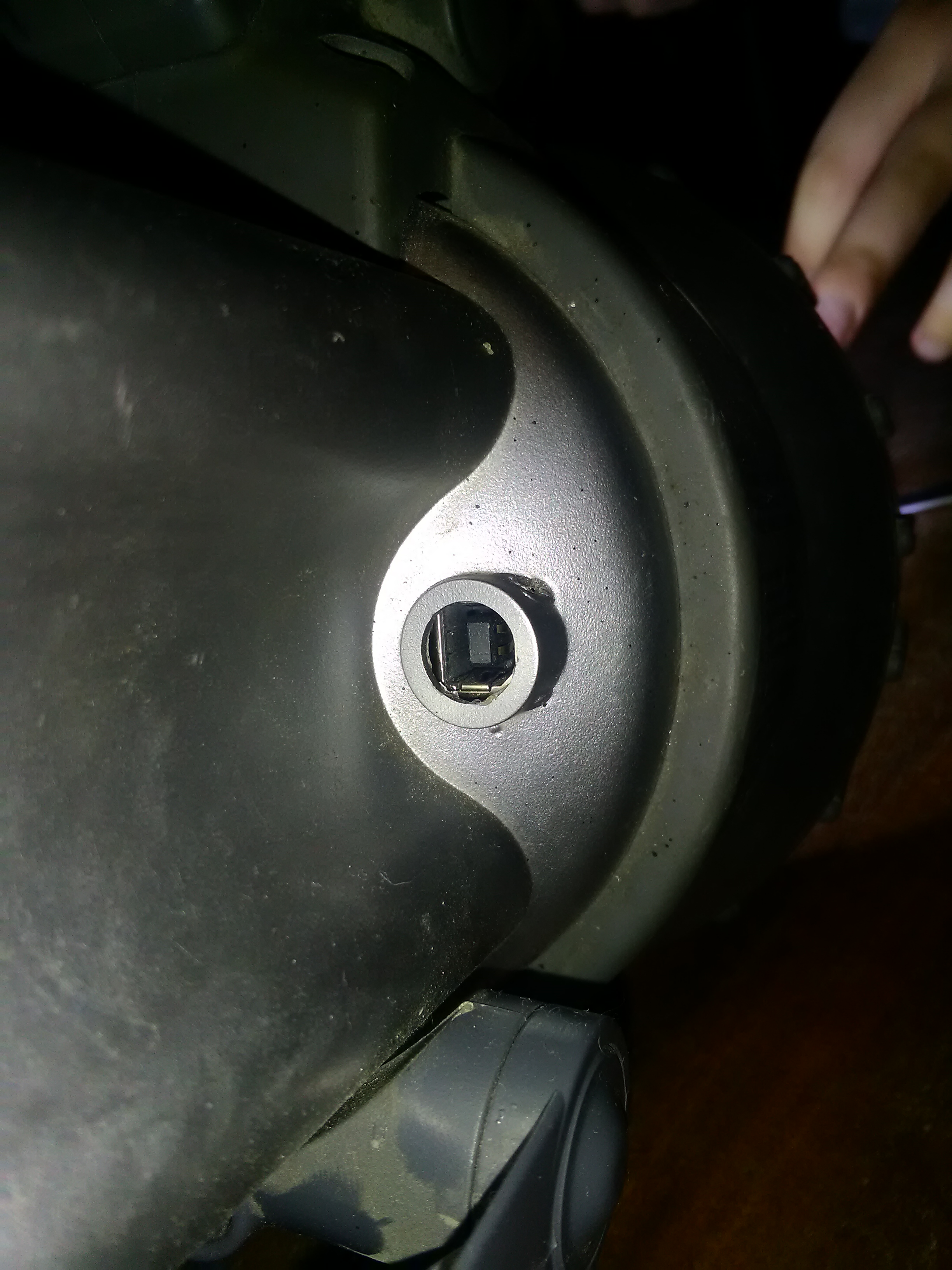

  • A CR2008S-1B halogen flashlight was converted into a xenon HID searchlight, replacing the original H3 6V 100W bulb and using the existing housing.
  • A 3s6p Li-ion pack made from used mole icr18650h cells powers the lamp, with the converter mounted under the flashlight where the fold-out foot used to be.
  • The pack uses a PCM-L03S08-012 protection board rated for 7A, while IMAX B6 measurements showed over 10Ah capacity.
  • The flashlight now has a very wide spill because the reflector is shallow, and runtime tests are still pending despite an estimated three hours of use.

    What kind of light focus does this offer? Could use a voltage indicator on the battery and built-in sockets for connecting the charger and balancer.

    The balancer socket is this plug (black cube) in the photo on the side with 4 cables, it just fits perfectly into the imax socket, as for the charging socket, I will probably put it in the place where the inverter power cable currently enters because it is quite long and I can let it go the hole on the other side. The battery indicator is rather unnecessary because the battery is guarded by the PCM that will disconnect the power when one of the cell sets is discharged below 2.7V
    The inverter is some cheap no name, something similar to this http://interlook.pl/pol_pl_Przetwornica-XENON-12V-35W-DC-554_4.jpg,
    however, this is not a very cool solution because the burner changes the shade of light when you move the flashlight.
    as for lighting, there is something like this in the room HID torch searchlight with halogen torch
    with field beamshots it may be a problem because it was only after 11 PM I could do something. Just out of curiosity, I weighed the structure and I have less than 1.9 kg.
