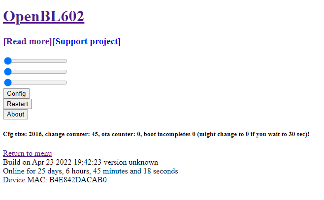

    #32 20028737
    Posts: 14751
    Rate: 12867
    OTA and RBL is only for Beken platforms. There is no OTA for BL602 yet. If any user wants to help and contribute, feel free to do it, but in the current state of things other features like Tasmota Device Groups support are taking priority.
    You should wait with updating bl602 if you dont need any new features. Tasmota device groups will be coming soon for bl602 as well so that might be handy.
    PS: 25 days:

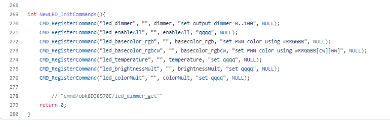

    #33 20030308
    droege
    Posts: 42
    Hi there,
    thanks for all the work. Great start.
    I'm using it with LED RGB-Stripe on an BL602.
    But I have difficulties with tasmota-compatible commands:
    Setting color is fine. Setting Power: NOT;
    In Tasmota POWER command is NOT per Channel, but per internal group. Meaning:
    POWER 0 / 1 sets the LAST color-code OFF or ON without resetting the channels to 0.
    I've looked into your code and found PowerStateOnly. But even this sets all channels to 0 and with a newly ON all channels are 255.
    Is there a way to simple set ON/OFF the stripe and to preserve the channel colors?
    Another question to MQTT: is it possible to use MQTT WITHOUT username/password? In home networks this should be ok. In tasmota you can enable/disable authentication.
    And an OTA update would also be great, as newly soldering would be obsolete for an update.
    Thanks in advance
  • MQTT without username and password may work
    #34 20030462
    Posts: 14751
    Rate: 12867
    https://github.com/openshwprojects/OpenBK7231T_App/blob/main/src/cmnds/cmd_newLEDDriver.c

    Hi,
    Thanks for your work. I successfully flashed the firmware on a Magic Home led controller (White only) with BL602 chip. I can control the LED brightness, but each time I reboot or switch the controller ON/OFF, the default value for brightness is set back to 0. Adding "power 100" or "powerALL 100" in the startup command text, solves the problem in case of a restart, but after switching the power on/off, the brightness is back to 0.
    Is there anything I'm overlooking to set the default brightness value too 100 when the controller is powered on ?
  • Use led_dimmer and HTTP commands for startup state
    #50 20049905
    Posts: 14751
    Rate: 12867
    Hey, the automatic "save last power state" is not yet done, so the startup command is a way to go.
    Please see:
    you can use "led_dimmer 100" command or something like that. Along with led_basecolor_rgb and led_enableAll.
    PS: Did you know that you can also send such commands by HTTP? Or use button event listener to send command to another device?
    https://www.elektroda.com/rtvforum/topic3892160.html
    Code: text
  • Clarifying warm boot versus cold boot startup behavior
