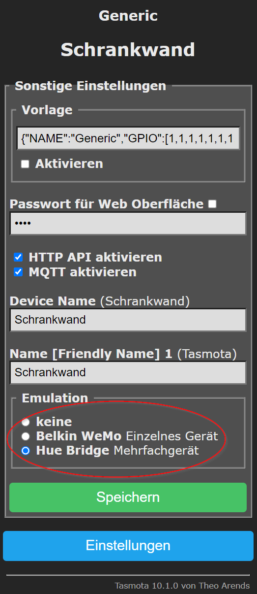

    Hi, thanks for the quick reply.
    I have some ESP based devices, flashed with Tasmota. In the web interface of Tasmota in the menu "other parameters" is a setting "emulation". If "Belkin WeMo" or "Hue Bridge" is set here, the device will be detected by Alexa with the command "search new devices". After that, the devices can be controlled by voice over Alexa without the need of Home Assistant, FHEM etc. For instance I can say: "Alexa, set LED strip to green".
    If emulation is set to "None", the device will not be detected. The same situation I have now with OpenBL602. Hopefully it is possible to implement this.

    So it's the Philips Hue Driver?
    https://github.com/arendst/Tasmota/blob/c0856...0/tasmota/tasmota_xdrv_driver/xdrv_20_hue.ino
    I could do that, but I need to buy Alexa hub for testing that? I never used Alexa before.

    Hey again,
    you don't need an Echo Device. The Alexa-App on a SmartPhone is sufficient. Alexa uses the smart home skill to address the Hue bulb.

    Yes, I think so. The comments in the linked source code look promising.
    I have very limited C programming and compiling skills, but I can test if you provide a new firmware image.
