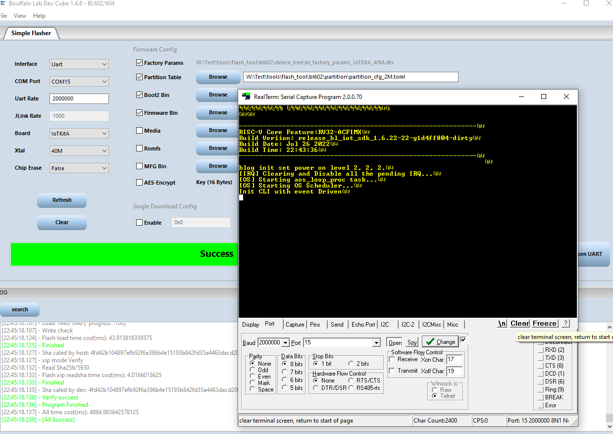

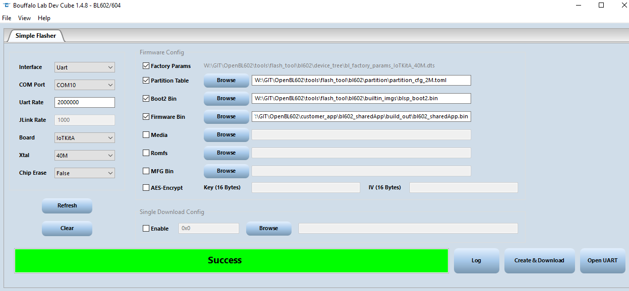

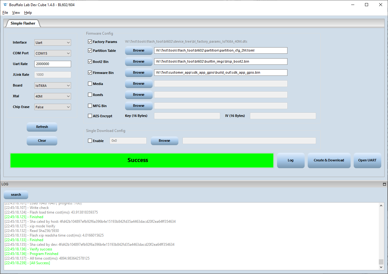

  • OpenBL602/OpenBeken ports Tasmota-style firmware to the BL602, letting closed IoT devices join Home Assistant over MQTT.
  • It flashes the chip through a USB-to-UART adapter and BLDevCube, then exposes an OpenBL602 access point for Tasmota-like Wi‑Fi, pin, and MQTT setup.

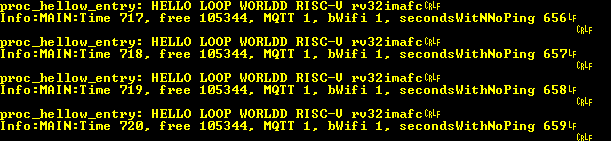

    First of all thank you for doing this awesome project! just received some MagicHome LED controller and wanted to flash them with tasmota when I realized that they had this BL602 chip which isn't supported by them - but you saved me.
    Took me this whole day to set both controllers up with your software and get them to show up in my home assistant instance. (because i'm a noob, your documentation is really nice)
    Sadly I now have some issues which i really think i can't fix on my own;
    one of the led controllers keeps "crashing" after 3-4 minutes. In the first couple of mins it works perfectly - reacts to on/off/colorchange through HA and web interface is reachable.
    But always after 3-4 mins something seems to happen. Interface isn't reachable anymore, and can't switch on/off via mqtt.
    LOG shows this

    resetted the device multiple times by pulling power 4xbut this didn't help.
    Also; resetting this way seems not to work that well either way as the device shows up as wifi host but when accessed all the input data as still as before reset.
    Hope you can help me <3

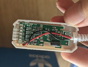

    do you have the same magic led device as me or a different one?
    does it work without crashing if you disable MQTT?
    it works well, it starts as wifi host and it's run without setting up pins, so you can revert config manually to one that does not crash

    i have the version that came only with wifi, without IR remote Tasmota replacement for BL602, programming, pairing with Home Assistant, now with OTA working!

    Ok, so which options are you using, which general flags? Are you using MQTT broadcast every minute or something like that?
    I suspect that you're hitting MQTT buffer limits and I might need to increase them in next build.

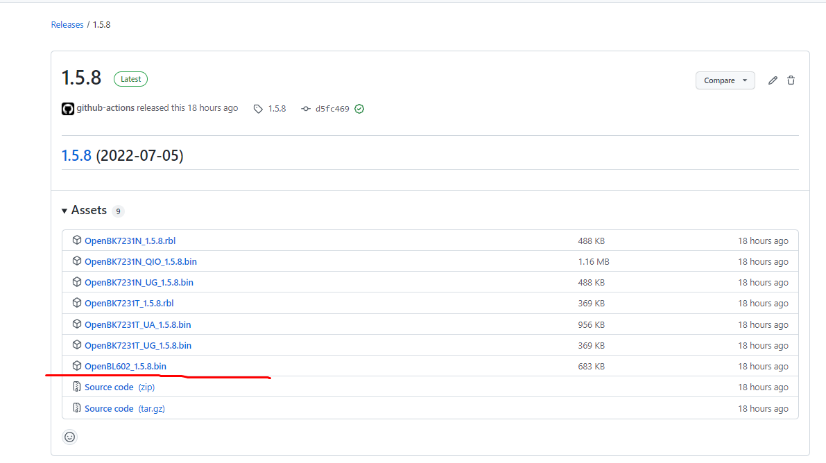

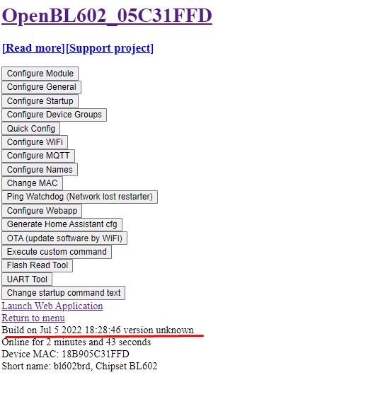

  • Stable OpenBL602 1.5.8 pairing with Home Assistant
    #99 20090481
    Posts: 14751
    Rate: 12867
    You have two devices and one works and the other doesn't? Two same BL602 with the same version?
    Well I will try to find my BL602 dev board and check

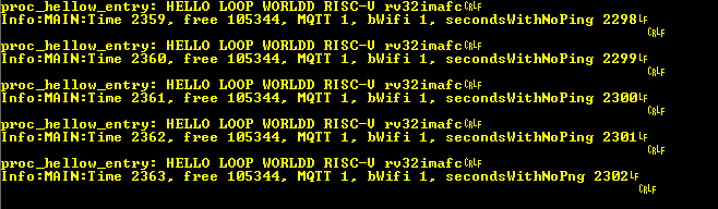

    OpenBL602_1.5.8.bin paired with HA, single LED control (dev board)
    edit: waiting for crash...
    edit: still stable:
    do you have any flags checked?

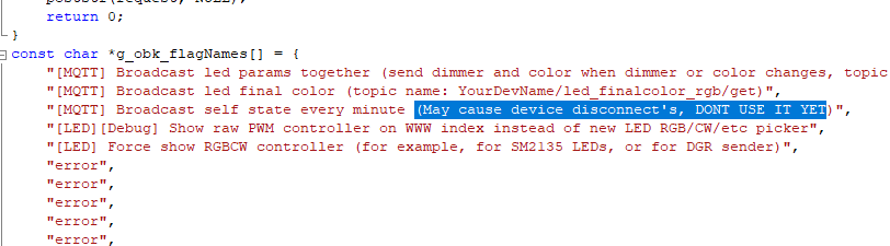

  • Flag3 MQTT reporting breaks BL602 stability

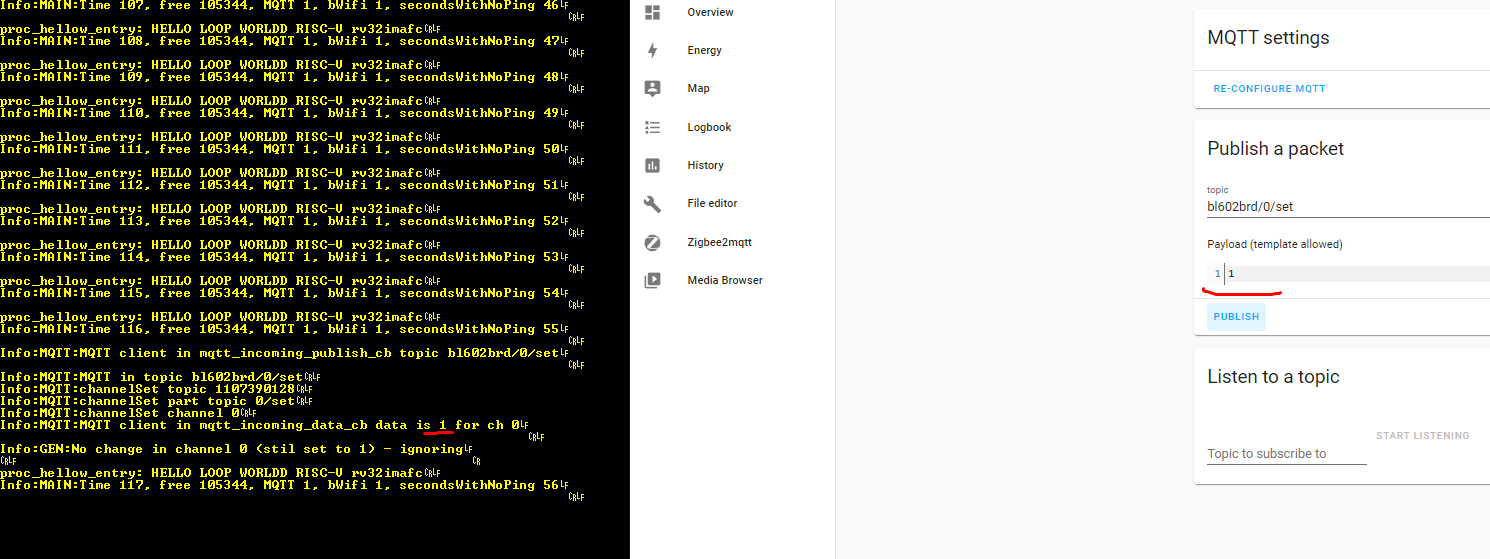

    #100 20098762
    droege
    Posts: 42
    Hi again,
    so, I tested 1.6.9 on BL602:
    When using the Flag3 MQTT - Report every 30 seconds together with Flag2, the device goes wild.
    It's not really accepting MQTT messages any more, and it doesn't report correctly.
    By just using Flag 2 without Flag 3 it works ok.

    @droege are you able to compile the binary yourself? I'm just asking, you could help with increasing MQTT limitations from LWIP
    if not, I might get you a binary myself

    Oh ok then, is your controler RGB or RGBCW? You have 5 separate color channels, right?
    I am asking because it seems that I need to increase the MQTT limits in LWIP library. They are hardcoded limits saying that, for example, there can be at once 4 requests sent, no more.
    Something like I did here:
    https://github.com/openshwprojects/OpenBK7231...mmit/ff6c85e6fe830a3e8efd4af82cb0f8e5536f5b7f
    well, maybe, I will try to increase them now, wait a sec
    EDIT: Can you try latest build, when it finishes and it's up on github?
    I need to know if it improves anything, if not, you'll have wait more for me to investigate

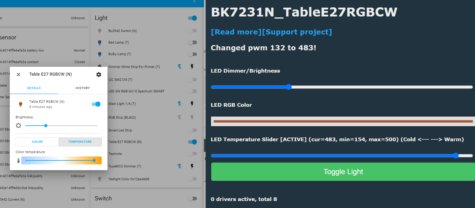

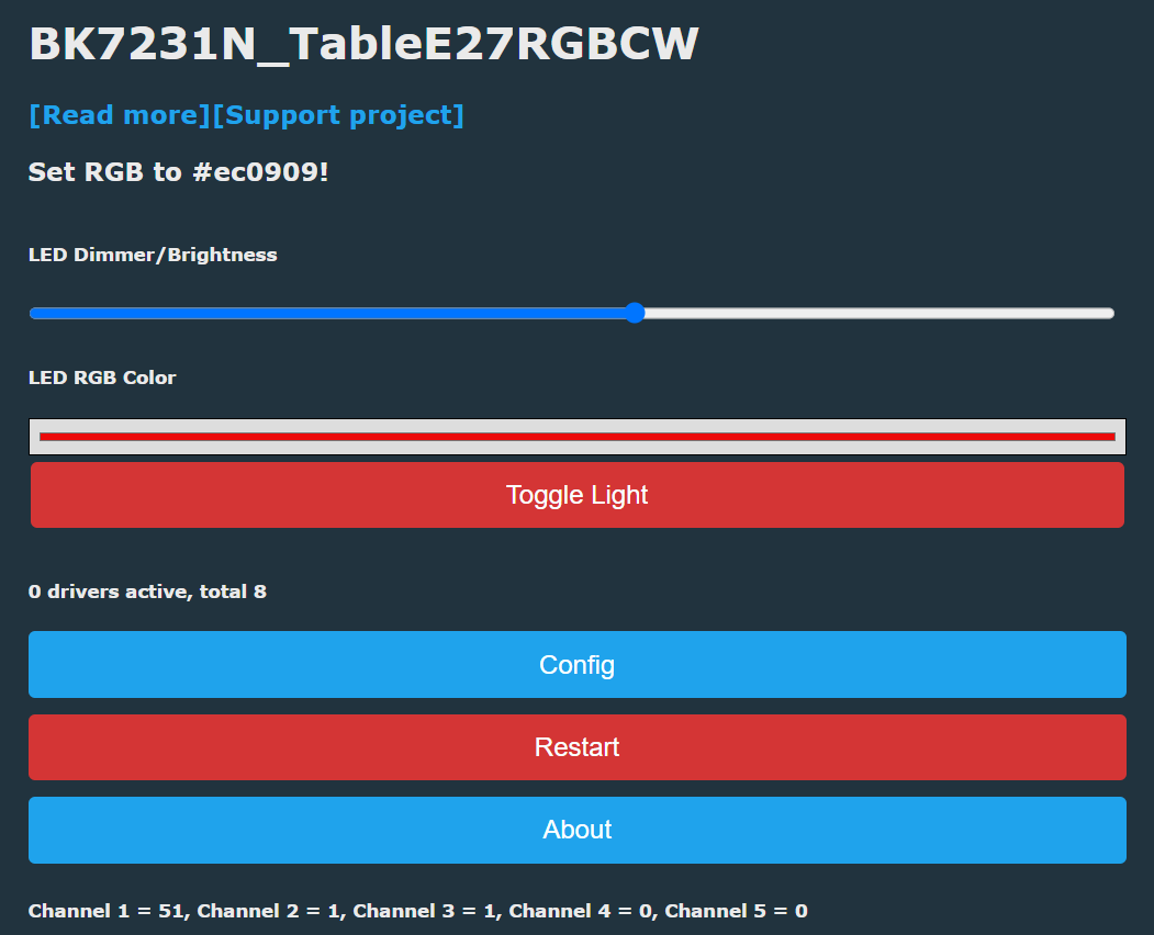

  • Clarifying RGB and warm white control behavior
    #105 20102424
    Posts: 14751
    Rate: 12867
    But with flags 1 and 2 off, there are no problems?
    Ok I will look into it.
    IP is broadcasted every minute.
    Only raw channels values are broadcasted every minute at the moment.
    I am updating LED driver and adding correct (final abstract) controls to web panel:
    Please wait a day or so, then I will need help with testing
    EDIT: "I have a 4 Channel RGBW controller with W= WarmWihte, that of course depends on the stripe."
    Is expected behaviour for this controller a separate setting of RGB and separate slider for Warm White?
    Should it behave like:
    a) you can set RGB or warm white, never both at once
    OR
    b) you can set both RGB and warm white anyway you want?

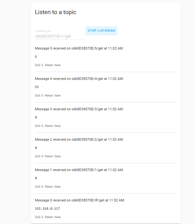

    Posts: 14751
    Rate: 12867
    Topic is like the channel name, but not a number, an "IP" string instead.
    Bump bump, topic update, @droege can you check?

    This is how smart LED control looks like now:

    Hey again,
    tested it.
    MQTT is not blocked and the device also not.
    BUT: I used Flags 1,2,3, so FinalColor, every minute & old UI;
    FinalColor is being reported, the old UI is also available, but it's not reporting anything every minute.
    And it's also NOT reporting the IP-Address.
    Sorry. But at least, it's not blocked.
    Best.
  • #109 20103710
    droege
    Posts: 42
    So, I tested 1.10.0:
    Broadcast of channel-state & IP_Address works. Great ;)
    Same for other MQTT messages, even when changing colors, etc.
    But: the device, even when no Web-Interface is requested and nor command is issued, gets warm. Meaning: some difficult tasks are running, and burning energy/producing heat. Is it only MQTT that runs all the time?
    Cheers.
  • Minute MQTT broadcast likely causes BL602 instability
    #110 20103716
    Posts: 14751
    Rate: 12867
    I haven't replied to your last post because I still consider BL602 MQTT broadcast every minute bugged. I suspect it will crash, sooner or later.
    Currently it has a following adnotation:
    I am not sure what's wrong, I think there might be multiple issues at fault. I checked the threading issues and stack size multiple times, but the mutex is in place and should work flawlessly, stack size should also fit.
    There was indeed a nasty BL602 platform bug where I assumed that sizeof(StackType_t) is 1 while it was 4 (stack size is given in words), very silly of me, but on vanilla beken platform it was in bytes... thus making all stacks unnecesarily large... but still, there is some other problem at play.
    Right now I'd say "don't broadcast every minute" and you should be fine.
    I think that nothing should change in that regard. You might need to double check, or check without mqtt broadcast
    The funny thing is it never happened for me until I tried to replicate your problem. It's just I didn't use that "every minute" flag.
    PS: @droege , if you also want to improve stability, can you tell me is there something that we should not broadcast but it's broadcasted now? Maybe that final color vs base color broadcast, do you use both of them? Maybe I should split the "base color broadcast" (if that's not used) and add a separate flag for that, so people can disable it if that's not needed?
  • Disable minute broadcasts to reduce heat and load

  • Flash and DTB verify, but board still won’t boot
    #113 20115200
    bartek666666
    The batch loads without any problems (on 3 different programmers), but the board does not start.
    [23:15:41.426] - Write check
    [23:15:41.446] - Flash load time cost(ms): 3520.0048828125
    [23:15:41.446] - Finished
    [23:15:41.456] - Sha caled by host: 0e1153e32ab88df80625d76cff354b799c48eda0f83fca86c52f6ea6898a067d
    [23:15:41.456] - xip mode Verify
    [23:15:41.676] - Read Sha256/709504
    [23:15:41.686] - Flash xip readsha time cost(ms): 210.0
    [23:15:41.686] - Finished
    [23:15:41.696] - Sha caled by dev: 0e1153e32ab88df80625d76cff354b799c48eda0f83fca86c52f6ea6898a067d
    [23:15:41.696] - Verify success
    [23:15:41.696] - Dealing Index 4
    [23:15:41.696] - ========= programming chips\bl602\device_tree\ro_params.dtb to 0x1f8000
    [23:15:41.706] - ========= flash load =========
    [23:15:41.706] - ========= flash erase =========
    [23:15:41.706] - Erase flash  from 0x1f8000 to 0x1f9729
    [23:15:41.716] - erase pending
    [23:15:41.756] - erase pending
    [23:15:41.816] - Erase time cost(ms): 110.00048828125
    [23:15:41.826] - decompress flash load 1640
    [23:15:41.836] - Load 1640/1640 {"progress":100}
    [23:15:41.846] - Write check
    [23:15:41.856] - Flash load time cost(ms): 39.999755859375
    [23:15:41.856] - Finished
    [23:15:41.856] - Sha caled by host: 4fd42b104897efb92f6a396b4e15193b842fd35a4463dacd20f2ea64ff354634
    [23:15:41.856] - xip mode Verify
    [23:15:41.886] - Read Sha256/5930
    [23:15:41.886] - Flash xip readsha time cost(ms): 10.000244140625
    [23:15:41.886] - Finished
    [23:15:41.906] - Sha caled by dev: 4fd42b104897efb92f6a396b4e15193b842fd35a4463dacd20f2ea64ff354634
    [23:15:41.906] - Verify success
    [23:15:41.906] - Program Finished
    [23:15:41.906] - All time cost(ms): 10290.014404296875
    [23:15:42.116] - close interface
    [23:15:42.116] - [All Success]
    When I try to check the logs, I get the error "ErrorCode": "0001","ErrorMsg":"BFLB EFLASH LOADER SHAKEHAND FAIL"
    [23:18:06.518] - Flash load shake hand
    [23:18:07.438] - default set DTR high
    [23:18:07.538] - clean buf
    [23:18:07.538] - send sync
    [23:18:07.648] - ack is b''
    [23:18:07.648] - retry
    [23:18:07.648] - default set DTR high
    [23:18:07.748] - clean buf
    [23:18:07.748] - send sync
    [23:18:07.858] - ack is b''
    [23:18:07.858] - retry
    [23:18:07.858] - {"ErrorCode": "0001","ErrorMsg":"BFLB EFLASH LOADER SHAKEHAND FAIL"}
    [23:18:07.858] - Shake hand redo
    [23:18:09.858] - ack is b''
    [23:18:09.858] - Not ack OK
    [23:18:09.858] - Read log
    [23:18:09.858] - Read Fail
  • Boot signal disconnect needed to read UART logs
    #114 20115338
    Posts: 14751
    Rate: 12867
    I feel like you`re not following the steps as described.
    The message below does not come from the device logs, but from the programmer:
    What appears on UART when you disconnect the boot signal and restart the device by cutting off the power?
    I am attaching logs from correct programming and from programming that failed due to failure to connect the boot signal:
    Spoiler:
    Correct:

    Spoiler:
    With error:
    [08:08:27.526] - [param]
    interface_type = "Uart"
    comport_uart = "COM10"
    speed_uart = "2000000"
    speed_jlink = "1000"
    bl60x_brd = "IoTKitA"
    bl60x_xtal = "40M"
    aes_key = ""
    aes_iv = ""
    addr = "0x0"
    [check_box]
    partition_download = true
    boot2_download = true
    bin_download = true
    media_download = false
    use_romfs = false
    mfg_download = false
    ro_params_download = true
    ckb_erase_all = "False"
    encrypt = false
    download_single = false
    [input_path]
    pt_bin_input = "W:\\GIT\\OpenBL602\\tools\\flash_tool\\bl602\\partition\\partition_cfg_2M.toml"
    boot2_bin_input = "W:\\GIT\\OpenBL602\\tools\\flash_tool\\bl602\\builtin_imgs\\blsp_boot2.bin"
    cfg2_bin_input = "W:\\GIT\\OpenBL602\\customer_app\\bl602_sharedApp\\build_out\\bl602_sharedApp.bin"
    meida_bin_input = ""
    romfs_dir_input = ""
    mfg_bin_input = ""
    img_bin_input = ""
    [08:08:27.540] - ========= Interface is Uart =========
    [08:08:27.572] - eflash loader bin is eflash_loader_40m.bin
    [08:08:27.574] - ========= chip flash id: ef4015 =========
    [08:08:27.603] - Update flash cfg finished
    [08:08:27.616] - create partition.bin, pt_new is True
    [08:08:27.620] - bl60x_fw_boot_head_gen xtal: 40M
    [08:08:27.625] - Create bootheader using W:\GIT\OpenBL602\tools\flash_tool\bl602\efuse_bootheader/efuse_bootheader_cfg.ini
    [08:08:27.626] - Updating data according to <W:\GIT\OpenBL602\tools\flash_tool\bl602\efuse_bootheader/efuse_bootheader_cfg.ini[BOOTHEADER_CFG]>
    [08:08:27.629] - Created file len:176
    [08:08:27.634] - Create efuse using W:\GIT\OpenBL602\tools\flash_tool\bl602\efuse_bootheader/efuse_bootheader_cfg.ini
    [08:08:27.637] - Updating data according to <W:\GIT\OpenBL602\tools\flash_tool\bl602\efuse_bootheader/efuse_bootheader_cfg.ini[EFUSE_CFG]>
    [08:08:27.640] - Created file len:128
    [08:08:27.656] - ========= sp image create =========
    [08:08:27.668] - Image hash is b'c5e2ce515a5783ac80efdd4910238a466572f882b53b3284e63c763e1da9847f'
    [08:08:27.669] - Header crc: b'52b188af'
    [08:08:27.669] - Write flash img
    [08:08:27.676] - bl60x_fw_boot_head_gen xtal: 40M
    [08:08:27.681] - Create bootheader using W:\GIT\OpenBL602\tools\flash_tool\bl602\efuse_bootheader/efuse_bootheader_cfg.ini
    [08:08:27.682] - Updating data according to <W:\GIT\OpenBL602\tools\flash_tool\bl602\efuse_bootheader/efuse_bootheader_cfg.ini[BOOTHEADER_CFG]>
    [08:08:27.686] - Created file len:176
    [08:08:27.690] - Create efuse using W:\GIT\OpenBL602\tools\flash_tool\bl602\efuse_bootheader/efuse_bootheader_cfg.ini
    [08:08:27.693] - Updating data according to <W:\GIT\OpenBL602\tools\flash_tool\bl602\efuse_bootheader/efuse_bootheader_cfg.ini[EFUSE_CFG]>
    [08:08:27.697] - Created file len:128
    [08:08:27.710] - ========= sp image create =========
    [08:08:27.733] - Image hash is b'4f3139b89da357f6d4b9c058eaf8d161a55237996f1d22e27c13105ec13f963c'
    [08:08:27.734] - Header crc: b'64cee850'
    [08:08:27.735] - Write flash img
    [08:08:27.748] - FW Header is 176, 3920 still needed
    [08:08:27.750] - FW OTA bin header is Done. Len is 4096
    [08:08:28.081] - FW OTA bin is Done. Len is 707584
    [08:08:29.153] - FW OTA xz is Done
    [08:08:29.162] - ========= eflash loader config =========
    [08:08:29.258] - =========W:\GIT\OpenBL602\tools\flash_tool\bl602\device_tree/bl_factory_params_IoTKitA_40M.dts ——> bl602/device_tree/ro_params.dtb=========
    [08:08:29.604] - Version: bflb_eflash_loader_v2.0.0
    [08:08:29.604] - Program Start
    [08:08:29.605] - ========= eflash loader cmd arguments =========
    chipname : None
    chipid : False
    usage : False
    flash : True
    efuse : False
    write : True
    erase : False
    read : False
    none : False
    port : COM10
    baudrate : None
    config : None
    interface : None
    xtal : None
    start : None
    end : None
    addr : None
    mac : None
    file : None
    data : None
    mass : None
    loadstr : None
    loadfile : None
    userarea : None
    csvfile : None
    csvaddr : None
    para : None
    aeskey : None
    aesiv : None
    key : None
    ecdh : False
    echo : False
    auto : False
    version : False
    [08:08:29.666] - Config file: W:\GIT\OpenBL602\tools\flash_tool\bl602\eflash_loader/eflash_loader_cfg.ini
    [08:08:29.668] - serial port is COM10
    [08:08:29.669] - chiptype: bl602
    [08:08:29.670] - ========= Interface is Uart =========
    [08:08:29.670] - com speed: 2000000
    [08:08:29.671] - Eflash load helper file: W:\GIT\OpenBL602\tools\flash_tool\bl602\eflash_loader/eflash_loader_40m.bin
    [08:08:29.672] - ========= load eflash_loader.bin =========
    [08:08:29.673] - Load eflash_loader.bin via uart
    [08:08:29.674] - ========= image load =========
    [08:08:29.945] - tx rx and power off, press the machine!
    [08:08:29.946] - cutoff time is 0.1
    [08:08:30.055] - power on tx and rx
    [08:08:30.860] - reset cnt: 0, reset hold: 0.005, shake hand delay: 0.1
    [08:08:30.861] - clean buf
    [08:08:30.970] - send sync
    [08:08:31.092] - ack is b''
    [08:08:31.093] - retry
    [08:08:31.371] - tx rx and power off, press the machine!
    [08:08:31.372] - cutoff time is 0.1
    [08:08:31.479] - power on tx and rx
    [08:08:32.281] - reset cnt: 0, reset hold: 0.005, shake hand delay: 0.1
    [08:08:32.282] - clean buf
    [08:08:32.391] - send sync
    [08:08:32.513] - ack is b''
    [08:08:32.514] - retry
    [08:08:32.516] - shake hand fail
    [08:08:32.517] - ########################################################################
    [08:08:32.519] - 请按照以下描述排查问题:
    [08:08:32.520] - GPIO8是否上拉到板子自身的3.3V,而不是外部的3.3V
    [08:08:32.520] - GPIO7(RX)是否连接到USB转串口的TX引脚
    [08:08:32.521] - GPIO16(TX)是否连接到USB转串口的RX引脚
    [08:08:32.522] - 在使用烧录软件进行烧录前,是否在GPIO8拉高的情况下,使用Reset/Chip_En复位了芯片
    [08:08:32.522] - 烧录软件所选择的COM口,是否是连接芯片的串口
    [08:08:32.523] - 烧录软件上选择的波特率是否是USB转串口支持的波特率
    [08:08:32.524] - 3.3V供电是否正常
    [08:08:32.526] - 板子供电电流是否正常(烧录模式下,芯片耗电电流5-7mA)
    [08:08:32.527] - ########################################################################
    [08:08:32.528] - shake hand fail
    [08:08:32.530] - Load helper bin time cost(ms): 2856.3779296875
    [08:08:32.531] - {"ErrorCode": "0003","ErrorMsg":"BFLB LOAD HELP BIN FAIL"}
    [08:08:32.532] - Burn Retry
    [08:08:32.532] - 0
    [08:08:32.534] - Burn return with retry fail

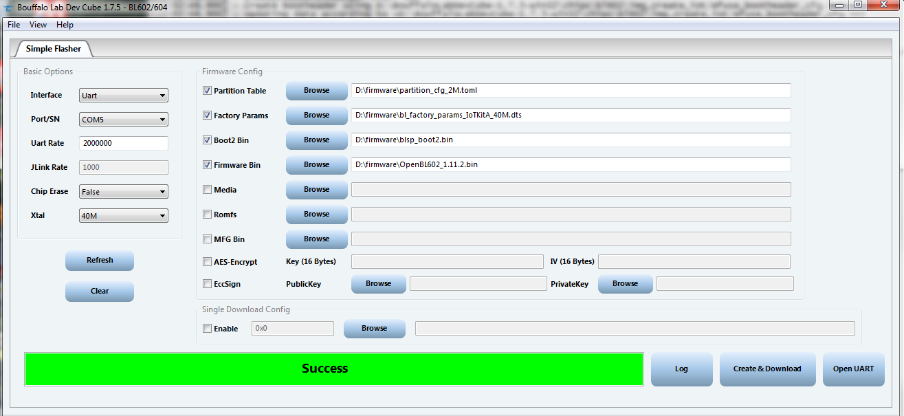

  • BL602 flash log shows image creation succeeded
    #116 20116445
    bartek666666
    For me it looks like this:
    Spoiler:
    [22:02:48.770] - ========= Interface is Uart =========
    [22:02:48.800] - eflash loader bin is eflash_loader_40m.bin
    [22:02:48.800] - ========= chip flash id: ef4015 =========
    [22:02:48.840] - create partition.bin, pt_new is True
    [22:02:48.900] - bl60x_fw_boot_head_gen xtal: 40M
    [22:02:48.900] - Create bootheader using D:\BouffaloLabDevCube-1.7.5-win32\chips\bl602\img_create_iot/efuse_bootheader_cfg.ini
    [22:02:48.900] - Updating data according to <D:\BouffaloLabDevCube-1.7.5-win32\chips\bl602\img_create_iot/efuse_bootheader_cfg.ini[BOOTHEADER_CFG]>
    [22:02:48.900] - Created file len:176
    [22:02:48.920] - Create efuse using D:\BouffaloLabDevCube-1.7.5-win32\chips\bl602\img_create_iot/efuse_bootheader_cfg.ini
    [22:02:48.930] - Updating data according to <D:\BouffaloLabDevCube-1.7.5-win32\chips\bl602\img_create_iot/efuse_bootheader_cfg.ini[EFUSE_CFG]>
    [22:02:48.930] - Created file len:128
    [22:02:48.940] - ========= sp image create =========
    [22:02:48.960] - Image hash is b'c5e2ce515a5783ac80efdd4910238a466572f882b53b3284e63c763e1da9847f'
    [22:02:48.960] - Hash ignored
    [22:02:48.960] - Header crc ignored
    [22:02:48.960] - Write flash img
    [22:02:48.980] - bl60x_fw_boot_head_gen xtal: 40M
    [22:02:48.990] - Create bootheader using D:\BouffaloLabDevCube-1.7.5-win32\chips\bl602\img_create_iot/efuse_bootheader_cfg.ini
    [22:02:48.990] - Updating data according to <D:\BouffaloLabDevCube-1.7.5-win32\chips\bl602\img_create_iot/efuse_bootheader_cfg.ini[BOOTHEADER_CFG]>
    [22:02:48.990] - Created file len:176
    [22:02:48.990] - Create efuse using D:\BouffaloLabDevCube-1.7.5-win32\chips\bl602\img_create_iot/efuse_bootheader_cfg.ini
    [22:02:48.990] - Updating data according to <D:\BouffaloLabDevCube-1.7.5-win32\chips\bl602\img_create_iot/efuse_bootheader_cfg.ini[EFUSE_CFG]>
    [22:02:49.000] - Created file len:128
    [22:02:49.010] - ========= sp image create =========
    [22:02:49.020] - Image hash is b'431e880948189fa0a34c490fa8e58920ded4a847a2b13165478b33881d87d43f'
    [22:02:49.020] - Header crc: b'a77e98f1'
    [22:02:49.020] - Write flash img
    [22:02:49.040] - FW Header is 176, 3920 still needed
    [22:02:49.050] - FW OTA bin header is Done. Len is 4096
    [22:02:49.160] - BL60X_OTA_Ver1.0
    [22:02:49.270] - FW OTA bin is Done. Len is 709504
    [22:02:49.800] - OTA XZ file len = 380120
    [22:02:49.800] - Partiton len = 557056
    [22:02:49.800] - BL60X_OTA_Ver1.0
    [22:02:49.870] - FW OTA xz is Done
    [22:02:49.880] - ========= eflash loader config =========
    [22:02:49.950] - =========D:\firmware\bl_factory_params_IoTKitA_40M.dts ——> D:\BouffaloLabDevCube-1.7.5-win32\chips\bl602/device_tree/ro_params.dtb=========
    [22:02:50.230] - Version: eflash_loader_v2.4.1
    [22:02:50.230] - Program Start
    [22:02:50.230] - ========= eflash loader cmd arguments =========
    [22:02:50.230] - D:\BouffaloLabDevCube-1.7.5-win32\chips\bl602\eflash_loader/eflash_loader_cfg.ini
    [22:02:50.230] - Config file: D:\BouffaloLabDevCube-1.7.5-win32\chips\bl602\eflash_loader/eflash_loader_cfg.ini
    [22:02:50.240] - serial port is COM5
    [22:02:50.240] - cpu_reset=False
    [22:02:50.240] - chiptype: bl602
    [22:02:50.240] - ========= Interface is uart =========
    [22:02:50.240] - com speed: 2000000
    [22:02:50.240] - Eflash load helper file: D:\BouffaloLabDevCube-1.7.5-win32\chips\bl602\eflash_loader/eflash_loader_40m.bin
    [22:02:50.240] - ========= load eflash_loader.bin =========
    [22:02:50.240] - Load eflash_loader.bin via uart
    [22:02:50.240] - ========= image load =========
    [22:02:50.500] - tx rx and power off, press the machine!
    [22:02:50.500] - cutoff time is 0.1
    [22:02:50.600] - power on tx and rx
    [22:02:51.340] - reset cnt: 0, reset hold: 0.005, shake hand delay: 0.1
    [22:02:51.340] - clean buf
    [22:02:51.340] - send sync
    [22:02:51.540] - ack is b'4f4b'
    [22:02:51.570] - shake hand success
    [22:02:51.580] - get_boot_info
    [22:02:51.580] - data read is b'0100000000000000030000000ece9d42e8b41900'
    [22:02:51.580] - ========= ChipID: b4e8429dce0e =========
    [22:02:51.590] - last boot info: None
    [22:02:51.590] - sign is 0 encrypt is 0
    [22:02:51.590] - segcnt is 1
    [22:02:51.620] - segdata_len is 37152
    [22:02:51.710] - 4080/37152
    [22:02:51.810] - 8160/37152
    [22:02:51.900] - 12240/37152
    [22:02:52.000] - 16320/37152
    [22:02:52.100] - 20400/37152
    [22:02:52.190] - 24480/37152
    [22:02:52.290] - 28560/37152
    [22:02:52.380] - 32640/37152
    [22:02:52.480] - 36720/37152
    [22:02:52.490] - 37152/37152
    [22:02:52.510] - Run img
    [22:02:52.630] - Load helper bin time cost(ms): 2390.00341796875
    [22:02:52.730] - Flash load shake hand
    [22:02:52.740] - default set DTR high
    [22:02:52.840] - clean buf
    [22:02:52.840] - send sync
    [22:02:53.050] - ack is b'4f4b'
    [22:02:53.080] - Read mac addr
    [22:02:53.090] - flash set para
    [22:02:53.090] - ========= flash read jedec ID =========
    [22:02:53.100] - Read flash jedec ID
    [22:02:53.100] - readdata:
    [22:02:53.100] - b'ef401580'
    [22:02:53.110] - Finished
    [22:02:53.150] - Program operation
    [22:02:53.150] - Dealing Index 0
    [22:02:53.150] - ========= programming chips\bl602\img_create_iot\whole_img_boot2.bin to 0x00000000
    [22:02:53.160] - ========= flash load =========
    [22:02:53.160] - ========= flash erase =========
    [22:02:53.160] - Erase flash  from 0x0 to 0xb98f
    [22:02:53.180] - erase pending
    [22:02:53.330] - erase pending
    [22:02:53.360] - erase pending
    [22:02:53.370] - erase pending
    [22:02:53.410] - erase pending
    [22:02:53.460] - Erase time cost(ms): 300.000732421875
    [22:02:53.490] - decompress flash load 22124
    [22:02:53.520] - Load 2048/22124 {"progress":9}
    [22:02:53.530] - Load 4096/22124 {"progress":18}
    [22:02:53.550] - Load 6144/22124 {"progress":27}
    [22:02:53.570] - Load 8192/22124 {"progress":37}
    [22:02:53.580] - Load 10240/22124 {"progress":46}
    [22:02:53.600] - Load 12288/22124 {"progress":55}
    [22:02:53.610] - Load 14336/22124 {"progress":64}
    [22:02:53.630] - Load 16384/22124 {"progress":74}
    [22:02:53.650] - Load 18432/22124 {"progress":83}
    [22:02:53.660] - Load 20480/22124 {"progress":92}
    [22:02:53.680] - Load 22124/22124 {"progress":100}
    [22:02:53.680] - Write check
    [22:02:53.710] - Flash load time cost(ms): 250.000244140625
    [22:02:53.710] - Finished
    [22:02:53.710] - Sha caled by host: b987f677ce281b949af2bf8de15d2916aabffc58dd121cbc95bf5cab17d7db4b
    [22:02:53.710] - xip mode Verify
    [22:02:53.740] - Read Sha256/47504
    [22:02:53.740] - Flash xip readsha time cost(ms): 10.000244140625
    [22:02:53.740] - Finished
    [22:02:53.760] - Sha caled by dev: b987f677ce281b949af2bf8de15d2916aabffc58dd121cbc95bf5cab17d7db4b
    [22:02:53.760] - Verify success
    [22:02:53.760] - Dealing Index 1
    [22:02:53.760] - ========= programming chips\bl602\partition\partition.bin to 0xe000
    [22:02:53.770] - ========= flash load =========
    [22:02:53.770] - ========= flash erase =========
    [22:02:53.770] - Erase flash  from 0xe000 to 0xe10f
    [22:02:53.790] - erase pending
    [22:02:53.830] - Erase time cost(ms): 60.000244140625
    [22:02:53.840] - Load 272/272 {"progress":100}
    [22:02:53.840] - Write check
    [22:02:53.860] - Flash load time cost(ms): 29.999755859375
    [22:02:53.860] - Finished
    [22:02:53.860] - Sha caled by host: da4d2fe7d42a71246b0e84d64665b70ad701435f89716c48e6f23ef55340eaa0

    [22:03:00.490] - Load 1640/1640 {"progress":100}
    [22:03:00.490] - Write check
    [22:03:00.510] - Flash load time cost(ms): 50.0
    [22:03:00.510] - Finished
    [22:03:00.510] - Sha caled by host: 4fd42b104897efb92f6a396b4e15193b842fd35a4463dacd20f2ea64ff354634
    [22:03:00.510] - xip mode Verify
    [22:03:00.540] - Read Sha256/5930
    [22:03:00.540] - Flash xip readsha time cost(ms): 20.0
    [22:03:00.540] - Finished
    [22:03:00.550] - Sha caled by dev: 4fd42b104897efb92f6a396b4e15193b842fd35a4463dacd20f2ea64ff354634
    [22:03:00.560] - Verify success
    [22:03:00.560] - Program Finished
    [22:03:00.560] - All time cost(ms): 10330.0146484375
    [22:03:00.770] - close interface
    [22:03:00.770] - [All Success]
    nothing at all

    And the latest version with today`s fixes?
    But that`s strange, no matter what, messages from the batch should appear on the UART, even if it is supposed to hang later.
  • BL602 boots AP mode with OpenBL602 SSID
    #118 20116479
    bartek666666
    ok, I downloaded the entire flash tool from your repo, partition table, boot2 and factory too and on the uart we have something like this
    Spoiler:

    and the latest version works great, great project

    I`m glad I could help.
    I know about OTA, there is no time to get down to it.
    Due to a conversation with one user on PM, I am posting here the now proven GPIO demo along with the proven flash_tool .
    This is as part of testing, if someone wanted to check if uploading a batch works.
    The attachments contain what is shown in the screenshots. Verified on the board with LED controller from the topic. Dev Cube 1.4.8. Binary customer_app/sdk_app_gpio.

    Hi there,
    any news concerning final_color report via MQTT and Dimmer, especially after overwriting via RGB?
    Thanks,
