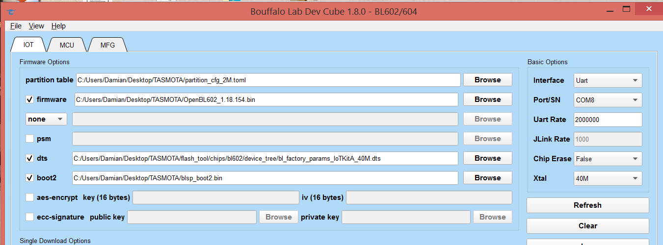

  • #490 21635718
    Cutin
    Posts: 92
    Rate: 11
    divadiow wrote:
    set up the bl_factory_params_IoTKitA_40M.dts dts file and use this file:
    https://www.elektroda.com/rtvforum/topic4126885.html#21583616
    Bouffalo Lab Dev Cube interface with loaded .toml, .bin, and .dts files .
    I tried with DTS and your .TOML and looks similar (no detection on WIFI, no blue LED flash). Tested connected to UART and 230V with the same result.
    I am wondering is the boot file is correct.
    I downloaded it from this source: https://github.com/renzenicolai/bl602tool/blob/main/blsp_boot2.bin

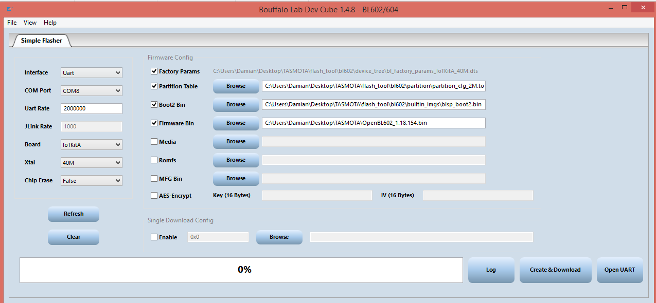

  • #491 21641391
    Cutin
    Posts: 92
    Rate: 11
    Hej,
    Spróbowałe to samo zrobić przy pomocy Lab Dev Cube 1.4.8 z tym ,że plik boot jaki i plik .toml już pochodzi w pochodzi z katologu z całym programem (traktuje to jako wiarygodne źródło) Post: >>20117857
    Cały proces wgrania OpenBeken przeprowadzony sukcesem lecz wynik jest nadal ten sam. Po podłączeniu Mini switch to 230V nadal nie widzę go na sieci WiFi ani dioda led nie świeci.
    Czy zatem plik firmware sam w sobie jest problemem ?

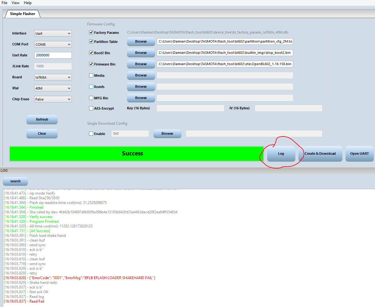

  • #493 21641608
    Cutin
    Posts: 92
    Rate: 11
    >>21641547 >>21641547 .
    My devices are Mini WiFi Switch KR2302 with BL602 processor (Ewelink firmware preloaded)
    I am not sure if I understood correctly.
    Simple Flasher interface with “Success” status shown and error logs below .
    After performing the flashing,unplugging the BOOT cable, rebooting and clicking "Log" I get this:
    [16:08:05.410] - Flash load shake hand
    [16:08:05.410] - clean buffer
    [16:08:05.473] - send sync
    [16:08:05.473] - ack is b'2d2d2d2d2d2d2d2d2d3e3e3e3e'
    [16:08:05.473] - reshake
    [16:08:05.473] - sleep
    [16:08:08.498] - clean buffer
    [16:08:08.498] - send sync
    [16:08:08.498] - ack is b'310d0a327468206368616e6e656c2c76'
    [16:08:08.498] - reshake
    [16:08:08.513] - sleep
    [16:08:11.528] - {"ErrorCode": "0001", "ErrorMsg": "BFLB EFLASH LOADER SHAKEHAND FAIL"}
    [16:08:11.528] - Shake hand redo
    [16:08:11.528] - FL695f unknown
    [16:08:11.528] - Not ack OK
    [16:08:11.528] - Read log
    [16:08:11.528] - Read Fail
  • #494 21641683
    Posts: 5062
    Help: 438
    Rate: 893
    Sorry, I mean "open UART". Is it BL602C20 or BL602L10?

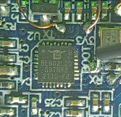

  • #495 21641905
    Cutin
    Posts: 92
    Rate: 11
    BL602L20
    KR2302 20220515 WiFi Smart Switch
    Close-up of BL602L20 chip on a blue PCB with visible wire connections .
    Disconnected BOOT cable, connected 3.3V, GND, RX and TX and pressed Open UART (Reading works as if in closed loop)
    Log file attached
    • Open_UART.txt (1.35 MB) You must be logged in to download this attachment.
  • #496 21642141
    Posts: 5062
    Help: 438
    Rate: 893
    OK.
    and if you open uart then power device?
    it should print boot logs in bottom window
    Added after 2 [hours] 9 [minutes]:
    eg. here's my boot log
    animated
    Animated Bouffalo Lab Dev Cube interface showing UART boot logs
  • #497 21642219
    Posts: 14615
    Help: 655
    Rate: 12632
    For me, it seems like it may be a classic issue on BL602. Bootloop on start caused by not enough power supplied to the module. BL602 will NOT work if it's powered from low quality 3.3V power source, especially if done via long wire, with no decoupling capacitors. We saw similar issues few times on forum already.
    Are you sure you're testing it powered via 230V? Does it work if you restore eWeLink firmware? Maybe something wrong is on the board itself, faulty capacitor?
    The solution often is simple- either power it as you are supposed to power it (but disconnect PC first), from smart device directly, or use a good LDO like AMS1117-3.3V, feed 5V to input and get good 3.3V from output.
    It may also help if @Cutin shows photos of his full setup.

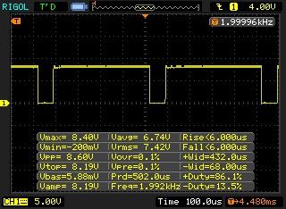

    Then I decided to flash without a backup, and finally succeeded.
    After connecting to my wifi, I launched the Web Application to back up the RF data from there. The config was all FFs (attached rfdata.bin), not sure why.
    Since it was empty anyway, I tried to recreate one - again, no success, got stuck on Restoring RF config....
    The device is working OK so far, but there are some concerns.
    First, the PWM frequency is 2KHz. Shouldn't it be 1KHz?
    Second, at 100% brightness, the duty cycle is ~86%. Is this expected?
    Square waveform on oscilloscope with detailed signal parameters
    P.S:
    this seems to have come up recently here too https://www.elektroda.com/rtvforum/topic4144560.html
    solevi wrote:
    I noticed that the BLDevCube app is toggling the DTR pin of the UART converter when accessing the chip. So I discovered that connecting the BOOT pin to DTR is a much more convenient way to flash the chip; no need to use the pull-up resistor.
    this is handy to know

  • #501 21699110
    solevi
    Sorry for the late reply, I have been busy lately.
    divadiow wrote:
    This function in web app is for BK7231N/T only I think
    Oh, I didn't realize that. I thought that the items shown were device-specific. Good to know.
    Thanks for the info, will be following the progress there.
    divadiow wrote:
    maybe your cables were too long? did you try lower baud rates?
    The cables were 6-7cm long, and I don't think that they're too long. Sorry, it's too late to check the baud rate ATM.
    And do you have any idea regarding the duty cycle?
