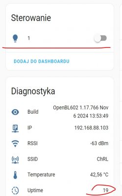

    I was so excited that I managed to flash it that I just changed the wifi settings. I thought I'd do the rest later...
  • #452 21251493
    Posts: 14667
    Help: 656
    Rate: 12683
    So maybe you've entered wrong WiFi settings? Do 5 quick power off/on cycles to enter safe mode (revert to access point).

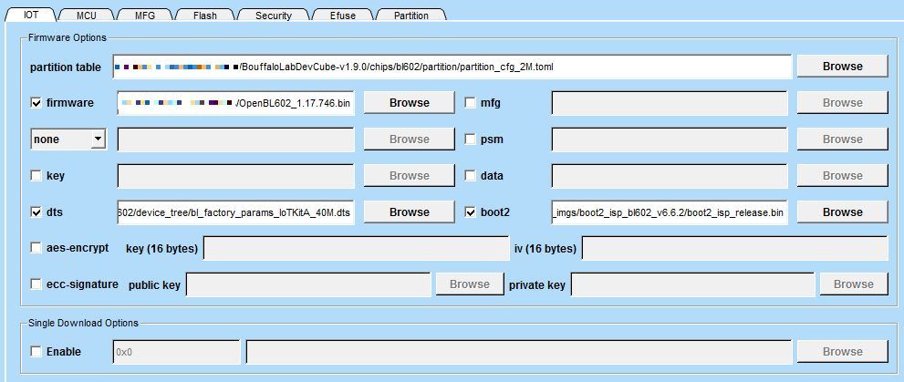

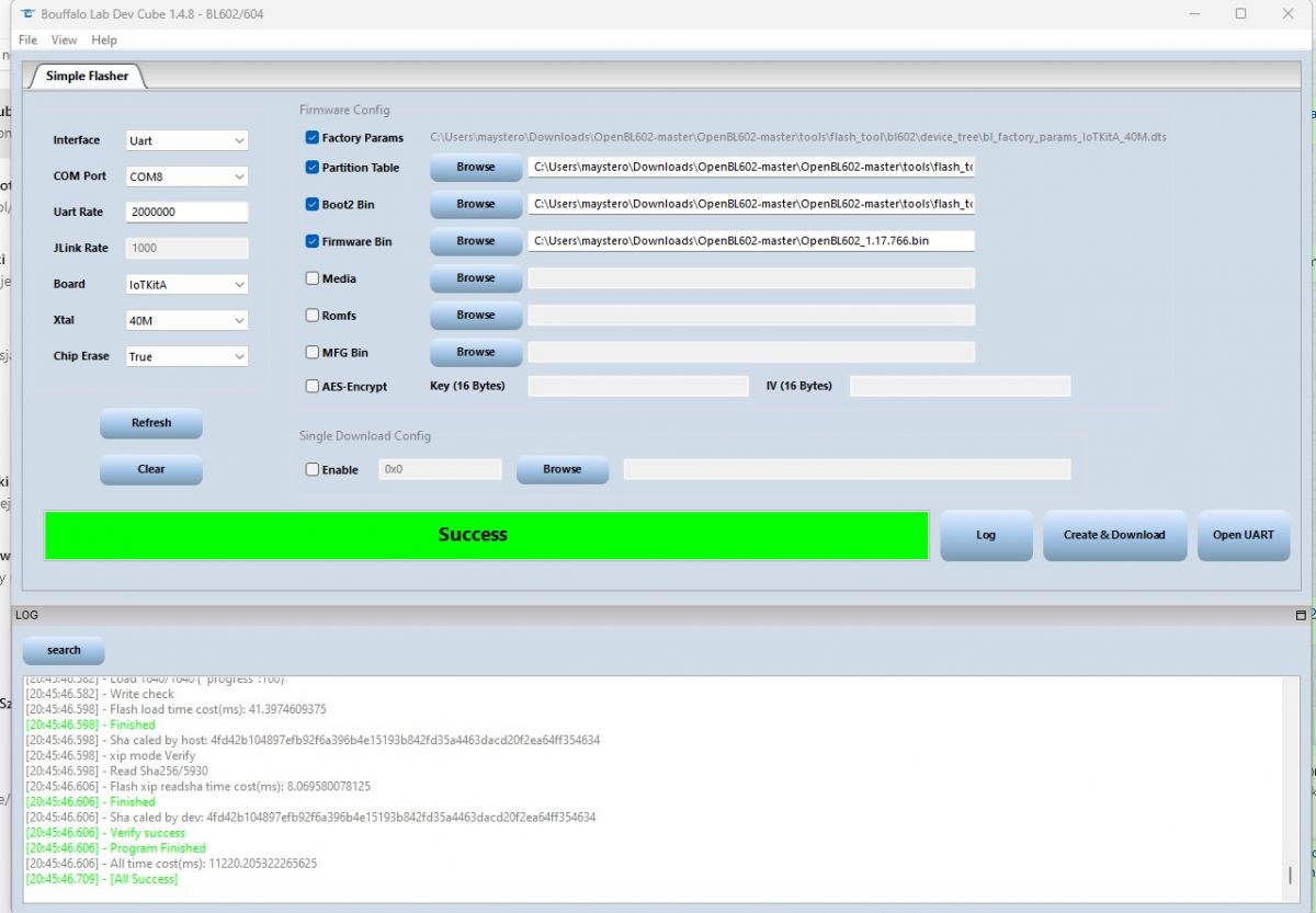

    update: I managed, I don't know how, to make my sonoff 1CH Ewelink Wifi RF Switch Module Inching recognize my home wifi. I'll start from the beginning. After several attempts to flash the device, fearing that I had already lost it, I set bouffalo lav dev cube on bl602, enter the program and set the parameters:
    partition table: ............./BouffaloLabDevCube-v1.9.0/chips/bl602/partition/partition_cfg_2M.toml
    firmware: .........../OpenBL602_1.17.741.bin
    boot2: ............./BouffaloLabDevCube-v1.9.0/chips/bl602/builtin_imgs/boot2_isp_bl602_v6.6.2/boot2_isp_release.bin
    I connect the device with the adapter to the PC, click on refresh, set chip erase to true (delete the old firmware), click on open uart and then click on create&download.
    I unplug everything, connect the sonoff directly with a USB cable, then from my smartphone (the PC did not connect) I enter the BL602 wifi (to connect you have to wait for the bl602 wifi to give the message internet not available!!!) and open the 192.168.169.1 page. I enter the menu and set the various parameters, except the wifi!!!!
    on module configuration I set p14 on rel to control the relay remotely. (I was unable to set the physical button on the device)
    I configure the MQTT parameters, configure Short Name and Full Name, go to Home and click on Restart.
    After a couple of minutes I connect to the new wifi (it takes the name of the device), I take courage, re-enter the SSID and password of my WIFI, click on SUBMIT, cancel and recheck the data 5 times and then click on OK. With little confidence I enter the menu of my router to search for the sonoff among the devices connected to the WIFI and finally I see it on 192.168.0.101. Now I just have to figure out how to make it recognize the various GPIO for any sensors.
    THANK YOU ALL!

    all solved! the problem was that I had not entered the fourth parameter in the dts entry.
    Software interface for device configuration with firmware, partition table, and other settings options.
    Pratically the router was unable to assign the correct Mac Address to the device and the wifi went into confusion. Now it takes it immediately, even powered by a normal usb charger. Now I just have to configure the contact sensor.
    Thanks again for the help!!

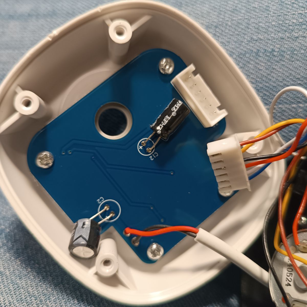

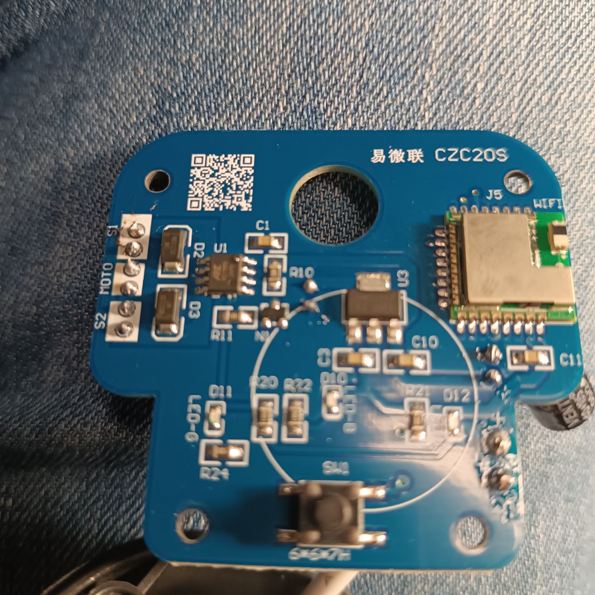

    >>21290296 What does this device look like inside? Do you have any pictures? What module from BL602 is in there?
  • #469 21291323
    lukasz06
    Posts: 9
    >>21291304 Close-up of an open electronic device mechanism showing a circuit board and wires. A printed circuit board with electronic components on a denim fabric background. Close-up of an electronic circuit on a blue PCB labeled CZC20S. .
    Unfortunately the valve died after 3 days, I sent it back for a claim. Unfortunately I have no more pictures

    Interesting, I initially thought it was the CBU footprint, but it doesn't fit.

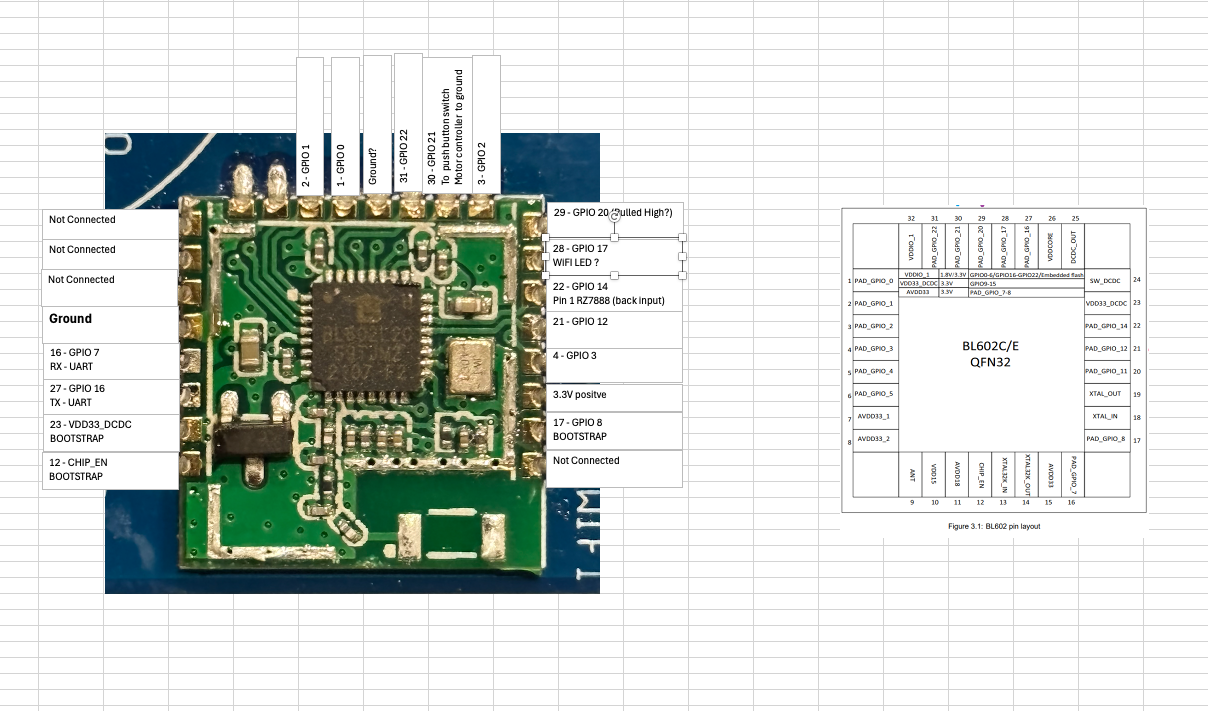

    Hey All,

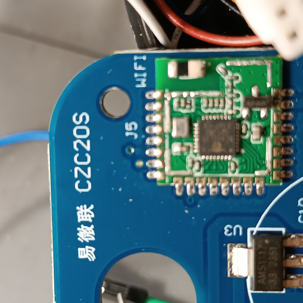

    I recently purchased this "Smart" Valve from Aliexpress
    Smart WiFi valve with remote control function
    I opened it up to flash new firmware to de-cloud it. Found it was a BL602, my first time coming across one. This thread has been absolutely fantastic.
    Ultimately I want to control using openhab, I will likely use MQTT to do so.
    I have managed to flash the software, overcome the wi-fi, and mapped what I think are the correct pins. (See Below)
    Image of a circuit board with pin labels next to a BL602C/E QFN32 layout diagram.
    I however Can't seem to get the motor to turn (to close/open the valve).
    From what I've been able to tell, the RZ7888 (motor driver) is connected via GPIO 14, and should close/open. According to this table I got from the datasheet.
    Pin function table and truth table for a valve from Aliexpress.
    I've tried using the pin finder to turn all of them from low to high, but it didn't seem to have any effect. Any assistance in trying to figure out what might be the best next course of action in trying to decipher this would be much appreciated. As I'm only a hobbyest.
    regards,

  • #474 21305127
    Posts: 14667
    Help: 656
    Rate: 12683
    Are you powering BL602 externally from the programmer? Motor control will only work if powered via device power supply.
    Can you show some photos from inside? Have you tried checking pins with multimeter?
    Also, this motor control requires two pins, not just one. So it could by GPIO with some other pin.

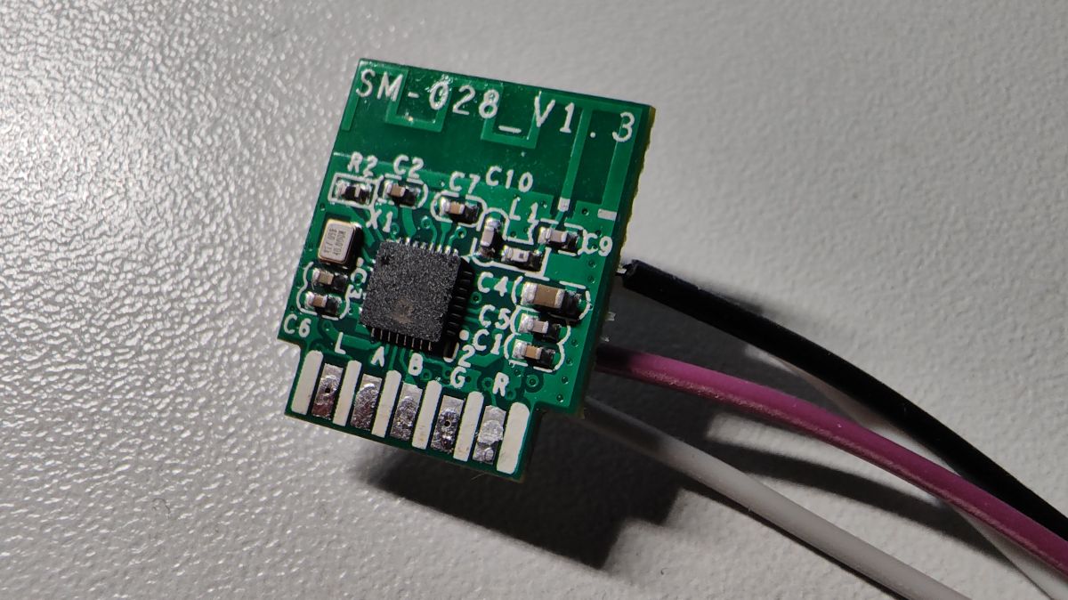

    I recently bought two simple switches (like Sonoff Basic) with BL602. I managed to flash them and configure WiFi and MQTT to connect to HomeAssistant. But the problem is that I can't connect both to AP simultaneously. When I turn them on separately (either first or second) everything is ok, I can see IP assigned in the router and I can see it configured in Tasmota. But it's impossible to connect them both to AP. Every time one of them is not recognizable.
    I tried to set up static IP, and change the MAC, and unfortunately, nothing helped.
    Did anybody have a similar problem? Any idea how to solve it?

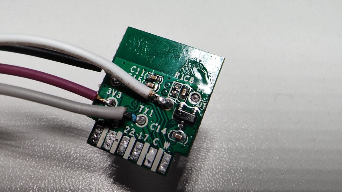

    >>21342476 Thanks for your help. Unfortunately while soldering, the BT pad fell off from the PCB... I assume ther's no chance to upload DTS files via OTA?

    Please show a detailed photo of the PCB, do you mean that the pad fell of directly from BL602 module, or from the mother board?
    Can you solder a wire directly to QFN pad?
    I could try...
  • #480 21347388
    wojtekrz
    Posts: 18
    From the motherboard. I don't have the appropriate soldering skills to solder the wire directly to the uC. I'm attaching the photos of both sides of the mb.
    Circuit board with an integrated circuit labeled SM-028_V1.3, with connected wires in various colors. Photo of the back of a printed circuit board with soldered wires.
