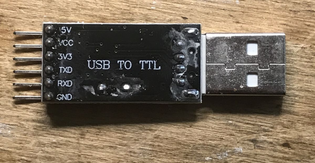

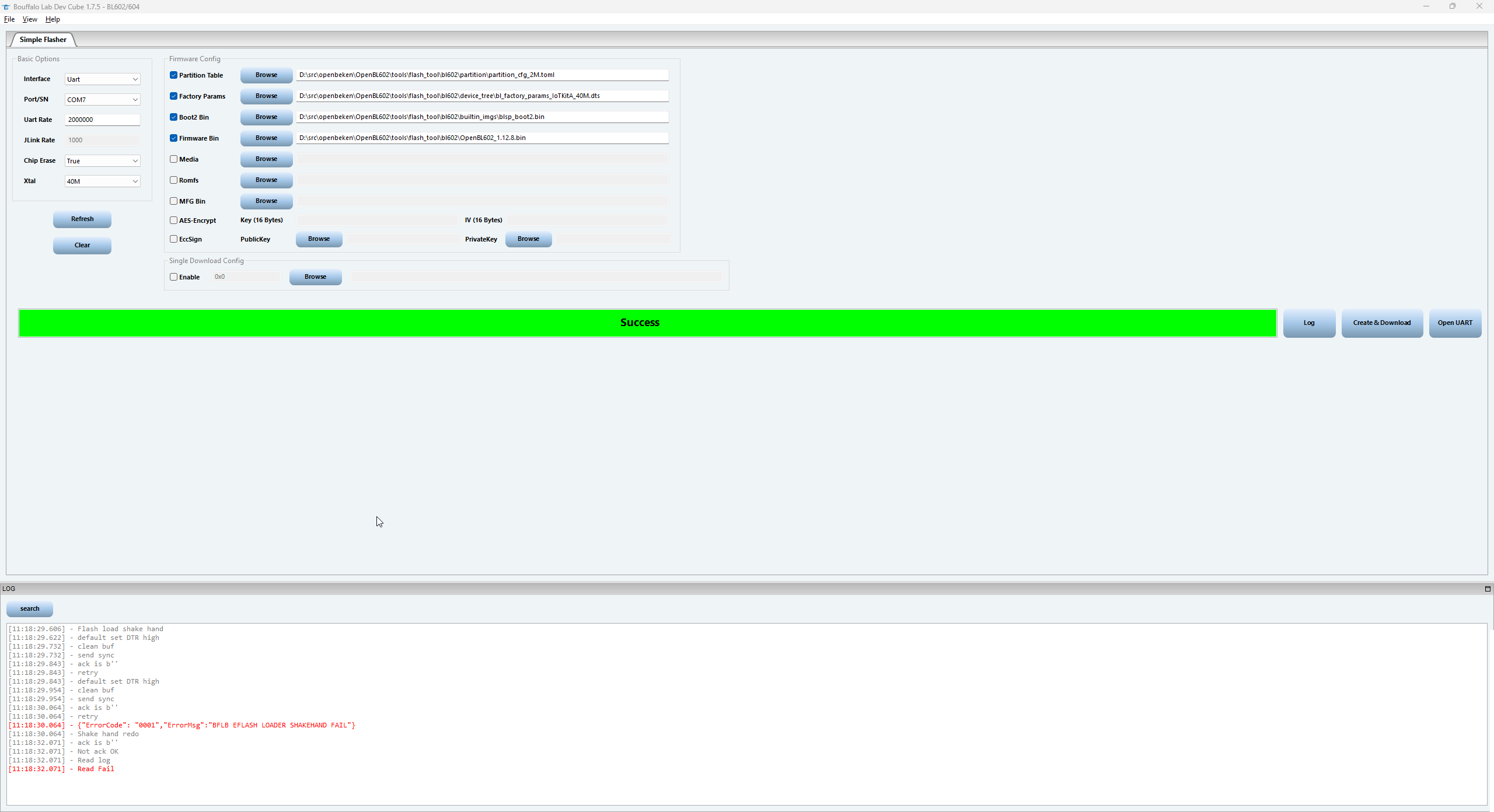

    Hello i flashed OpenBL602_1.12.8.bin on a Sonoff MiniR3 as described above.
    Flash was successful but the device does not boot after opening the boot-3,3V connection and power cycling.
    When i try to log in DevCube i get an error. Do i need a different Partition Table or Params?
    The Chip is a BL602L20.
    Some Pics and flash logs are in the attachment.
    Cheers Winux

  • DevCube version mismatch fixed flashing issue
    #122 20129679
    winux22
    Sorry totally my bad :D
    I had the same problem as bartek666666. I kinda missed that page of the thread.
    The problem was i downloaded the devcube programmer from the buffalos website. It's a different version.
    The one in your repo worked first try. I thought about deleting the post above, but i will leave it there for the pictures. Maybe it helps someone.

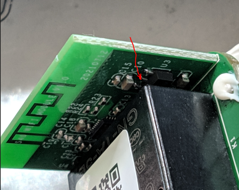

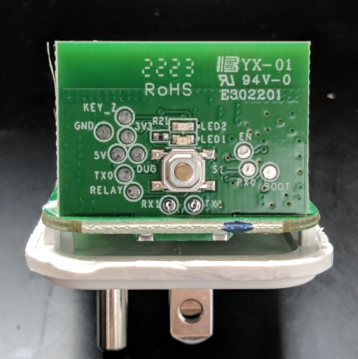

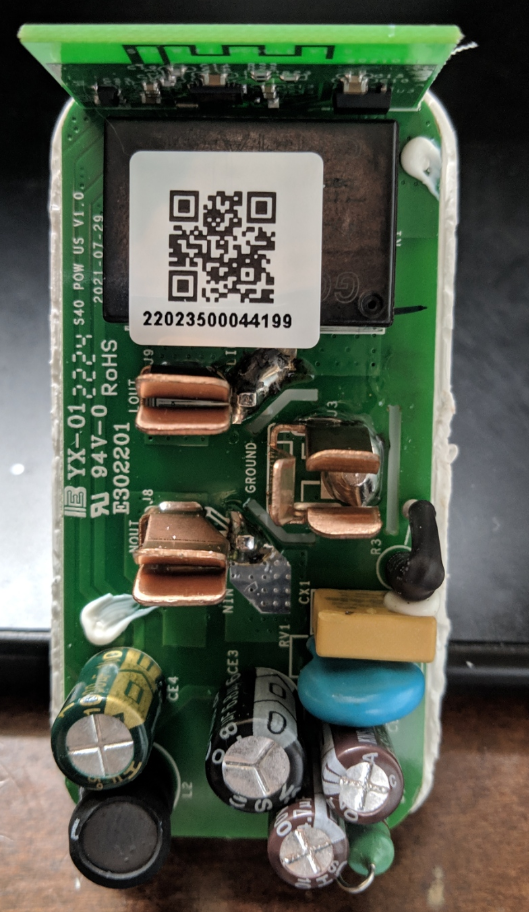

  • Bootloop after flashing Sonoff S40 BL602 firmware
    #124 20135575
    theugster
    Howdy!

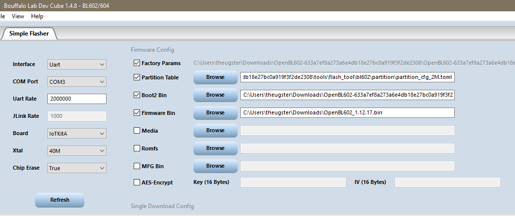

    First off, thanks so much for your work on this project! I accidentally bought a pack of Sonoff S40 smart plugs with power monitoring and figured I'd try to cut my losses and see if I could harvest the switch boards from these. Took *way* too long to get the correct wiring layout (the board has two sets of rx/tx pads for some reason) but I was eventually able to flash the latest firmware. Unfortunately it appears to be in a bootloop now, and never gets to a point where it's broadcasting a WiFi AP.
    The error(s) it appears to throw in the console are:
    [0m: bl_romfs.c: 146] romfs magic is NOT correct
    and
    [ 39][INFO : hal_gpio.c: 115] [gpio1] status = disable
    [ 39][ERROR
    : hal_gpio.c: 216] gpio1: unvalid GPIO config
    [ 40][ERROR
    : hal_gpio.c: 130] gpio2: unvalid GPIO config button
    [ 40][ERROR
    : hal_gpio.c: 216] gpio2: unvalid GPIO config
    [ 41][INFO : hal_gpio.c: 106] gpio3 NOT found
    I've attached some logs and a screenshot of the Dev Cube app. Happy to provide some pictures of the board itself as well, this seems to be a fairly new one.
    Thanks again!
    • Tasmota replacement for BL602, programming, pairing with Home Assistant, now with OTA working! devcube_1.4.8.png (27.22 KB) You must be logged in to download this attachment.
    • S40_Serial_Log.txt (12.46 KB) You must be logged in to download this attachment.
    • flash_log.txt (21.54 KB) You must be logged in to download this attachment.
  • Try the SDK GPIO demo and share wiring photos
    #125 20135712
    Posts: 14797
    Rate: 12954
    That's a strange error, I have never seen it before.
    At first, can you try downloading compiled GPIO demo from their SDK, here:
    https://www.elektroda.com/rtvforum/topic3889041-90.html#20117857
    and checking if at least it works on your device? It has an UART console to control pins. Try commands from the first post from this topic, gpio-func, gpio-set, etc...
    Also, good job with finding the wiring. Can you please photos of boards and the wiring to help other users with flashing Sonoff S40?

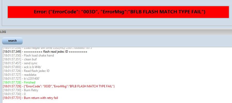

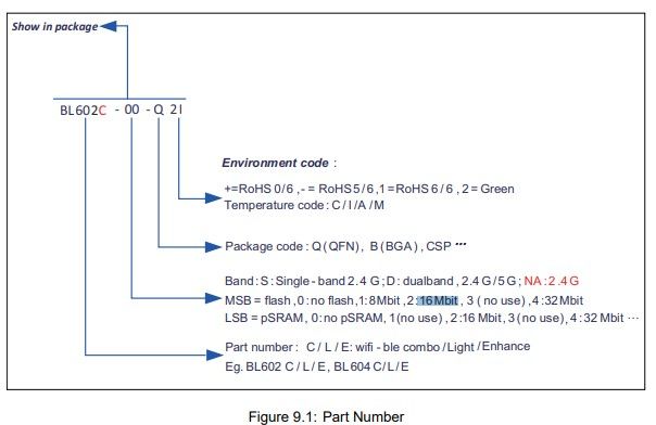

  • BL602L20 flashes with BLDevCube but won’t boot OpenBeken

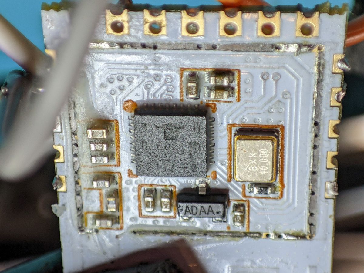

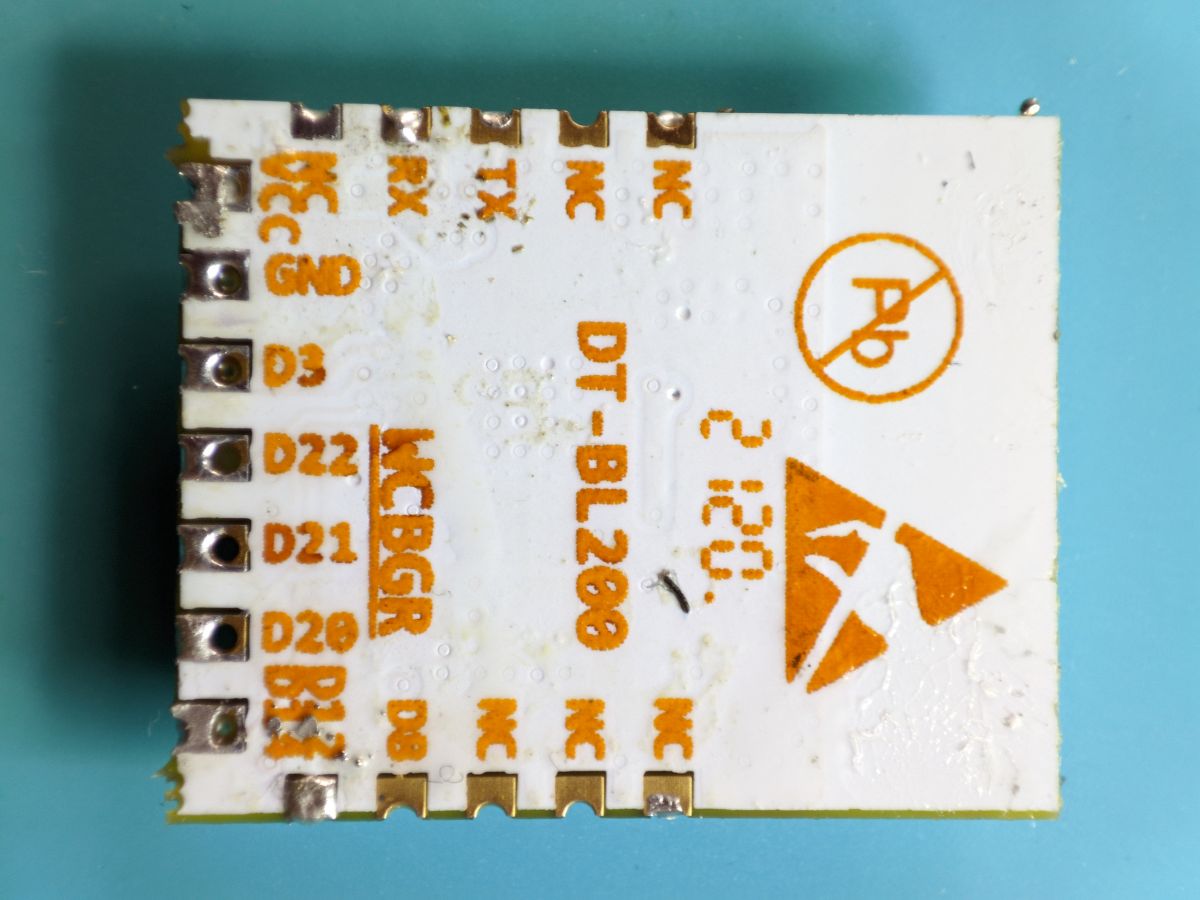

    #127 20151469
    blakadder
    Posts: 11
    I got a CozyLife bulb with a DT-BL200 slightly different from the one p.kaczmarek2 posted. Mine doesn't have anything written on the RF shield and the code on the back is `2120`.
    Removing the shield reveals a BL602L20 chip. According to the datasheet L is for "light" chips compared to the usual C/E which tracks.
    I wasn't able to flash it using the DevCube flashing tool in the Open602 repo. It errors out after trying to read flash vendor ID.
    Flash was complete using the latest official BLDevCube 1.7.5. but OpenBeken firmware does not boot.
    It seems to be related to https://gist.github.com/lupyuen/2cb2034a436dc75acc1aeb63ea3b9aa1
    Tasmota replacement for BL602, programming, pairing with Home Assistant, now with OTA working! Tasmota replacement for BL602, programming, pairing with Home Assistant, now with OTA working!

    mgerald21 wrote:
    But in the end it was my fault because the chip was powered by the USB adapter's 3v3 and obviously that wasn't enough .
    did you use this USB to UART dongle?
    as far as I know, the 3.3V and 5V pins are just used to select VDD levels by puting a jumper between them.
    Still, the WiFi crash due to low power is also known to me. I even had device with a faulty electrolytic capacitor which started randomly resetting because capacitor gone bad and power supply was not providing enough stable voltage/current.
    See (not yet translated):
    https://www.elektroda.pl/rtvforum/topic3898805.html
  • #134 20156633
    mgerald21
    Yes, these USB dongles seems to have an internal 3v3 LDO which can provide enough power for flashing but not for regular WiFi operations.
  • #135 20156680
    Posts: 14797
    Rate: 12954
    It's a classic trap for young players, this is why I have soldered extra wire directly to 5V pin on that USB to UART dongles, and use it along with TC1264 3.3V LDO or the on-board LDO of smart device pcb if possible
  • #136 20156698
    blakadder
    Posts: 11
    Some adapters sometimes do not even have enough power for flashing, depending on the chip/ module you're flashing. In Tasmota community we always recommend the "golden CH340G" which always works.
    If you're looking for a bit more serious tool get an ESP8266 burner board (https://s.click.aliexpress.com/e/_DeodsyT *affiliate link)

  • #146 20196386
    bxwen19
    Posts: 9
    Got one S40 openned. Please let me know what I should do next. There are Tx0, Rx0, Tx1, Rx1. Tasmota replacement for BL602, programming, pairing with Home Assistant, now with OTA working! Tasmota replacement for BL602, programming, pairing with Home Assistant, now with OTA working!
  • #147 20196491
    Posts: 14797
    Rate: 12954
    So that's a BL602 device? Well, you need 3 signals - BOOT (visible on photo), RX1 and TX1 (visible on photo).
    Also you need to power it, and NEVER power it from mains while programming - this might even destroy your PC. Maybe you can power it from 5V, 5V and GND pads are also visible on photo.
    Where does the 5V pad go? To AMS1117?
  • #148 20196810
    bxwen19
    Posts: 9
    To my surprise, 5V is connected to pin 2 of U3, which looks like an ams1117.
  • #149 20196840
    Posts: 14797
    Rate: 12954
    Then you don't need an external 3.3V LDO regulator. You can use that AMS1117. So, you need to solder 5V, GND, TX, RX and boot. Please also read the instructions in the first post.
