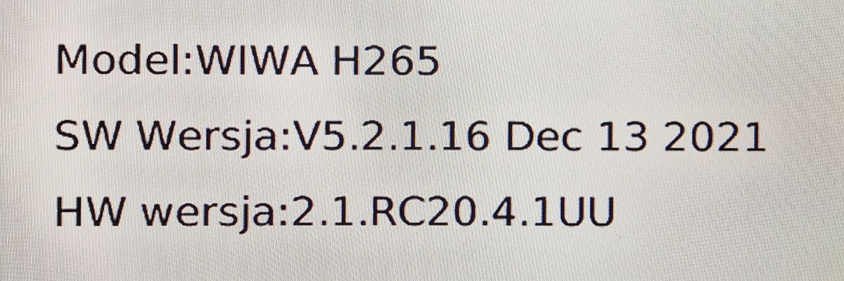

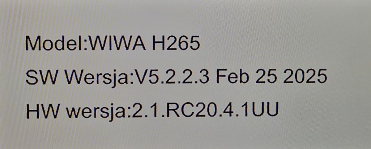

    sq3evp
    Posts: 6540
    Help: 219
    Rate: 869
    funzen wrote:
    What version do you have currently uploaded ?
    Upload a photo of the menu with info about the soft version in the decoder.
    It was:
    WIWA H265 tuner - the issue of updating via usb / network and network operation .
    Uploaded:
    As you can see the font has changed
    I uploaded a new version to SW Version:V5.2.1.16 Dec 13 2021
    HW version:2.1RCC2.4.1UU.
    New .bin file from post #132.
    Newer file already uploaded then I uploaded to the old version (was Model:WIWA H265SW VersioniV5.0.0.49 Jan 3 2020; HW Version:2.1.CC20.4.1):
    • upgrade_7T10E_WIWA_H.265_V5.1.0.52.bin (3.79 MB) You must be logged in to download this attachment.
