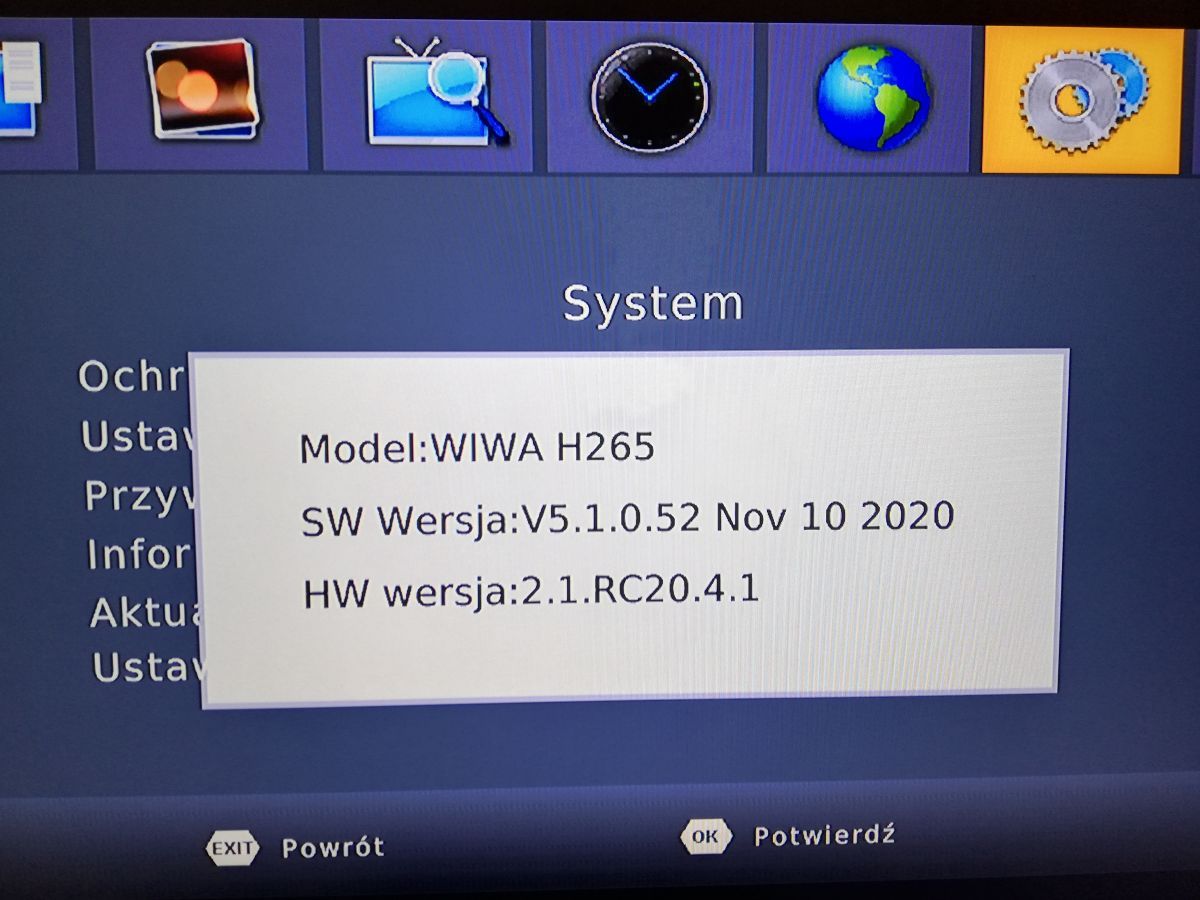

    I have already downloaded; fellow forum members have helped with points :-) for which many thanks. Unfortunately, the new software did not fix the problem. The tuner continues to reboot when searching for TV stations.
    At the moment the installed soft: 5.2.2.3Feb25.2025
    HW version: 2.1RC20.4.3UU

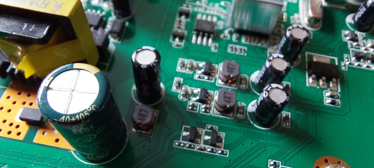

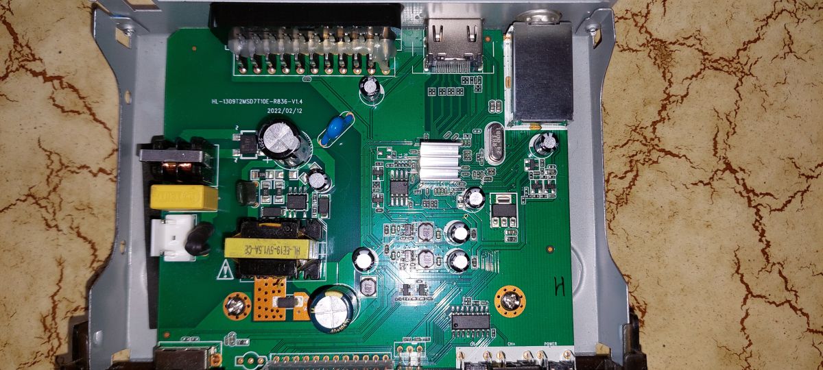

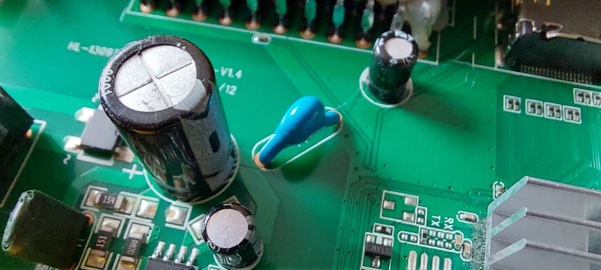

  • Antenna connection triggers resets during channel search
    #154 21780335
    tgralinski
    Posts: 7
    The capacitors appear to be ok and I will describe the operation of the tuner below:
    On the old firmware (2020 I think)
    - after switching on I restored to factory settings
    - connecting the antenna
    - searching for programmes
    - after searching and starting a programme the device resets over and over again
    - after disconnecting the antenna from the tuner the tuner stops resetting
    - after restoring to factory settings (deleting program memory) and connecting the antenna the tuner does not restart
    After uploading new software (the one from 2025):
    - the tuner restarts when searching for programmes.
    Inside of DVB tuner showing main PCB with capacitors, connectors, and electronic components
    Close-up of electrolytic capacitors on a green printed circuit board
    Close-up of electrolytic and ceramic capacitors on green PCB
  • #155 21780353
    funzen
    Level 25  
    Posts: 524
    Help: 73
    Rate: 254
    Well, they actually look ok
    And check that with the aerial disconnected and the film running from the memory stick works correctly.
  • #156 21780375
    tgralinski
    Posts: 7
    Movies from USB are playing.
    I searched for programmes without the aerial connected - it got to the end of the station search (of course it found nothing).
    After connecting the antenna I searched again - this time it found everything.
    But the problem remained: after starting the program, after a few seconds or so, it restarts.
    Maybe I will actually replace the capacitors prophylactically....

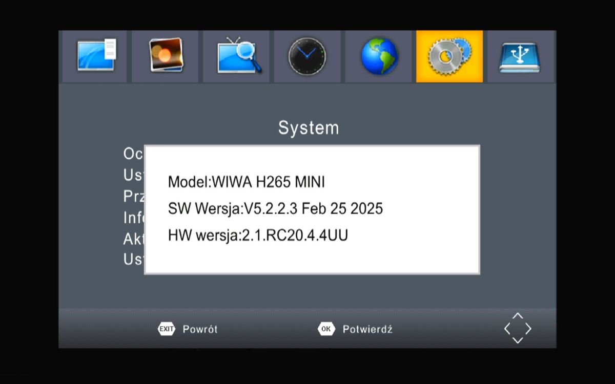

  • #174 21889128
    LteTuner
    >>21887511
    Thank you! When i tried to update it i accidentally turn it off, and when i turn it on again it stucks on the logo screen. It is broken?
    I tried to use the flash drive with the firmware file but it flashes only for 5-6 seconds.
  • Interrupted firmware update likely corrupted the tuner
    #175 21889364
    krzysiozak
    Level 40  
    Posts: 6650
    Help: 510
    Rate: 1154
    LteTuner wrote:
    >>21887511
    Thank you! When I tried to update it, I accidentally turned it off, and when I turned it back on, it jammed on the logo screen. Is it corrupted?
    I tried using a flash drive with the firmware file, but it only flashed for 5-6 seconds.
    Is it under warranty? Is there an after warranty service available where you bought it? Have you tried unplugging it and restarting it.
    It won't do without service, it may not even be cost effective to repair.
    Contact the service, write what they have told you about the problems you have caused.
    WIWA SERVICE
    1 Taśmowa St
    02-677 Warsaw
    Service open from Monday to Friday from: 8.30-15.30
    Phone: 22 654 76 66, 22 654 77 45

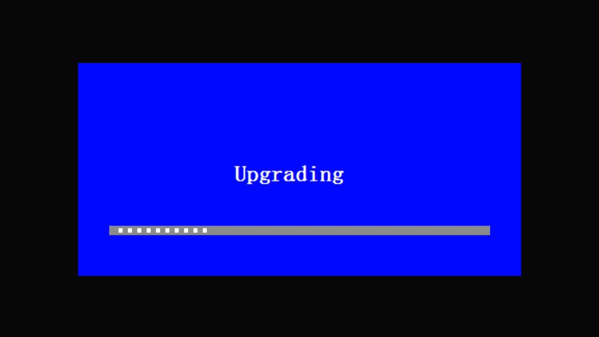

  • USB force-upgrade procedure for WIWA H265 tuner
    #176 21889472
    funzen
    Level 25  
    Posts: 524
    Help: 73
    Rate: 254
    Flash drive is flashing, which means the decoder is looking for the softwares on the flash drive
    If the boot is fully operational, try this file
    ForceUpgra..App.bin (3.7 MB)You must be logged in to download this attachment.
    1.Flash drive format Fat32
    2.Copy the ForceUpgradeApp.bin file to the Flash Drive
    3.Decoder unplugged
    4.Insert the Flash Drive into the decoder.
    5.Power on the decoder.
    If the boot is working, you can see it on the screen
    WIWA H265 tuner - the issue of updating via usb / network and network operation
    wait until the progress bar reaches the end and the decoder boots itself.
    After this, switch off the decoder with the remote control and disconnect the flash drive.
  • #177 21889544
    LteTuner
    >>21889472
    Thank you very very much!!! That worked!!!! You are a life saver!!!
