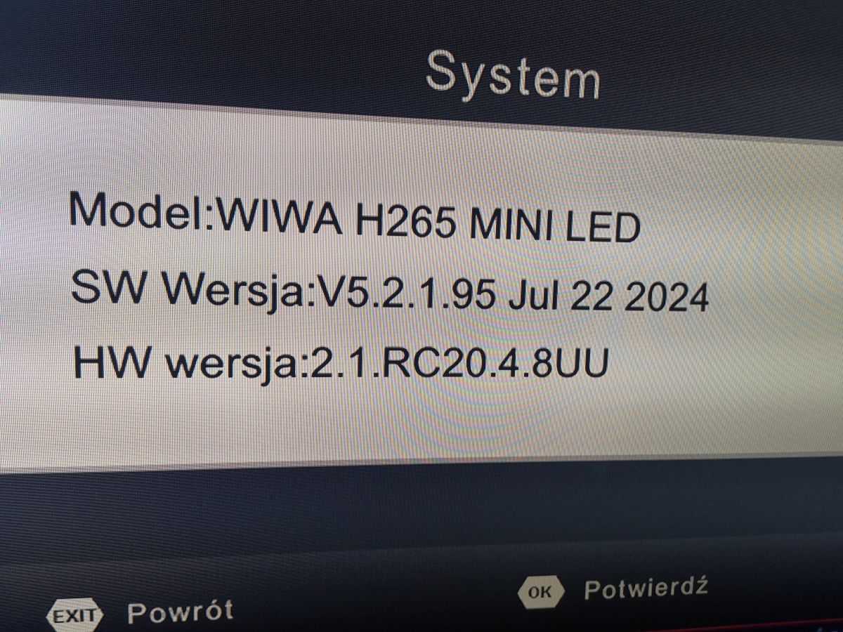

    The latest original software for WIWA H265 Mini Led
    in attachment I send software files - upgrade_MINI_LED_V5.2.1.95.bin
    Restore factory settings before and after the upgrade.
    So we start with:
    - press the "menu" button on the remote control.
    - select the "System" tab (cogwheel)
    - select "Restore factory settings"
    - password: 000000
    Then:
    - select "Software update" -> "Update via USB"
    Once the update is complete, the decoder will reset itself. Restore
    factory settings again.
    System menu of WIWA H265 MINI LED showing model and software version information. .
    • upgrade_MINI_LED_V5.2.1.95.bin (3.7 MB) You must be logged in to download this attachment.

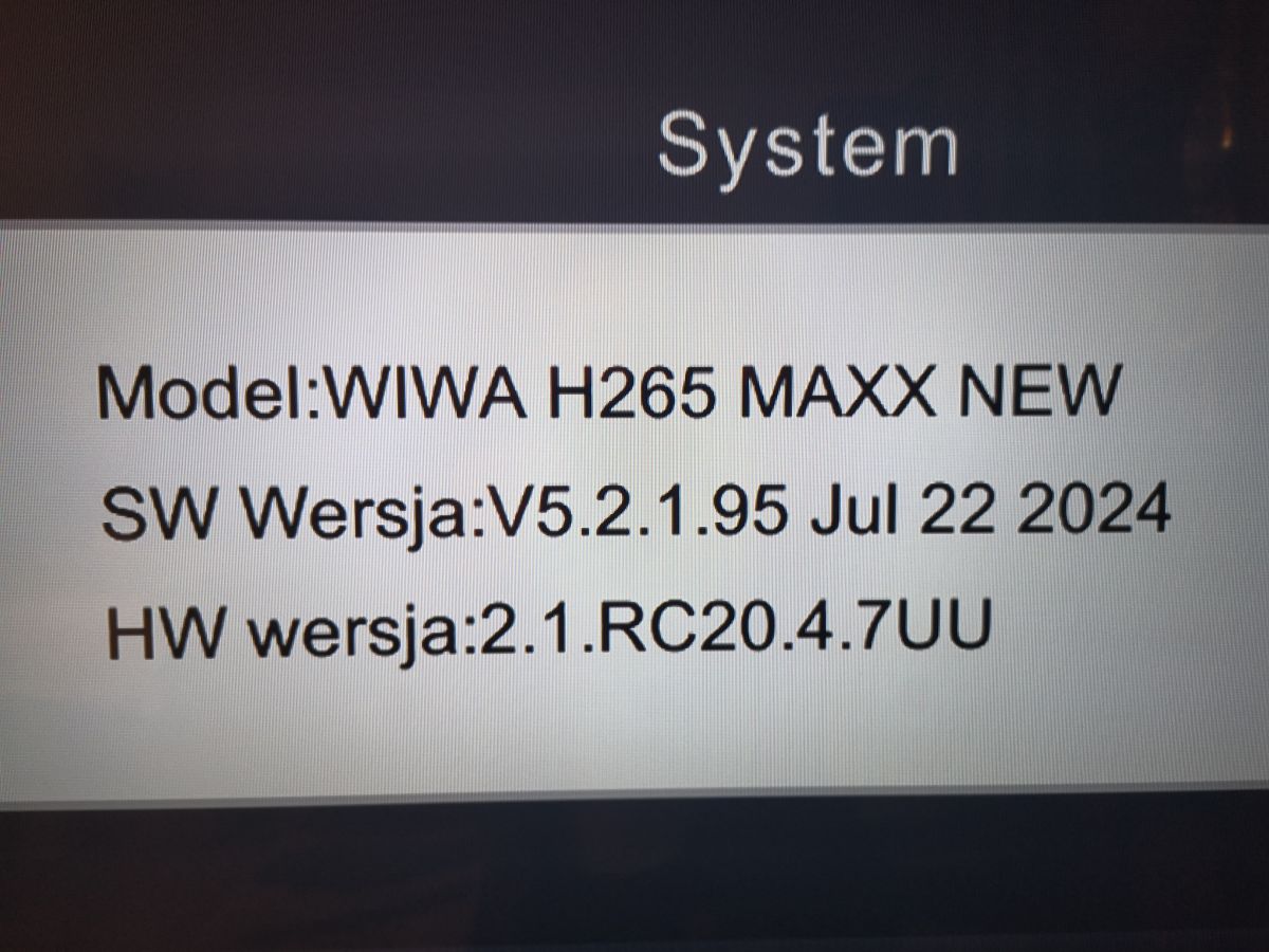

    I have a new WIWA H265 new bought somewhere a week ago in MediaMarkt and they gave me some software V5.2.2.3 Feb 25 2025.
    Model: WIWA H265.
    HW version: 2.1.RC20.4.1UU.
    Previously shop off the shelf was a different SW: V5.2.1.95 Jul 22 2024.
    same: HW version: 2.1.RC20.4.1UU,
    And now I want to go back to the previous shop one, because on this new one my 1080p display has disappeared, when I turn on the screen flashes, before it worked.
    On this new one there is only 1080i left to set, 1080p can not be set and on YouTube the image has deteriorated, bigger rectangles and image quality in general on everything has deteriorated.
    And breaks off my picture somewhere, worst on Polsat News Politics, MUX-8, MUX-1 and others TNIE, RWIE IMAGE every few seconds. When changing to a channel from a weaker mux ( with a weaker signal) it thinks for a long, long time, switches to that channel, and then rips. I am thinking all the time to return it, I have 2 weeks, because it rips and too weak head has it, in a light wind it breaks everything,
    Where on a Panasonic smart TV with the tuner built in there there are no such problems on the same Telmor antenna and Telmor crossover and nothing rips on any channel. The channels change quickly.
    So I don't know anymore, what are these new decoders being sold these days? And that it rips everything and cuts right on them.
    And on the same antennas well set up. Where on the smart TV the signals are 100/90%, and with this off-set 80/70% and it breaks everything.
    Something must be wrong with the head unit or the software.

  • #110 21570183
    blondynek102
    Posts: 42
    Board Language: polish
    I gave this: upgrade_7T10E_HW2.1.RC20.4.1U_WIWA_V5.2.1.47.bin and it works, but still 1080p image flashes.
    Over the internet I am now trying to upgrade this and it won't give.
    It says software update, search.... and searches and can't find anything.
    Manually from USB now I will give what you gave above.
    Only after installing this version of yours:
    upgrade_7T10E_HW2.1.RC20.4.1U_WIWA_V5.2.1.56.bin
    invented for me over the internet the version I had, and the latest version, viz:
    upgrade_7T10E_HW2.1.RC20.4.1U_WIWA_V5.2.2.3.bin
    And the one I wanted, I see I skipped at all, viz:
    upgrade_7T10E_HW2.1.RC20.4.1U_WIWA_V5.2.1.95.bin
    I'm not going to combine anymore, I'm going to leave it on the latest one, viz:

    It's probably to the one with HW 2.1.RC20.4.1UU that you can confidently upload the latest software, and to the other one with HW 2.1.RC20.4.1 I wouldn't risk it, because it may already be too old on other chips, a different, older, similar version of the motherboard, but there may be differences, I don't rule it out, especially as the HW is missing the UU at the end and that probably won't work properly and how it still won't release it.
    You see, the older one already has just the quality itself and now another one for a new soft not from that might just damage it. So a risk on your account.
    The warranty doesn't cover it anymore either, so whatever you think. At most you will go to the shop for a second new one, this regarding the older one with this HW 2.1.RC20.4.1 without UU.
    In this older one there is also too old a version of SW v5.0.0.49 and you don't know if this latest one will run so immediately and at all, it could be that it won't install it at all because there is another HW without UU.
  • #119 21575855
    sq3evp
    Posts: 6334
    Help: 210
    Rate: 833
    This will leave me with what is :) .
    The risk is too great.
  • #120 21577006
    blondynek102
    Posts: 42
    Unless you can use it for a loss, the old one, then you can test what it will be. And there, not such a big risk, the new one costs 120 zl, the older one probably the price of it has already halved to 60 zl or less, as in 2020 bought and already 5 years old, after the warranty and just like the older one strongly arranged. Exactly, or maybe not and it is the same?
    But the UU may make a difference, unless there is a similar if not identical motherboard in it with the processor, then it will cog.
    Model the same, but just HW different and it might not go, because technology and chips also change with the years, they move forward and to newer ones, so this newer version of software on an older model might not work, as I wrote. If you take a chance, can you write what happened, did it install, did it not want to, does it work and how, did it stop working altogether?
