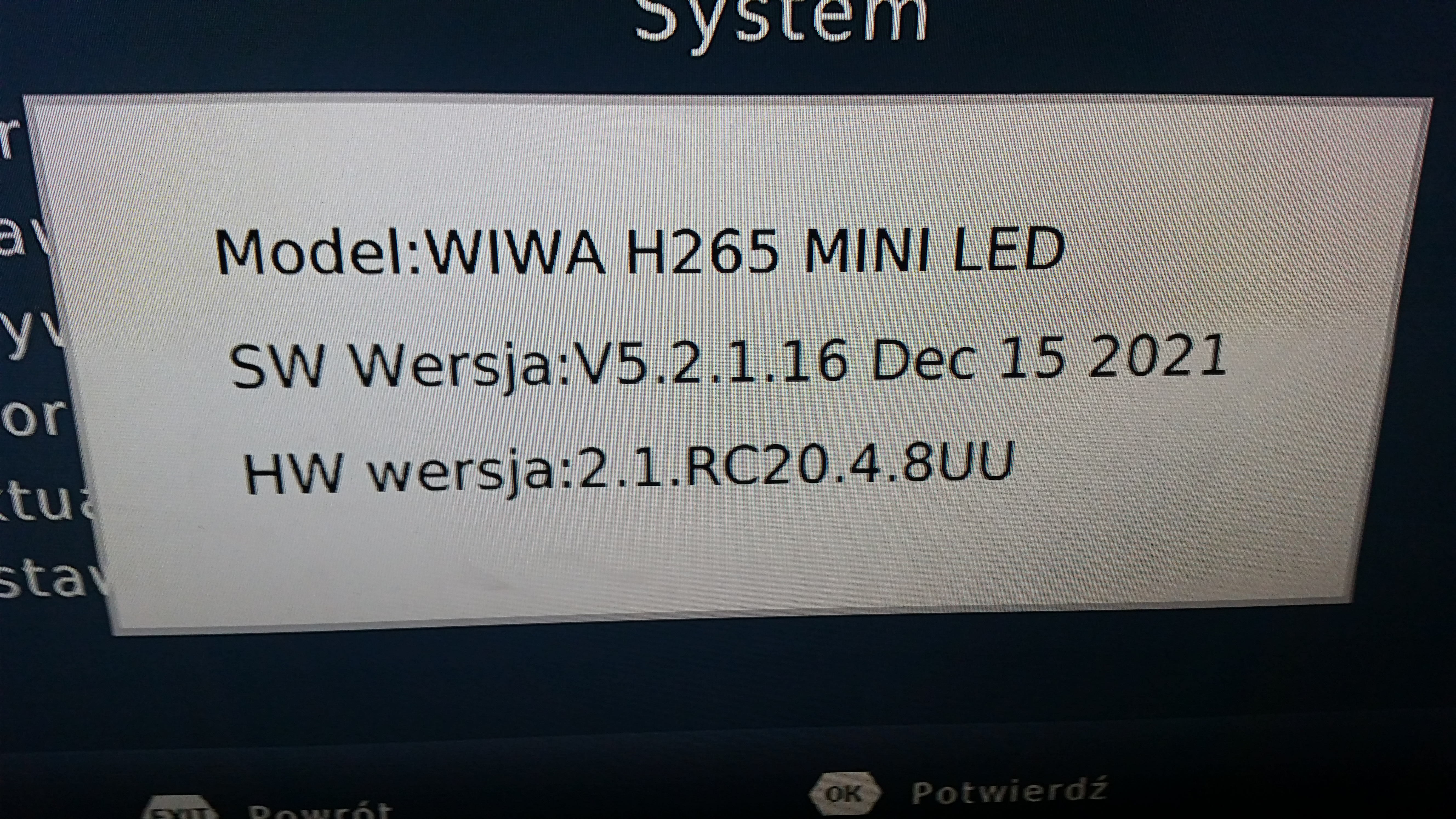

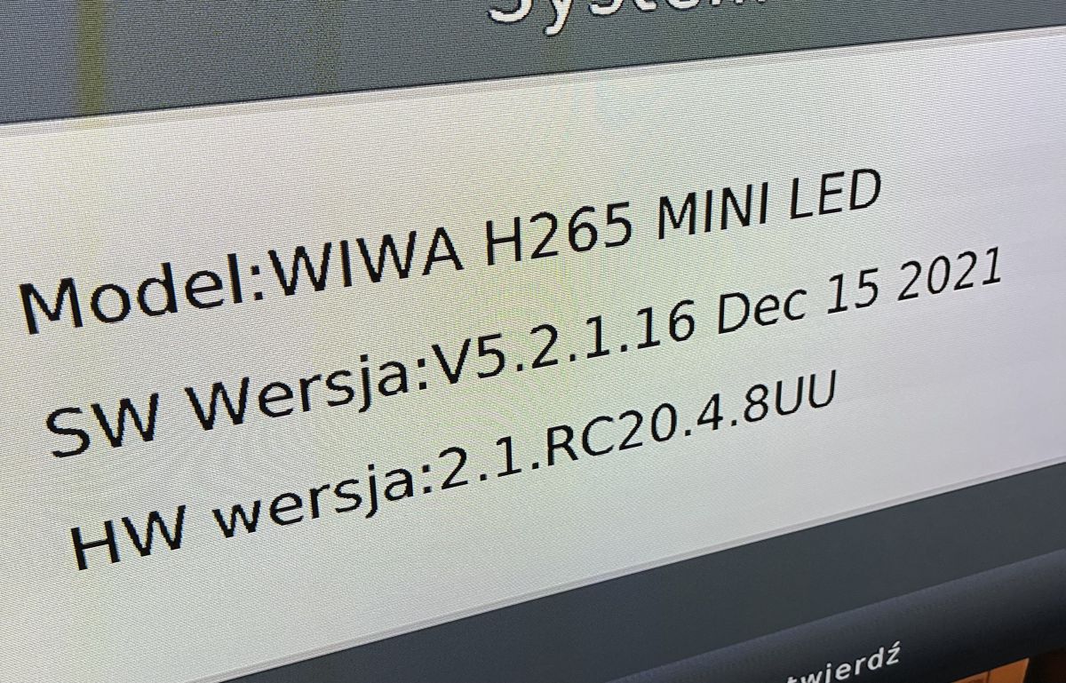

  • #36 20740864
    wojtasso88
    Well, it was about uploading :)
    This is my version. Screen displaying system information for the WIWA H265 MINI LED model.
  • #37 20740879
    funzen
    Level 25  
    Posts: 524
    Help: 73
    Rate: 251
    The latest original software for WIWA H265 Mini Led
    v5.2.1.56
    • upgrade_7T10E_HW2.1.RC20.4.8U_WIWA_MINI_LED_V5.2.1.56.bin (3.73 MB) You must be logged in to download this attachment.
  • #38 20740884
    wojtasso88
    Well, I downloaded it, put it on a pendrive and tried to run the update from it and I got this message.
  • #39 20740888
    funzen
    Level 25  
    Posts: 524
    Help: 73
    Rate: 251
    And where did you take him from?
  • #40 20740894
    wojtasso88
    Your post is above, but now I see that it is different.
    I'll install it tomorrow and let you know 😀
  • #41 20740946
    dzg4
    Posts: 1687
    Help: 129
    Rate: 356
    Version WIWA H265 Mini LED
    v5.2.1.56
    cannot be uploaded, displays the message INVALID SOFT.
  • #42 20740954
    funzen
    Level 25  
    Posts: 524
    Help: 73
    Rate: 251
    This is software only for the Wiwa H265 mini LED tuner.
    Posted for my friend wojtasso88
    Make a photo menu with the wiwa version.

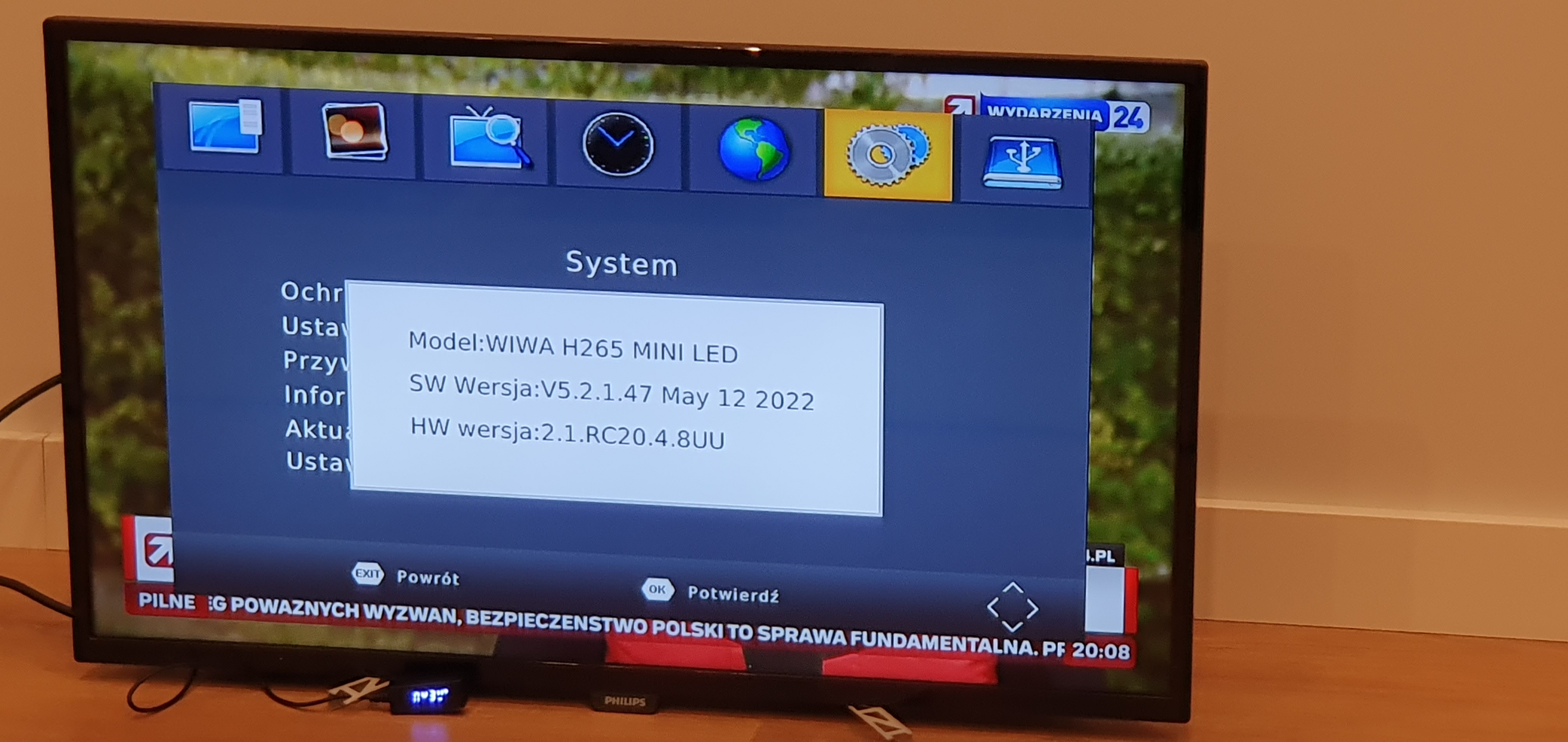

  • #43 20740973
    dzg4
    Posts: 1687
    Help: 129
    Rate: 356
    WIWA H265 Mini Led SW version
    v5.2.1.47 May 12 2022 HW 2.1.RC20.4.8UU has been working flawlessly in my case for half a year now.
  • #44 20741053
    funzen
    Level 25  
    Posts: 524
    Help: 73
    Rate: 251
    First check if the previous version loads.
    Restore factory settings as a precaution
    • upgrade_7T10E_HW2.1.RC20.4.8U_WIWA_MINI_LED_V5.2.1.47.bin (3.7 MB) You must be logged in to download this attachment.
  • #45 20741355
    wojtasso88
    It's fine for me now, the new version is installed. Thank you very much.

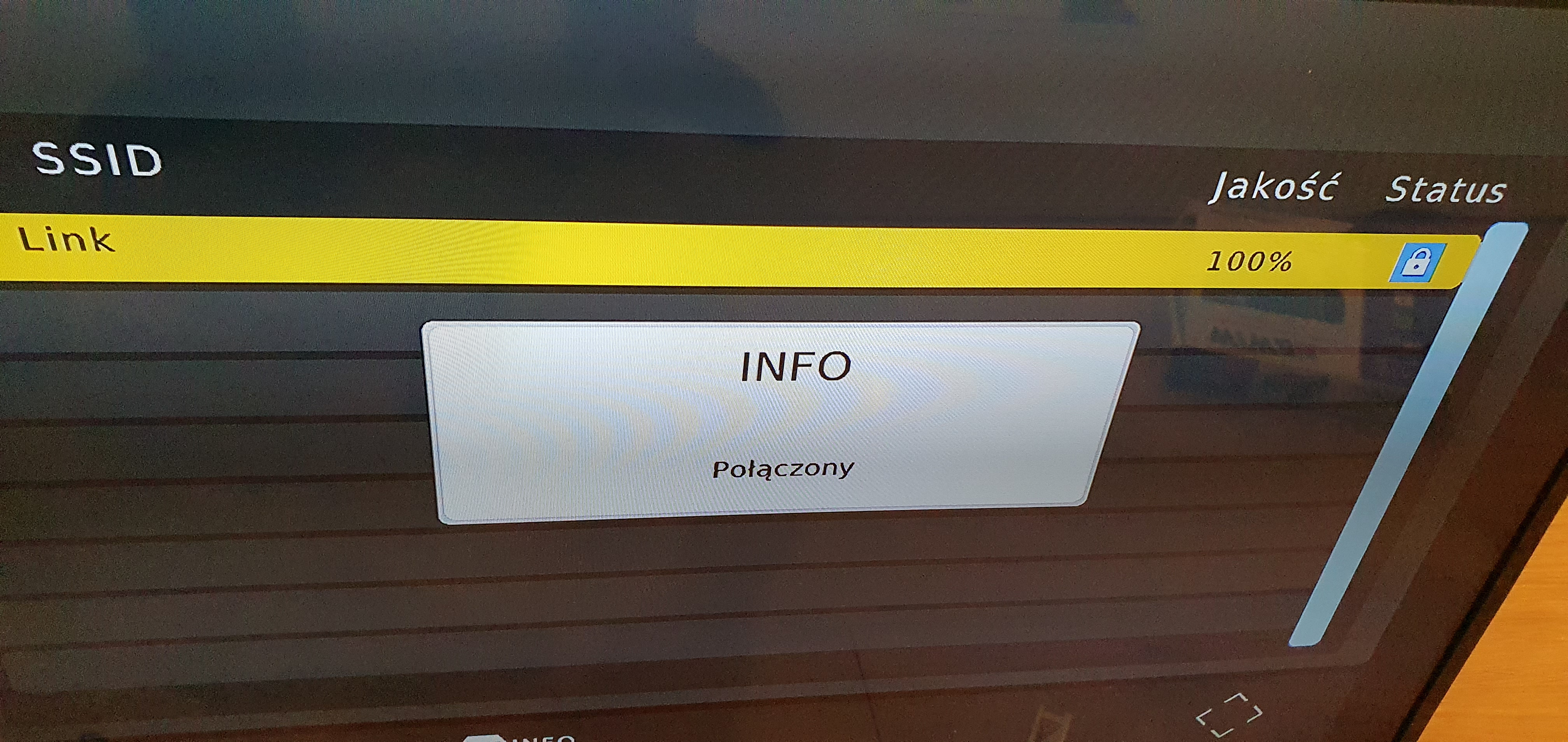

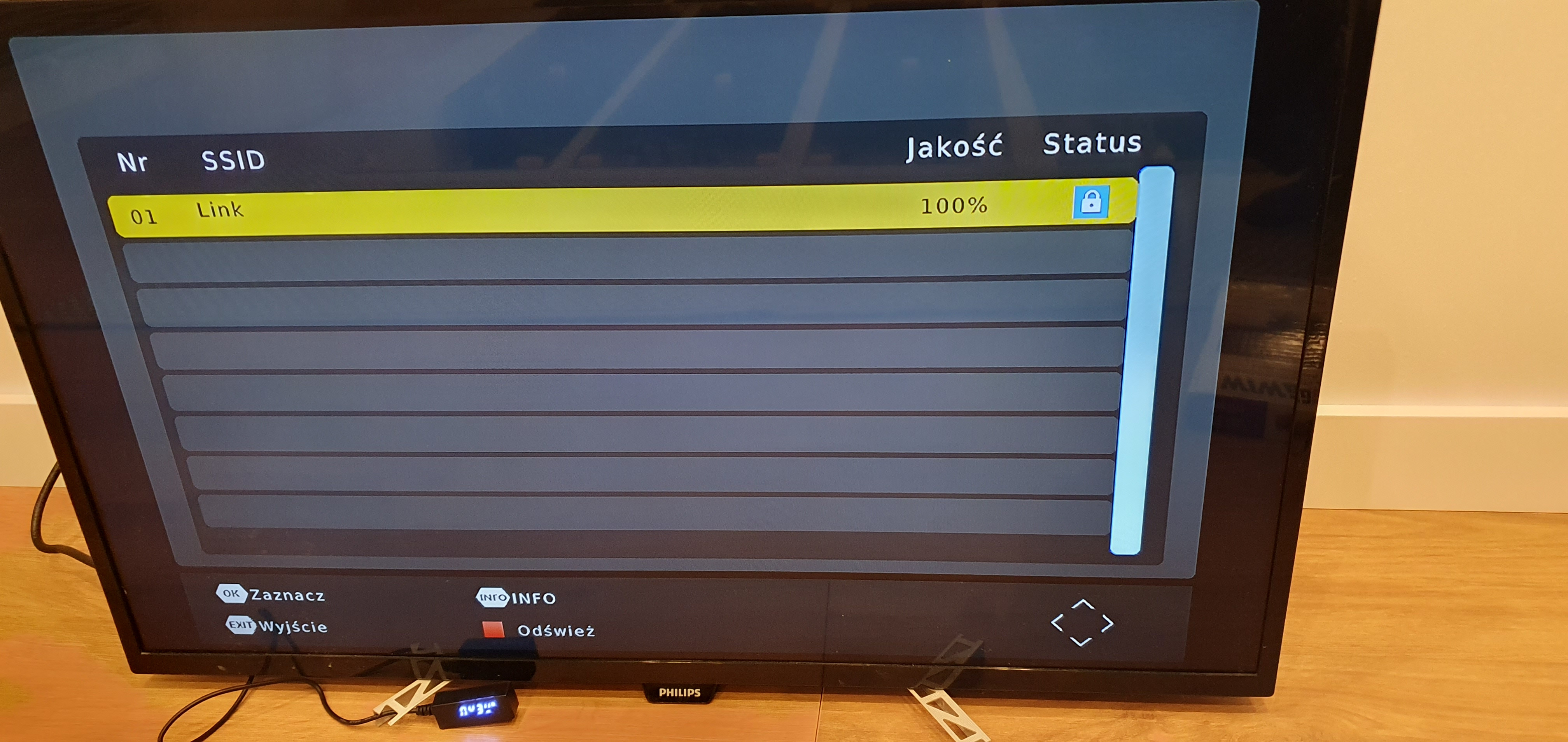

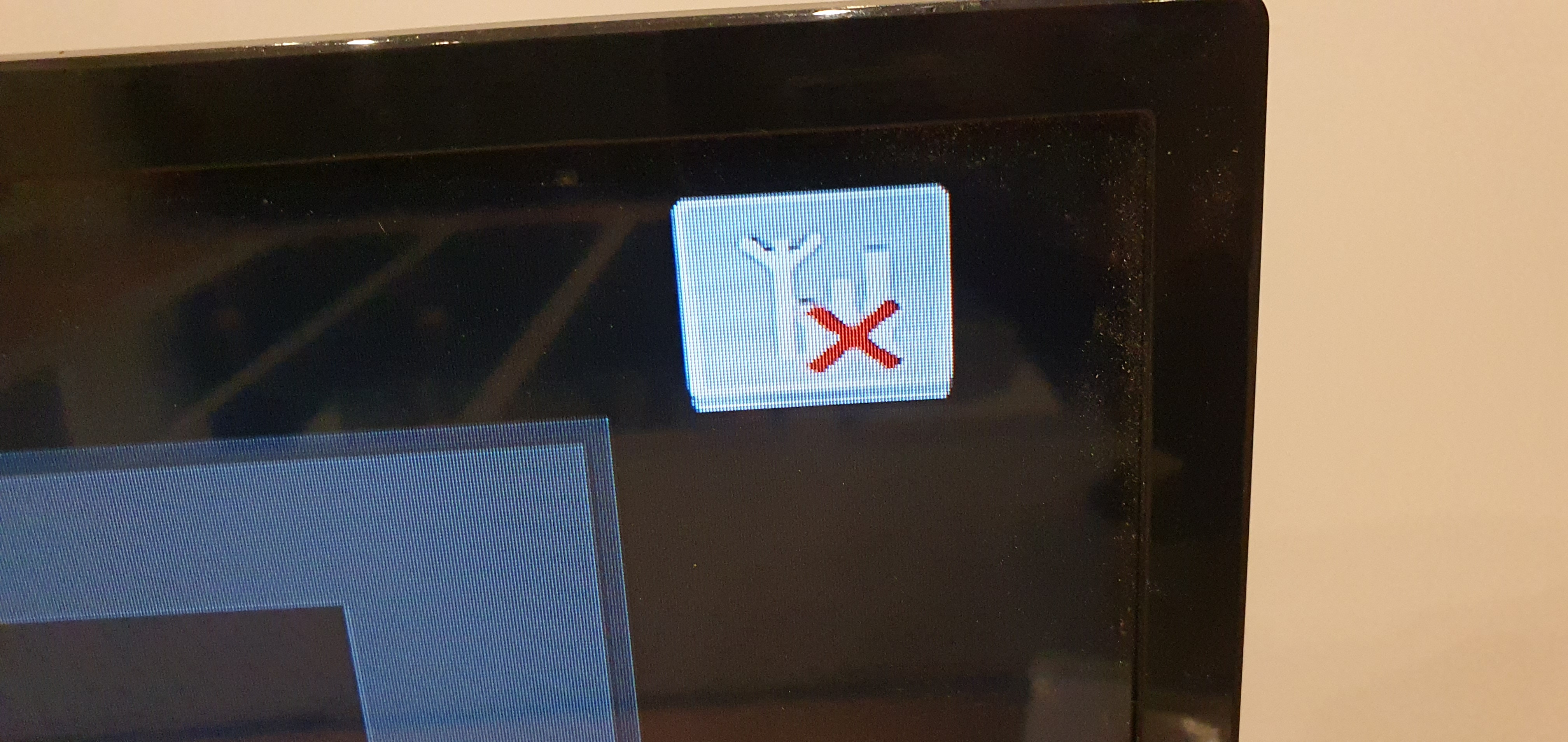

    krzysieksa
    Posts: 71
    Rate: 10
    Can what funzen posted help with the problem of WiFi operation (I have a Wi-Fi antenna)?
    The problem is that it sees the network, entering the password, it resets and continues to see the network but does not connect to it.
    • WIWA H265 tuner - the issue of updating via usb / network and network operation 20231012_201722.jpg (2.08 MB) You must be logged in to download this attachment.
    • WIWA H265 tuner - the issue of updating via usb / network and network operation 20231012_201717.jpg (1.86 MB) You must be logged in to download this attachment.
    • WIWA H265 tuner - the issue of updating via usb / network and network operation 20231012_201439.jpg (1.47 MB) You must be logged in to download this attachment.
    • WIWA H265 tuner - the issue of updating via usb / network and network operation 20231012_201534.jpg (1.16 MB) You must be logged in to download this attachment.
    • WIWA H265 tuner - the issue of updating via usb / network and network operation 20231012_201424.jpg (1.07 MB) You must be logged in to download this attachment.
    • WIWA H265 tuner - the issue of updating via usb / network and network operation 20231012_200900.jpg (1.02 MB) You must be logged in to download this attachment.
  • #48 20770000
    funzen
    Level 25  
    Posts: 524
    Help: 73
    Rate: 251
    What is the tuner powered from?
    Directly from the TV or from an external power supply?

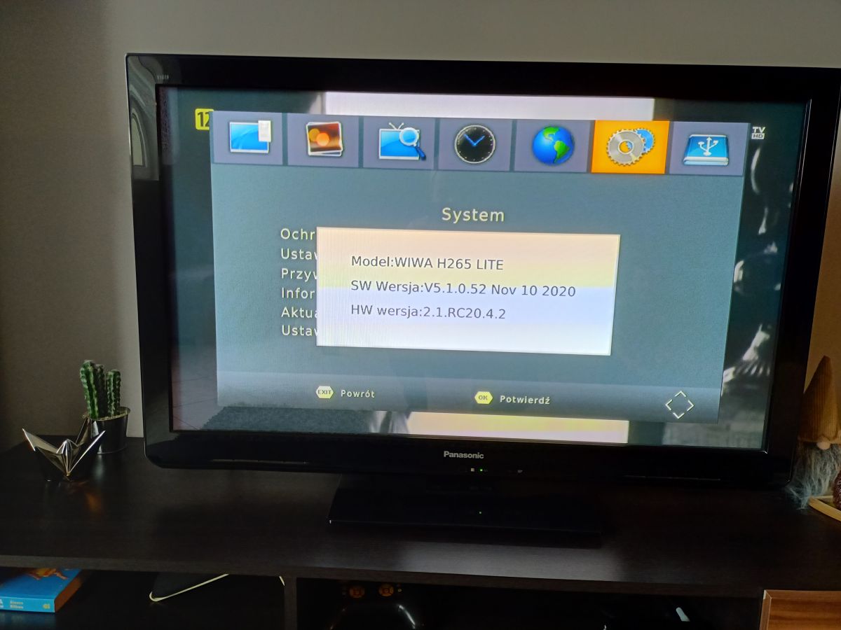

  • #49 20822207
    lucky49
    Level 4  
    Posts: 8
    needs: upgrade_7T10E_HW2.1.RC20.4.2_WIWALITE_V5.1.0.52
    may someone attach a photo of the tv
    TV screen displaying system information for the WIWA H265 LITE decoder..
  • #50 20822487
    funzen
    Level 25  
    Posts: 524
    Help: 73
    Rate: 251
    This is the version with LAN port
    You already have the latest version of the software.
    • upgrade_7T10E_HW2.1.RC20.4.2_WIWA_LITE_V5.1.0.52.rar (3.85 MB) You must be logged in to download this attachment.
  • #51 20823846
    lucky49
    Level 4  
    Posts: 8
    Thank you for your reply and sending the soft, unfortunately it pops up "invalid software". I unzip it on a clean pen and it doesn't work. Maybe I am doing something wrong?
    Added after 9 [minutes]:
    >>20822487
    I started to combine, because my wife kept telling me that it stutters, that it loses programs (this decoder, is some kind of misunderstanding). I took a photo of the soft when everything was still working, messed around and it broke....
  • #52 20824372
    2Tom
    Posts: 18
    Rate: 14
    Of course you're doing it wrong. Upload to a flash drive formatted to FAT32, the file I attached. Turn off the tuner from power, plug in the flash drive and turn on the tuner, patiently wait for the operation to complete....
    • ForceUpgradeApp.bin (3.78 MB) You must be logged in to download this attachment.
  • #53 20824758
    lucky49
    Level 4  
    Posts: 8
    thank you, it worked, the programs came back, however, after pressing the channel list there is no list, the channels can be changed but only +/-
  • #54 20824775
    2Tom
    Posts: 18
    Rate: 14
    lucky49 wrote:
    thank you, it worked, the programs came back, however when you press channel list there is no list, channels can be changed but only +/-
    Because you messed up by uploading the wrong firmware sooner. Now restore the default settings on your tuner and search for channels from scratch.... You will then have your list
  • #55 20824803
    lucky49
    Level 4  
    Posts: 8
    Unfortunately, the channels are still not visible.
  • #56 20824812
    2Tom
    Posts: 18
    Rate: 14
    lucky49 wrote:
    unfortunately the channels still cannot be seen.
    I know this error after uploading the wrong software.... Turn off/on the tuner, restore the default settings again and search for programs. I don't remember exactly, or immediately, but it should surprise and the list will appear....
