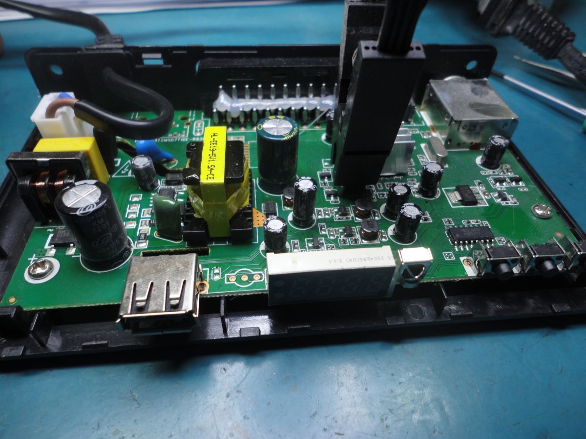

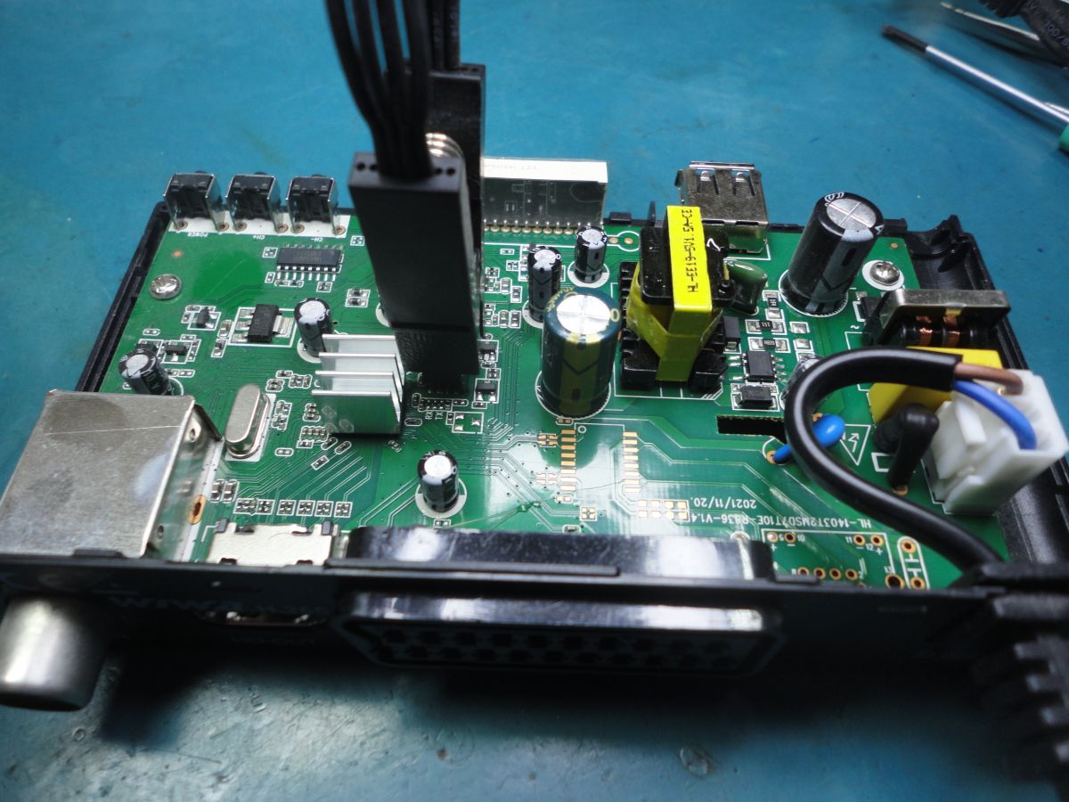

    Does anyone of you have a working .bin input for the standard 2nd generation WIWA H.265 decoder with LCD; the device does not have a LAN port; the memory chip is: 25VQ32BTIG; please download the batch from a functional unit and share it with me. I will upload it using a programmer to a new memory (*old damaged/replaced) and I will confirm whether it works; probably HW what it was: 2.1.RC20.4.1UU but I`m not sure; the USB update option is probably not possible because the hardware is dead. This is what the decoder and the box with the remote control look like inside.
    Interior of WIWA H.265 decoder with visible electronic components. Image of the mainboard of a WIWA H.265 decoder with visible electronic components. WIWA H.265 second-generation decoder with an LED display and remote control next to the box with graphics depicting the decoder and remote.

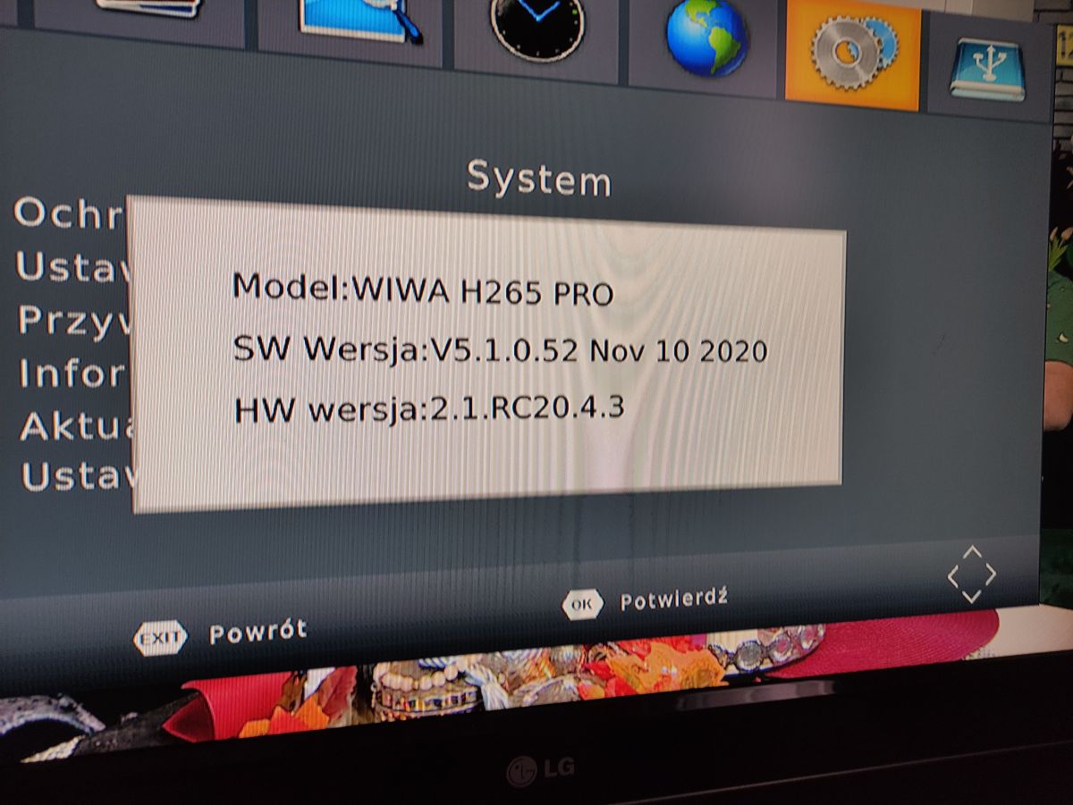

    Does anyone have the latest software update for the Wiwa H265Pro?
    I currently have:
    SW: v5.1.0.52 Nov 10.2020
    HW: 2.1.RC20 4.3.
    Thanks in advance for your help if anyone is able to help :) .
    Settings screen of WIWA H265 PRO decoder showing software version information.
  • #76 21128896
    sleszek1
    Posts: 9
    The best way is to send an email with a picture of this soft and you will get a reliable soft

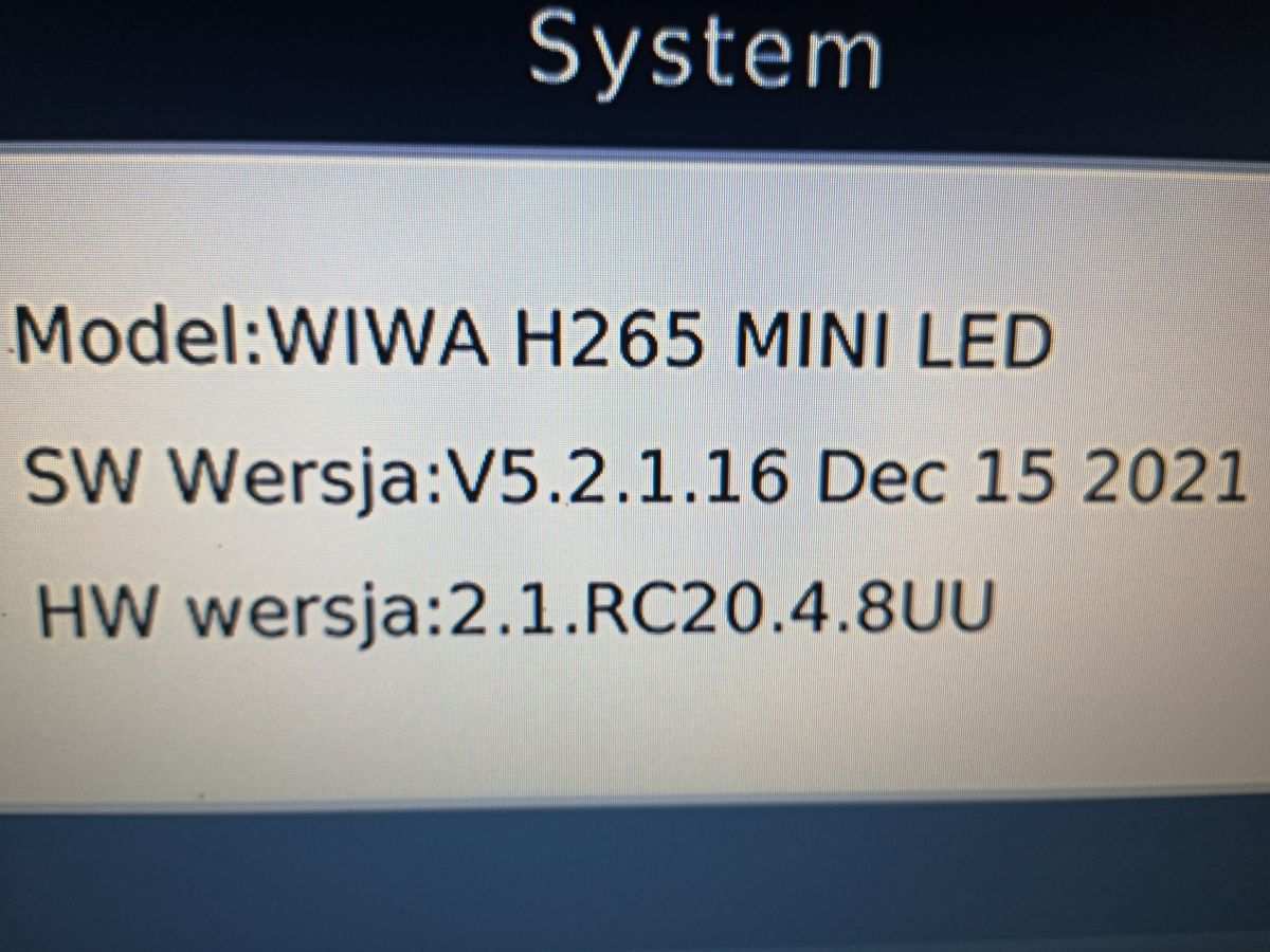

    Please find me the latest original soft for WIWA H265 Mini Led
    now i have such :
    Screenshot of system information for WIWA H265 MINI LED. .

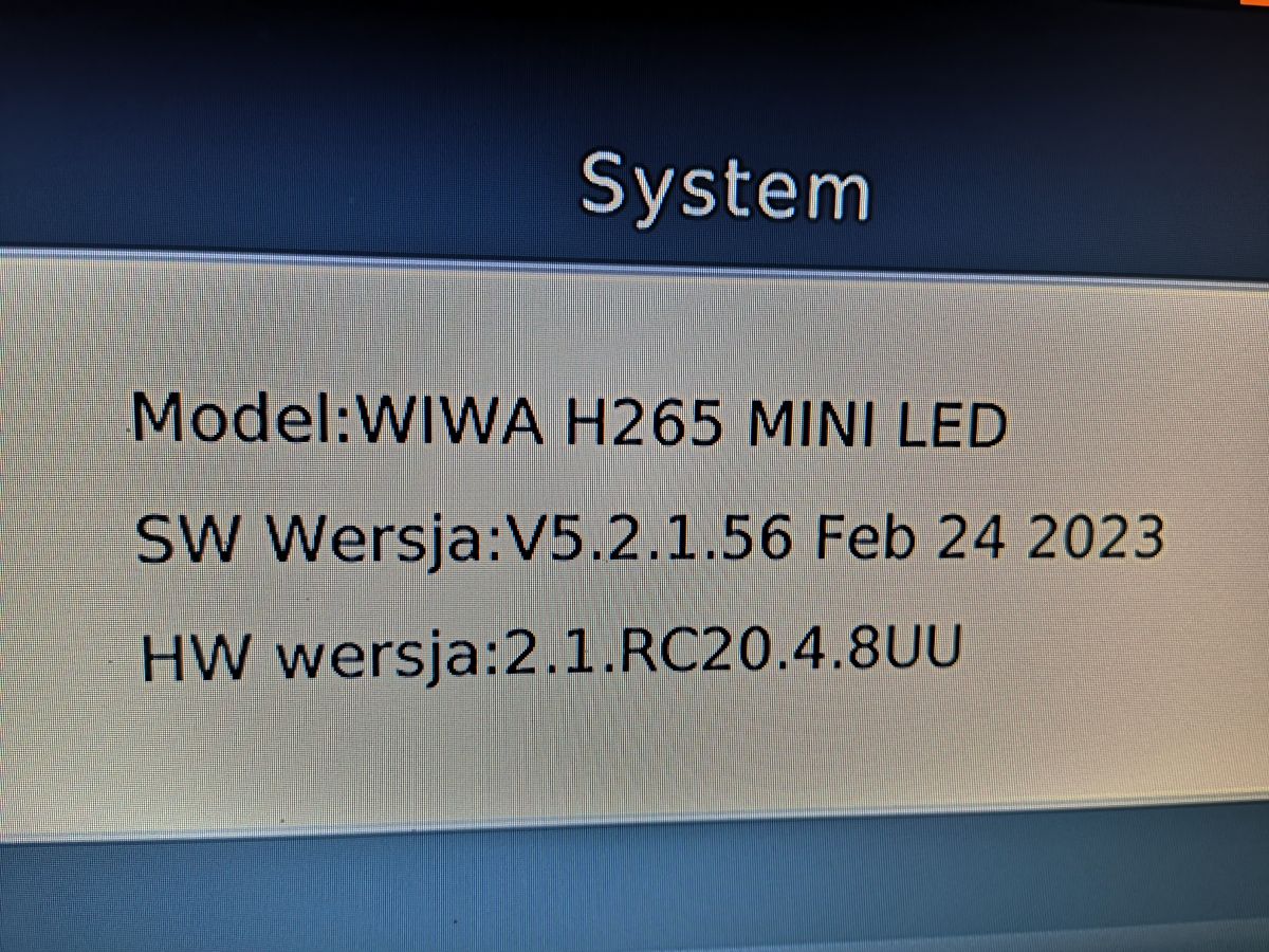

    @funzen
    After downloading you have to rename the file v5.2.1.56 ?
  • #87 21314748
    funzen
    Level 25  
    Posts: 524
    Help: 73
    Rate: 251
    There is no need for this.
  • #88 21314825
    czarny_alibaba
    Posts: 863
    Help: 5
    Rate: 151
    Update went successfully -SW v5.2.1.56 software installed
    System screen displaying the WIWA H265 MINI LED model and software and hardware version. .

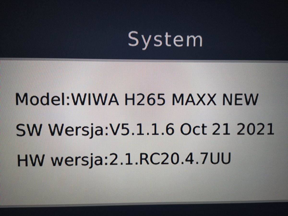

    For this model WIWA H265 MAXX New is there a newer original software ?
    Screenshot of system information for model WIWA H265 MAXX NEW. .
