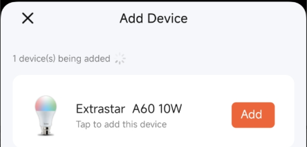

    excluding the bootloader, this is the boot log from your backup
    Tuya finds as
    Tuya app screen showing addition of Extrastar A60 10W smart bulb.
