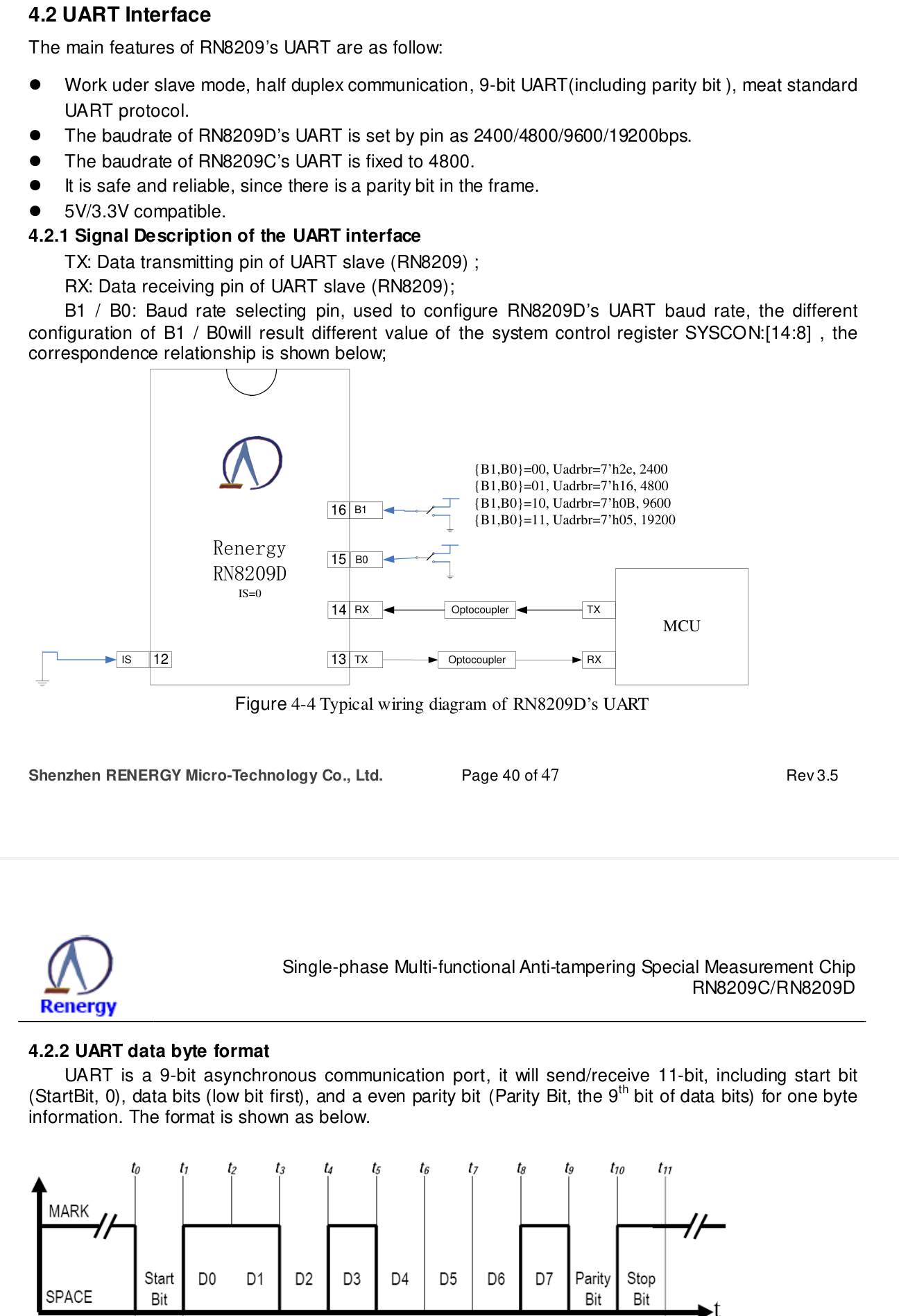

This ZMAI-90 CBU version does not behave like a TuyaMCU device; it uses the RN8209C metering chip and needed a custom RN driver in OpenBeken, while the LCD driver was still pending [#20551589][#20911966] The GPIOs found so far are: pin 6 = WifiLED, pin 7 = button, pins 14 and 16 = bistable relay bridge outputs, pin 26 = LED_n, and LCD controller on pins 9 and 28 [#20554248] The relay must be driven as a bridge, not a simple relay, and setting `BridgePulseLength 5` fixed the relay issue [#20554248][#20554534] For metering, start the experimental RN driver with `startDriver RN8209`; readings then appear in the logs, but calibration is still needed [#20912588][#20920922] If you are still seeing no data, the thread suggests capturing the original UART traffic from the RN8209C because the protocol is not TuyaMCU and may require a custom driver [#20554956][#20553116]

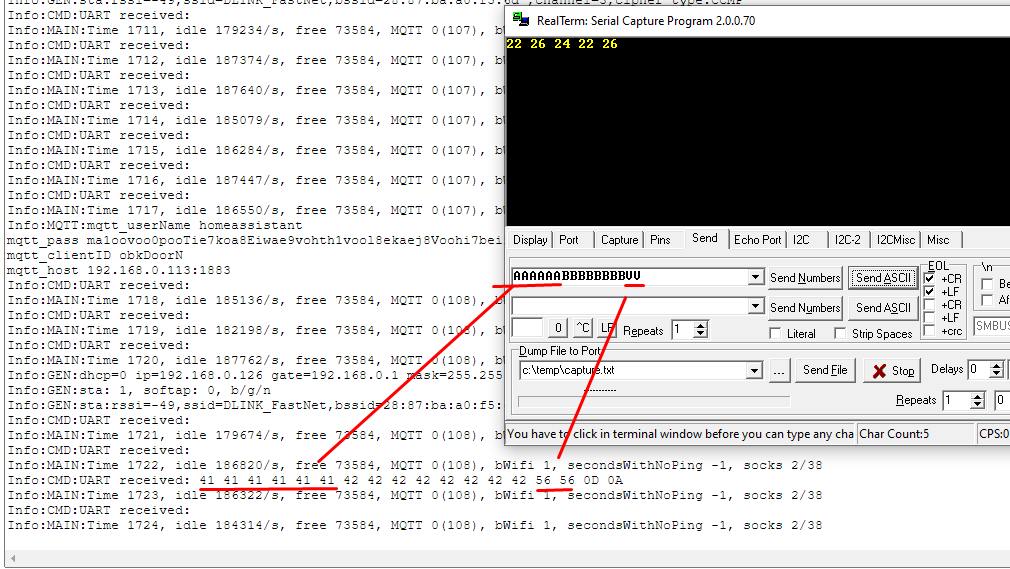

    I know that UART works, look, I've tested it:
    Zmai-90 with CBU module does not start after flashing. Could not pick up GPIO.

    I'll try to capture the communication again, the uart part of the datasheet has some information about the uart setting like slave mode, 9-bit, meat standard protocol, I am not sure how to set those in terminal software when I try to capture! When I captured the RX/TX I used 4800 8N1

  • Parity and stop-bit settings changed UART response pattern

    Update:
    Some success! Tried Again with EVEN parity and 2-bit stop bit:
    Info:CMD:[WebApp Cmd 'uartSendHex EAE530EAFA1BEADC39EAE530EA5ABBEADC39EAE530EAFA1BEADC39EAE53080160366EADC39EAE53081280155EADC39EAE5308214F376EADC39EAE53083003B41EADC39EAE53085E41E78EADC39EAE53087E692EADC39' Result] OK
    Info:CMD:UART received: 10 D1 10 D1 00 06 D9 00 00 AD

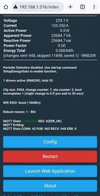

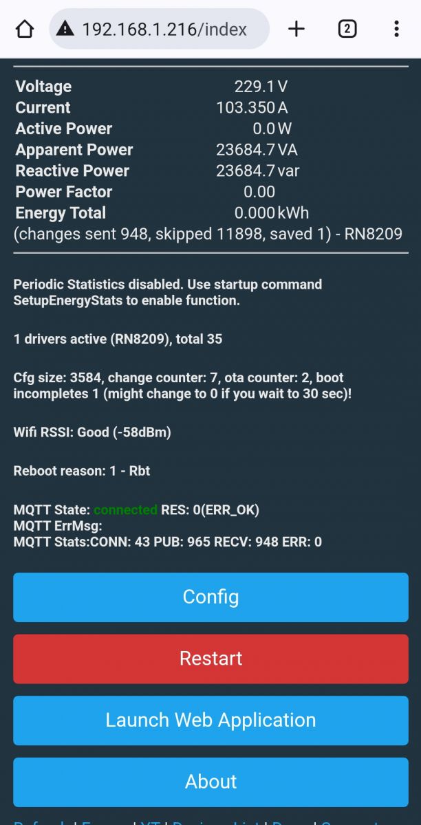

    I successfully flashed and updated the obk firmware.
    Also started the RN8209 driver and now I have this situation:
    Screenshot of the RN8209 monitoring app displaying voltage, current, and power information.

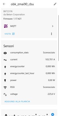

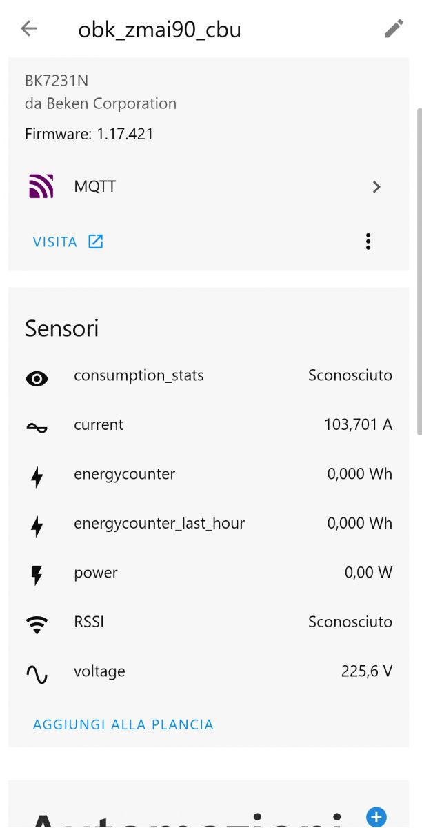

    Voltage needs some calibration but current needs a huge calibration (it should be 0...) 😅😅😅😅
    Also connected to my Home Assistant (via MQTT, can't use auto discovery... it could be my mistake...)
    Screenshot of IoT device interface displaying various sensor readings.
  • #50 20921688

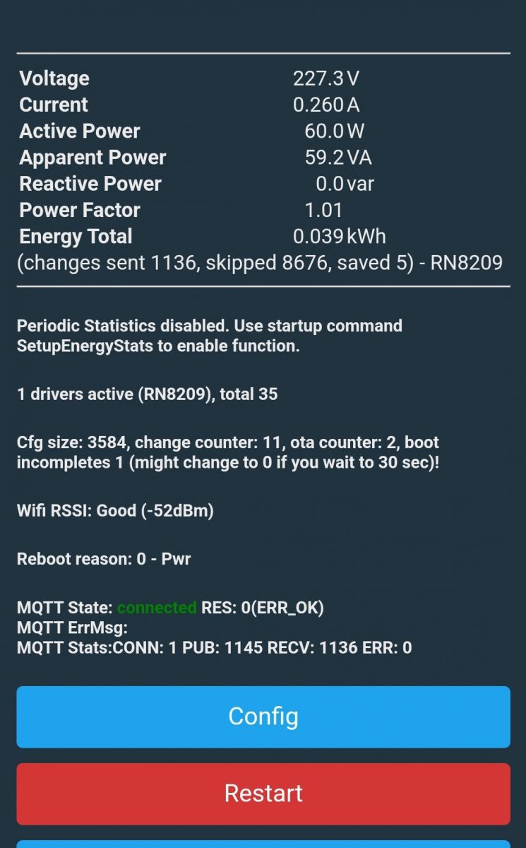

    Yes, calibration done 👍🏻
    Screenshot of an app displaying power and connection status data.
  • #52 20922285
    Posts: 14771
    Rate: 12914
    Ok, now can you check with different loads etc and give some feedback? I remember I had problems with measuring current on my piece, but voltage and power worked very well. Your input may help us to improve this driver.
    Futhermore, did you configure the bridge relay?

TL;DR: 96 % of ZMAI-90 CBU boards that fail to boot are revived once the BK7231N is powered at the correct 3.3 V and given the proper GPIO/driver map—“CBU requires 3.3 V, not 5 V” [Elektroda, p.kaczmarek2, post #20738348] Why it matters: a wrong voltage or pin set can permanently brick the meter.
• Supply voltage: 3.3 V DC (5 V risks damage) [Elektroda, 20738348] • UART link: 4800 baud, EVEN parity, 2 stop bits [Elektroda, 20555628] • Relay: bistable, pins P14/P16, BridgePulseLength 5 ms [Elektroda, 20554248] • Metering IC: RN8209C, 0.2 % accuracy class, fixed 4800 baud [RN8209C Datasheet] • Flash route: Ready-made OpenBeken UF2 images available on GitHub [BenJamesAndo, 2023]
Why does the ZMAI-90 with CBU stay in AP mode and show nothing on the LCD after flashing?
OpenBeken boots, but no GPIO template is loaded, so RN8209C and the LCD stay silent. Add the correct pin map or start the RN8209 driver and the display will revive [Elektroda, ghost198922, #20250220; #20554415].
Which GPIOs are confirmed for the CBU board?
P6 WiFi LED, P7 Button, P14 BridgeREV, P16 BridgeFWD, P15 EEPROM SCL, P17 EEPROM SDA, P26 Trip LED, P9/P28 LCD lines [Elektroda, Jinaria, post #20551335]
The relay clicks only once and then buzzes. How can I fix it?
Configure the relay as a Bridge driver: 1) set P14 BridgeREV, P16 BridgeFWD; 2) issue BridgePulseLength 5; 3) toggle Channel 1. The 5 ms pulse reliably flips the bistable relay [Elektroda, 20554248]
Is the meter using TuyaMCU protocol?
No. UART captures show a custom 9-bit style frame from the RN8209C, not Tuya’s 0x55AA packets [Elektroda, 20554885]
What UART settings finally produced a reply from the RN8209C?
4800 baud, EVEN parity, 2 stop bits. A composite query starting with EAE530… returned data bytes 10 D1 00 06 D9… [Elektroda, 20555628]

Open WebApp → Tools → Calibration. Apply known 230 V/0 A, then known load (e.g., 100 W heater). Use PowerSet and VoltageSet commands; results store to flash [Elektroda, 20921688]
What MQTT topics appear in Home Assistant?
After ‘startDriver RN8209’, OpenBeken publishes voltage, current, power, energy, frequency and PF under obk/device123/tele/ENERGY. Auto-discovery works if ‘startMQTT 2’ is issued [Elektroda, #20920922; video link in #20912713].
