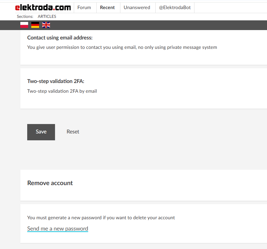

  • #49 21838134
    rt17mspiasta
    >>21838085 Last but not least, can you tell me how to delete my account? I dug around in the settings and couldn't find anything.
