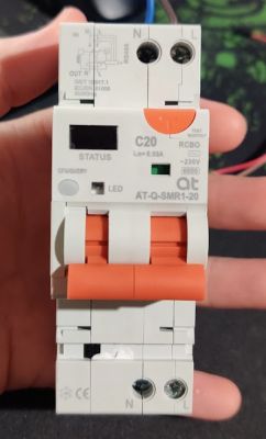

    Teardown of this RCBO/circuit breaker/energy meter from AliExpress.
    [BK7231T / WB3S] AT-Q-SMR1-20 wifi DIN rail RCBO circuit breaker + energy meter
    This is a VERY interesting device. Not your mama's wifi circuit breaker, this is a real, proper, mechanical RCBO/circuit breaker.
    This is proper gear, and can be used to completely replace the circuit breakers in your home, rather than the typical arrangement of placing wifi relays/meters in-line after a traditional current limiting circuit breaker and RCBO.
    This is a 2P all-in-one device that does it all.

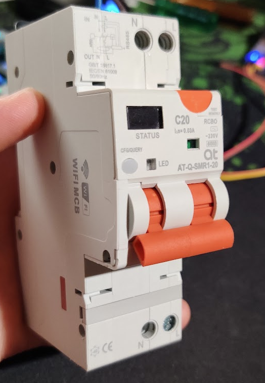

    This thing's big, heavy, and feels substantial.
    Let's see what's inside...

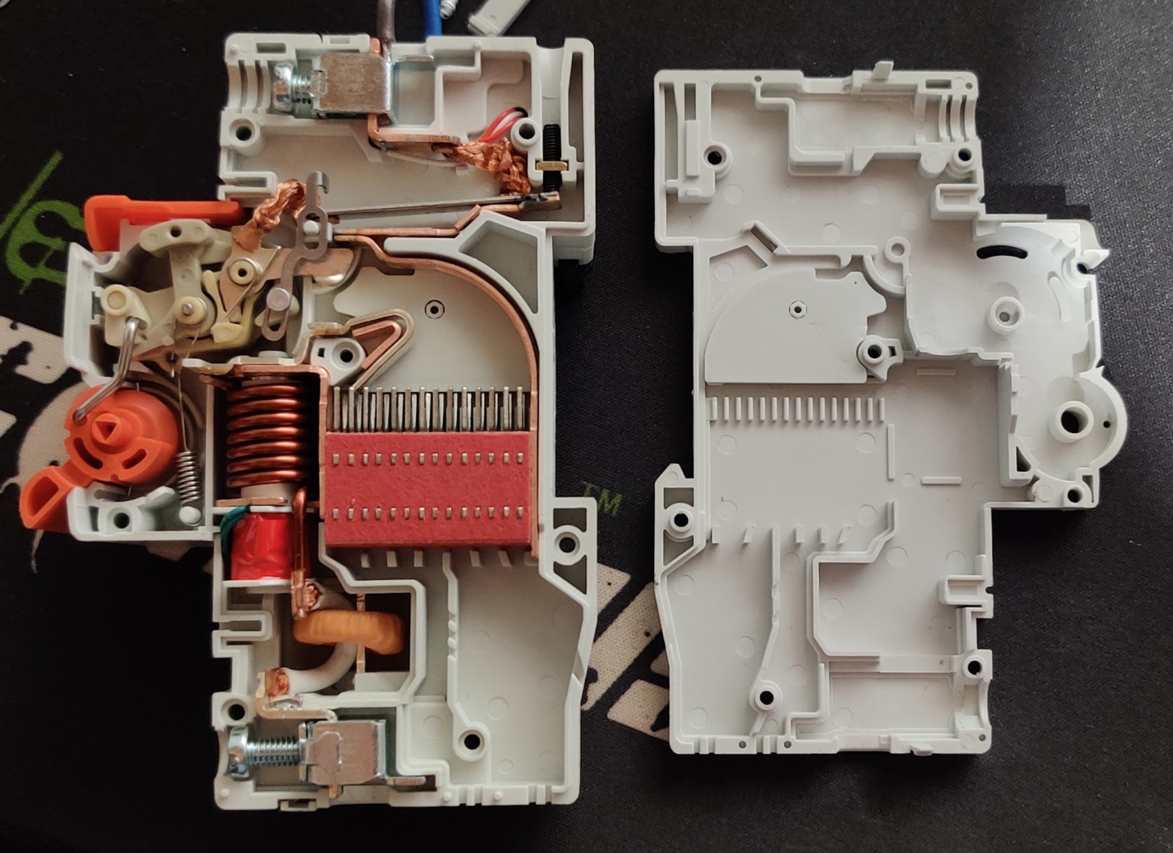

    It is sadly quite difficult to break into. There are 4 screws, 2 plastic clips, a plastic RS485 port cover, and very sadly, 5 solid-core rivets which need to be removed, which unfortunately means this device can not be re-assembled very securely after destroying the rivets.
    I drilled the folded end of the rivets and tapped them through with a hammer and a nail. Once everything was removed, it comes apart easily.
    The devices has 2 separate covers that can be removed on each side of the device. The left cover reveals the electronics, and the right cover reveals the mechanical components.
    Holy smokes!
    My suggestion, DO NOT REMOVE THE RIGHT COVER. 3 of the 4 screws are on the right hand side, and they do not need to be removed to modify the device. Just leave those 3 screws in place and leave the right cover on.
    These mechanical parts are all loose. There are at least 4 springs, and lots of floating bits, and they are held in place by guides on the cover itself. I bumped it and spent at least an hour trying to work out how to reassemble it correctly!!

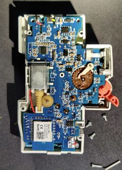

    Let's remove the left side cover:
    Jeezus!! There's a lot going on here.
    Connecting to the switching lever there's a series of FIVE cogs, all very well lubricated.
    Instead of a relay, there's a motor which drives the lever to open/close the circuit.
    There seems to be a shit-load of flux on the surface, it's glossy and it makes it really hard to see what the components are. I spent time trying to get good photos.

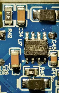

    This is the chip closest to the motor:

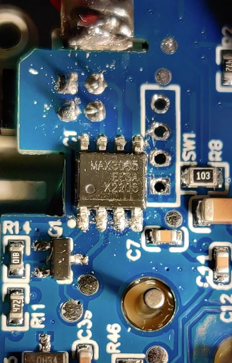

    This is the one at the opposite corner from the wifi module. I can't read what this is:

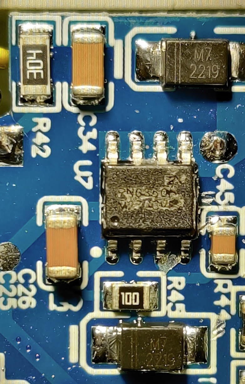

    This is the one closest to the wifi module. It's also very difficult to read:

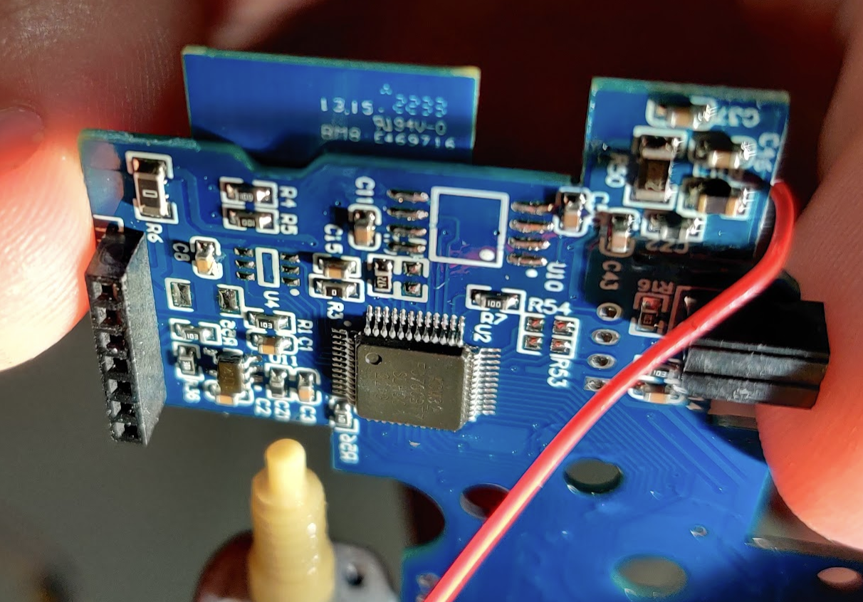

    Lifting the board reveals a second layer circuit board deeper in the device. I lifted the board just enough to get a peek at what's going on, but I couldn't get a comprehensive look without risking mechanical damage:

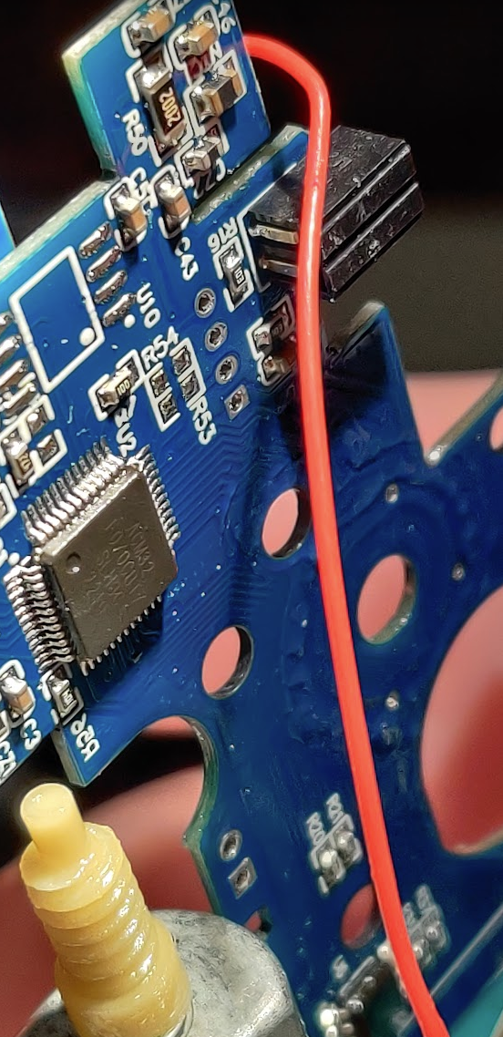

    And there it is... I reckon that's the MCU I was looking for. Again, it's very hard to read what's written on the chip.

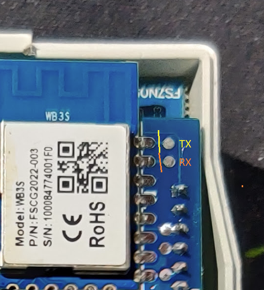

    Fortunately, the circuit board is designed in a way that will make it very easy to flash the wifi module. The main board does not need to be lifted or removed to flash the device. Also:
    There is a perfect location to cut and then repair the TX/RX traces with pads to create the repair located perfectly.

    So it's relatively easy to flash this device, but before that, I need to learn all the communications. There are so many configurable values; this will be a lot of data!
    ...but how can I sniff the UART safely? It's the same problem as before, the device needs to be connected to mains power for it to reveal the interesting communications.
    I don't want to blow this device up like my other one. How can I safely read data from the UART without a common ground reference, and avoid blowing up my device and my USB bus again?

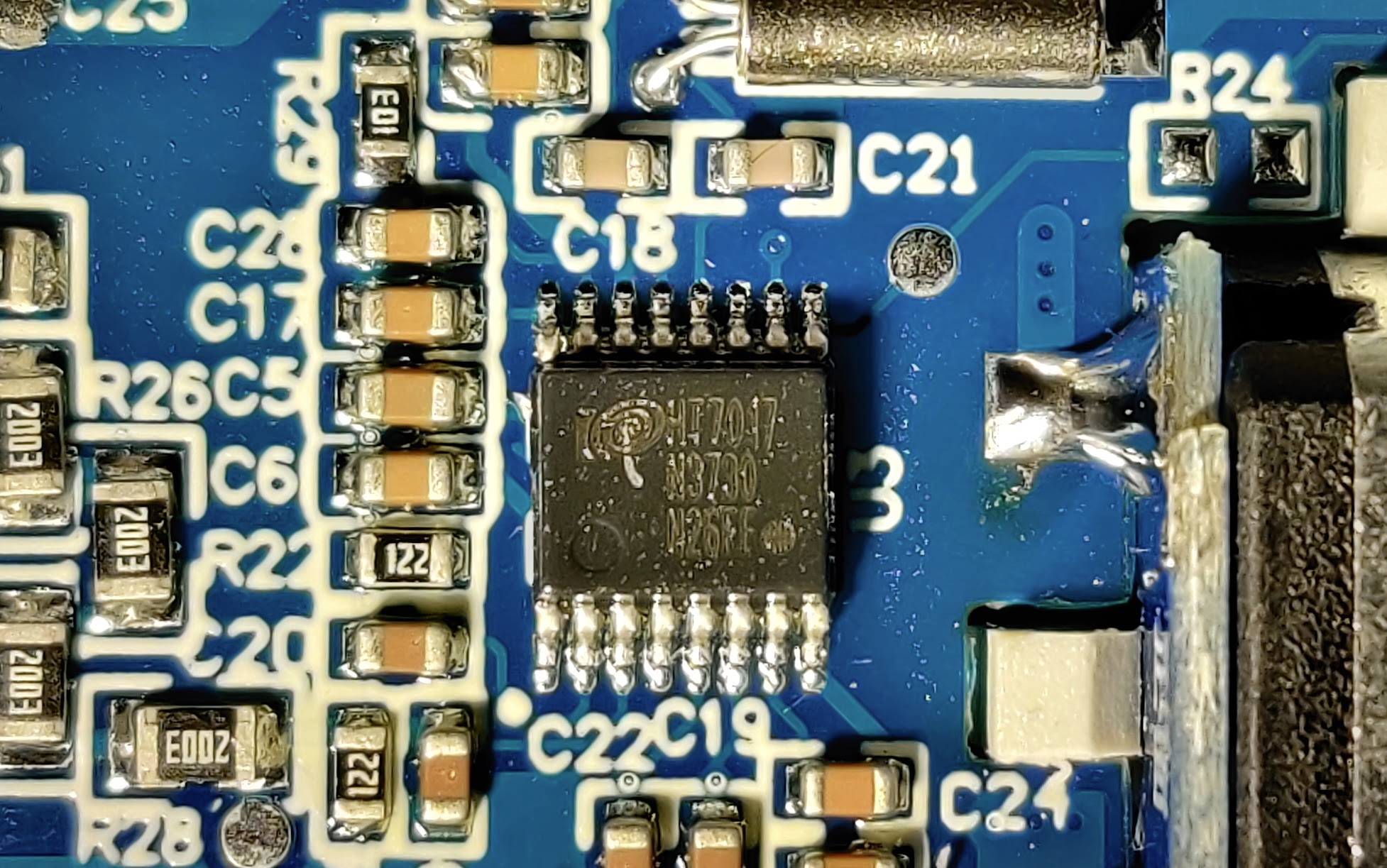

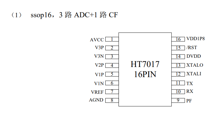

    Very useful teardown. It would be also helpful to get 2MB dump from this device so further ones can be flashed via OTA hack.
    HT7017 chip?
    Never heard that before, but "8000:1 3V~5.5V UART 单相电量芯片 SSOP-16-150mil Energy Metering ICs ROHS"
    Where are RX and TX legs connected? Maybe to TXD1 and RXD1 of WiFi module?
    PN6850 chip? Or something like that? I can see it has many legs (4 of them) on single copper pour.
    It's a power supply chip.
    Buck/step down converter.
    MAX3085? Not sure, it's hard to read, and I can't see why would be there a RS interface IC.
    And the MCU....
    That MCU is most likely TuyaMCU connected by UART to WiFI module.

    HT7017 chip?
    They don't seem to connect to the wifi module. I guess they connect to the large chip underneath, but I couldn't get probes under there to follow.
    It's for RS485 (modbus probably), where there are 2 ports exposed on the front of the device. This chip *IS* connected to the wifi chip, so it seems the wifi module also manages the RS485 comms... I thought that was a bit surprising.

    And the MCU....
    Yes, and I expect the HT7017 metering chip is connected to this.

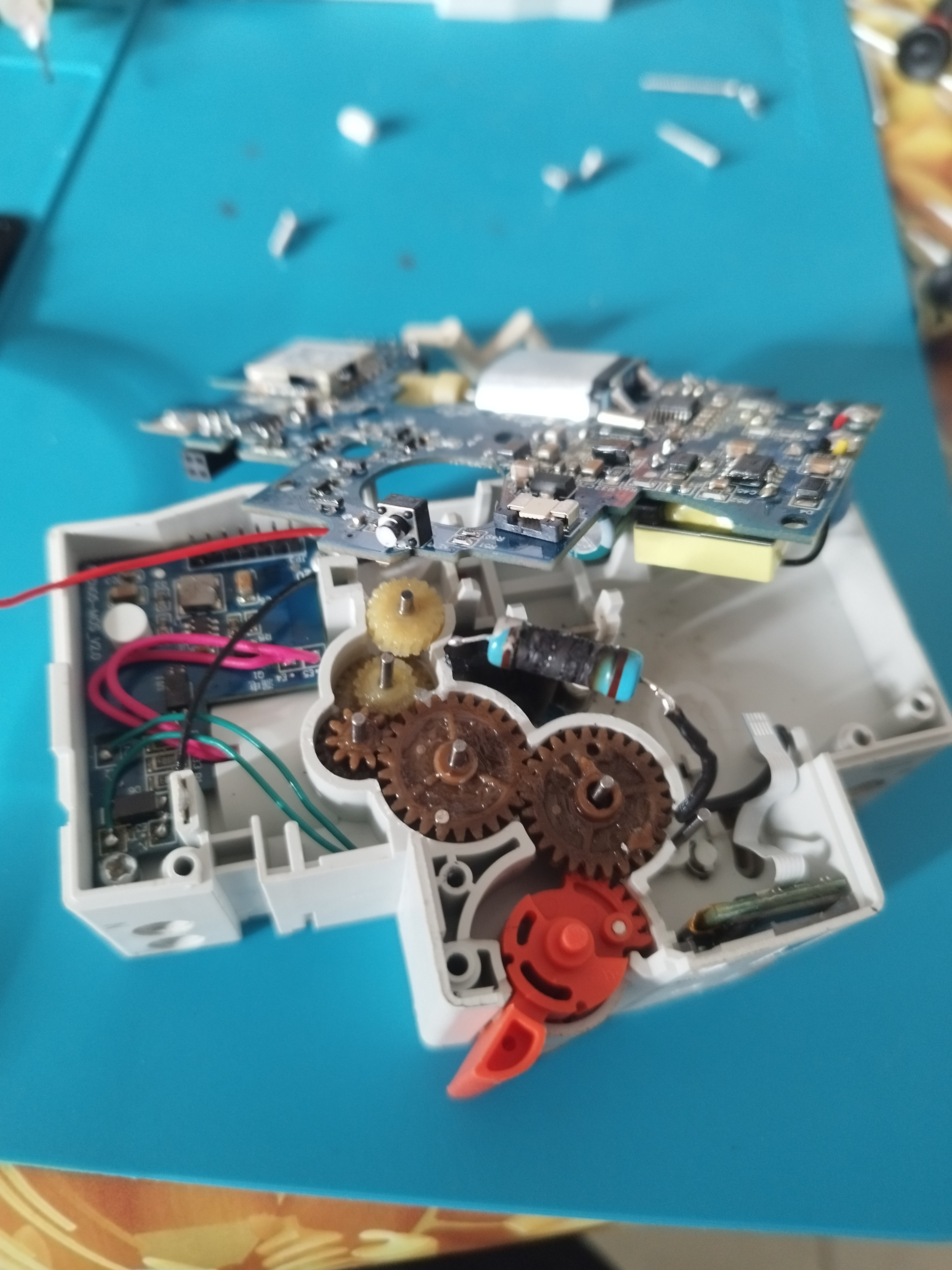

    Hello, I have the same RCBO with a test button problem. It does not cut the voltage when pressed. I opened the RCBO and found a burnt resistor (under the mainboard). Can you tell me what the code or value of the resistor is? Thank you.
    • [BK7231T / WB3S] AT-Q-SMR1-20 wifi DIN rail RCBO circuit breaker + energy meter IMG_20231109_135138.jpg (1.84 MB) You must be logged in to download this attachment.
  • Estimate test resistor value from 230 V 30 mA trip circuit
    #10 20807990
    morgan_flint
    Posts: 251
    Rate: 63
    rusudanion wrote:
    Hello, I have the same RCBO with a test button problem. It does not cut the voltage when pressed. I opened the RCBO and I found this BURNED RESISTOR (under the mainboard). Can you tell me what is the code or value? Thank you.
    If that resistor is like the one used to test a classic RCBO, its function is to create a small current that flows outside the current transformer, thus making the RCBO trip:
    RCBO schematic showing the connection of a resistor to the L line and TEST button.
    Then, in that case, it's easy to calculate its value, as that current should be (slightly) higher than the residual the RCBO is designed to trip. So if the RCBO is for 230V 30mA, the resistor should be lower than (230*0.9)/30 = 6k9 (0.9 is to allow for a -10% voltage tolerance). I guess 6k2 could be a valid value. As for the power, you'll have to guess from its size; to withstand continuous connection, it should be higher than (230*1.1)²/6200=10W, but as it should only be connected for a very brief period, maybe 0.5-1W would be enough. I guess the limiting factor in this case is the voltage it can withstand. Maybe your resistor got burned because the RCBO didn't trip fast enough due to another problem?
    But check before doing anything that that resistor corresponds with this function (for example, checking that it is connected to the test button); as this is an electronic RCBO, it could also be part of the low voltage feeding circuit for the electronics.
  • Test resistor identified as 18 kΩ 2 W

    morgan_flint wrote:
    rusudanion wrote:
    Hello, I have the same RCBO with a test button problem. It does not cut the voltage when pressed. I opened the RCBO and I found this burned resistor (under the mainboard). Can you tell me what is the code or value? Thank you.
    Then, in that case, it's easy to calculate its value, as that current should be (slightly) higher than the residual the RCBO is designed to trip. So if the RCBO is for 230V 30mA, the resistor should be lower than (230*0.9)/30 = 6k9 (0.9 is to allow for a -10% voltage tolerance). I guess 6k2 could be a valid value. As to the power, you'll have to guess from its size; to withstand continuous connection, it should be higher than (230*1.1)²/6200=10W, but as it should only be connected for a very brief period, maybe 0.5-1W would be enough. I guess the limiting factor in this case is the voltage it can withstand. Maybe your resistor got burned because the RCBO didn't trip fast enough due to another problem?
    Hi, thanks for your kind reply. The resistor is 18kohm 2 watts. I heard from the assistance (since I have a direct channel) and they told me the value of the resistor. It is 18kohm as the RCBO is adjustable from 30mA to 100mA. So I think the resistance is good for all ranges. Inside the RCBO, the resistance is connected to the L line and when you push the TEST button, it makes a contact on the ground of the circuit. Obviously, I tested the RCBO with an EXTERNAL TESTER and it works well. The TEST BUTTON, as in other RCBOs, interposes a resistance between L and N. Being a separate circuit, it does what a TESTER does. In your opinion, is a metal oxide or carbon resistance better?
    It sounds like it's a high value, as it would only draw 230/18=12.7mA at 230V, but maybe pressing the button also changes the sensitivity to a lower value... in an electromechanical device it would be lower.

    I really don't know, but the burnt one in the photo looks like a metal oxide film

    I ordered the resistor on AliExpress. When I received it, I tested it. Yes, it is a metal oxide resistor. I see that metal oxide supports higher temperatures better than carbon film.

    @TurkeyMan mentioned some other chip (was it MAX3085?) connected to beken board. Do you know which pins exactly? Maybe it needs to be put in some state first?
    I was playing with the GPIO doctor and I observed that P7, P8 and P9 sometimes toggle when configured as input, so there might be something there...

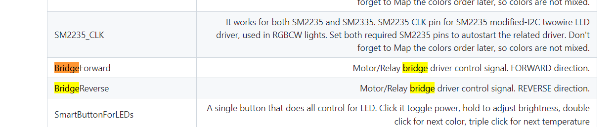

    #26 20890687
    Posts: 14791
    Rate: 12937
    @ferbulous
    I had the same while testing new Zmai90 and I discovered it indicates a bridge relay, see related topic:
    https://www.elektroda.com/rtvforum/topic4014818.html
    A bridge relay uses two GPIOs to control a latching relay, you need to set two GPIO roles for that:
    A table fragment describing GPIO settings for relay control.

    #29 21097468
    Roeller
    So, I saw this is the same as the TONGUE TOSMR1 (SMR1) device.
    I saw all the teardown and all the springs and plastic clips.. So my question is: Is it easy/possible to JUST unscrew the left side, solder the TX/RX, flash and that's all?
    (don't want to drill plastic clips and stuff and then turn it back in my 230 main circuit ;) )
    Is the flash specifically for the RS485 version (modbus) or also for the WIFI version? I heard the RS485 version does not have WIFI?

Not yet. CB3S UART1 talks to MAX3085, but OpenBeken still lacks a Modbus driver. Community roadmap lists it as “planned” [Elektroda, TurkeyMan, post #20366523]
