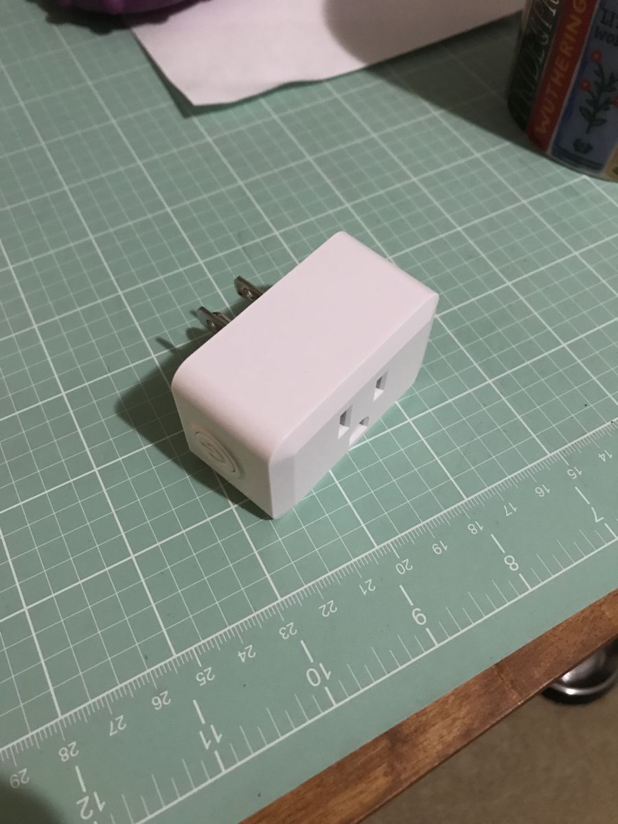

    I recently found the OpenBeken project after buying a three pack of Globe smart plugs and realizing they use BK7231T's and not esp8266's. Flashing the plugs with OpenBeken is easy enough given its similarity to Tasmota.
    [OpenBeken Project for BK7231T/WB2S] Flashing Globe Smart Plugs with OpenBeken and Pin Setup
    I used a pocket knife to pry open the case. Sliding the edge into the seam between the two halves helped break the adhesive hold.

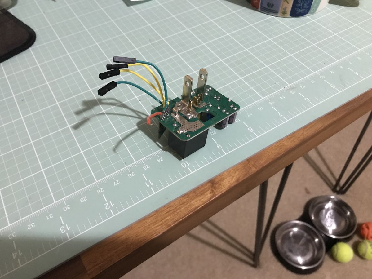

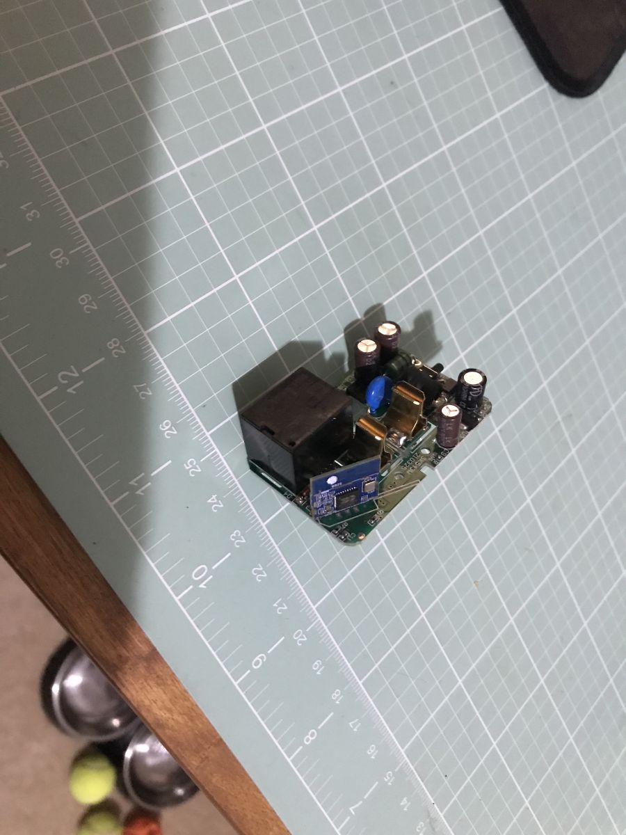

    I soldered on just the 3.3V, GND, RX, and TX wires initially but couldn't get uartprogram to connect. I had to add a wire to the CEN pin as well and short it to GND while the uartprogram was "Getting Bus."
    After that, a bit of trial and error led me to the following pin configuration:
    P7 - LED_n
    P24 - Rel
    P26 - Btn

    Thank you, device will be added to our templates list. It's interesting to see that your one had WB2S without a metal shield on BK7231T, most of the modules have the metal shield in place.
    Any BK flasher requires a reboot during "Getting bus" to work. You can reboot by shorting CEN to GND or by doing a power off/on cycle.
