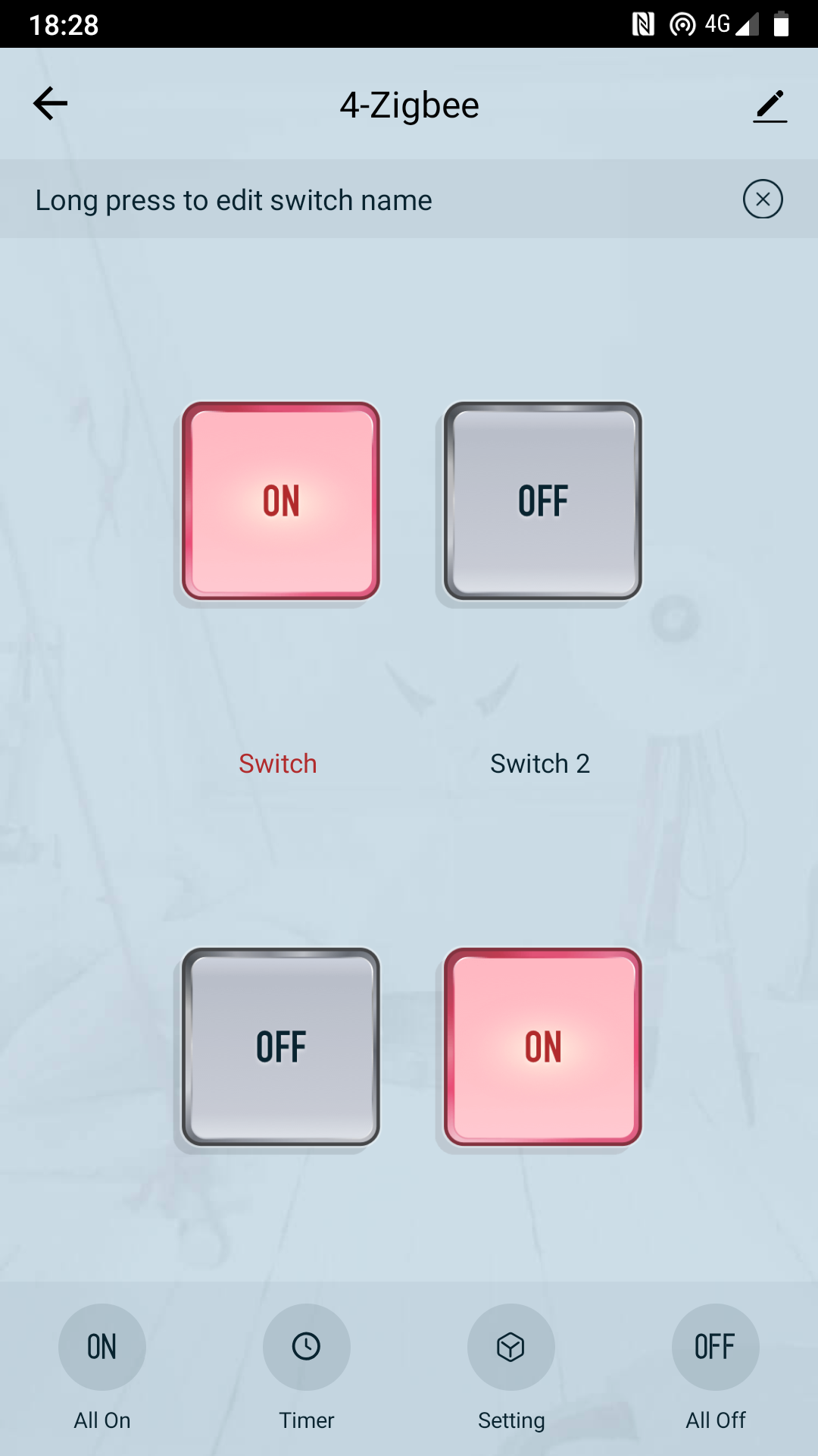

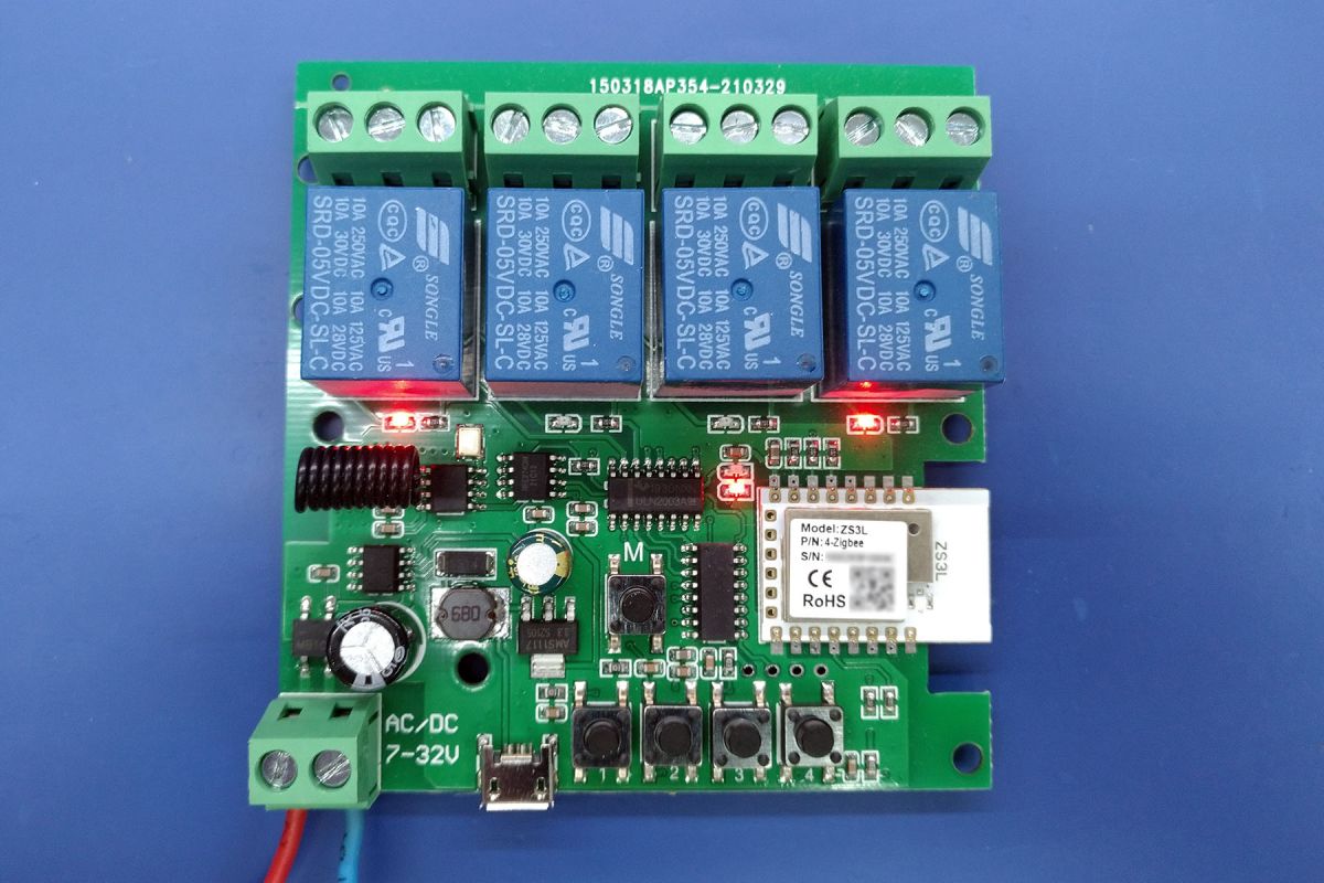

    Hi,
    I bought a four channel receiver with Zigbee relays today, paired it with the Tuya app and that's it. Control from the app doesn't work - from the app I am unable to control the relays. Only when I control them with the buttons on the board does the app tell me they are on. Tuya app up to date, controller paired again, no results. On the other hand, the app controls other devices correctly, scenes, dependencies etc work.
    Tuya App Not Controlling 4-Channel Zigbee Relay: Seeking Documentation and Solutions Tuya App Not Controlling 4-Channel Zigbee Relay: Seeking Documentation and Solutions
    If anyone has any documentation from this marvel, I would ask them to share. What I am mainly interested in:
    - a procedure for removing the remote controls (without resetting the device)
    - some kind of software update, maybe an alternative software that will allow control from Tuya and similar applications

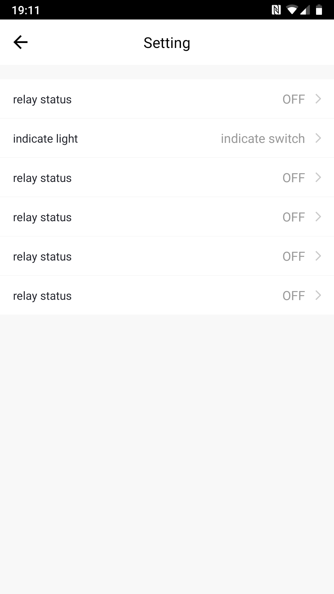

    Such o:
    Tuya App Not Controlling 4-Channel Zigbee Relay: Seeking Documentation and Solutions .
    None of these settings allow themselves to be changed.
  • #5 20308317
    prosiak_wej
    Posts: 5273
    Help: 501
    Rate: 1461
    No changes. When I go into any of the settings, e.g. "relay status", I can change OFF - ON - Remember last status. After changing, I confirm with the "Confirm" button and there is no change.

    The connectors under the UART are also not visible, it remains to read the circuit models.

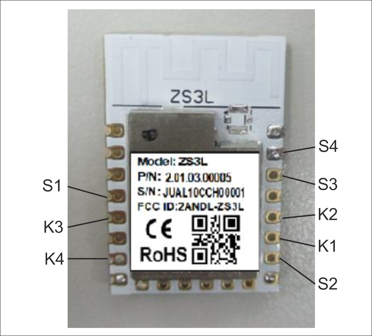

    The UART appears to be in the form of four pins, above the third and fourth buttons. The MCU has no markings. Just do you need to get to it, or is it more of a ZigBee module?
  • #12 20314284
    prosiak_wej
    Posts: 5273
    Help: 501
    Rate: 1461
    ZigBee module.
    Anyway - no one has had to deal with such a device? No one has had a problem with control from Tuya and similar applications?

  • Virtual button clicks but relay never switches
    #20 20315625
    prosiak_wej
    Posts: 5273
    Help: 501
    Rate: 1461
    Everything you mentioned I have done. All the devices (including the gateway) report that there is no newer software version. I reinstalled Tuya, added the devices to it again, in the meantime I used the Smart Life app - to it I added everything I had in Tuya (after uninstalling Tuya at the time and resetting the devices, including the gateway). I also added a room, to which I assigned the faulty controller. Regardless of the app - the virtual button on the phone screen can be seen to 'click', but this does not generate the relay switching on and giving feedback that it is on.

    In the Tuya app, in the window of this driver at the bottom you have Settings. How do you have it set up? I have:
    "OFF
    indicate switch
    OFF
    OFF
    OFF
    OFF"
  • #22 20315633
    prosiak_wej
    Posts: 5273
    Help: 501
    Rate: 1461
    Post three - I later added that none of these settings allow themselves to be changed.
  • #23 20315636
    freebsd
    Level 42  
    Posts: 6791
    Help: 766
    Rate: 2034
    Then I think you have exhausted all possibilities. What's left? A return? An exchange?

    #24 20315657
    prosiak_wej
    Posts: 5273
    Help: 501
    Rate: 1461
    What else did I check... On which pins the Zigbee module puts out a high state, which activates the relay, and on which pins it expects a low state from the buttons on the board:
    The high states from the Zigbee go to the MCU, which turns on the relays. When I applied a high state to one of the K pins with a wire, the relay switched on for the duration of the jumper hold, but there was no indication of switch-on in the application. The buttons are also connected to the mystery MCU. What remains? Soldering out the parts, reprogramming the Zigbee module. Unfortunately, the four pins that look like a UART go to the MCU and not the Zigbee.

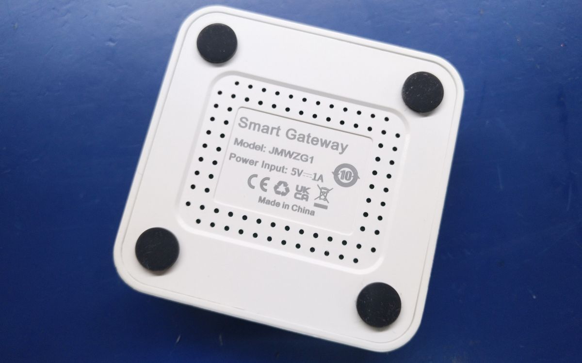

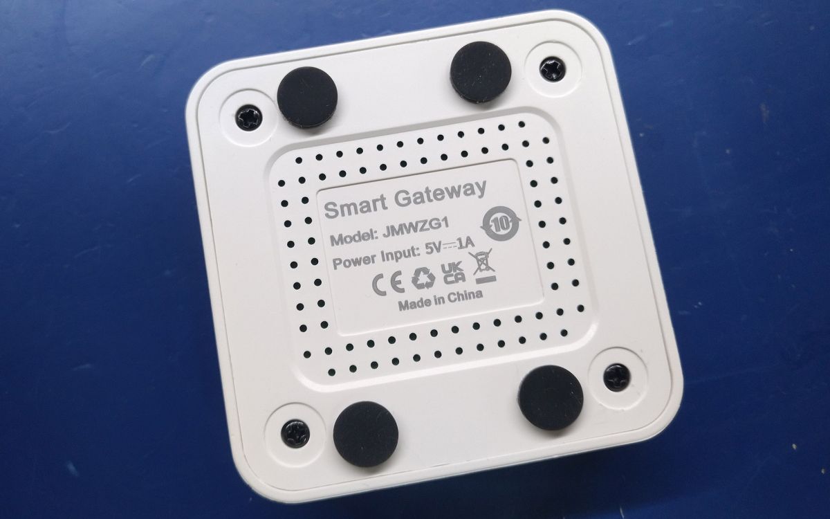

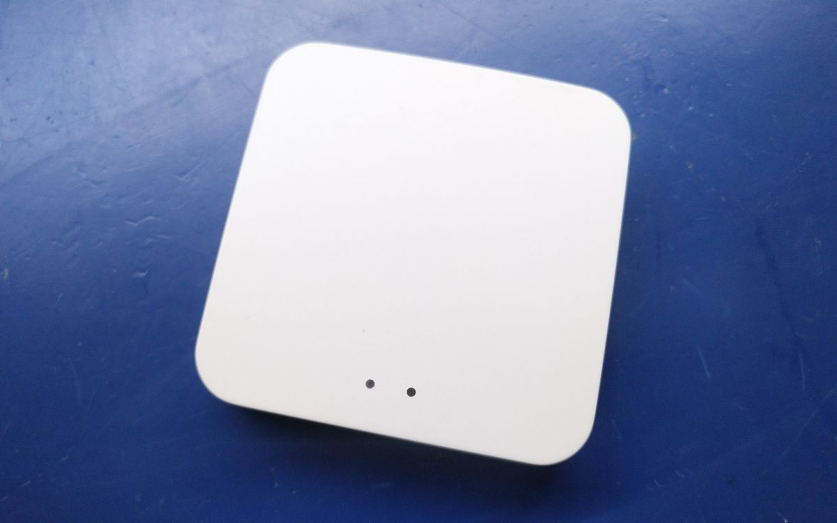

    prosiak_wej
    Posts: 5273
    Help: 501
    Rate: 1461

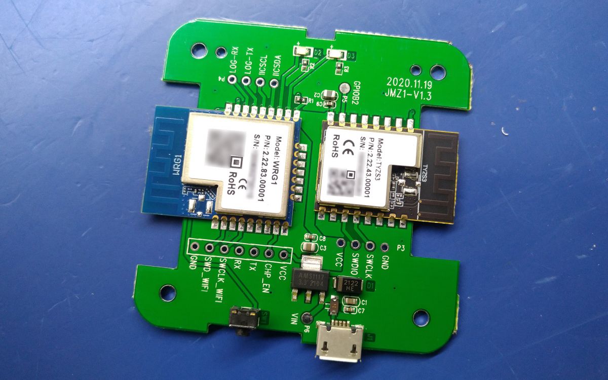

    Today I accidentally solved the problem. I found another Zigbee gateway in a lumpy shop that cost me like 2zl.... I connected it to the Tuya app, added the switch from the topic to it and it worked just fine. Below are photos of the gateway that worked:
    Tuya App Not Controlling 4-Channel Zigbee Relay: Seeking Documentation and Solutions Tuya App Not Controlling 4-Channel Zigbee Relay: Seeking Documentation and Solutions Tuya App Not Controlling 4-Channel Zigbee Relay: Seeking Documentation and Solutions Tuya App Not Controlling 4-Channel Zigbee Relay: Seeking Documentation and Solutions .
