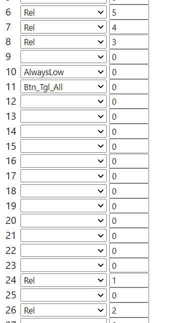

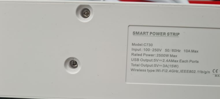

    Tuya based smart power strip from AOFO.
    AOFO smart power strip - WB2S
    Amazon.de link: Link
    Needs a triangle screwdriver to open the case
    Flashed with : OpenBK7231T_App
    Used this tool on Windows 11 to flash the WB2S chip using a FTDI232 device: bk7231tools
    Soldered 4 Pin header on the chip and connected Vdd, GND, Rx and Tx to FTDI converter. Rx and Tx are crossed over.

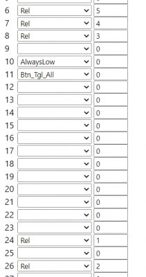

    Configuration for the relays and button, can be found in the attached images.
    AOFO smart power strip - WB2S AOFO smart power strip - WB2S

    Thanks for the teardown, I haven't seen this device yet. Out of curiosity, why are you using "AlwaysLow" for P10?
    EDIT: Is it a LED? Maybe it would be better to use WiFiLed or WifiLed_N role.
  • #3 20319602
    radu_
    It is the power LED, it could be set as you mentioned too, I see no problem.
    My aim was to share on which ports the things are.
