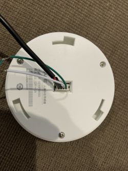

    This is a short teardown of Moes mmWave Radar Sensor with CBU module.
    Basic information:
    Brand: MOES
    Model: XZ-HPSW101
    Chip: BK7231N [CBU]
    Local Vendor: https://expo.tuya.com/product/1053016 (original link wasn't valid anymore so I'm putting this link from tuya)

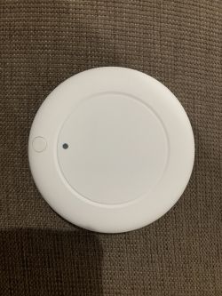

    Teardown Photos:
    [BK7231N] Moes XZ-HPSW101 mmWave Radar Sensor Teardown with CBU Module [BK7231N] Moes XZ-HPSW101 mmWave Radar Sensor Teardown with CBU Module [BK7231N] Moes XZ-HPSW101 mmWave Radar Sensor Teardown with CBU Module [BK7231N] Moes XZ-HPSW101 mmWave Radar Sensor Teardown with CBU Module [BK7231N] Moes XZ-HPSW101 mmWave Radar Sensor Teardown with CBU Module

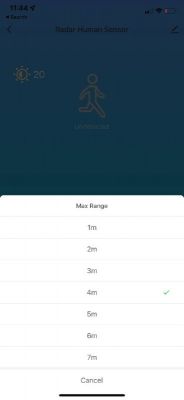

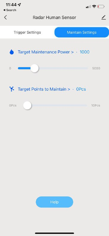

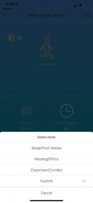

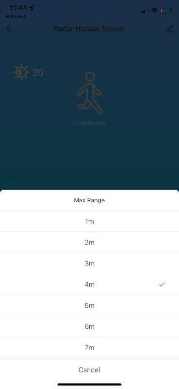

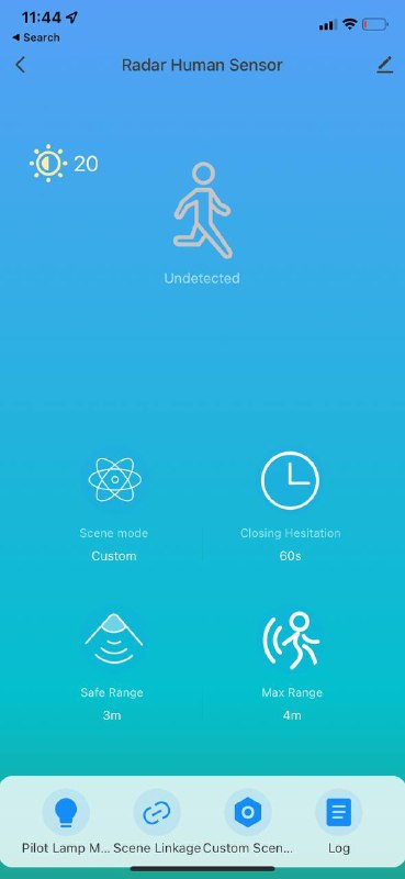

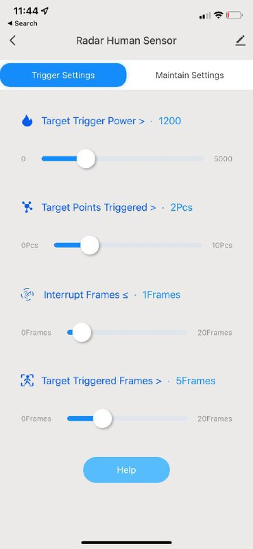

    Tuya/smartlife configuration:

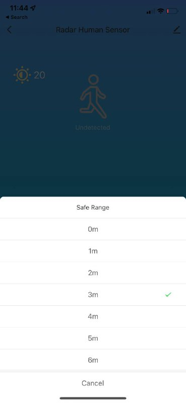

    [BK7231N] Moes XZ-HPSW101 mmWave Radar Sensor Teardown with CBU Module [BK7231N] Moes XZ-HPSW101 mmWave Radar Sensor Teardown with CBU Module [BK7231N] Moes XZ-HPSW101 mmWave Radar Sensor Teardown with CBU Module [BK7231N] Moes XZ-HPSW101 mmWave Radar Sensor Teardown with CBU Module [BK7231N] Moes XZ-HPSW101 mmWave Radar Sensor Teardown with CBU Module [BK7231N] Moes XZ-HPSW101 mmWave Radar Sensor Teardown with CBU Module [BK7231N] Moes XZ-HPSW101 mmWave Radar Sensor Teardown with CBU Module

    @p.kaczmarek2 I haven't started flashing this yet since I don't really know how to start configuring this.
    Could this be using tuya mcu?

    Very interesting device. One of the methods to determine is it using TuyaMCU would be simply hooking up UART to RX and TX lines and doing a packet dump, preferably in hex format, maybe with Realterm.
    See the following topic: https://www.elektroda.com/rtvforum/topic3936455.html
    I will need that data for the analysis.
    Second way to check for TuyaMCU would be with multimeter, are the RX/TX tracks going to MCU?
    The third way, the one for battery powered devices, would be checking if WiFi module is always powered. Some of the devices with TuyaMCU just disable the power of WiFi module when it's not needed. There is a MOSFET on the way between 3.3V and VDD of WiFi module and TuyaMCU controls that MOSFET. Does your device VDD of WiFi module connects directly to main VDD rail on the board?
    but, in general, i'd say, first try to do UART packets dump. 9600 baud (most likely), Realterm, "capture to file", and paste here captures. I will use my TuyaMCU analyzer to check what's going on.
