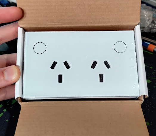

    Product has 2 GPO's with 2 touch buttons. The product was advertised with energy metering, but this device does NOT have an energy meter.

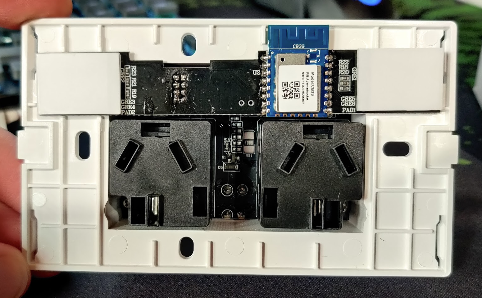

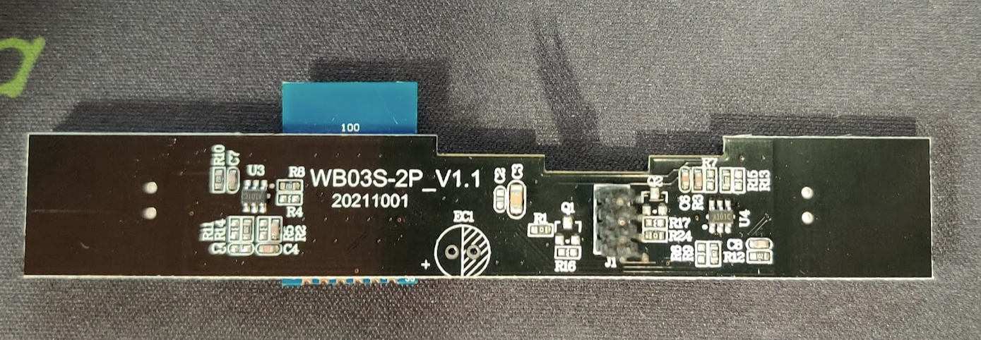

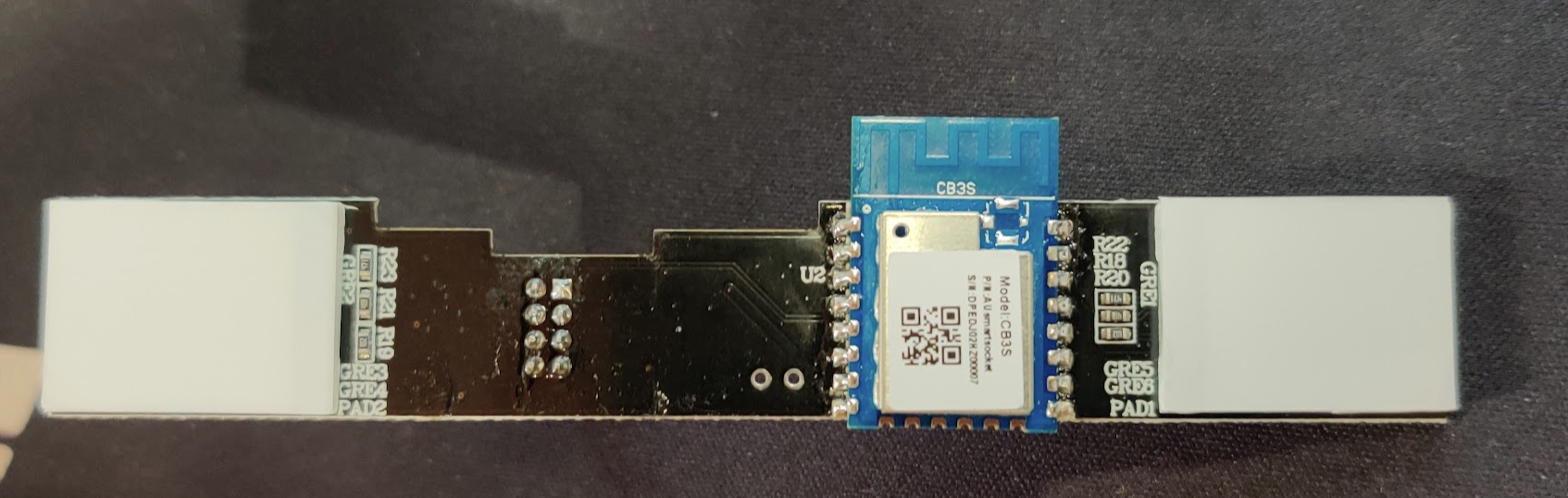

    [BK7231N / CB3S] Tuya Smart Dual GPO
    Which reveals the wifi board on a pin-mounted riser:

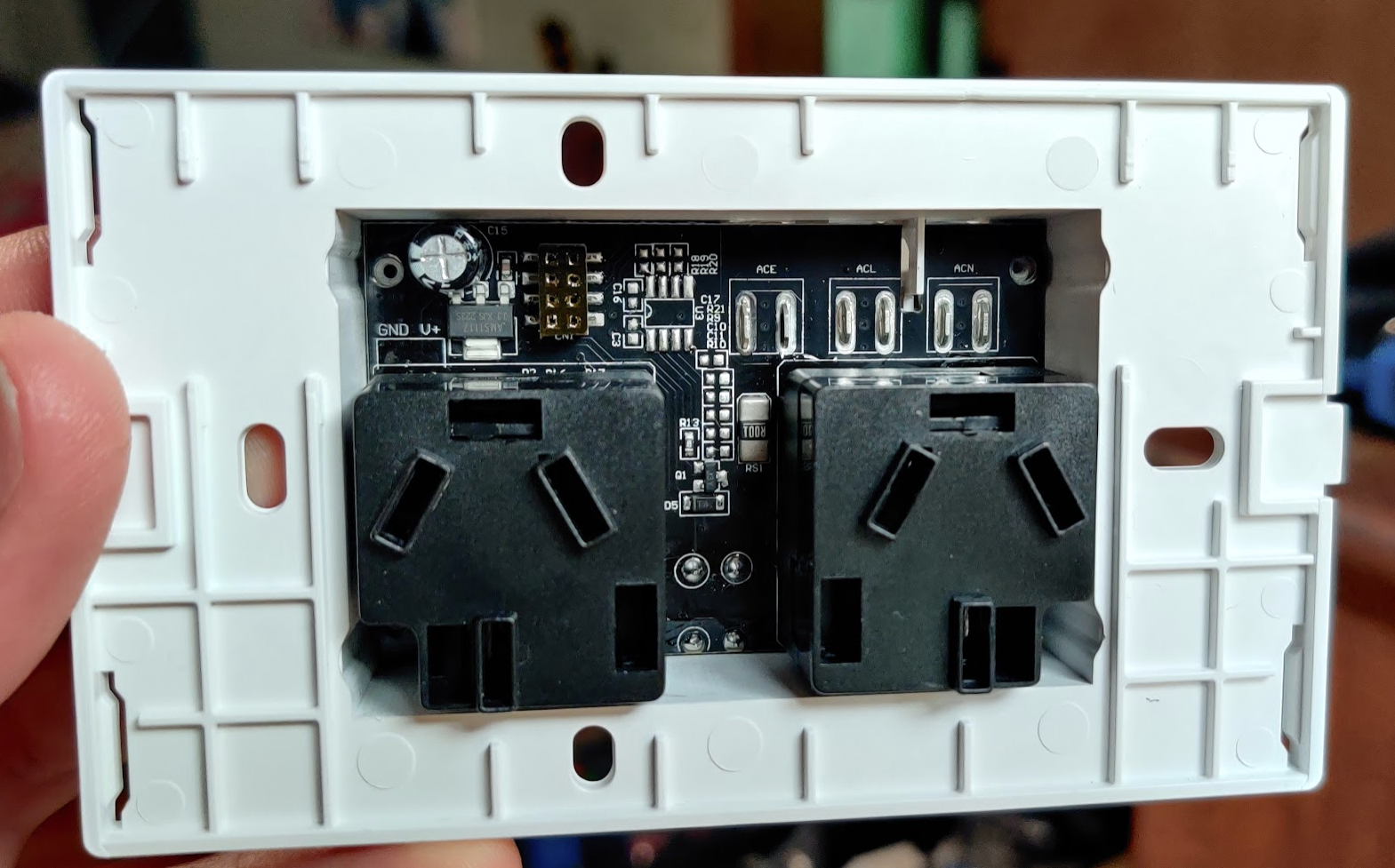

    Behind the wifi board:

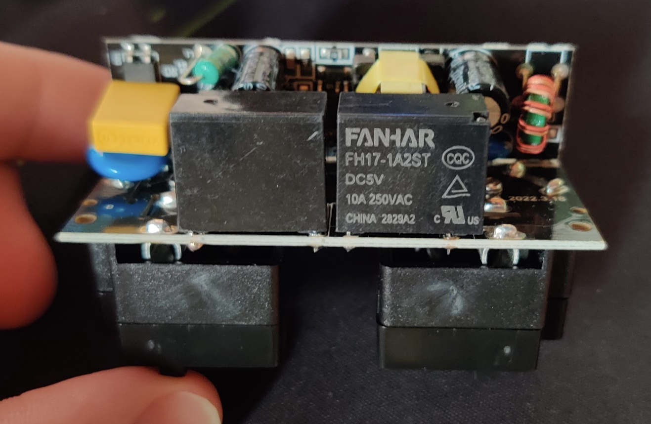

    Removing the power board, we see a pair of relays:

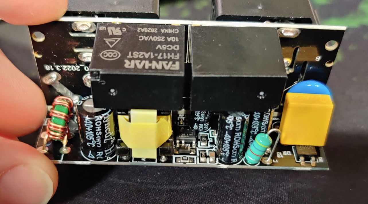

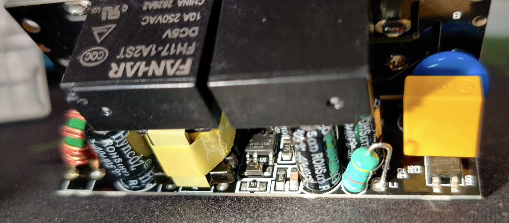

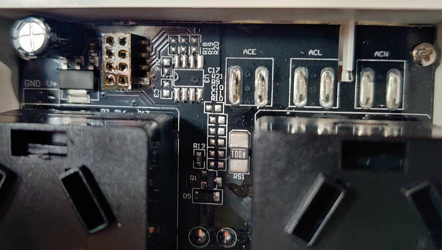

    Trying to look for power metering chips as advertised, but none seem to be present:
    It looks like this is where the metering chip should be located, but the board is not populated:
