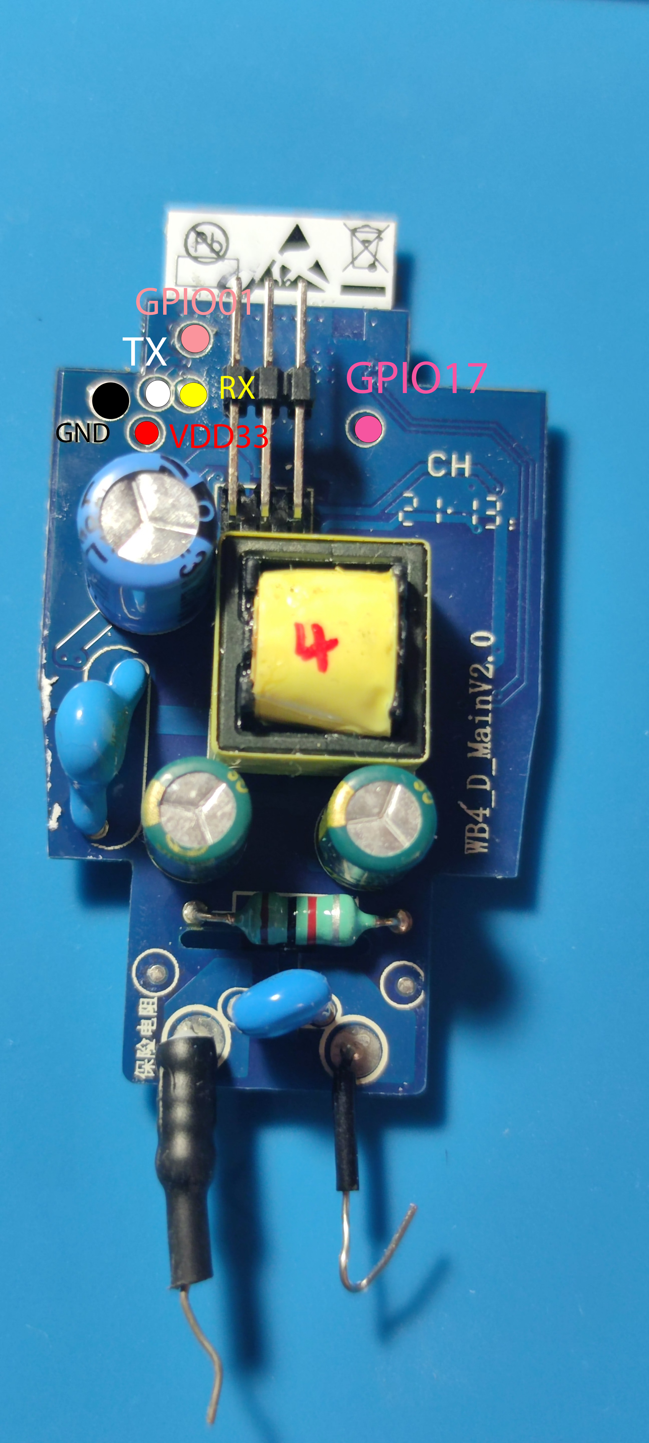

    Hi all,
    I have a problem with changing the software on the tasmote in the gosund bulb wb4.
    Despite soldering in the leads I still have no feedback communication from the controller.

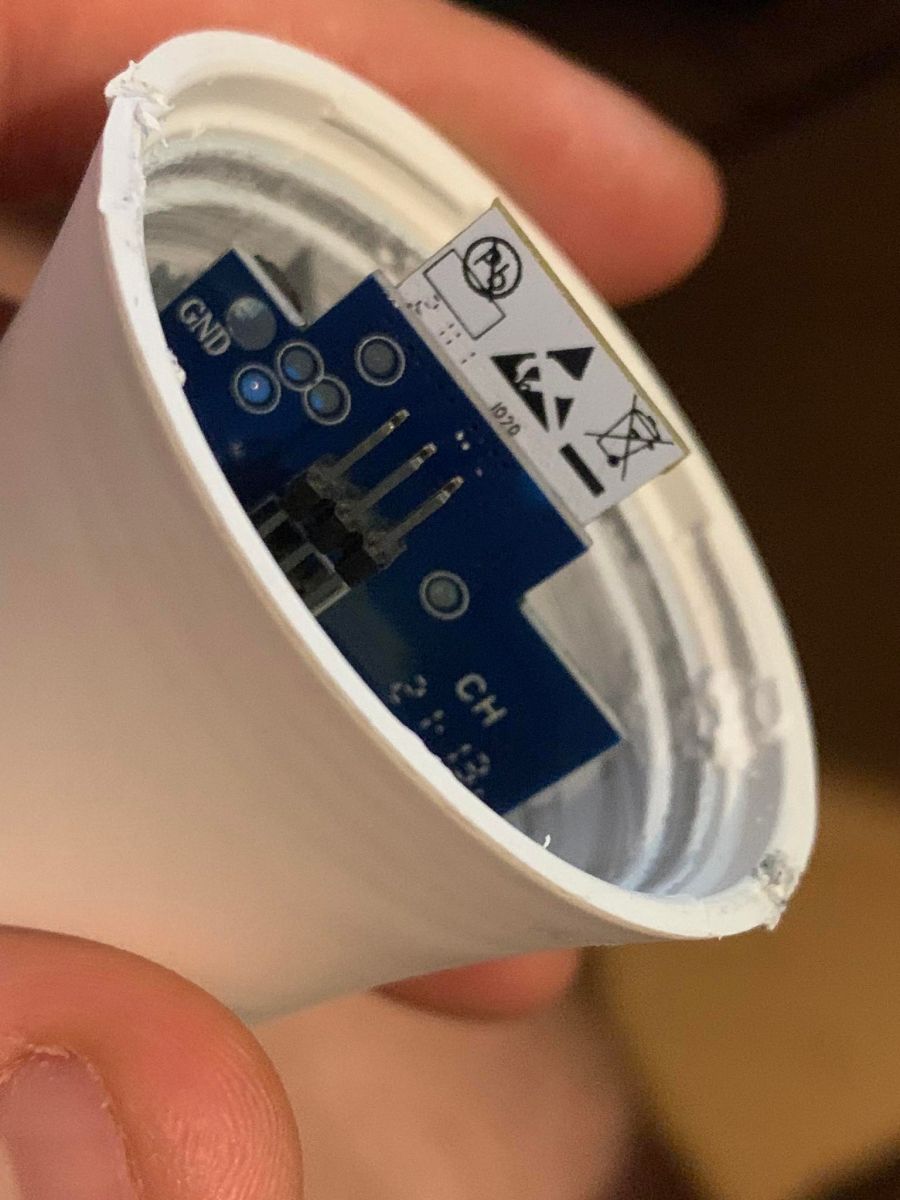

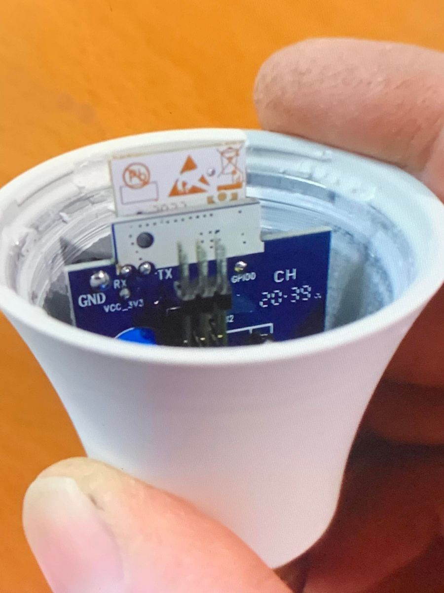

    Below I insert pictures I found on a German forum :
    Gosund Nite Bird WB4 - Issues Flashing Tasmota Firmware, No Feedback

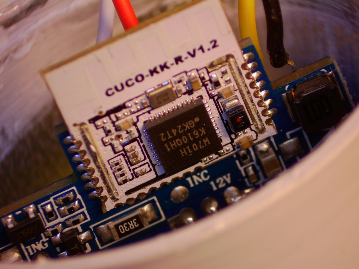

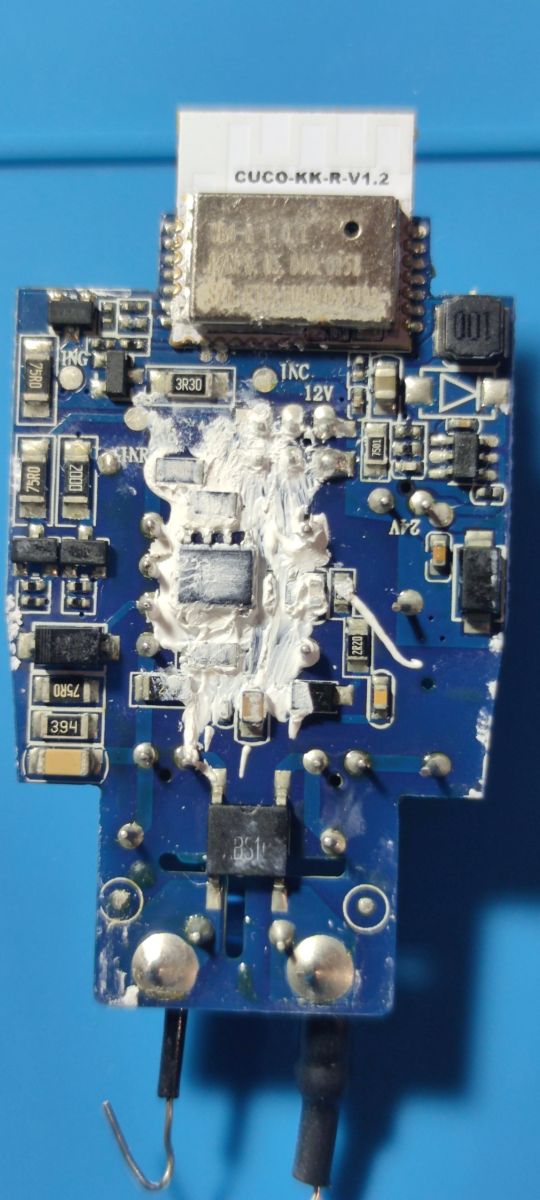

    And here my bulb
    As you can see, mine is newer (?) , does not have the signed pins , although the board looks identical.
    Question whether the controller may have been changed and therefore does not detect my computer, or have been routed differently pins ?
    Anybody here has changed the software in this bulb ?
    I would appreciate an answer :) .

    What WiFi module is in there? More pictures please, you have not shown the WiFi module on the front and I can't see its designation.

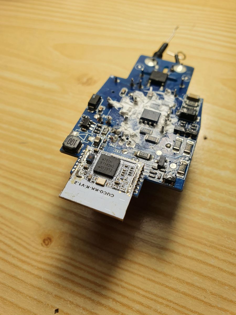

    I will dig up the topic because I just happen to have a few of these bulbs and at some point the manufacturer changed the ESP to W701H(?). Also, I could not find a module that looks the same or similar on the Tuya website.

  • W701H flashing requires RX and IO0 pulled high
    #6 21438564
    Posts: 5216
    Help: 448
    Rate: 917

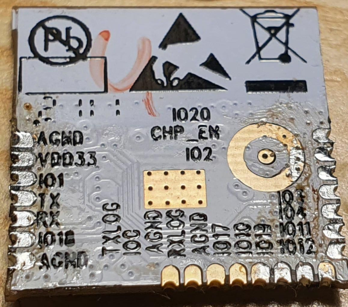

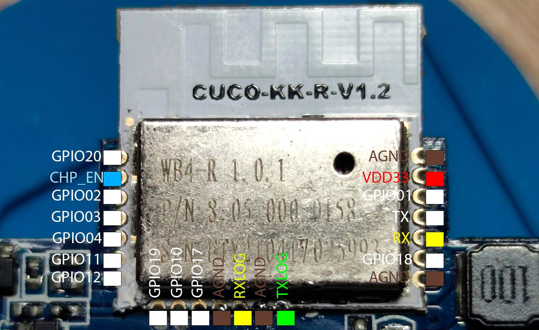

    @maxikaaz86 has de-soldered the CUCO-KK-R-V1.2 module and kindly provided us with a pic of the rear, which I now post
    Image of the desoldered CUCO-KK-R-V1.2 module with visible pin markings.
    The image shows the backside of the CUCO-KK-R-V1.2 electronic module with visible pin labels and connection instructions.
    This W701H module requires 2 IOs to be pulled to 3.3v
    RX is GPIO13

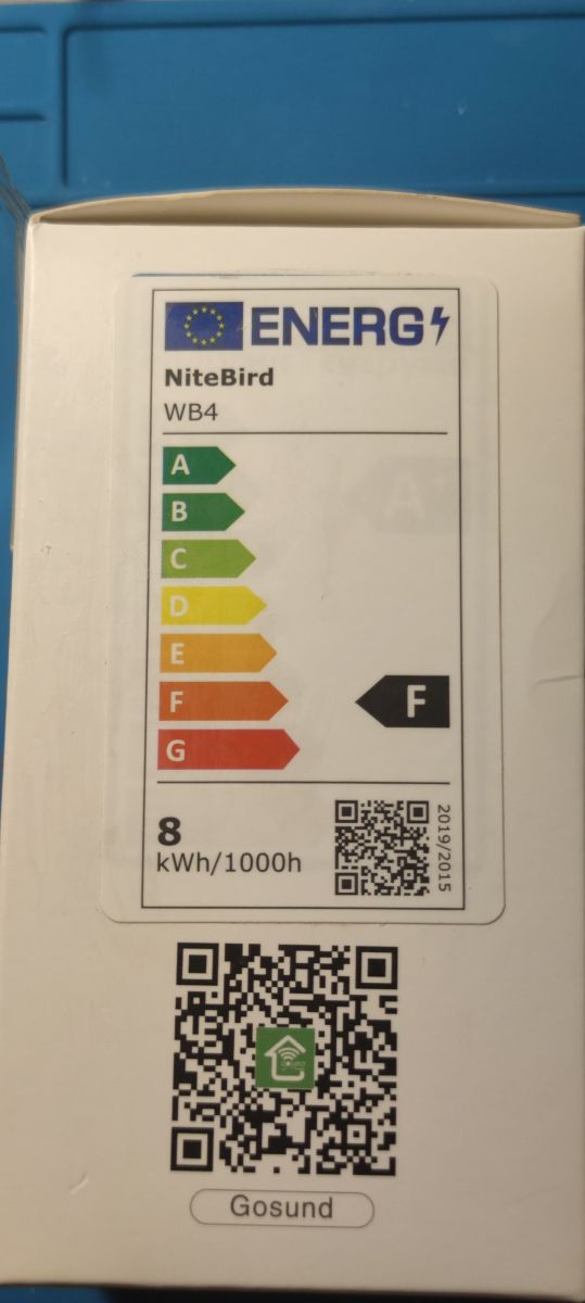

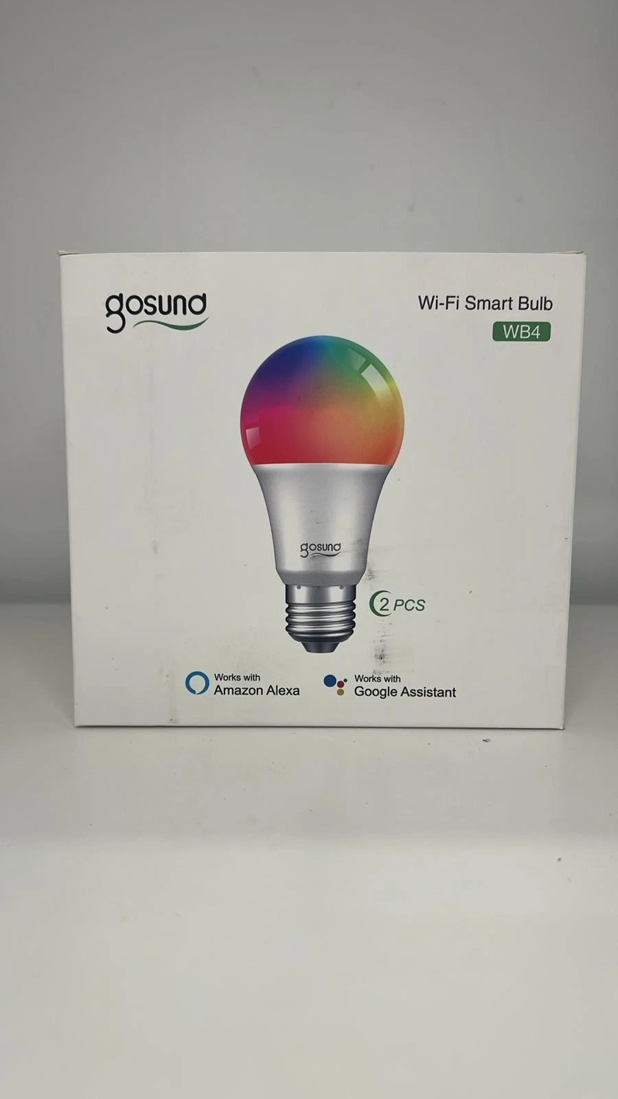

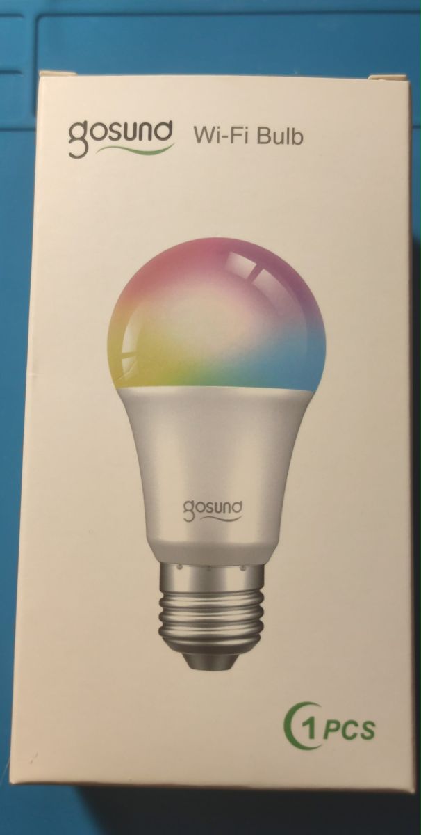

    Box photo:

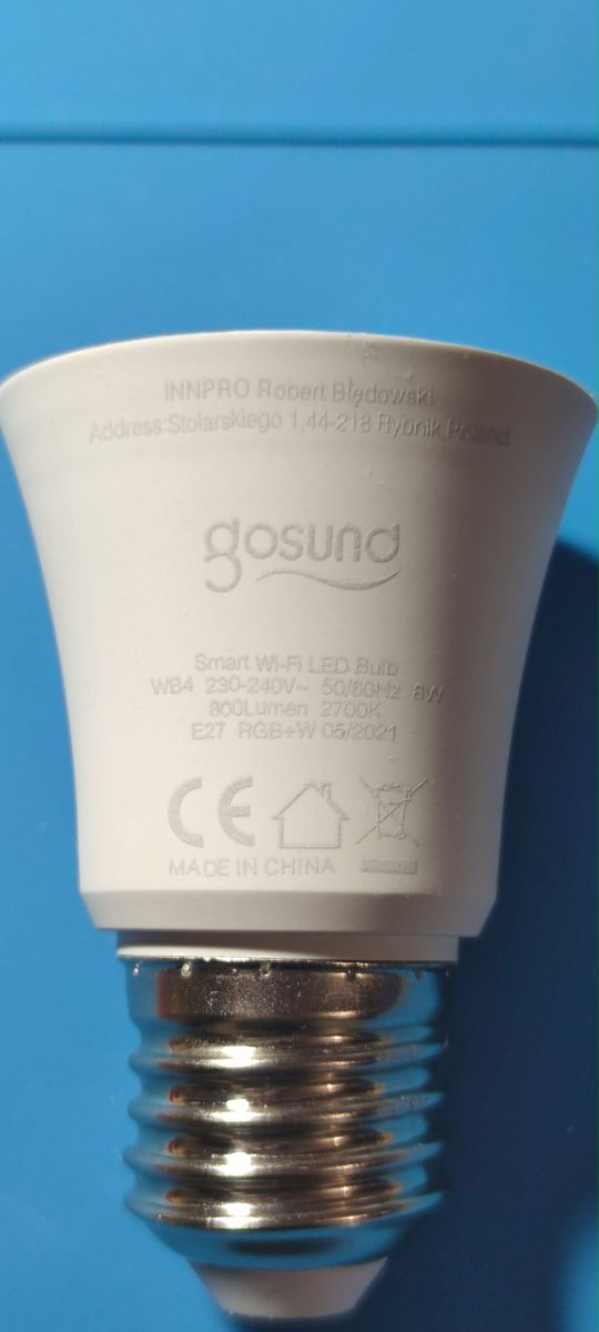

    Bulb case photo:
    Bulb board photo:

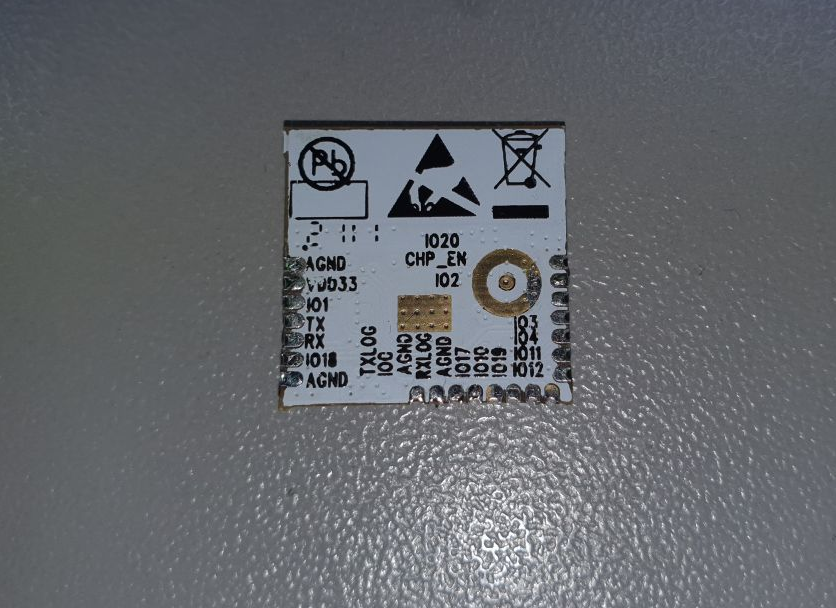

    Cuko-KK-R-V1.2 Pinout(W701 module):

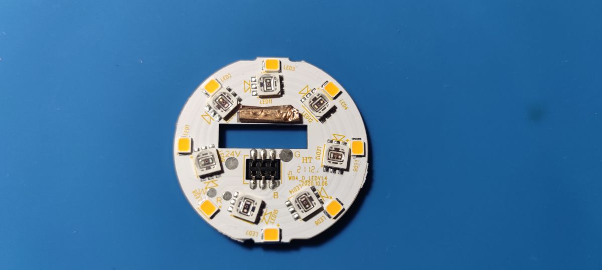

    LEDs board:
    Preparing to flashing OpenBK:
    (PIN on board -> UART)
    VDD33 -> +3.3V
    AGND -> GND
    TXLOG -> RX
    RXLOG -> TX
    RX -> +3.3V(or VDD33 on module) (to enter flashing mode, must be connected all the time)
    IO0 -> +3.3V(or VDD33 on module) (to enter flashing mode, must be connected all the time)
    CEN -> AGND or module metal shell (only momentarily to reset the chip)

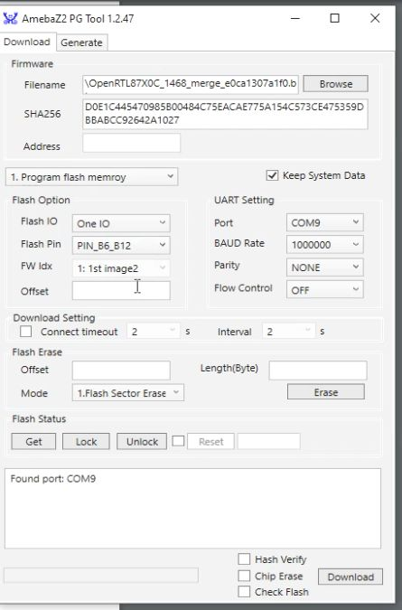

    How to flash:

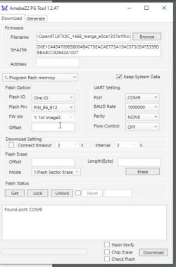

    Use AmebaZ2 PG Tool(u can download one in attached files) and set settings like this:

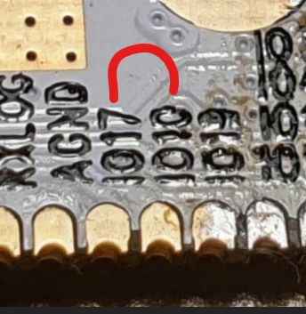

    Added after 1 [hours] 36 [minutes]:
    is there continuity between IO10 and IO17 on the one that doesn't work? tiny bit of solder linking the two?
    Close-up of PCB pin labels with a red U-shaped marker drawn on it

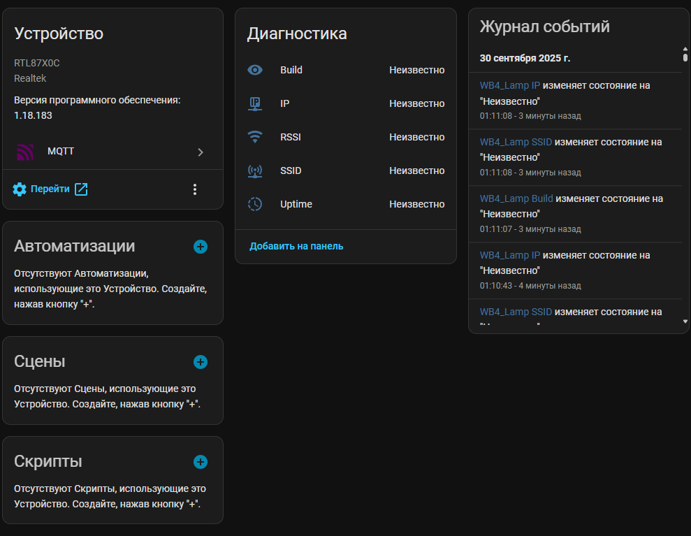

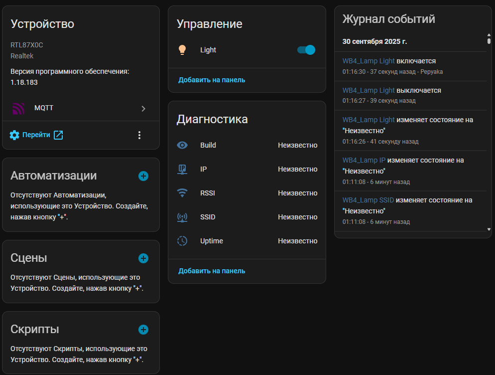

  • Flag 24 affects Home Assistant bulb entity behavior
    #28 21705019
    LeMaxime
    Posts: 16
    >>21704896
    lmao, i found that i broke 2 pads on first bulb- IO17 and IO19
    repaired them and now brightess control available on both bulbs
    but still few funny things
    1)If i use Flag 24 - LED Temperature Slider control RGB LEDs(that slider turn on RGB LEDs and setting them to white color) and control thier brightness,in Home Assistant i see bulb entity and can control colors and brightness RGB LEDs -
    Spoiler:
    IoT device interface showing diagnostics, controls, and light switch status
    2)If i disable Flag 24 - LED Temparature Slider control white LEDs brightness, but there is no bulb entity in Home Assistant -
    Spoiler:
    Interface panel showing RTL87XXC device info, diagnostics, and event log
    But if firstly i set Flag 24 and after remove him - control still appears in Home Assistant and EVEN i can choose white LEDs and control their brightness
    so funny

    I've updated my post a bit, I hope it helps those who want to flash this light bulb.
Discussion about flashing Tasmota/OpenBK on a Gosund Nite Bird WB4 smart bulb that initially showed no UART feedback after soldering programming leads. The issue was traced to a newer hardware revision using a different Wi‑Fi module, identified as a Realtek-based W701H/CUCO-KK-R-V1.2 board rather than the older ESP-style layout. Community members shared pinouts, flashing wiring, and backup methods, including full flash dumps and Tuya/Itchiptool reads. Later testing confirmed the bulb could be flashed and restored to stock Tuya firmware, and that white LED control required mapping the correct GPIO/PWM pins; on one unit PA17/IO17 worked for white brightness, while PA10 did not support PWM. Additional notes covered OpenBK configuration flags, Home Assistant behavior, and hardware damage to pads that affected LED control until repaired.
TL;DR: 2 IO lines must be held at 3.3 V to flash the W701H; “requires 2 IOs to be pulled to 3.3v.” This FAQ fixes no‑feedback flashing and pin mapping on Gosund Nite Bird WB4. [Elektroda, divadiow, post #21438564]
Why it matters: It turns a "no serial output" bulb into a locally controlled RGB+W light that works with OpenBeken and Home Assistant.
How do I identify the Wi‑Fi/MCU inside my Gosund Nite Bird WB4?
Open the bulb and check the module silkscreen: CUCO‑KK‑R‑V1.2 with Realtek RTL87X0C is common on newer WB4 units. In OpenBeken, select the RTL87X0C UART build and use the provided pin template with PWM on pins 3, 4, 11, and 17. [Elektroda, LeMaxime, post #21699333]
How do I put the W701H/RTL87X0C into flashing mode when I get no serial feedback?
Wire VDD33 to 3.3 V and AGND to GND; cross TXLOG↔RX and RXLOG↔TX. Hold RX and IO0 at 3.3 V continuously, then momentarily pull CEN to GND to reset. The module then responds over UART; RX corresponds to GPIO13. [Elektroda, divadiow, post #21438564]
What’s the safest way to back up stock Tuya firmware before flashing?
Use ltchiptool. Set 115200 baud and select chip family Realtek AmebaZ2. Run Read Flash and Read ROM to save full images, which you can later restore. This preserves Wi‑Fi credentials and Tuya activation data. [Elektroda, LeMaxime, post #21699333]
Which OpenBeken firmware file should I flash on WB4?
Flash an OpenBK build for UART RTL87X0C, for example OpenRTL87X0C_1.18.187.bin. After flashing, apply the WB4 pin config with PWM mapped to 3, 4, 11, and 17 for RGB+W control. [Elektroda, LeMaxime, post #21699333]
Why does the bulb reboot when I set PA10 to PWM?
PA10 is not a PWM‑capable pin in the Tuya RTL SDK for this SoC, so enabling PWM there triggers errors and resets. "Tuya RTL sdk doesn’t allow PA10 as PWM." Use a supported PWM like PA17 for the White channel. [Elektroda, insmod, post #21704430]
Which pin actually dims the White LEDs on WB4?
Use PA17 as a PWM output for the White channel. Users confirmed full on/off and brightness control after assigning White to PA17, while PA10 did not work for PWM. [Elektroda, LeMaxime, post #21704580]
I can switch White on/off but not dim—what should I check first?
Inspect the module for damaged pads or lifted traces, especially IO17/IO19 on CUCO‑KK‑R‑V1.2. Repairing broken pads restored PWM brightness on two bulbs. Hardware faults can mimic firmware misconfiguration. [Elektroda, LeMaxime, post #21705019]
The bulb resets when I try RGB and White together—what’s going on?
WB4 is RGB+W, not RGBCW. Driving both heavy loads simultaneously can cause overcurrent and resets. Try lowering power usage or enabling power‑saving features to reduce load during testing. [Elektroda, p.kaczmarek2, post #21699636]
What is Tuya on these bulbs?
Tuya is the stock IoT platform and firmware that handles BLE/Wi‑Fi pairing, product keys, and lighting control. Boot logs show Tuya tasks, product IDs, and BLE advertising during activation. [Elektroda, divadiow, post #21704350]
What is OpenBeken (OpenBK)?
OpenBeken is an open firmware for cloud‑free control of smart devices like WB4. For RTL87X0C, you flash an OpenBK UART build, set pin roles, and integrate with Home Assistant. [Elektroda, LeMaxime, post #21699333]
How do I wire and flash WB4 quickly? (3‑step How‑To)
  1. Back up: ltchiptool @115200, AmebaZ2, Read Flash + Read ROM.
  2. Enter flash: Hold RX+IO0 at 3.3 V; pulse CEN to GND; connect UART to TXLOG/RXLOG.
  3. Flash OpenBK RTL87X0C UART build; set PWM pins 3, 4, 11, 17; save and reboot. [Elektroda, LeMaxime, post #21699333]
Home Assistant shows no bulb entity after I disable Flag 24. How do I fix it?
Enable Flag 24 for initial Home Assistant Discovery so an entity appears. After discovery completes, remove Flag 24 to restore correct Cool White behavior while keeping the entity. [Elektroda, LeMaxime, post #21699333]
How long does a full backup take over 115200 UART?
At 115200, transfer speed is about 2.25 KB/s. A 2 MB flash dump can take roughly 15 minutes, so be patient or increase baud if supported. [Elektroda, LeMaxime, post #21704330]
Where can I find a pinout/datasheet for W701‑VA2‑CG/WBRx‑class modules?
See the linked guide covering WBR2, WBR3, WBRU, and W701‑VA2‑CG pinouts, datasheets, and flashing steps suitable for Home Assistant use. [Elektroda, p.kaczmarek2, post #21379255]
What pin mapping does Tuya’s stock firmware suggest for PWM on WB4?
A Tuya boot log shows PWM pins indexed as 4, 11, 3, and 17. This aligns with OpenBeken templates that map RGB+W across those four PWM outputs. [Elektroda, divadiow, post #21704350]
Why can’t I find the exact module on Tuya’s site?
The vendor revised the design from ESP to W701H, and the exact module variant may not match Tuya’s public listings. Expect CUCO‑KK‑R‑V1.2 with Realtek on newer batches. [Elektroda, maxikaaz86, post #20514563]
