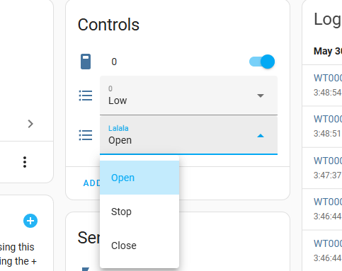

    #71 21564801
    Posts: 14755
    Rate: 12881
    I'll do MQTT check on my side in one hour and get back to you, I will edit my post.
    What kind of UI do we need for OpenStopClose? In OBK, and in HA?
    Added after 5 [minutes]:

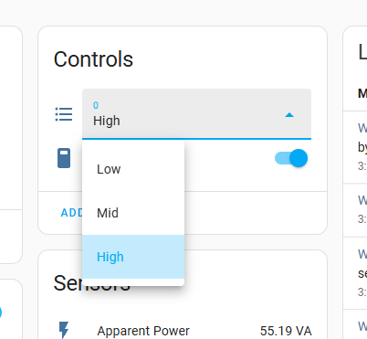

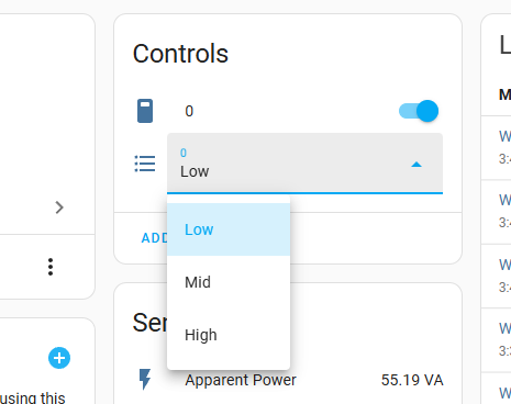

    For HA discovery, add this to end of autoexec.bat:
    scheduleHADiscovery 5
    This will do discovery 5 seconds after mqtt connect. Of course, this can be also done manually, but maybe it's easier with command.
    When doing big changes, you may need to remove manually device from HA first.
    Some of channel types may not be discoverable yet, but I can add what's missing
    Added after 1 [hours] 42 [minutes]:
    I'm working on it

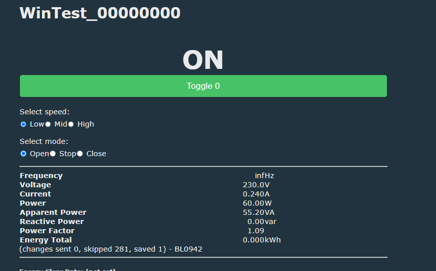

    Dropdown menu with three levels: Low, Mid, and High in the Controls section of the user interface.
    Added after 17 [minutes]:
    I will add release soon.
    Sample:
    setChannelType 2 LowMidHigh
    scheduleHADiscovery 1
    Result:
    Control panel with dropdown menu for selecting power level; options are Low, Mid, High.
    setChannelLabel 3 Lalala
    setChannelType 3 OpenStopClose
    Screenshot of a user interface showing a dropdown menu with Open, Stop, and Close options in the Controls section.
    Control panel WinTest_00000000 with speed selection (Low, Mid, High), mode options (Open, Stop, Close), Toggle 0 button, and device electrical data.

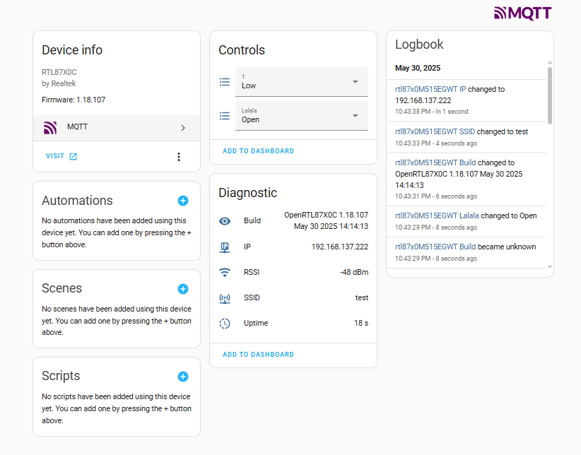

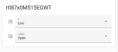

  • #72 21565307
    robshd2
    Level 4  
    Posts: 7
    >>21564801

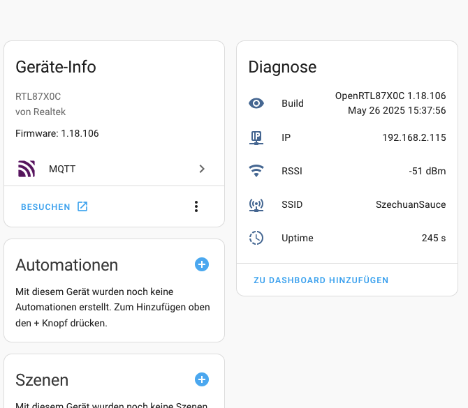

    Thanks for the help! This works through the UI and through the HTTP endpoint now, but no matter how often I reset, reboot or remove the device from HA, it comes up without Controls or Sensors:
    Diagnostics panel for RTL87X0C device showing firmware, connection, and Wi-Fi status.
    Any idea why this might be the case?
  • Check whether OpenStopClose appears in HA UI
    #73 21565310
    Posts: 14755
    Rate: 12881
    So you have this radio buttons on OBK UI, but not in HA?
    Wait... do you REALLY have those new types on UI?
    I added them today, and your build is from 26 may. Hmm. Maybe you need to update?
    Just to be sure, is OpenStopClose channel type really working for you? Do you have it on OBK UI?
    @divadiow , do you have physical device with the same platform as @robshd2 ? Can you check do you get OpenStopClose in HA?
    ENABLE_ADVANCED_CHANNELTYPES_DISCOVERY seems to be enabled on RTL...
    I can also see you're SSID may be a Rick and Morty reference.

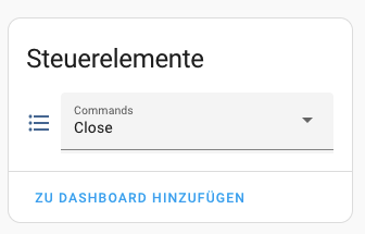

  • Update enables TuyaMCU Home Assistant discovery
    #74 21565324
    robshd2
    Level 4  
    Posts: 7
    >>21565310
    I still run it with LowMidHigh for now, as the others seemed to error. I had hoped for either the buttons of Channel 2 to show up. Let me update and report back, if it makes a difference for discovery.
    Re: SSID: You would be correct ;)
    EDIT:
    Holy holy, it looks like the update did the trick! Thank you very much, my detachment from the Tuya Cloud seems to be complete!
    To get an understanding of the internals: The channels are exposed based on their type, which is why things like the dimmer on channel 2 would not be visible?
    Current config:
    startDriver TuyaMCU
    tuyaMcu_setBaudRate 9600
    tuyaMcu_defWiFiState 4
    setChannelType 1 OpenStopClose
    setChannelLabel 1 Commands
    linkTuyaMCUOutputToChannel 1 4 1
    setChannelType 2 dimmer
    setChannelLabel 2 ClosingState
    linkTuyaMCUOutputToChannel 2 2 2

    Screenshot of a panel with two dropdown lists set to Low and Open.
    Control panel of RTL87X0C device by Realtek with diagnostics and logbook on the MQTT platform.
  • #76 21565333
    robshd2
    Level 4  
    Posts: 7
    Control panel with Close command and a button to add to dashboard.
    And a screenshot of the working toggle. Updated the message above with an edit. Thanks again!

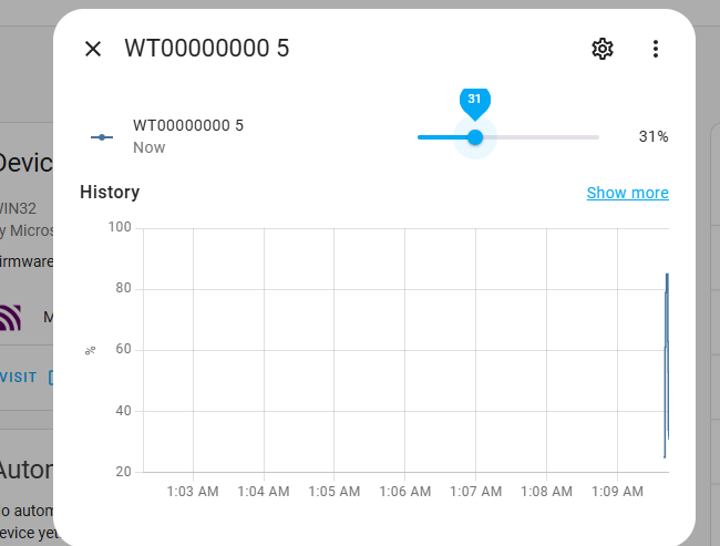

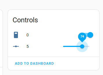

  • Suggesting a read-write percentage control channel for HA
    #77 21565336
    Posts: 14755
    Rate: 12881
    Dimmer channel type is special, because it's used to create light entity. I think I will just create a separate channel type with HASS discovery for you tomorrow.
    So, what kind of channel type do we need? Does it have to be read and write, or read only?
                  "abilityId": 2,
                  "accessMode": "rw",
                  "code": "percent_control",
                  "description": "If the curtain motor can monitor its current position (e.g., 50% open), this DP allows precise position control. If selected, percentage display must be enabled. The value range for this DP cannot be modified, added, or removed.",
                  "extensions": {
                    "iconName": "icon-dp_power"
                  "name": "Percentage Control",
                  "typeSpec": {
                    "max": 100,
                    "min": 0,
                    "scale": 0,
                    "step": 1,
                    "type": "value",
                    "typeDefaultValue": 0,
                    "unit": "%"
    It seems it's rw, so both read and write. Ok, so do you have any suggestions which HA entity should we use for that?
    Alternatively, once we get this fully working, we can check HA for dedicated shutter entity, maybe it would be even more useful.
    Added after 1 [hours] 4 [minutes]:
    maybe something like that:
    A control panel with a battery icon showing 0 and a slider set to 74.
    History chart of the device WT00000000 5 with a current value of 31%.

    //EDIT:
    OK, now I know that I had to start the driver for Power Metering.
    startDriver BL0942 9600
    And I tryed guessing the 3 Sensors:
    "pins": {
    "12": "dInput;51",
    "13": "LED_n;50",
    "15": "BL0937CF;0",
    "17": "Rel;46",
    "18": "BL0937SEL;0",
    "19": "BL0937CF1;0"
    Now I was able to read the Volt and Amps and also calibrate them.
    But Power ist still not showing and I cannot calibrate - "Last status: ERROR: Command found but returned error (undefined)"
    What am I missing? I thought that maybe one of the PINs ist not corret, but if I remove one, then I get only zeros.
    (I was not able to find out how the BL937 CF CF1 and SEL corelate to one another. Is it like, one is for A one for V and one for W?
    Normaly I would say, that the W would just be calculated?)

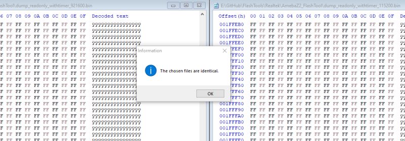

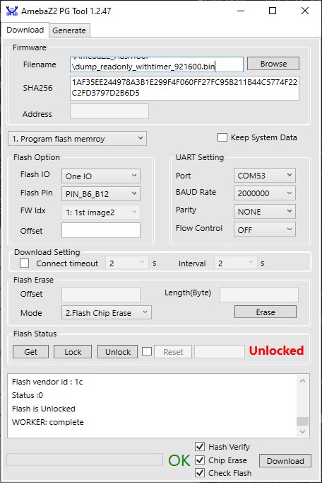

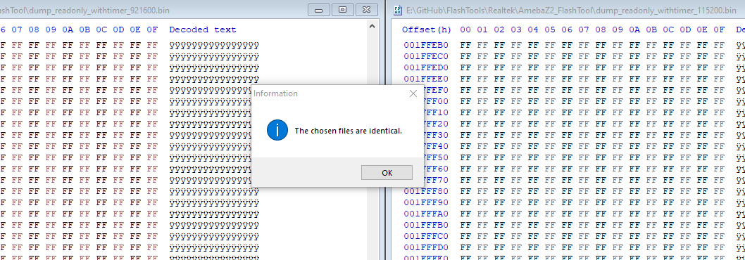

  • AmebaZ2 flash read script works at multiple bauds
    #90 21701946
    Posts: 5212
    Help: 446
    Rate: 914
    insmod wrote:
    The most important is AmebaZ2, but its protocol is somewhat different - even requires separate flash tool, while even AmebaZ is supported by latest flash tools.
    I've been playing with GPT and we seemed to have made a Z2 flash read script. I really don't know how good the code is but it's making identical dumps at different bauds and they can be flashed to erased Z2 (with official tool) and they do boot.
    AmebaZ2 PG Tool interface showing flash programming and device status
    Comparison of two binary files with message confirming they are identical.
    • ambz2_flashtool_readonly_withtimer.zip (6.36 KB) You must be logged in to download this attachment.
