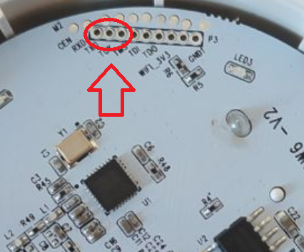

    Hi All! Great project I didn't know until 2 hours ago, keep up the good work!
    Now I'm just started programming a recent Tuya Siren+Temperature+Humidity sensor (old ESP8266 version was named NAS-AB02W (without 6) this one is the old: https://templates.blakadder.com/neo_coolcam_NAS-AB02W.html ; the one I got from aliexpress has the BK7231N and it's using TuyaMCU.
    I've programmed it just fine using RXD-TXD pins and touching CEN pin with UART3v3 GND pin just after flash program starts.
    I've figured out how to map the dpid I need for now, but there is a thing I'm not able to change: this siren has LEDS that are flashing when siren is ringing and stay off in all other states, with original firmware.
    With OpenBK flashed, the leds just flash after boot and I'm not able to stop them. Any suggestion what to look for?

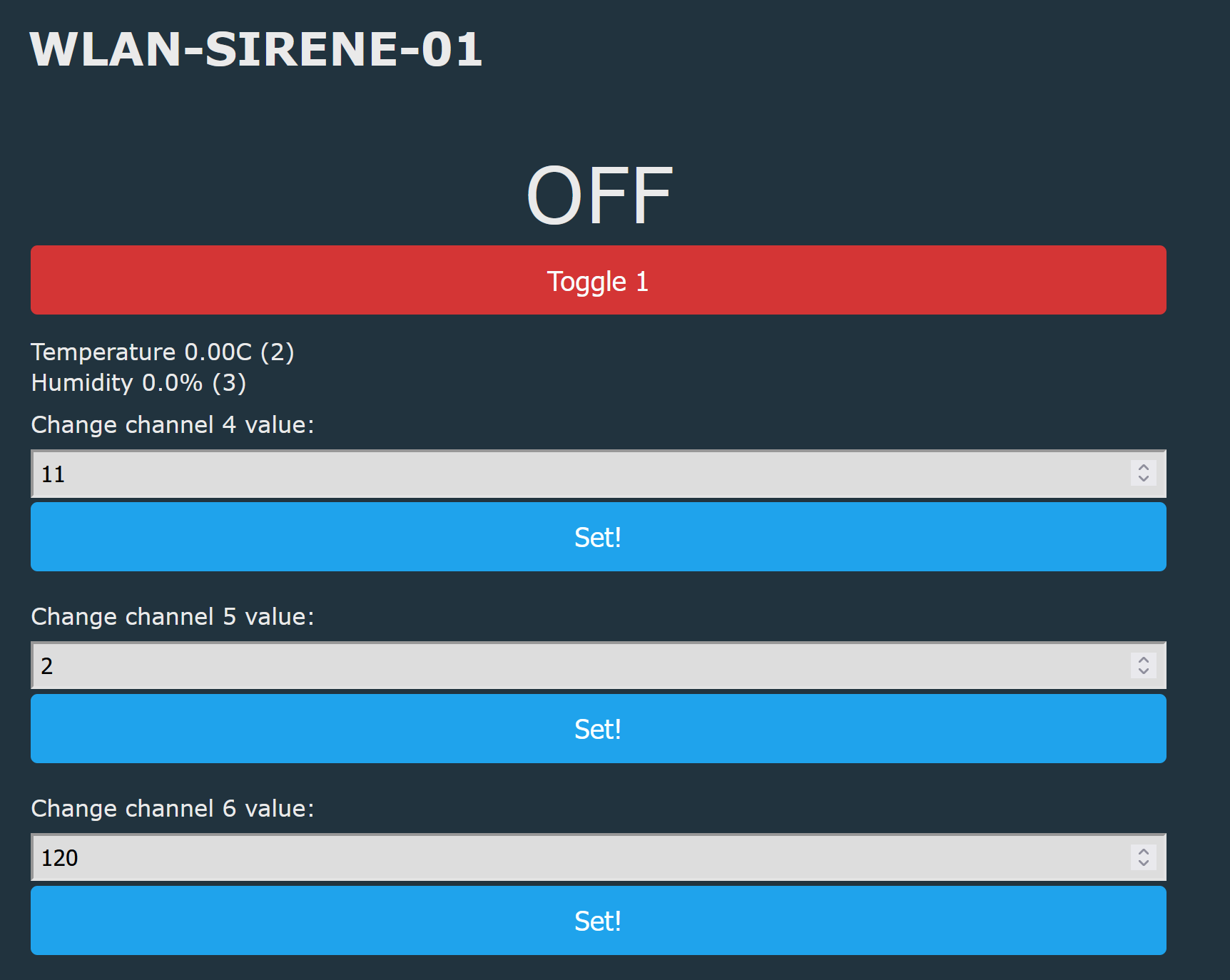

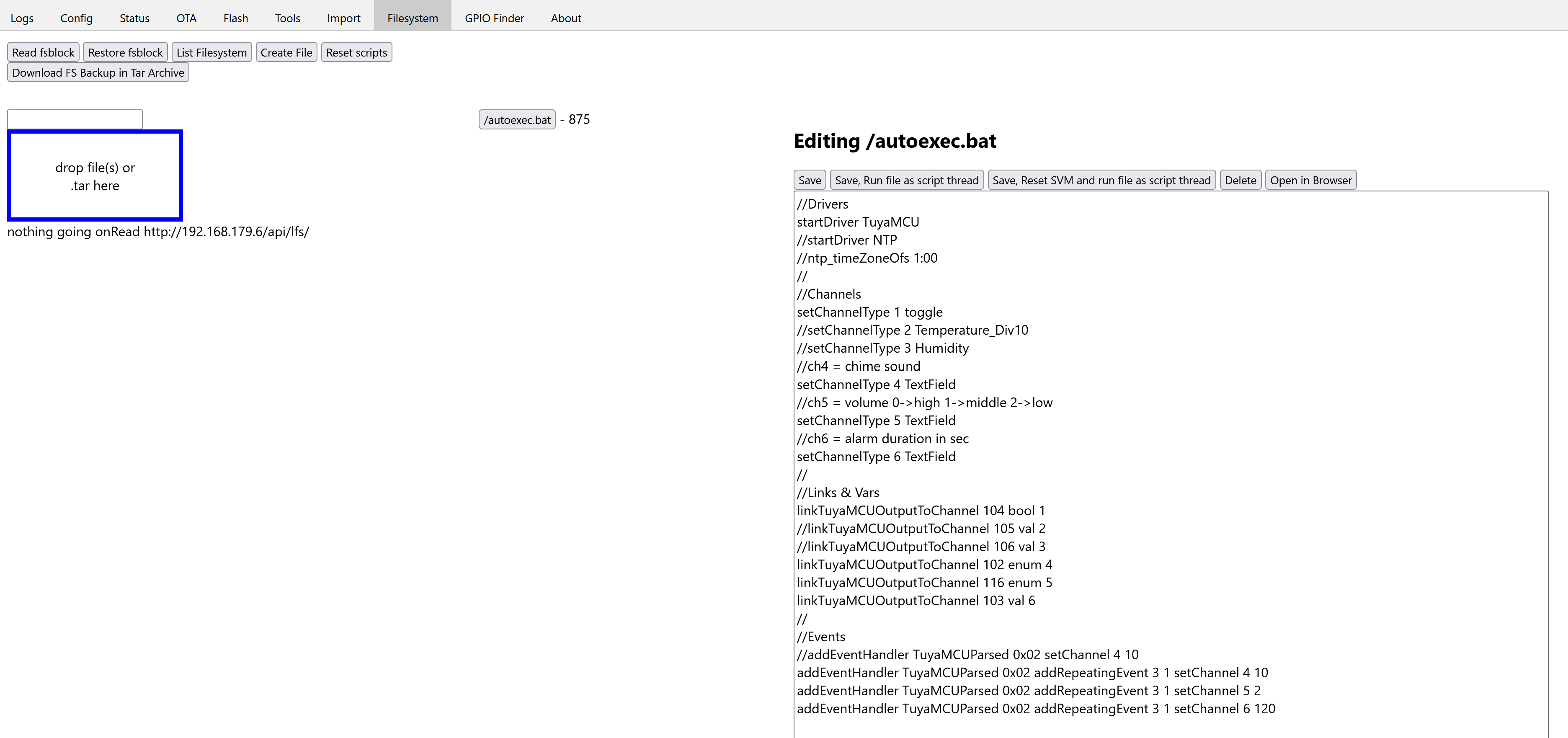

    I've tried a lot of things and the results are:
    dpid 103 is alarm duration time (in seconds), default is 10.
    When 104 (toggle) is set to 1 (switch on) the bell will ring for dpid 103 duration, after switch 102 is returned to 0.
    Temperature is dpid 105 and humidity is 106.
    104 - 105 - 106 are working fine with openbeken.
    There is a problem on dpid 102 that is chime sound selection (it's a value from 0 to 17) = 18 ring tones.
    At startup it's defaulted to value 5. I can change it with setchannel on command of webapp (channel is set to textField). I need value 12 permanent.
    If I put this on web config as startup value, it remains 5 after a reboot.
    I've tried also setChannel 4 12 on autoexec.bat but value after reboot is still 5.
    I've tried also a delay before setchannel but value is still 5.
    I can change it only from command line. Any clue?

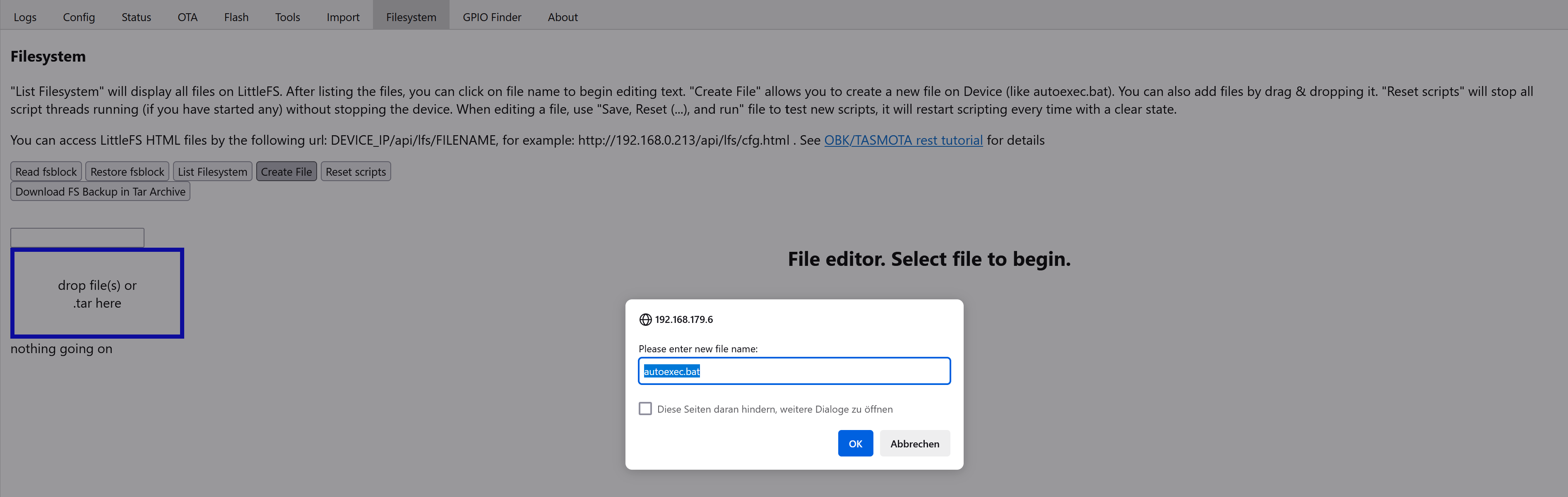

    my actual autoexec.bat:
    See post #5
    If i put this on web config as startup value, it reamains 5 after a reboot.
    I've tried also a dealy before setchannel but value is still 5.
    I can change it only from commandline. Any clue?
    We do not have implemented yet the initial state sending to TuyaMCU, it was never needed, but I will try to figure out something for you.
    The most simple solution would be:
    addRepeatingEvent 5 1 setChannel 4 12
    5 is a delay in seconds, customizable, 1 is number of repeats - do it once.
    But it may not be a perfect solution. I've been thinking what else I can do for you quickly to solve your issue and I came up with this:
    https://github.com/openshwprojects/OpenBK7231...mmit/93debb94eb3b4c380812ed4b3e129dd7a5994ed5
    You will need to update the firmware to get that.
    This is an event, TuyaMCUParsed, with argument showing packet type:

    Usage:
    addEventHandler TuyaMCUParsed 0x02 setChannel 4 12
    Or, if you want a delay:
    addEventHandler TuyaMCUParsed 0x02 addRepeatingEvent 1 1 setChannel 4 12
    I haven't tested it so tell me if there is any problem.

    Wow! Thank you for your support.
    Ok first problem was this linkTuyaMCUOutputToChannel 102 val 4, apparently it was working and setting a value was working too but in reality chime sound was not changing.
    After setting it as linkTuyaMCUOutputToChannel 102 enum 4 it was starting working and set value was retained on reboot too.

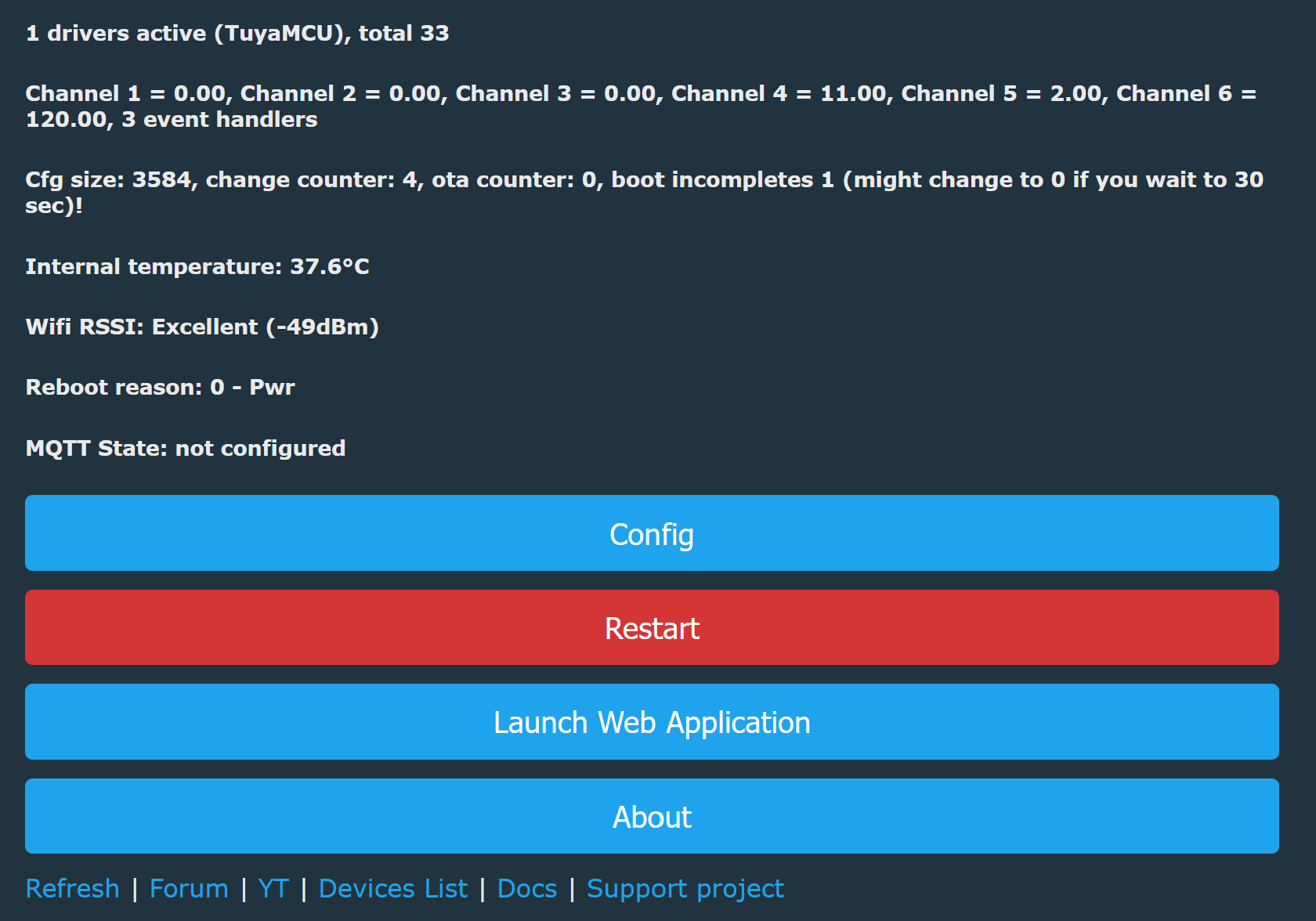

    However I've also tested your new event and put this on autoexec.bat "addEventHandler TuyaMCUParsed 0x02 setChannel 4 11" and it's working fine if I change value then reboot.
    As of now I can say this device is fully supported right now.
    Will edit this message later adding my actual autoexec.bat. Here it is:
    //Drivers
    startDriver TuyaMCU
    //startDriver NTP
    //ntp_timeZoneOfs 1:00
    //Channels
    setChannelType 1 toggle
    setChannelType 2 Temperature_Div10
    setChannelType 3 Humidity
    //ch4 = chime sound
    setChannelType 4 TextField
    //ch5 = volume 0->high 1->middle 2->low
    setChannelType 5 TextField
    //ch6 = alarm duration in sec
    setChannelType 6 TextField
    //Links & Vars
    linkTuyaMCUOutputToChannel 104 bool 1
    linkTuyaMCUOutputToChannel 105 val 2
    linkTuyaMCUOutputToChannel 106 val 3
    linkTuyaMCUOutputToChannel 116 enum 5
    linkTuyaMCUOutputToChannel 103 val 6
    //Events
    //addEventHandler TuyaMCUParsed 0x02 setChannel 4 11
    addEventHandler TuyaMCUParsed 0x02 addRepeatingEvent 3 1 setChannel 4 11
    addEventHandler TuyaMCUParsed 0x02 addRepeatingEvent 3 1 setChannel 6 120

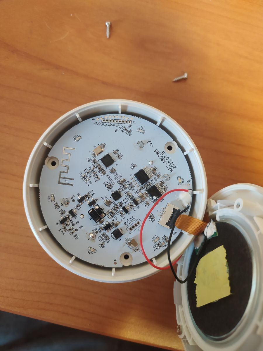

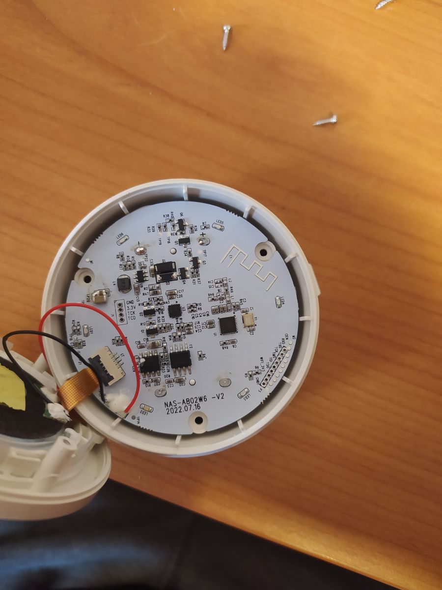

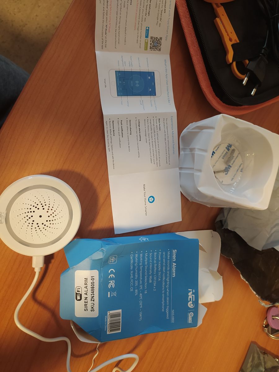

    Thank you, would you be able to at least provide few more photos of the device inside (PCB board) or/and packaging to make the entry to https://openbekeniot.github.io/webapp/devicesList.html complete? Or maybe where the device was bought?
    It's important to use to provide enough documentation so future users so they can easily flash their devices.
  • #7 20389108
    rylos78
    Device was bought here: AliExpress Siren Temperature Humidity Sensor

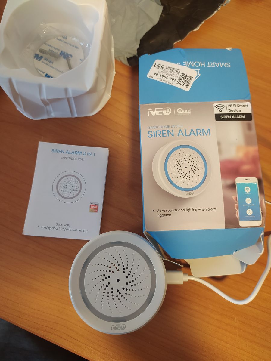

    I will post here a backup screenshots from the offer you linked (because links tends to expire):
    NAS-AB02W6 Ver 2.0 Tuya Siren+Temp+Humidity Sensor: Control LEDs with OpenBK Firmware
    NAS-AB02W6 Ver 2.0 Tuya Siren+Temp+Humidity Sensor: Control LEDs with OpenBK Firmware NAS-AB02W6 Ver 2.0 Tuya Siren+Temp+Humidity Sensor: Control LEDs with OpenBK Firmware NAS-AB02W6 Ver 2.0 Tuya Siren+Temp+Humidity Sensor: Control LEDs with OpenBK Firmware NAS-AB02W6 Ver 2.0 Tuya Siren+Temp+Humidity Sensor: Control LEDs with OpenBK Firmware NAS-AB02W6 Ver 2.0 Tuya Siren+Temp+Humidity Sensor: Control LEDs with OpenBK Firmware NAS-AB02W6 Ver 2.0 Tuya Siren+Temp+Humidity Sensor: Control LEDs with OpenBK Firmware NAS-AB02W6 Ver 2.0 Tuya Siren+Temp+Humidity Sensor: Control LEDs with OpenBK Firmware NAS-AB02W6 Ver 2.0 Tuya Siren+Temp+Humidity Sensor: Control LEDs with OpenBK Firmware
    Are you using PowerSave for this device, as according to the photos is supports battery mode? But even if it's powered by wire... PowerSave can always save some energy.

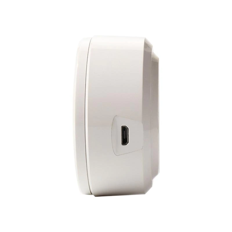

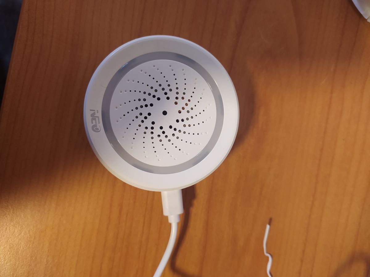

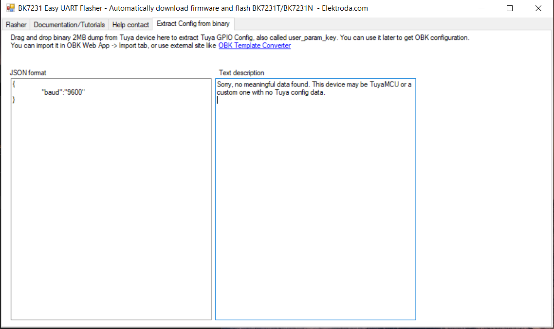

    Hi, I got a similar device NEO nas AB02W6 from AliExpress, based on Beken7231N module.
    The related photos of siren:
    Want to ask: Should I do tuya mcu capture of packets before flashing or not?
    It seems to be similar with @rylos78's siren.
    Thank you.

    It's up to you, @ionoleinic , but it's always safe to do both packet capture and firmware backup first.
    Keep in mind that TuyaMCU is using the same port which one is used for flashing, so not much extra work is needed to do the capture. It should be easy. As far as I remember you already did UART capture in the past, right?

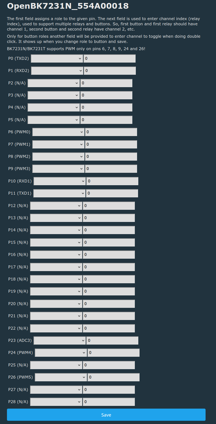

    I'm just starting to interface in HASSIO the NEO Coolcam Siren NAS-AB02W6, and just flashed the device with OpenBK.
    May anyone suggest the PIN configuration to be used.
    Thanks.

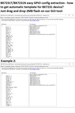

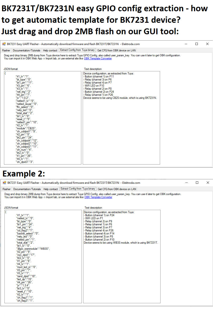

    Hello, do you have a 2MB flash dump?
    This tool:
    can extract GPIO from 2MB Tuya flash dump.
    See example below:
  • #21 20623474
    ionoleinic
    Posts: 48
    It doesn't work on devices that use Tuya MCU...
  • #22 20623995
    Posts: 14611
    Help: 655
    Rate: 12629
    Well, right, but at least it can detect the baud rate of TuyaMCU protocol.

    I also have NEO Coolcam Siren NAS-AB02W6 and just flashed the device with OpenBK. However, I don't know how to configure pins in the following screen;
    Screenshot of pin configuration for OpenBK7231N device.
    May anyone suggest the PIN configuration to be used?

    Have you tried to do the GPIO extraction process?
  • #25 20852717
    jleepblcjleeca
    Yes, I already tried but it doesn't work on devices that use Tuya MCU...

    you do not need to configure any pins.
    The Bekenchip talks directly with the tuya chip via serial connection (the same serial port you use to flash). This tuya chip does anything else (sound led).
    All you have to do is creating an autoexec.bat in the filesystem of openbeken and paste the code from rylos87 in post #5 (https://www.elektroda.com/rtvforum/topic3947937.html#). Then restart it and it works.
    Best regards.

    #30 21135668
    itelektronik
    Here is a short how-to flash the NAS-AB02W6-V4 Siren and get it working.
    1.) Flash the Beken7231N module.
    I just connected TXD and RXD (its the second and third hole marked on the picture) to my USB-Serial-Interface, launched the OpenBekenFlasher, started Backup&Flash and then connected USB Power to the Siren. I think it is a good idea to use the computer as USB-power source to have the same ground level.
    Close-up of a circuit board with highlighted TXD and RXD holes.
    2.) Start the device. Connect to the "Openbeken*****" wifi. Open http://192.168.4.1 in your browser. Configure wifi.
    3.) Discover the IP address of the device and connect to it.
    4.) Launch Web Application
    Screenshot of the configuration interface for the NAS-AB02W6-V4 siren.
    5.) On the Top-menu click on "file system". then choose "create file". say "OK" to autoexec.bat
    File editor interface with a field for creating a new file autoexec.bat.
    6.) In the middle click on the new file paste the autoexec.bat contents from post #5 there. Click "Safe"
    If you have the device without temperature and humidity, you can delete the according lines (8,9,19,20).
    Editing interface for autoexec.bat file in a web application.
    7.) restart the device and have fun :-) :-) :-) :-) :-) :-) :-) :-) :-) :-) :-) :-)
    Screenshot of the WLAN-SIRENE-01 interface with Toggle 1 button and channel settings options.
