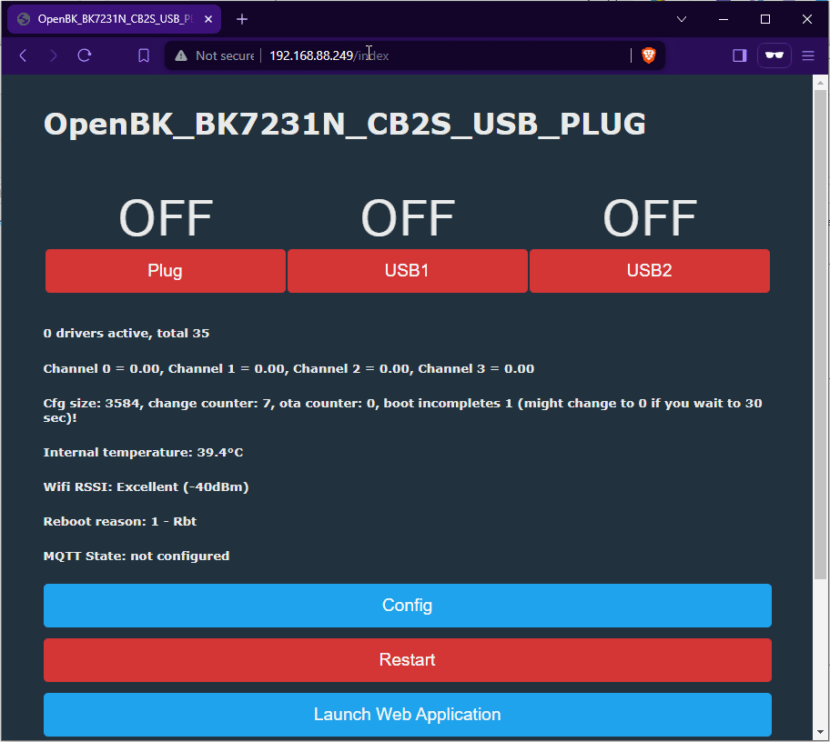

    feel free to upload factory-state unpaired full firmware dump or tuya config file
    OpenBK_BK7231N_CB2S_USB_PLUG software control panel on a webpage.
