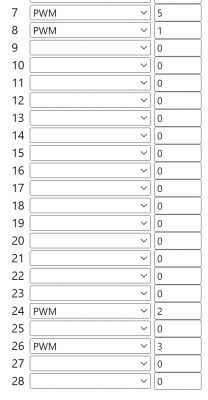

    I've no idea whether it's PWM or not, but does the fact that I've used another bulb profile which maps PWM and it kinda works suggest this is a PWM bulb?
    Is there any benefit to opening one of the bulbs? Will it give me any answers or is the time best spent using trial and error with the PWM mapping?
    I'm on a different laptop to last night but the profile I used resulted in something like this when I used the webapp;
    PWM-Red: Worked, dimming worked, the brightness seems quite poor but this could be standard for this bulb
    PWM-Green: Mapped to warm white, dimming worked
    PWM-Blue: Does nothing
    PWM-Cool White: Mapped to blue, dimming worked, the brightness seems quite poor but this could be standard for this bulb
    PWM-Warm White: Mapped to green, dimming worked, the brightness seems quite poor but this could be standard for this bulb
    This is the mapping from the previously mentioned bulb profile;

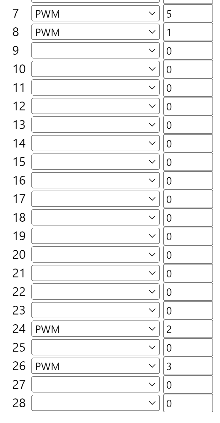

    Good job, so it's PWM. Please rearrange the channel indices so Red is 1, Green is 2, Blue is 3, Cool is 4, Warm is 5.
    As I have already mentioned, there are 6 possible PWM pins on BK7231 devices.
    If you already know that in your case PWM-Blue (P6?) does nothing, then by the process of elimination (your screenshots shows PWMs on 6, 7, 8, 24 and 26), there is a fair chance that missing PWM is on P9:
    PWM3 I/O GPIOP_9, common GPIO, which is connected to the P9 pin on the internal IC
    Remember to unset PWM role for old pin (P6 in your case?) while setting a new PWM role for pin you want to check (P9, I think?).

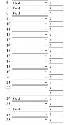

    I'm so close to getting this right but cannot get warm white and cold white to work independently.
    The working mapping so far is;
    [BK7231N] LVWIT B22 Bayonet WiFi LED Bulb,1521Lm,Tuya Smart Bulb B22 ,12W (Amazon.co.uk)
    Working:
    Red
    Green
    Blue
    Warm White
    Not Working:
    Cold White
    No matter what value I put in 6 or 9 it doesn't respond.

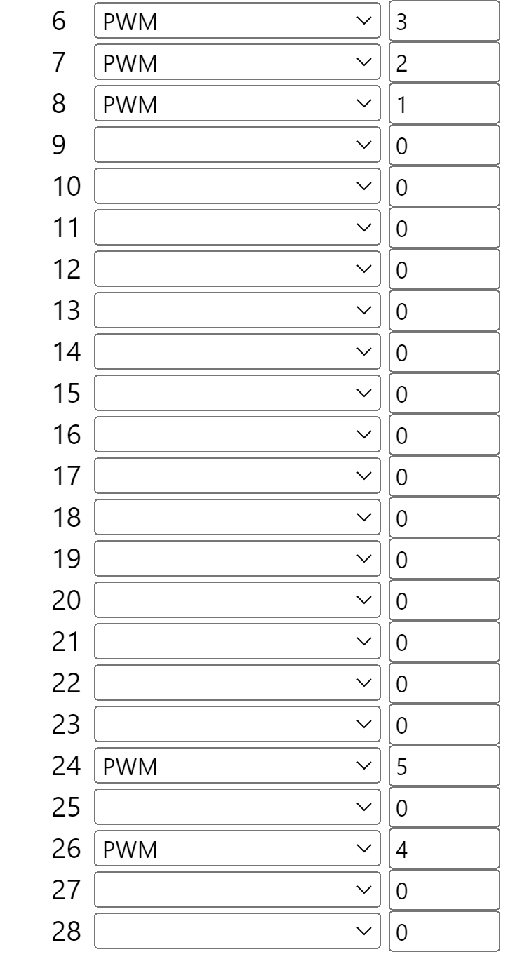

    Bingo!! We got it! :)
    Thank you so much for the help - I think this is a fully functional config now;
    Pin Assignment:
    6 PWM_n 4
    7 PWM 5
    8 PWM 1
    24 PWM 2
    26 PWM 3
    Flags:
    Flag 8 - [LED] Alternate CW light mode (first PWM for warm/cold slider, second for brightness)
