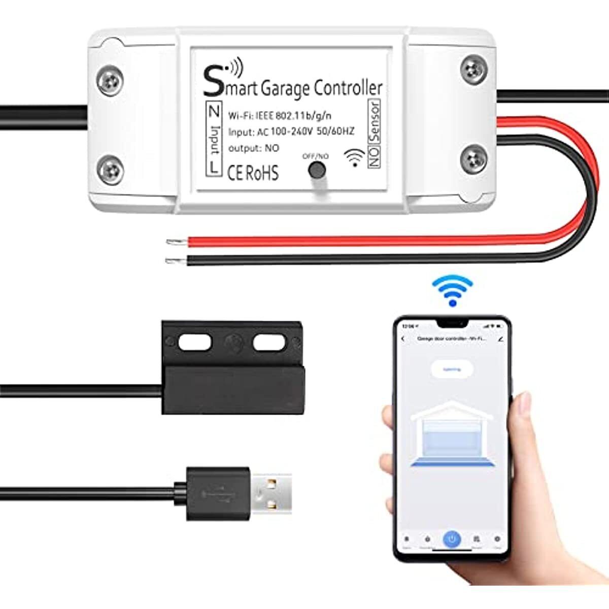

    thank you for this solution to deal with those pesky wifi chips. With help of your flasher and modifying instructions for 'Athom Garage Door Opener Kit' I was able to get this 'Smart Garage Opener' going.
    Modified Athom Garage Door Opener Kit with BK7231T (WB2S) Chip: Complete Guide (90 characters)
    Flash using bk7231flasher_1.0.4 -> BK7231T chip
    I used a Esp8266 NodeMCU as TTL adapter (EN connected to Gnd will put NodeMCU in adapter mode)
    NodeMcu <-> WB2S
    Vin(5v) <-> ive in of voltage regulator
    Gnd <-> Grnd
    TX<->1TX
    RX<->1RX
    Gnd<->Cen *when prompted. Disconnecting power did not work.
    Once flashed, used AP mode to connect to wifi
    follow same steps as Athom Garage Door Opener Kit, but pin config to be set as below
    P6 btn
    P7 Ledi
    P24 Relay
    P26 dinput
    and then the command to set up as garage opener
    backlog setChannelType 1 OpenClosed; addChangeHandler Channel0 != 0 addRepeatingEvent 2 1 setChannel 0 0
  • #2 20403999
    Posts: 14622
    Help: 655
    Rate: 12639
    Thanks! I will just note that:
    should be executed as a Startup Command or in autoexec.bat, if you run it just in console, then device will forget the event with next reboot.
